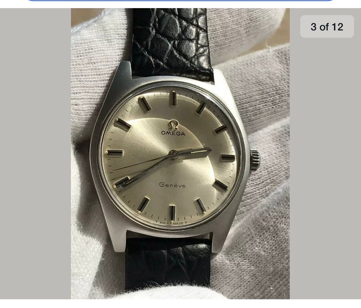

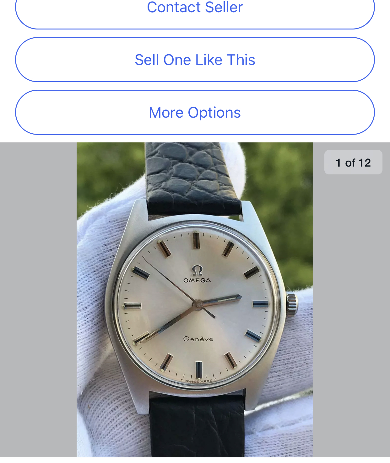

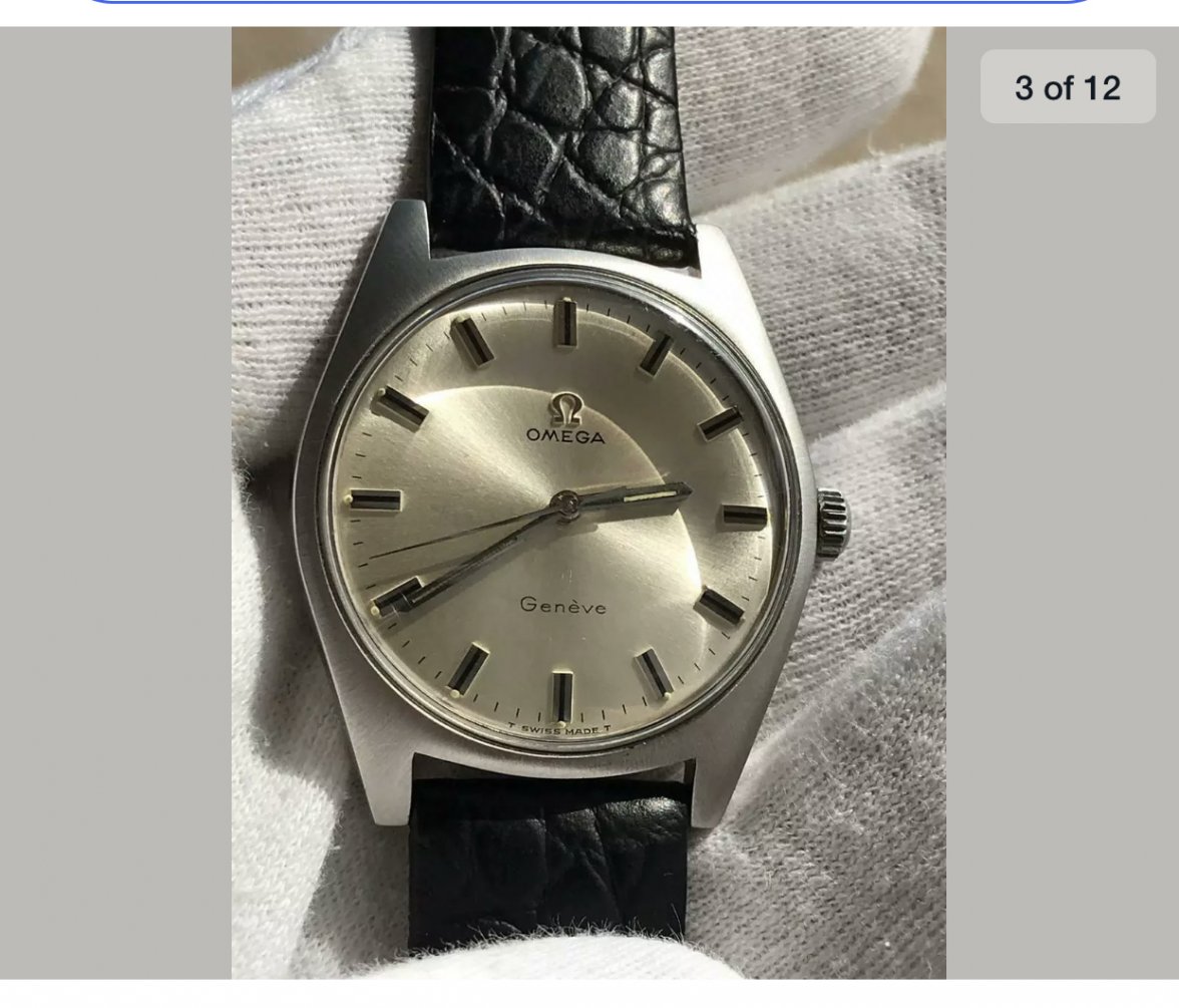

Hello guys! This is my first post here. So I just into watches and was looking to buy my first vintage watch. I was just coasting through Ebay and found this Omega Geneve for a good (not cheap not too expensive) price. However, for its age, the dial looks too good/clean to be true. Thus it makes me wonder if it has been redialed, or even worse reconstructed. If it was indeed redialed, do you guys think it’s still worth it, or if it’s a bad quality re-dialing? I’m in a dilemma here. I’m seriously considering buying this. By the way, the watch is a Geneve 135.041, from the late 60’s if I’m not mistaken. Thanks guys!

Dial looks ok to me at first glance. Has the serial number been damaged, or is that just something done to the photo?

Everything looks good. The Geneves are very often in good condition. in any case, I come across them very often. In my opinion, there is nothing to rush into.

Dial looks completely original to me. As Concer said, not uncommon for one of those Genèves. All the more reason to actually buy a good example like this one. The only weird thing is the serial number.

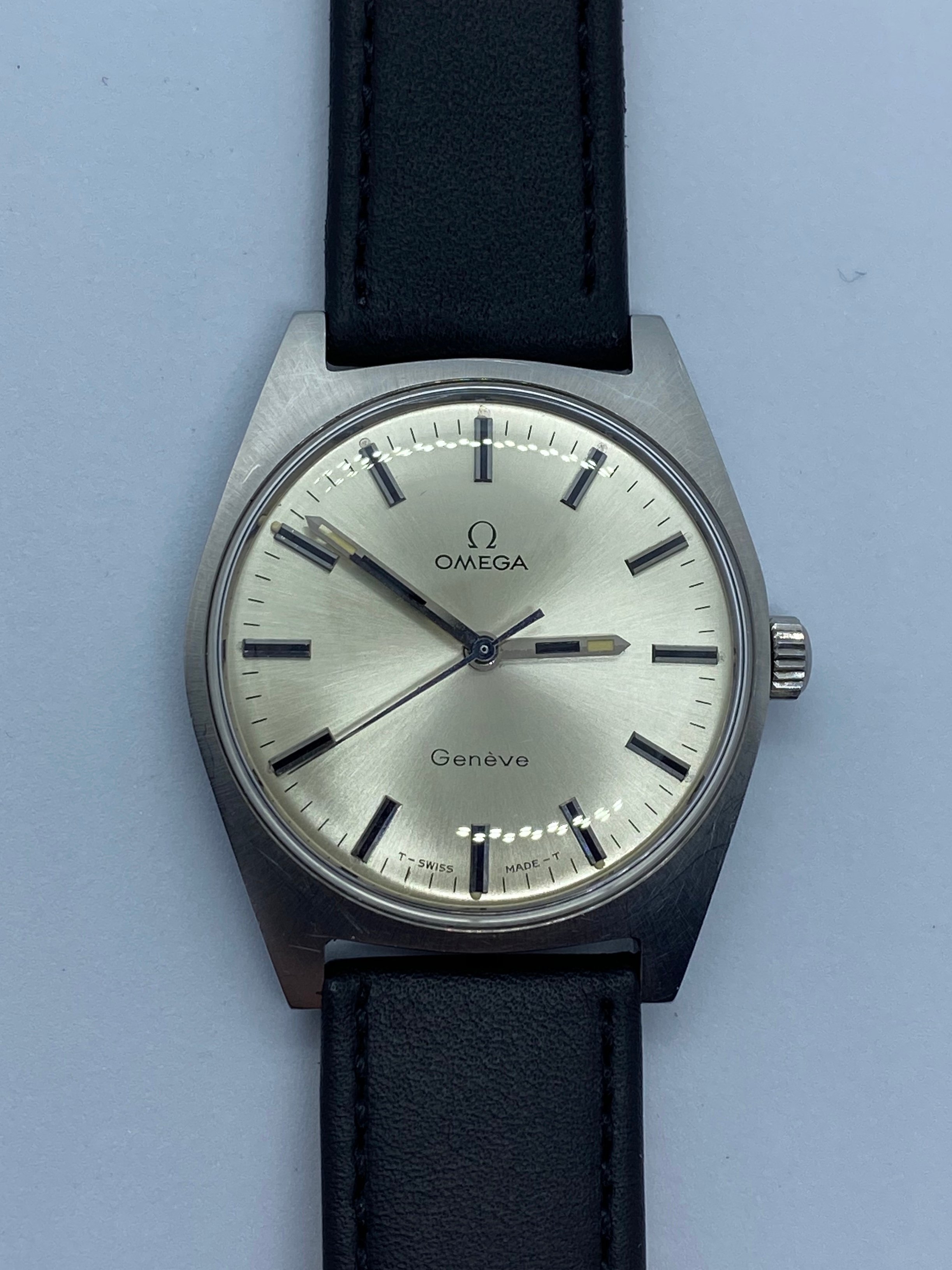

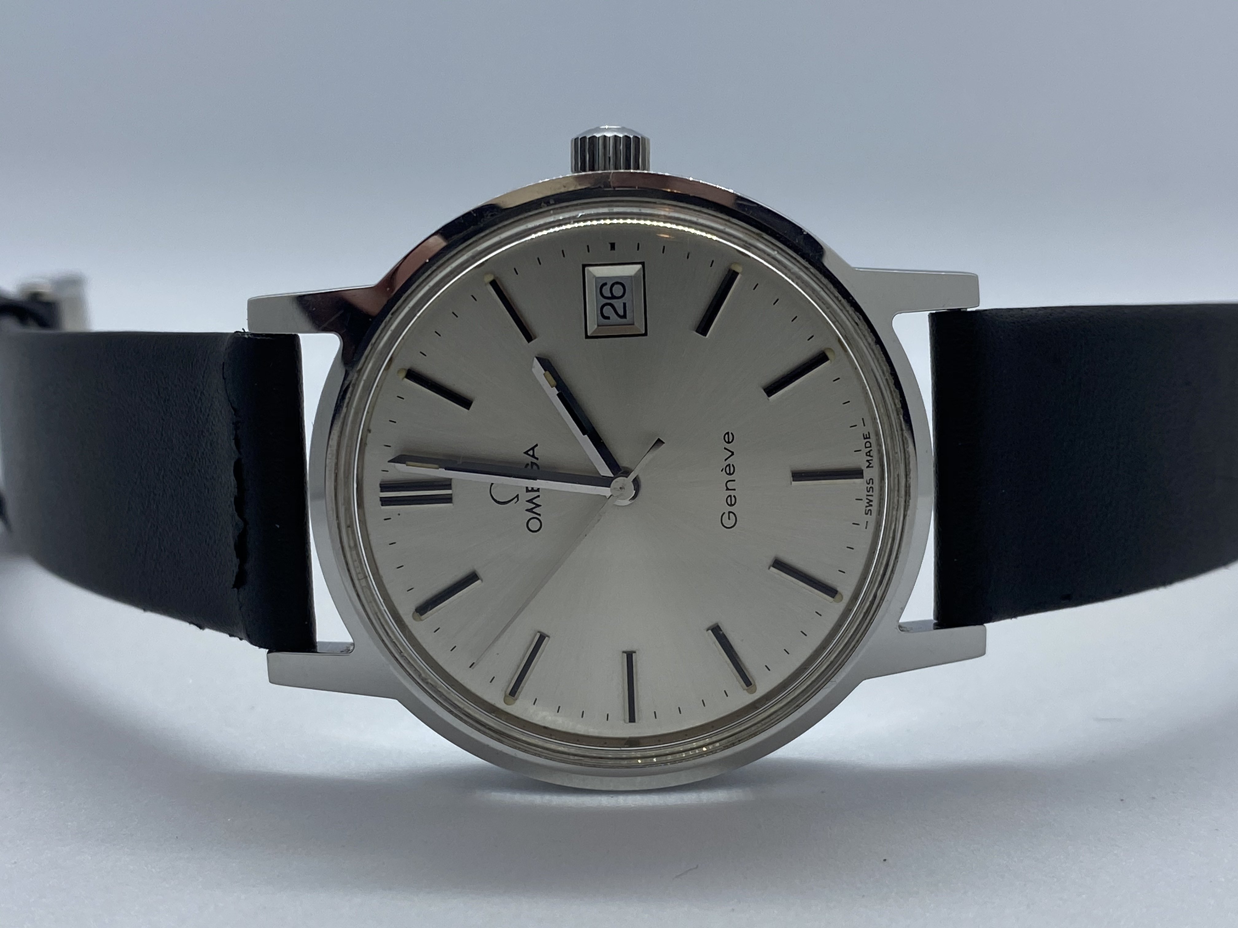

Here are two examples of Genèves I had and sold in the last couple of month - found both within a few weeks of searching for a reasonable price. I’d say both dials are pretty close to pristine.

Thanks for the reply! I can’t say for sure, I’ve asked the seller but he hasn’t replied. I hope it’s just the photo...

Good to know that the dial looks good! Yeah, I see a lot of them being sold on Ebay, however, this particular seller offered me a pretty decent price. Thanks for the reply.
Those are beautiful looking watch! Love the one with the date window. Yeah, I’m guessing that the Geneves are not really in high demand, that’s why it’s pretty easily available anywhere. Thank you for the input!

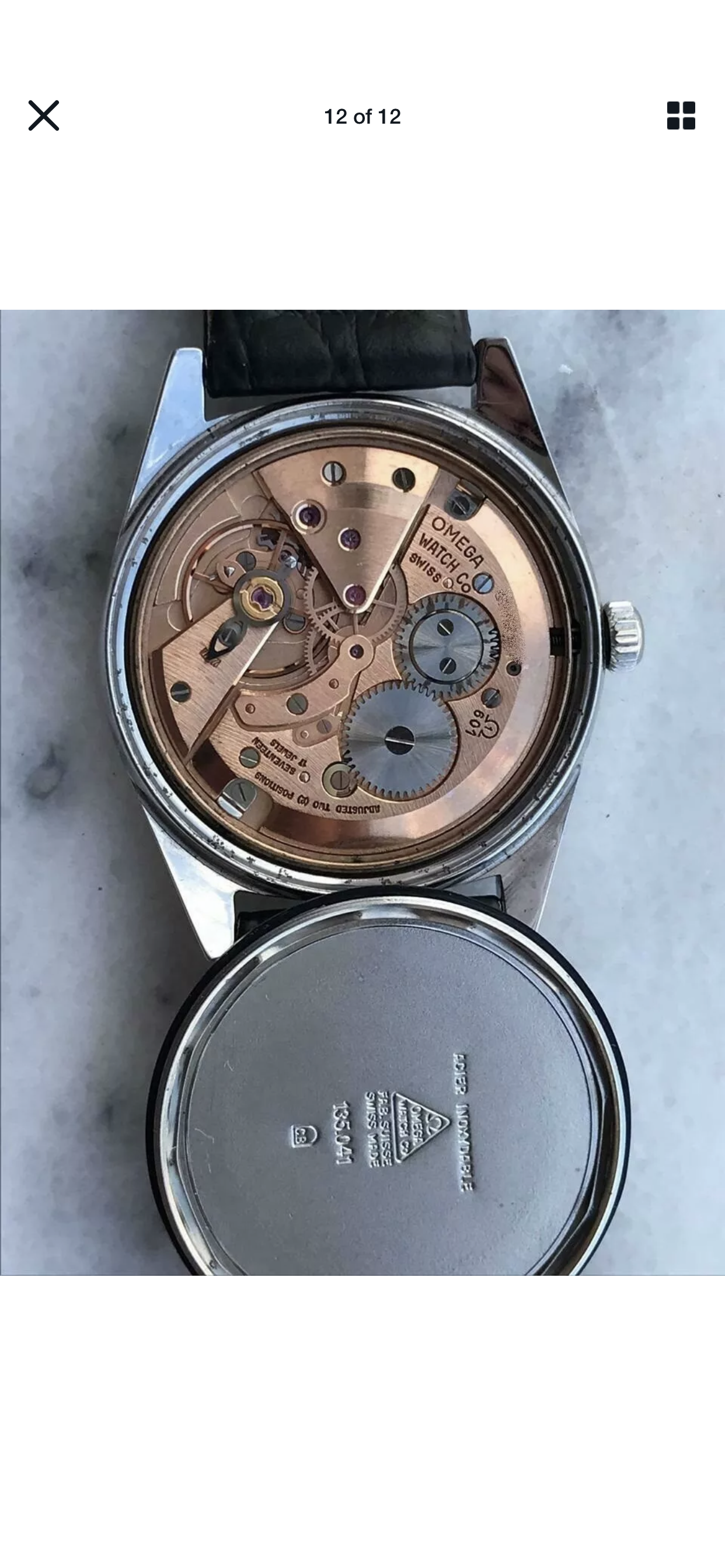

A nice example of an entry level model. These are not rare so there will always be another along, I too would go for an auto. I note the case and movement has some pitting so while very nice, this one isn't perfect. The lack of serial is a major concern, if it has been photoshopped to hide it then that is fine but if it has been physically removed (and that is how it looks) then walk away.
Thanks for the advice. Just out of curiosity, are there any legitimate reasons why someone would remove the serial number? Was it once stolen, or could it be a counterfeit product?
I can’t think of a legitimate reason. These are from before the days of grey imports so I doubt that would be the motivation like it might on a 1990s watch. Theft, insurance fraud, bodged repair and Frankenism are all less legitimate reasons. It won’t be a fake, it would cost more than the watch is worth to fake it that accurately.
On a more prosaic level, it is very important to some of us to date their watches. You can’t do that accurately without a serial number. I won’t touch a watch without serial.
That’s really interesting. I’m heavily reconsidering of getting the watch now. Thanks for the advice, padders! I learned so much just from my first post here.

I’m a fan of the 041s and the 601 movement. They make for good entry level Omegas and this one looks good. Nice case, dial, intact lume, etc. Not sure if it was resolved earlier but I can’t tell if the SN was actually physically removed or if the photo was edited. Some folks are quite sensitive/paranoid about posting SNs online. I’d ask the seller for an additional movement picture. If it was removed, I’d walk away. Good luck!
