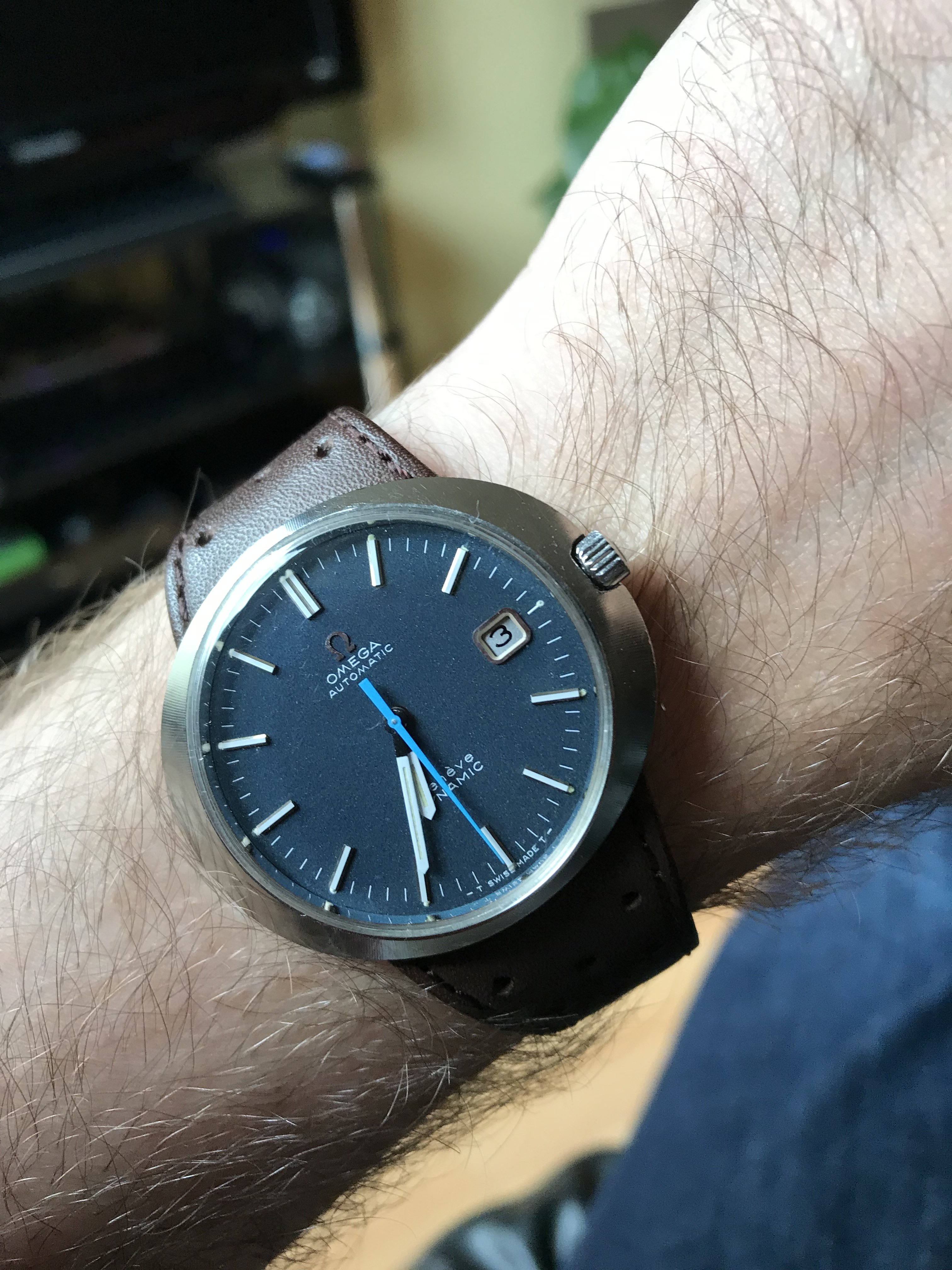

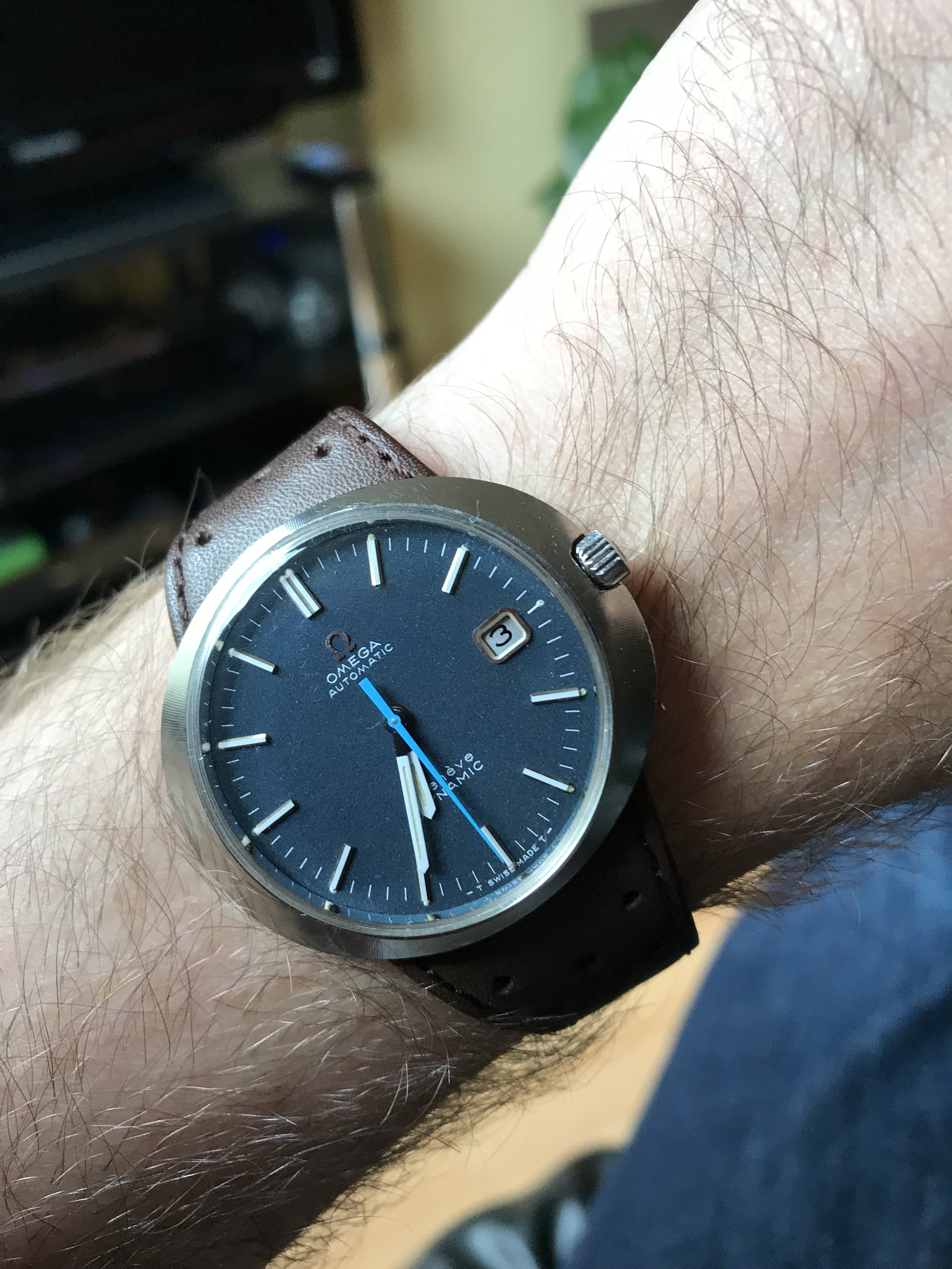

Here's my Royal Blue Mk I:

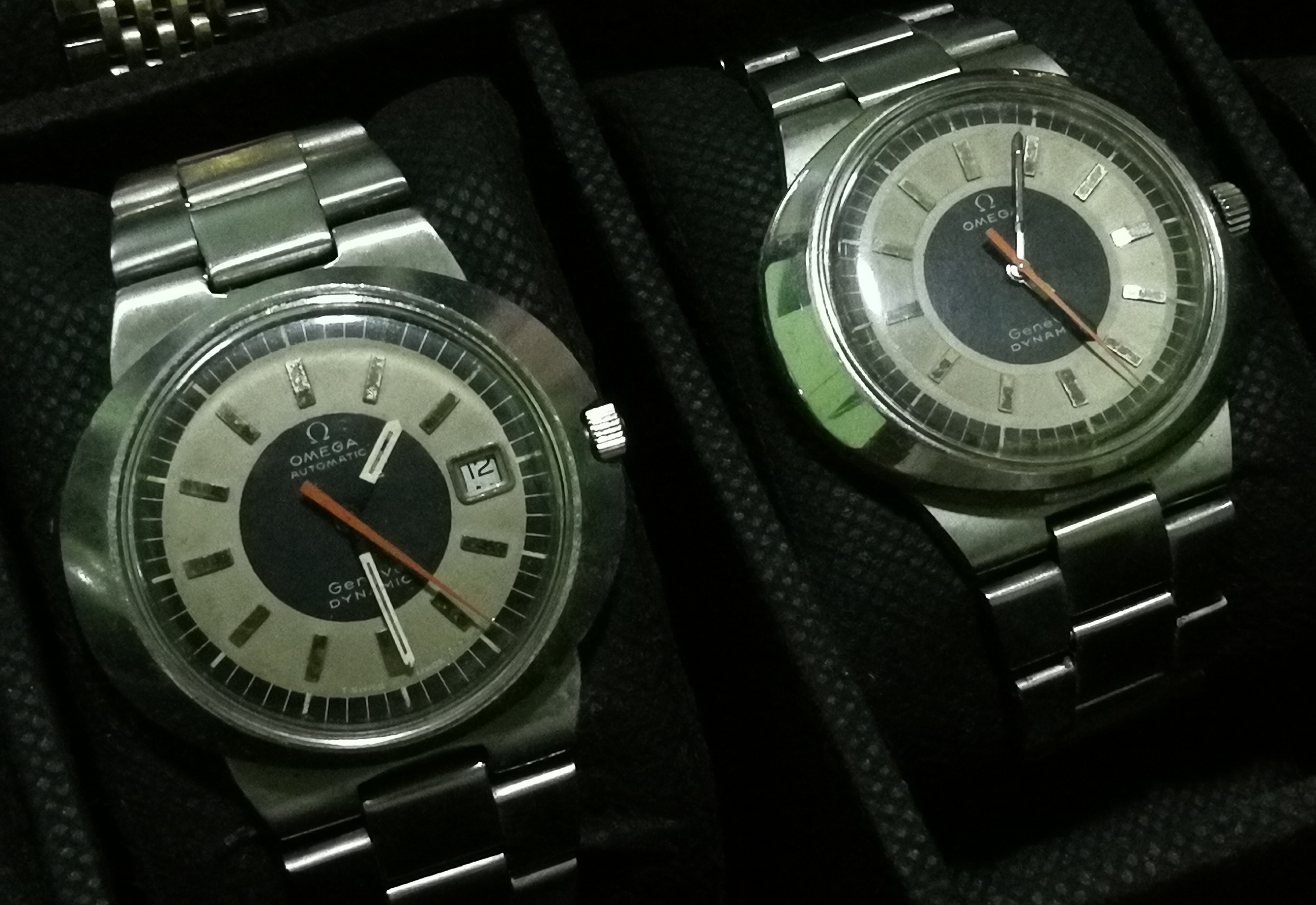

there were over 1000,000 Dynamics produced in their lifetime..It proved to be a pretty popular watch. Personally I'm a fan of the first generation ones from 68-71 ish. The case was less chunky and had better brushed finishing. The dials were indeed often variations on Bullseyes and they came with added day and date complications. Particularly hard to find are red and green dials. Time hasn't been great to a lot of these dials , especially the lume on the indices, they are prone to flaking off. The 565 movement is generally accepted as an Omega classic. By the time the last dynamics were coming out Omega was just about to stop fitting their own in-house movements. The Quartz revolution was in full swing.

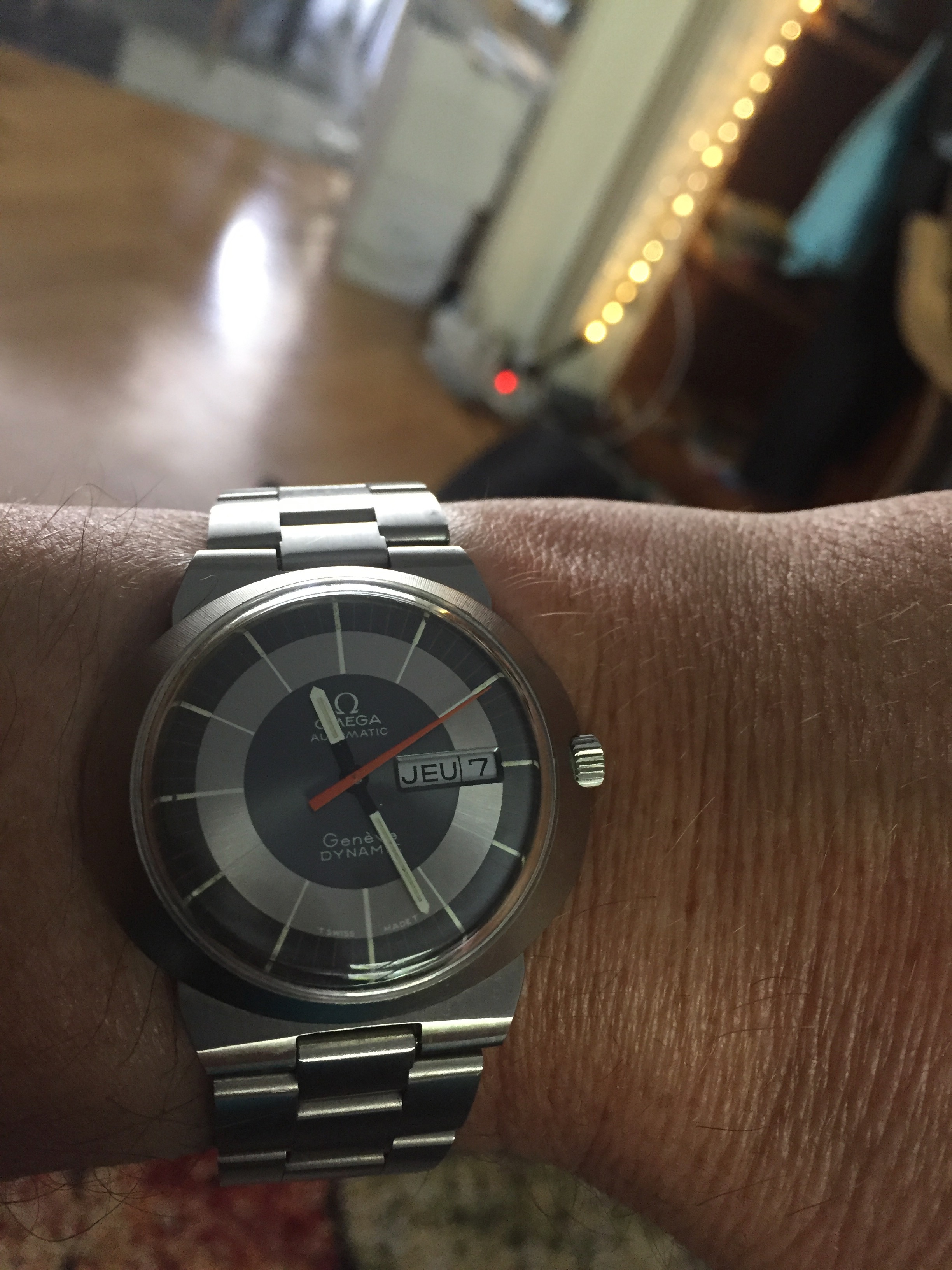

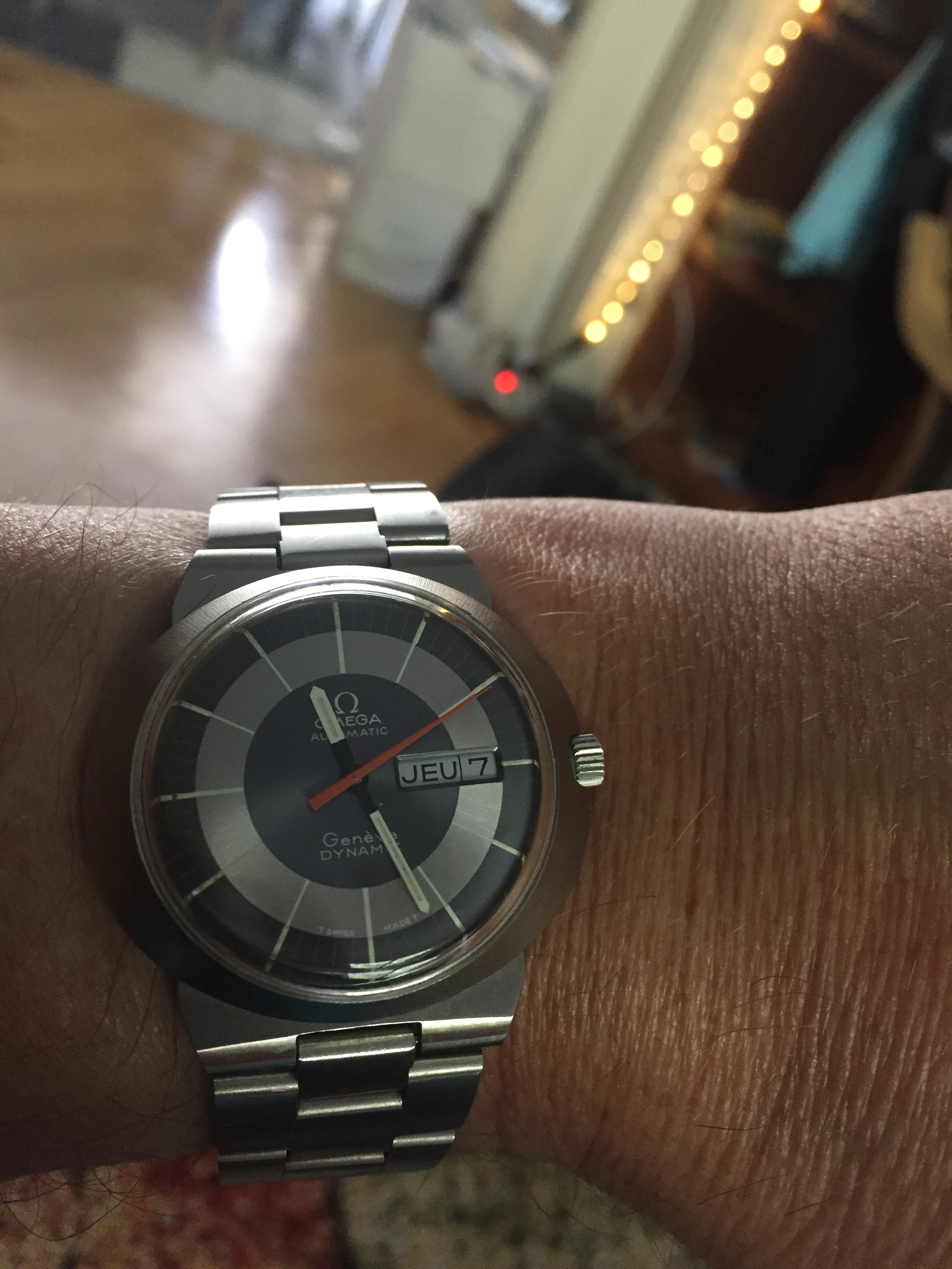

Soem folk like the later generation dynamics with their spider web design (amongst others) but they don't do it for me. I found this one on eBay.fr about 3 years ago. It needed fixing and the price was too good to pass up . People are asking a lot of money for them nowadays , but as they are plentiful be patient to get an original one. Also be aware that this is a model is often sold as a redial.
