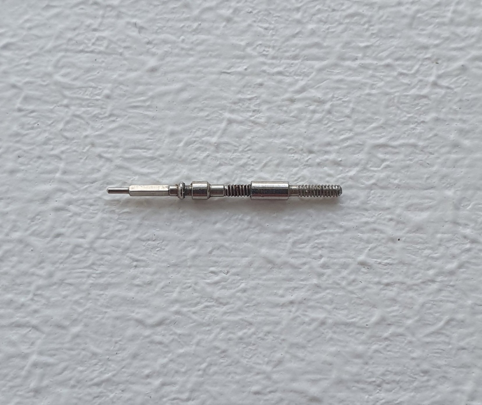

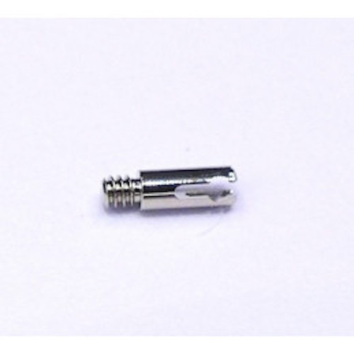

This is the stem fitted.

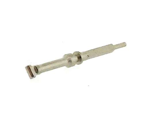

That's not the right stem.
You need a split stem and crown. Sorry I'd don't have the part numbers.

For the Dynamic - female stem part number is 081ST9992. I don't see the male stem part listed, so that's odd, but this should have a two piece stem.
For the 135.033 the case tube is part number 090ST0002, and the crown is 069ST42528.
I'm guessing the stem that was fitted is the regular Omega 1106 listed for this movement.
I've managed to source the correct crown (069ST42064) and have ordered the female stem. Just the male to try and source now 馃槙
