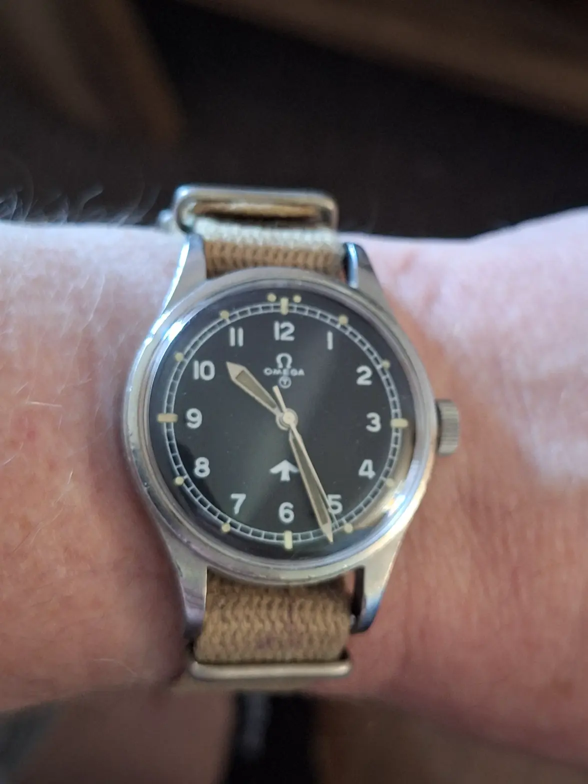

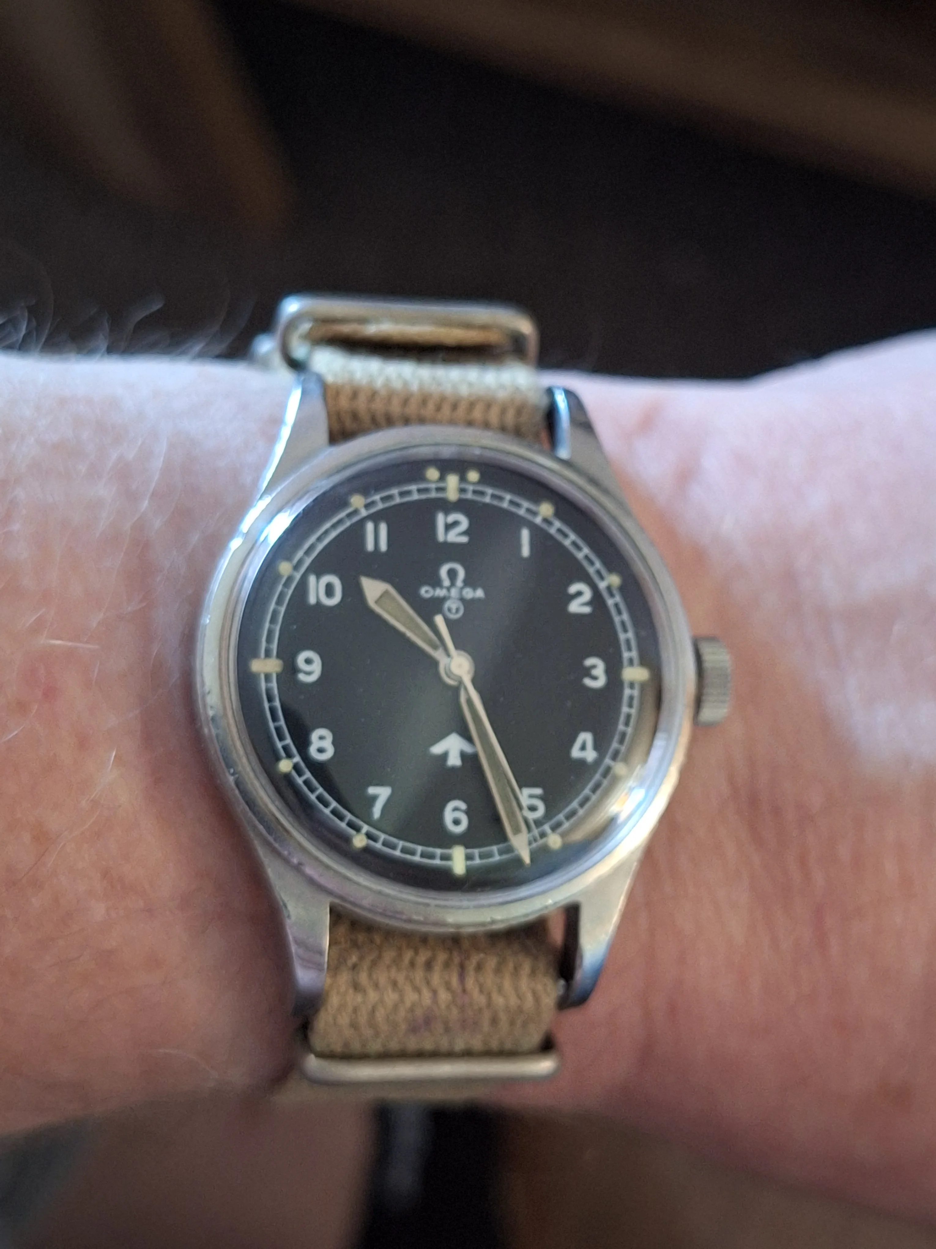

It's NOT a Dirty Dozen. It doesn't look like an Omega case, and the hands are wrong. But the movement and dial look like they are from an RAF/RAAF Omega 53... and that type of early dial is relatively rare! Here's my '53 with the later dial.
