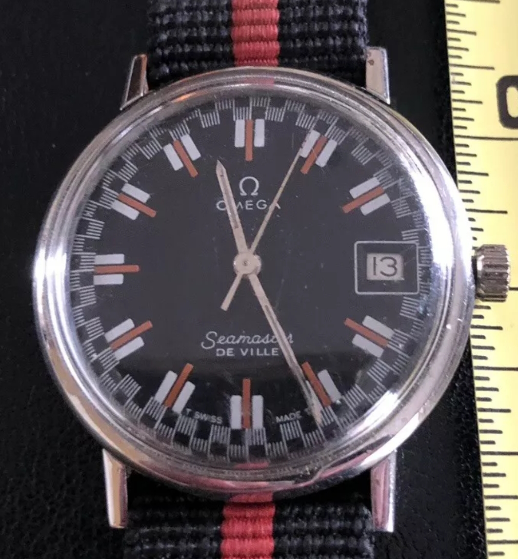

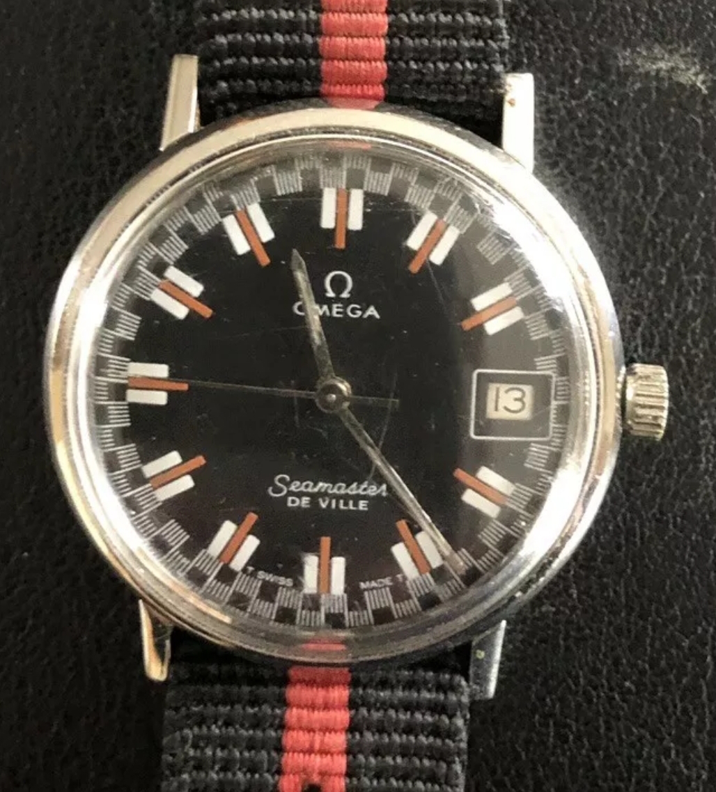

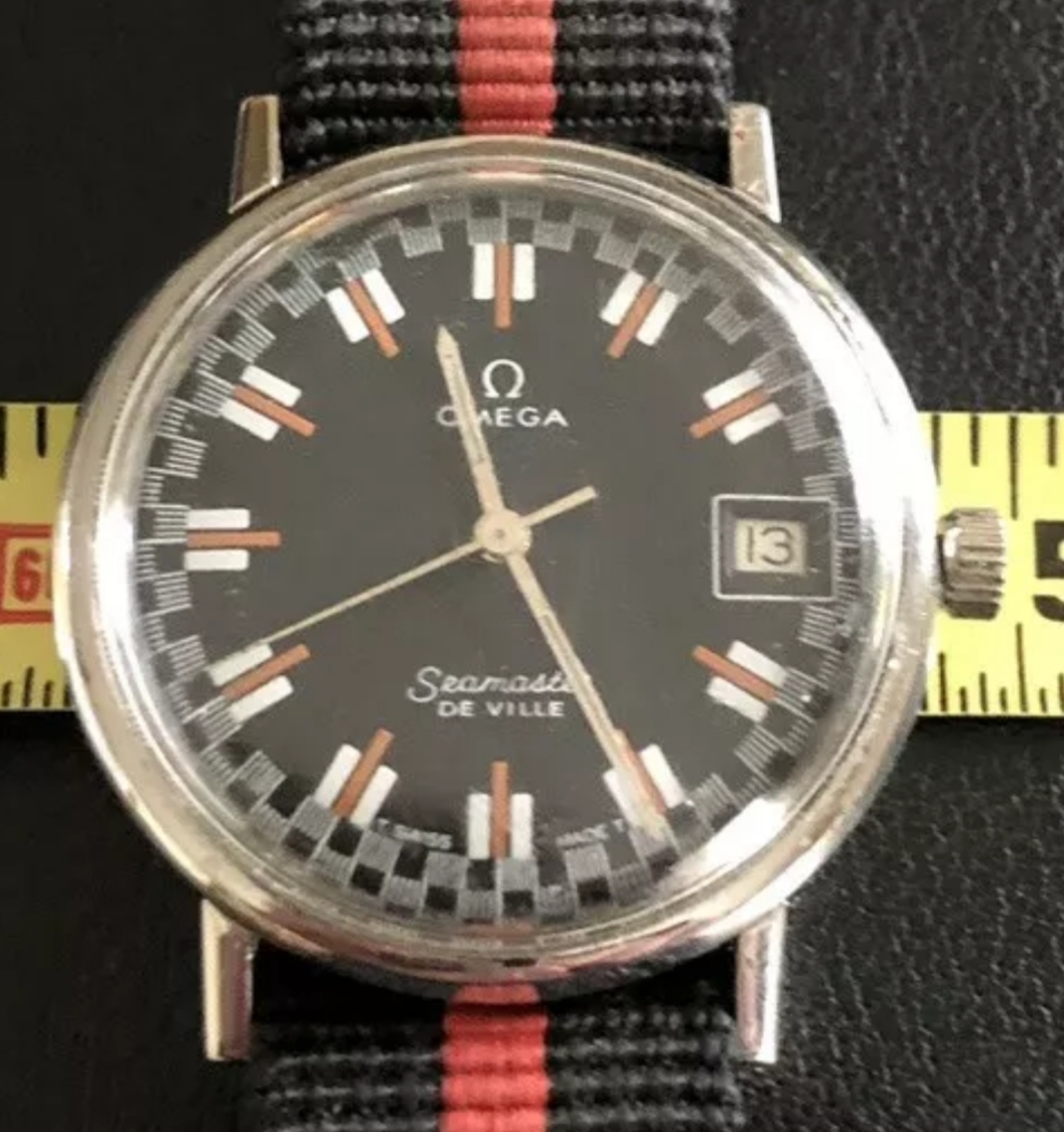

Hi All,
Was hoping to get your opinions on what's going on with this watch? Looks like a De Ville case but a Dynamic dial. The hands have lume but the dial doesnt seem to have any so guessing this is some sort of franken. I haven't been able to find any watches with this dial saying De Ville instead of Dynamic though so wondering if anyone could help me identify what's here.
Seller wont open caseback so this is all I have:
13,493
31,812
Horribly over polished case and an imaginative redial.
339
145
I’d have to agree on the dial. I haven’t seen anything like it before. However omega has done some stranger limited run stuff for individual contracts, companies, etc. if it were me I’d stay clear at the moment.

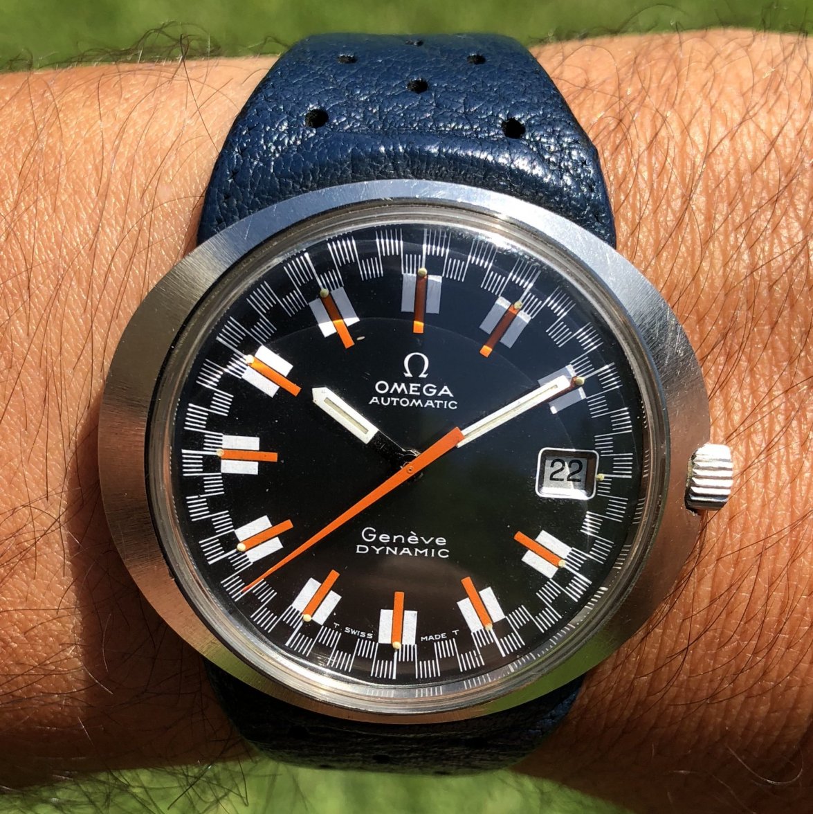

Compare the print quality on OPs watch with the real deal.
