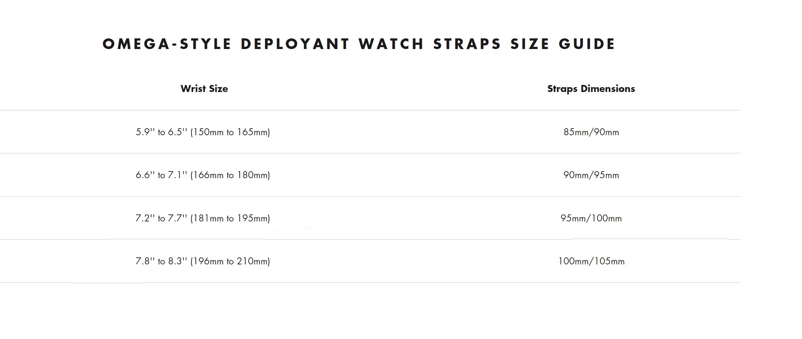

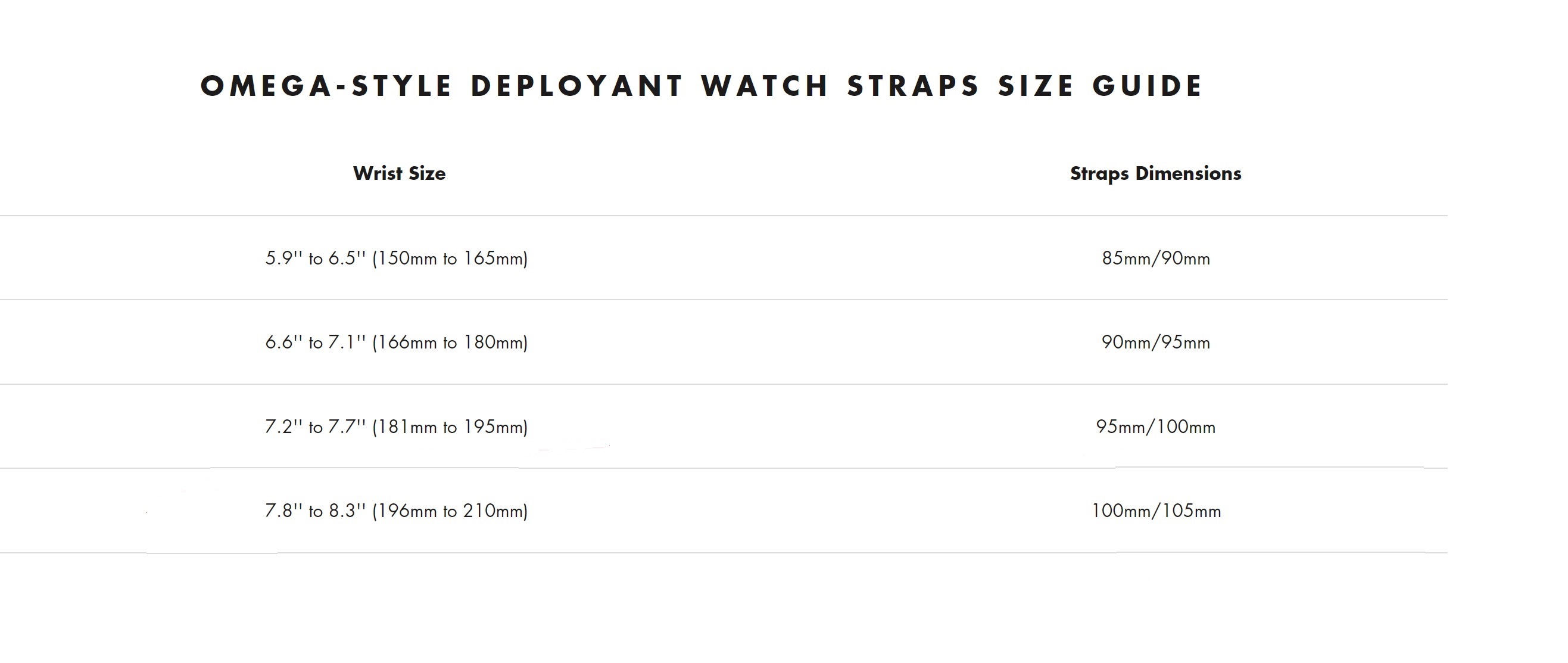

2) I know you cant use any strap and the omega ones are really expensive. I found a few companies (mill handmade, delugs, and genteel) I am most leaning towards delugs because I Know the quality is great and genteel is twice as much. I'm having trouble with the measurements needed for my strap. From the genteel website is says the length I should get is 95/100 mm but I have also seen a lot of other measurements. My wrist is 190mm so if anybody can help with that it would be greatly appreciated.

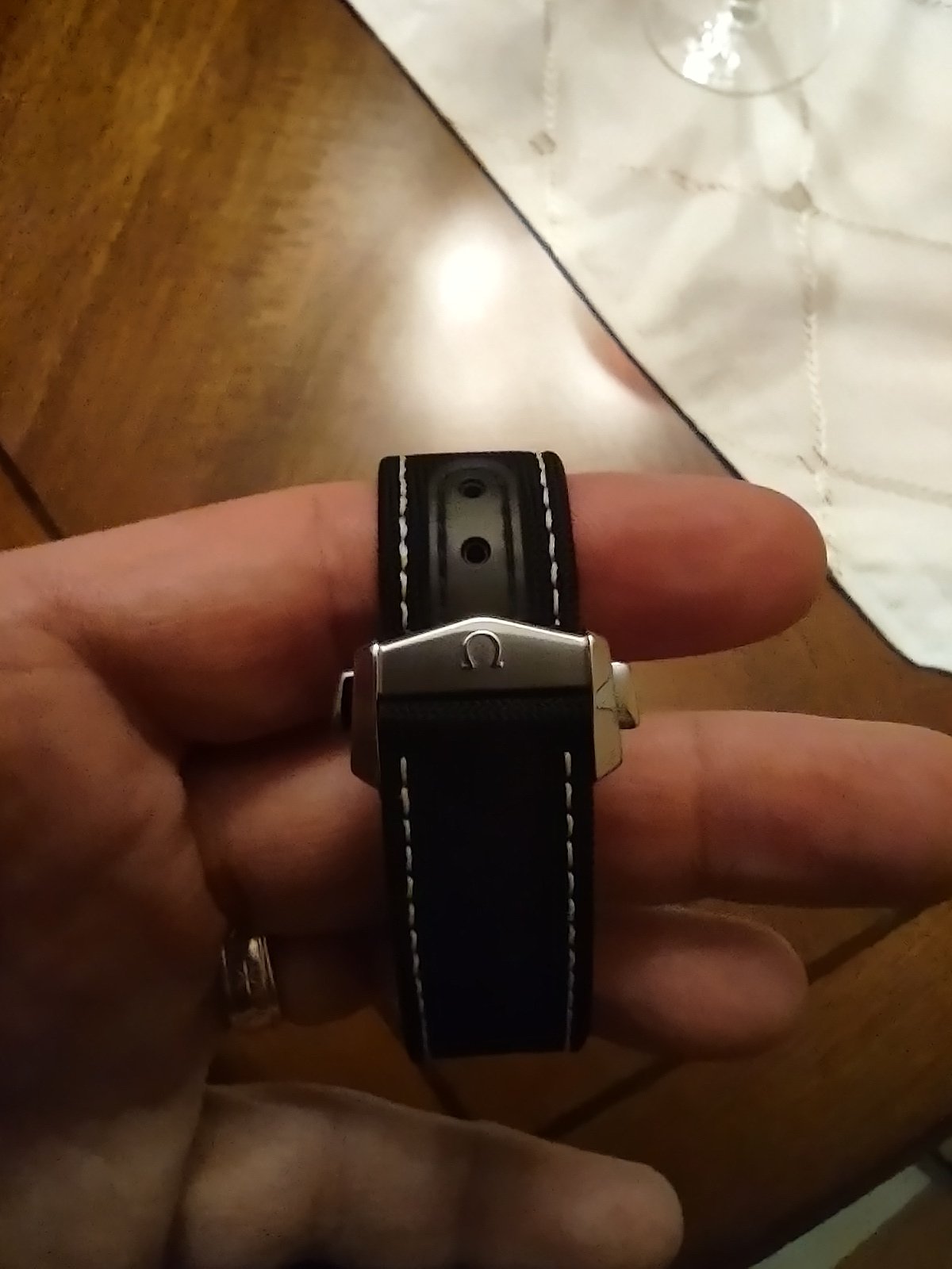

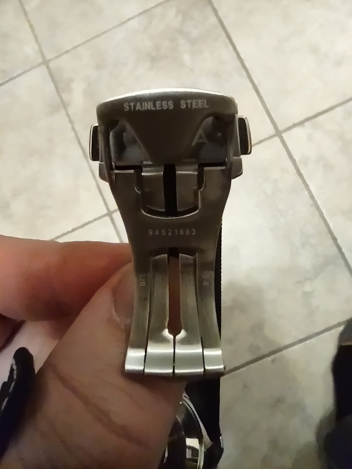

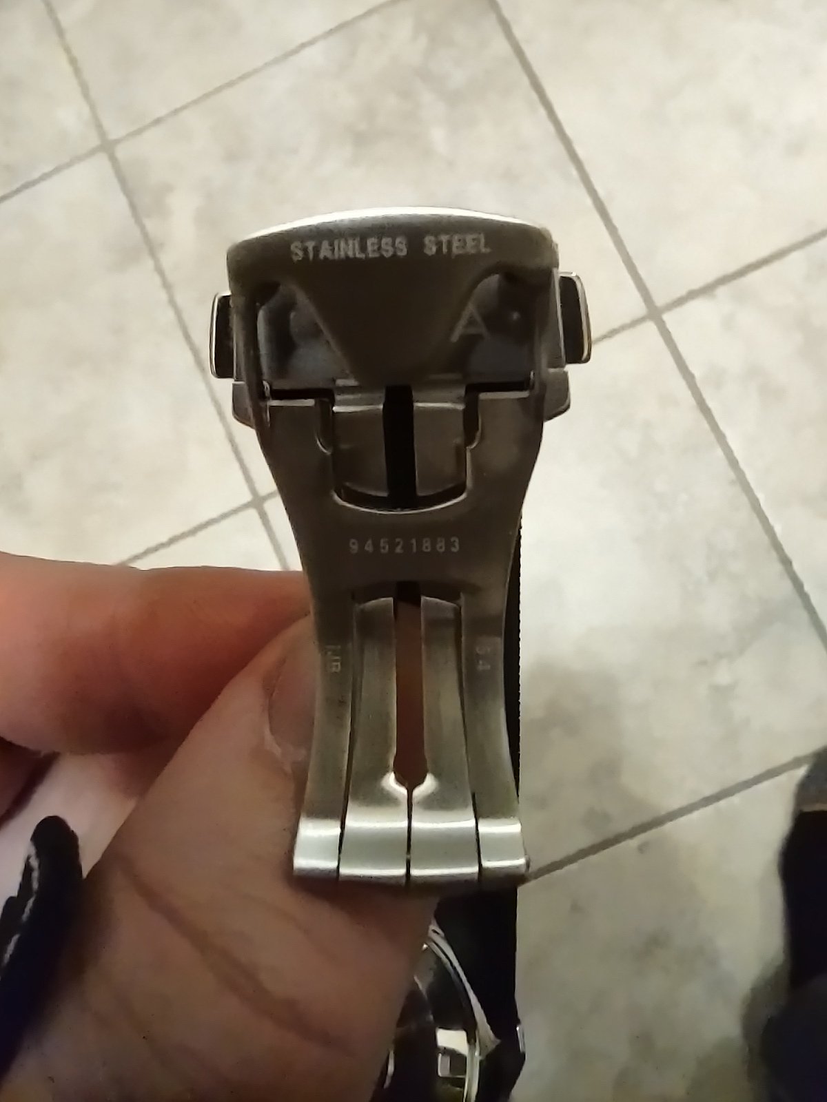

They make 2 different thickness. The one I have is 9452.18.83 which is 18mm wide. It also is slightly thicker at 2.7mm. The other size is 2.5mm. This one fits the Genteel fine, and the extra thickness also goes well with something a litter thicker like a Silver Snoopy strap. The thicker one is more versatile. My wrist is 185mm and the 95/100f fits just fine.

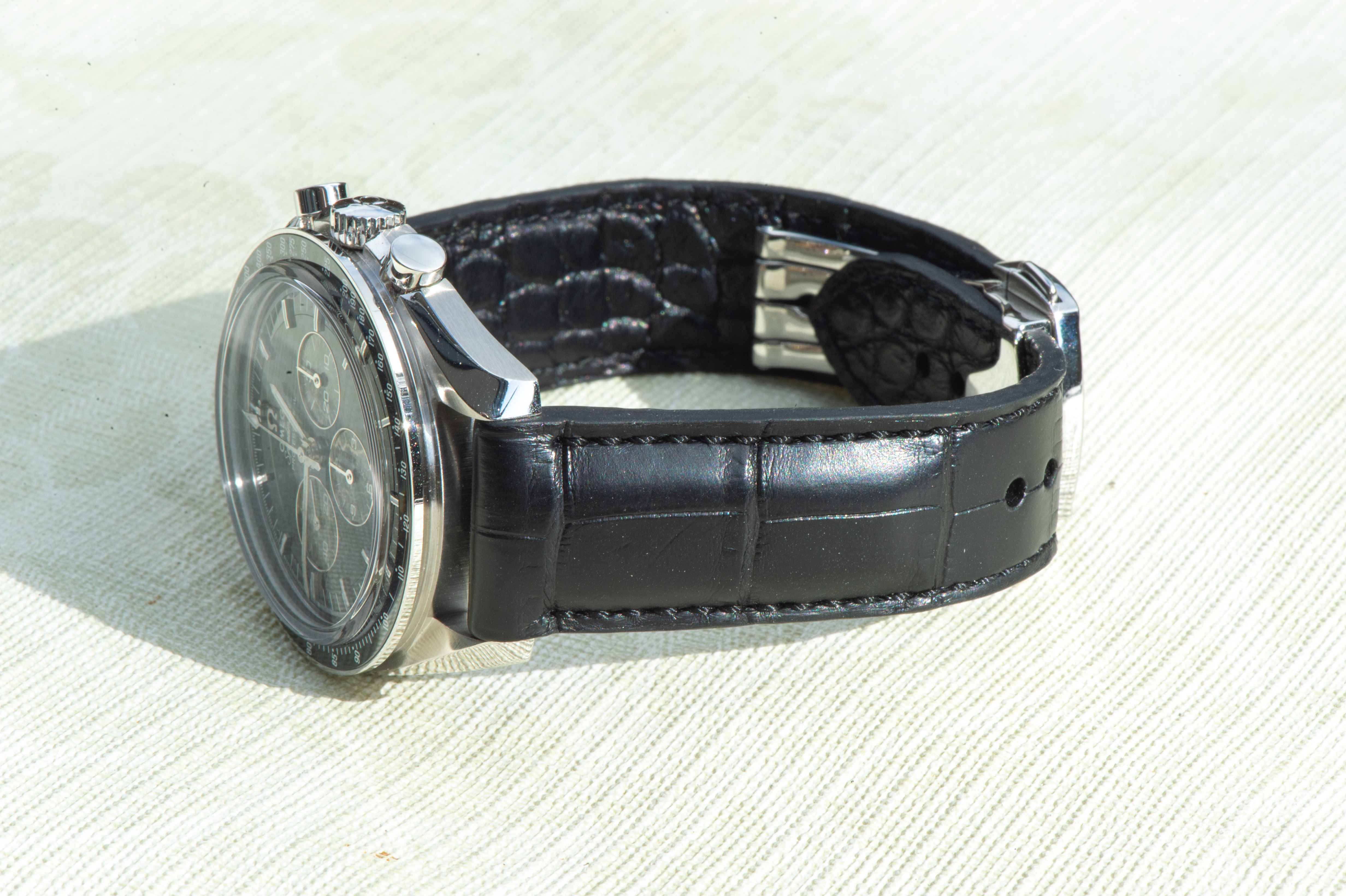

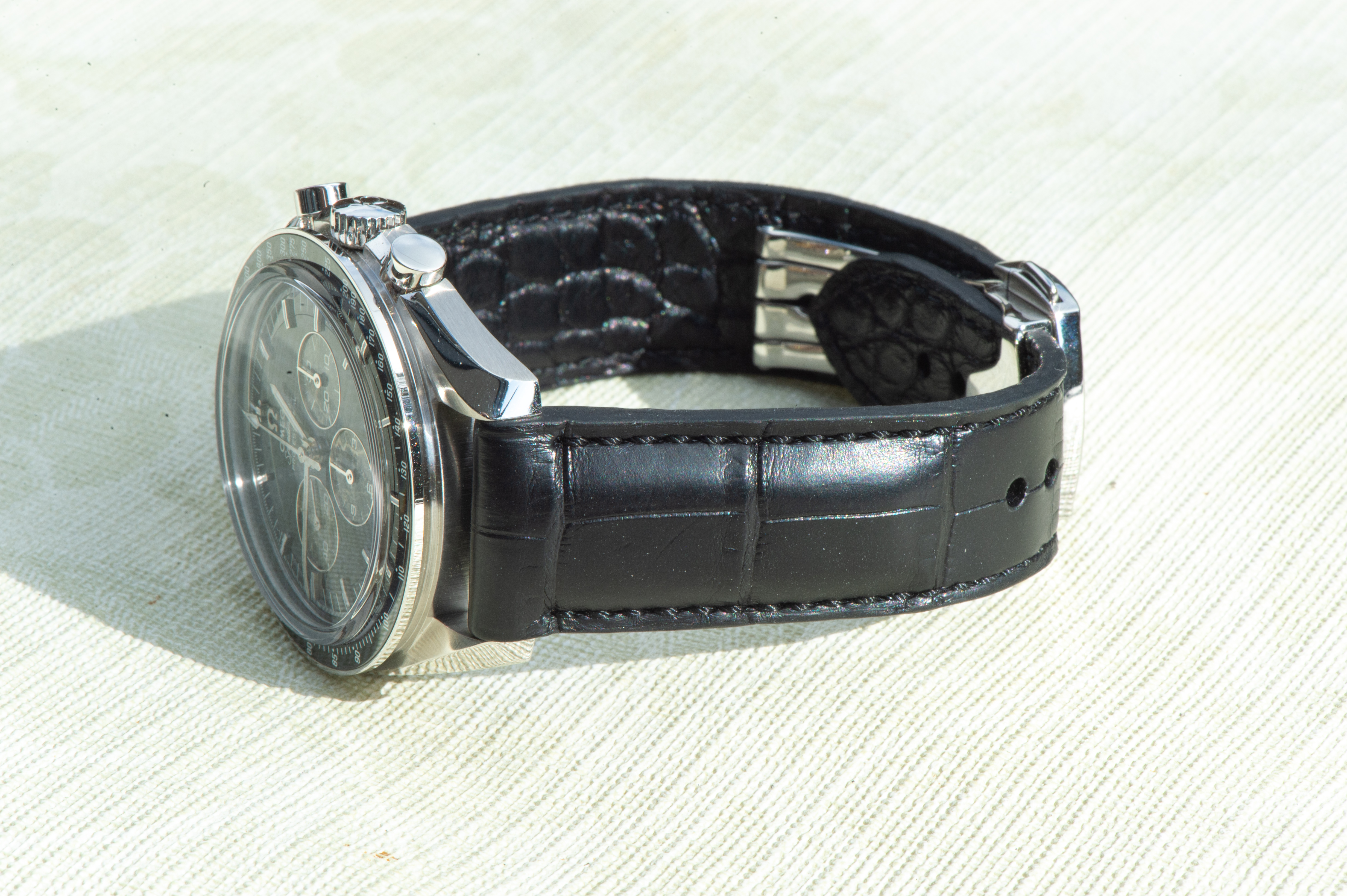

Ad. 1 - don't know reference numbers, but there are 2 types of clasps at each size - polished & brushed - make sure you chose correct one.
Ad. 2 - if you look at photo below - the left part is different than standard strap - has no place for the pin and no keepers on the buckle side. The quality is immaculate though.

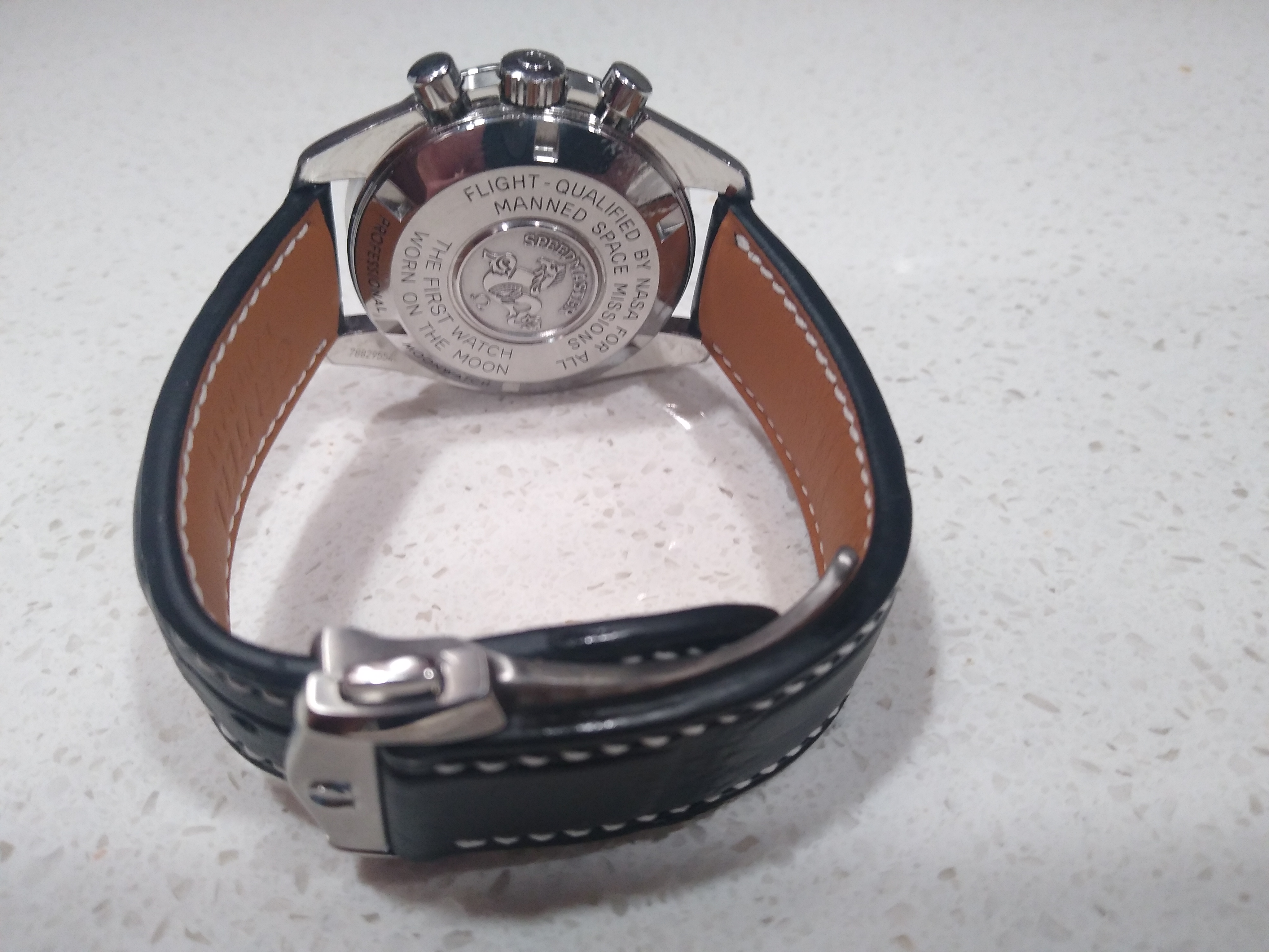

On the photo below you can see previous version of polished clasp at 18mm. Apparently I got this when buying my Globemaster and I won't use it so could be for sale at some reasonable price.

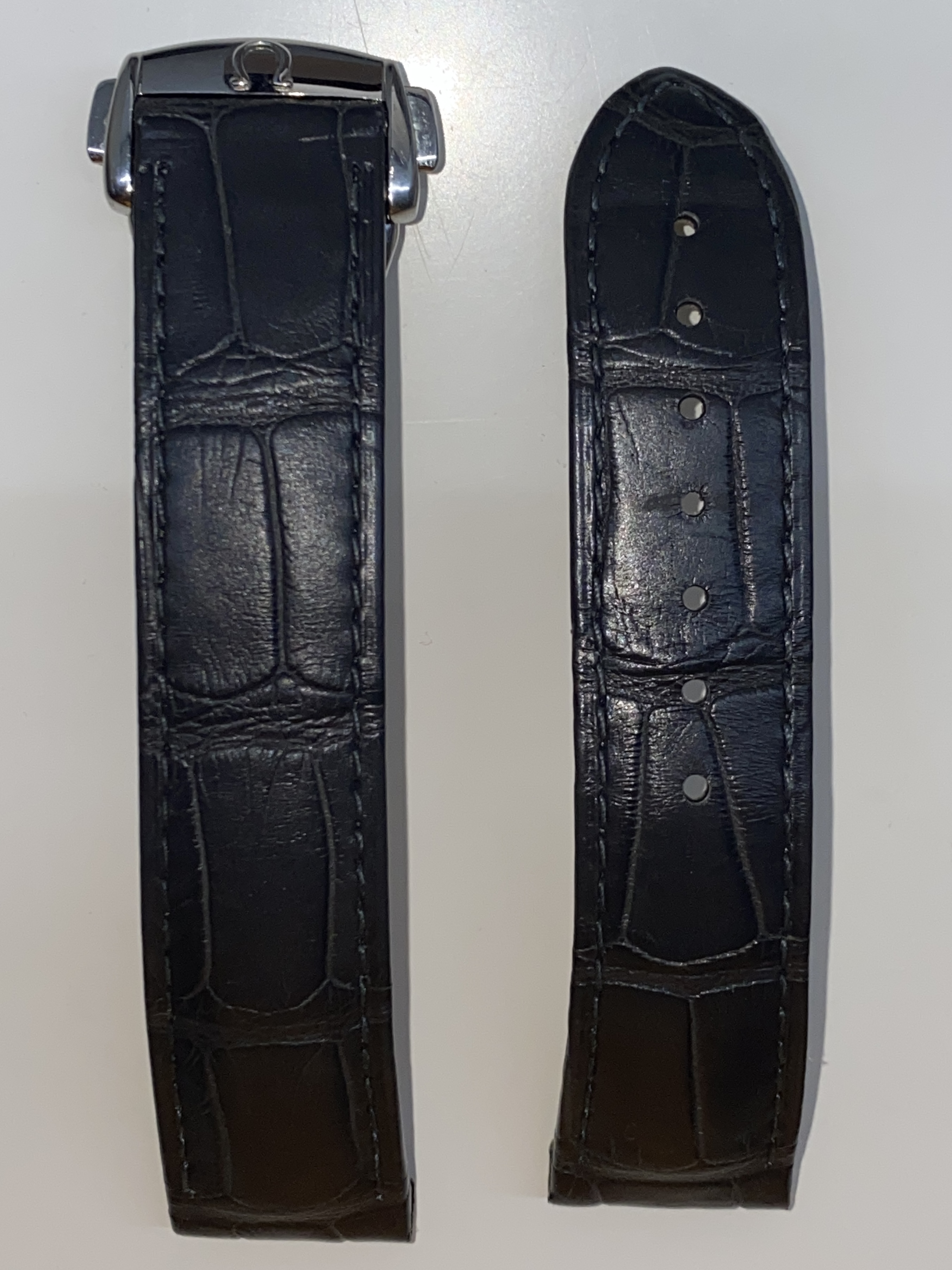

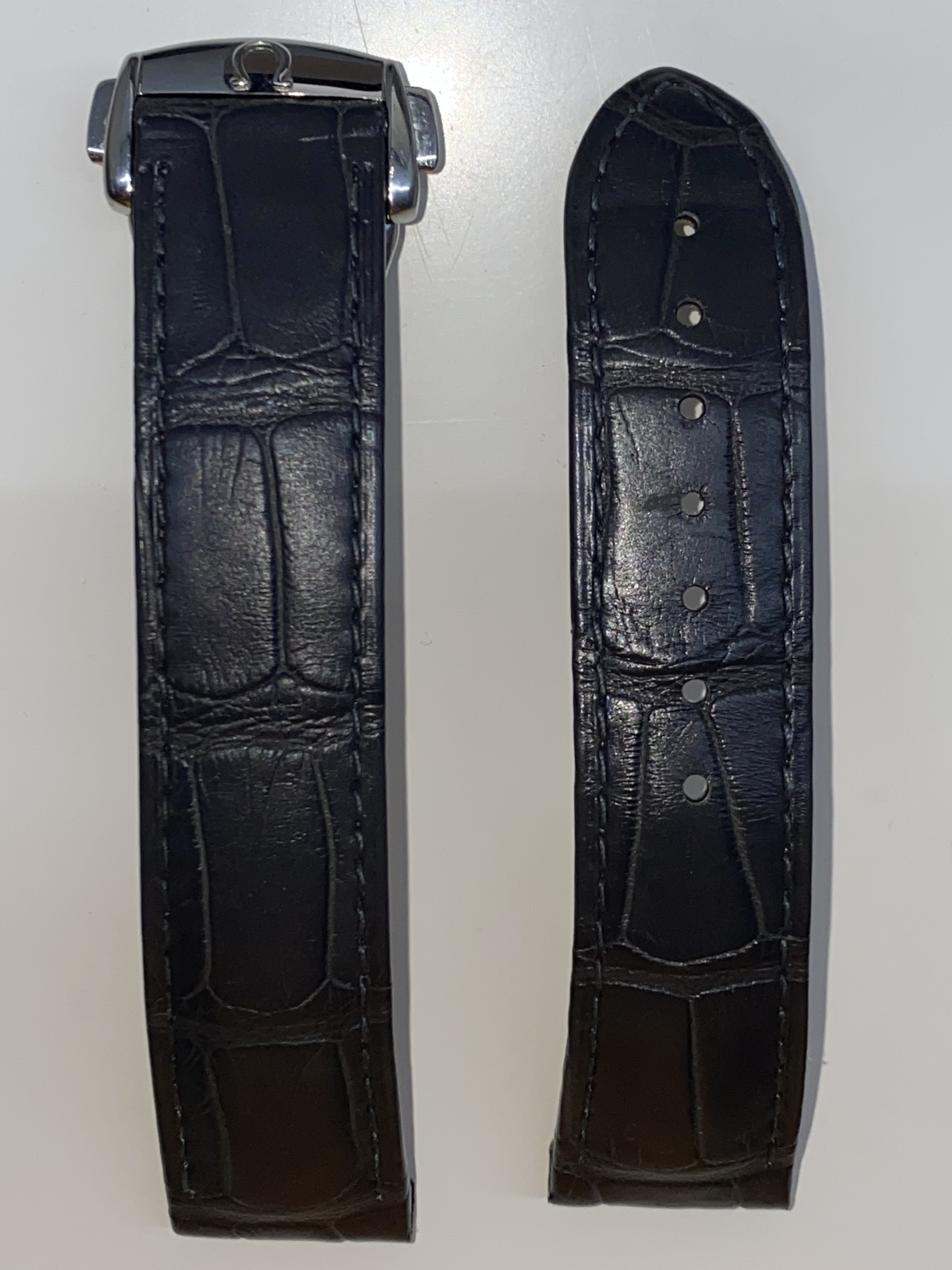

You're referring to the 20mm-18mmm strap, correct? That would mean 20mm at the watch end and 18mm at the buckle end which fits the OEM leather deployments.
