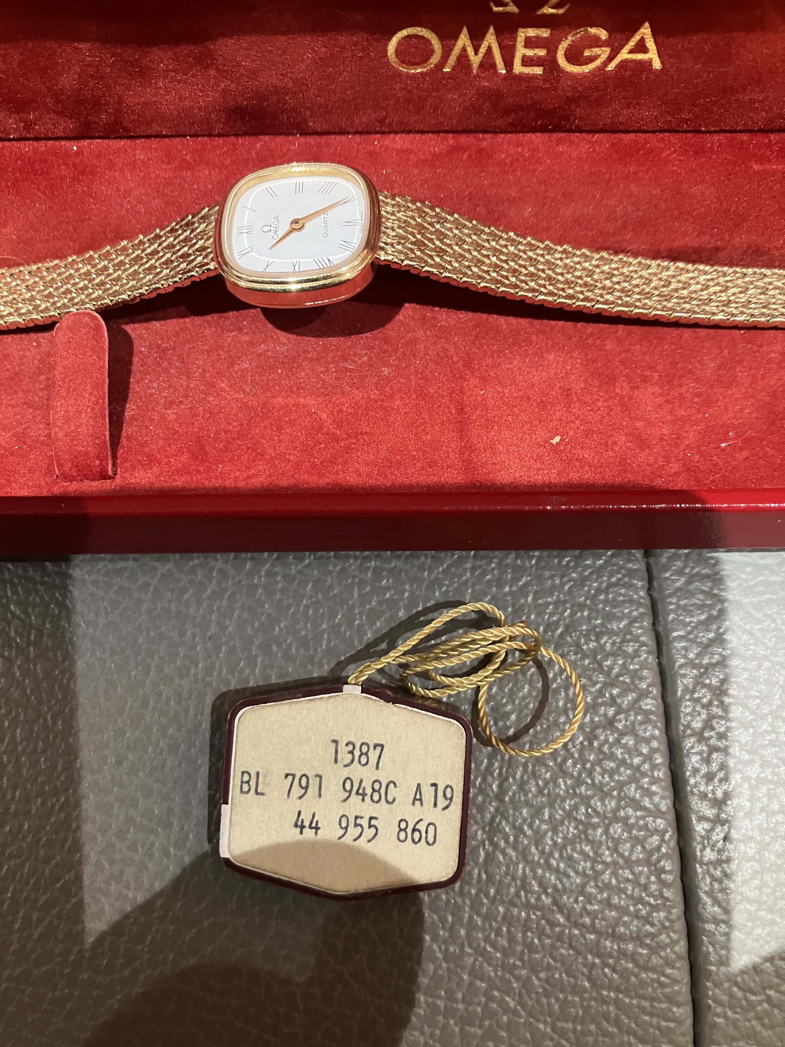

Morning All, could anybody help me with this matter?
My wife’s Omega watch needed a replacement battery so we took it along to a reputable local jeweller to do.
Unfortunately he advised us that the part to adjust the time is now missing.
The watch is working perfectly with the new battery but we can’t adjust it to the correct time.
Would anybody know the part # we need to repair?
I’ve been in contact with Omega Switzerland but they want me to send it to them at an eye watering cost.
I think the part we’re looking for maybe called a “pusher “ Any suggestions would be greatly appreciated.Thanks.Carl.

Hi Carl, maybe you can tell us where you are located so a forum member can recommend a watchmaker near you who can put the missing piece in place. I don't think this needs to go to the Omega mothership. If you know of a watchmaker (not a jeweler) in your area, try to get a quote from them.

The model in the photo showing the tag apparently is incorrect it should show 591948C and not 791948C as it shows on the tag.
