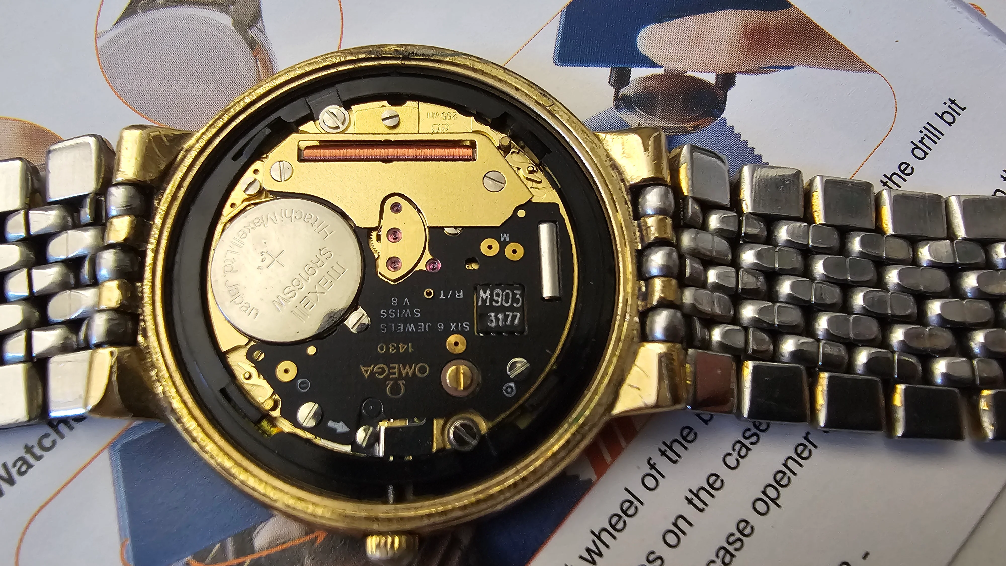

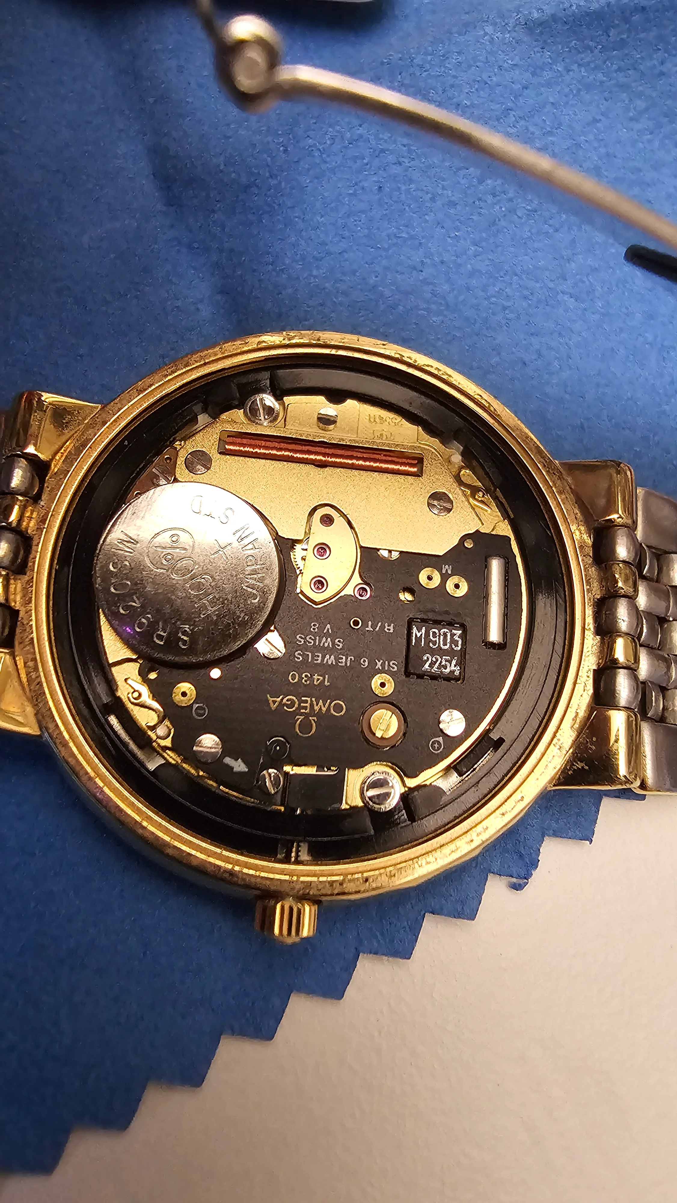

I have two Omega de Ville model DL 396 1012 watches, both of which have different batteries. Can anyone advise me which is correct?
One has the SR920W and the other has SR916SW. The SR916SW has been in my watch and worked fine for years, so I'm assuming that someone has put the wrong battery in the other watch with the SR920SW. Am I correct about that? The SR920SW seems to be too high.
Any help would be appreciated.
31
106
Correct. The 373/SR916SW is the one you need, the other one is indeed to big.
Thank you. I appreciate your help.
