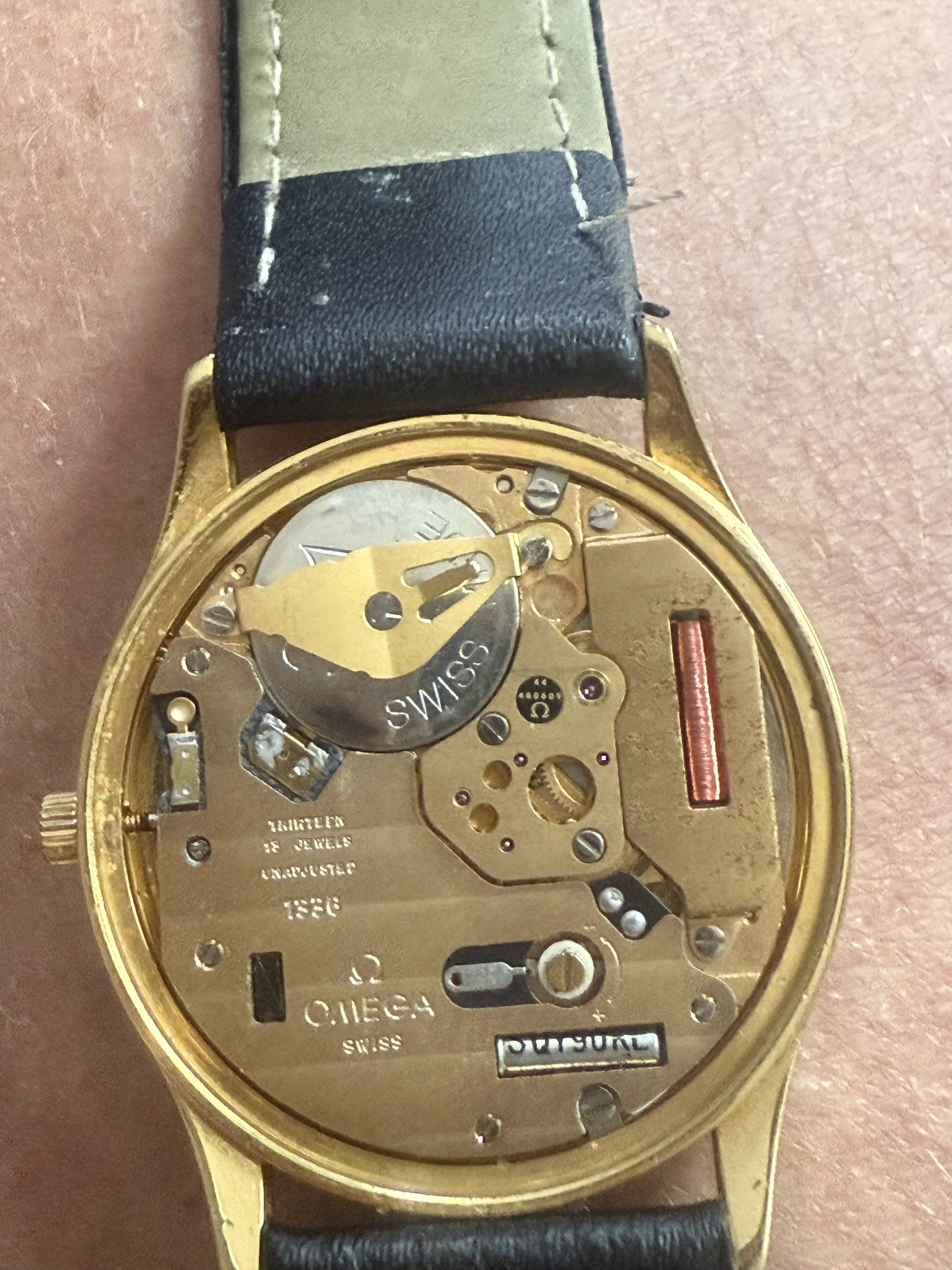

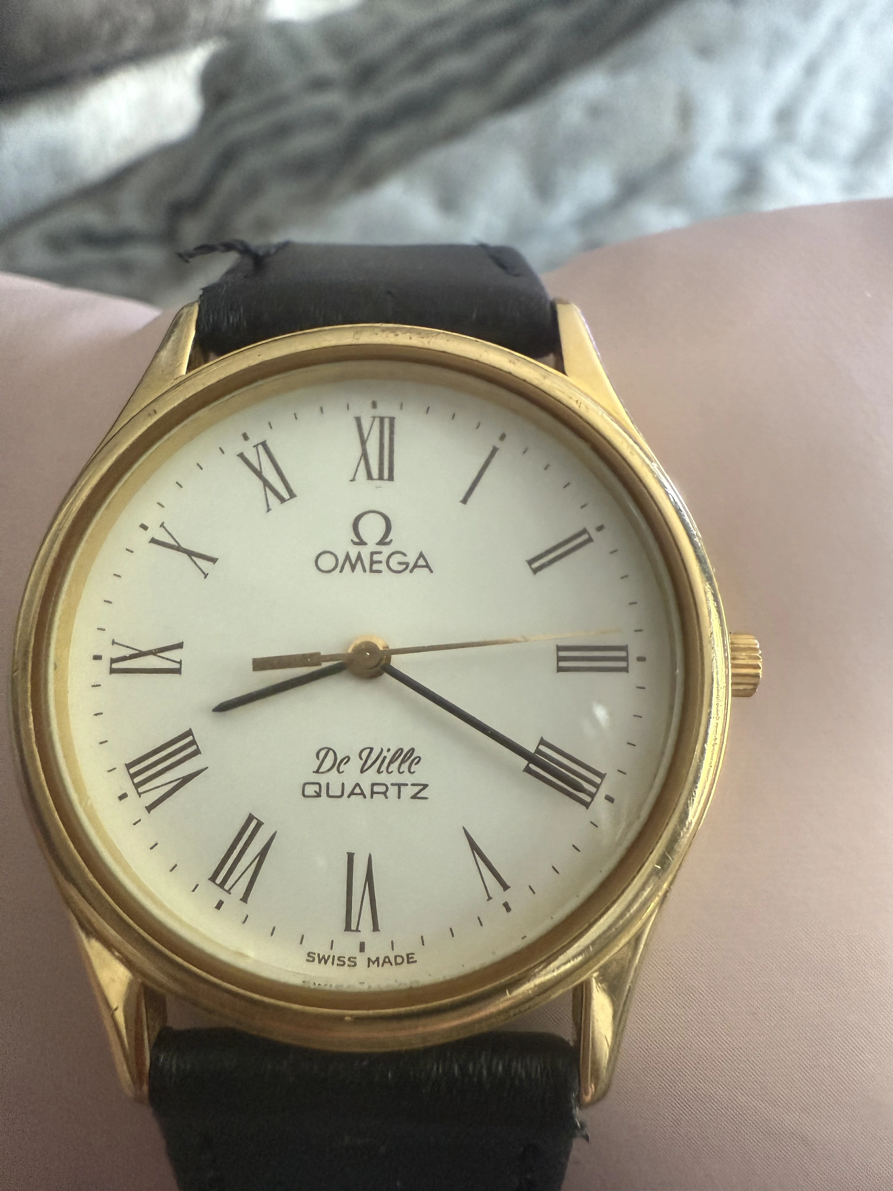

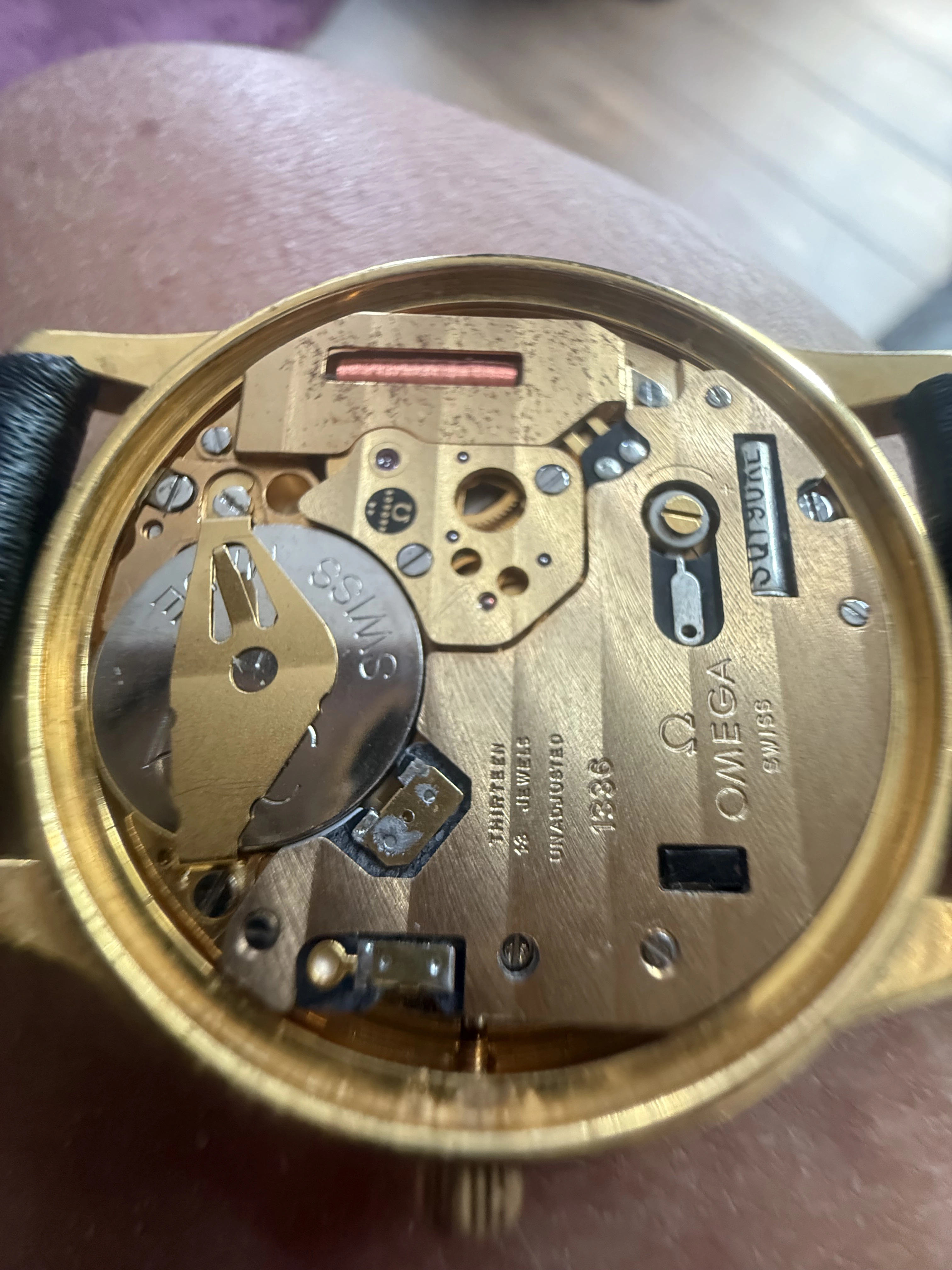

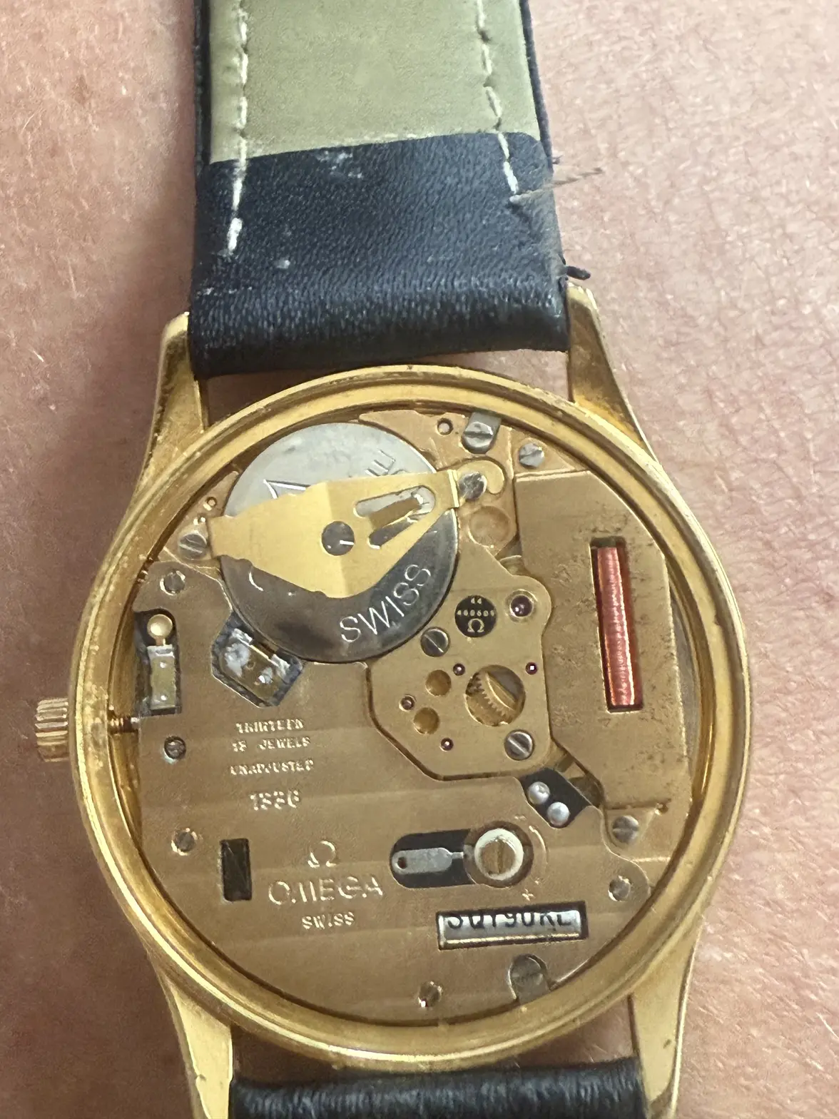

I have this beautiful de ville 1336 and want to know what battery to replace it with?

That 3 digit number on the battery is what you’re Looking for just do a quick google and you’ll find a replacement, I believe it’s 391

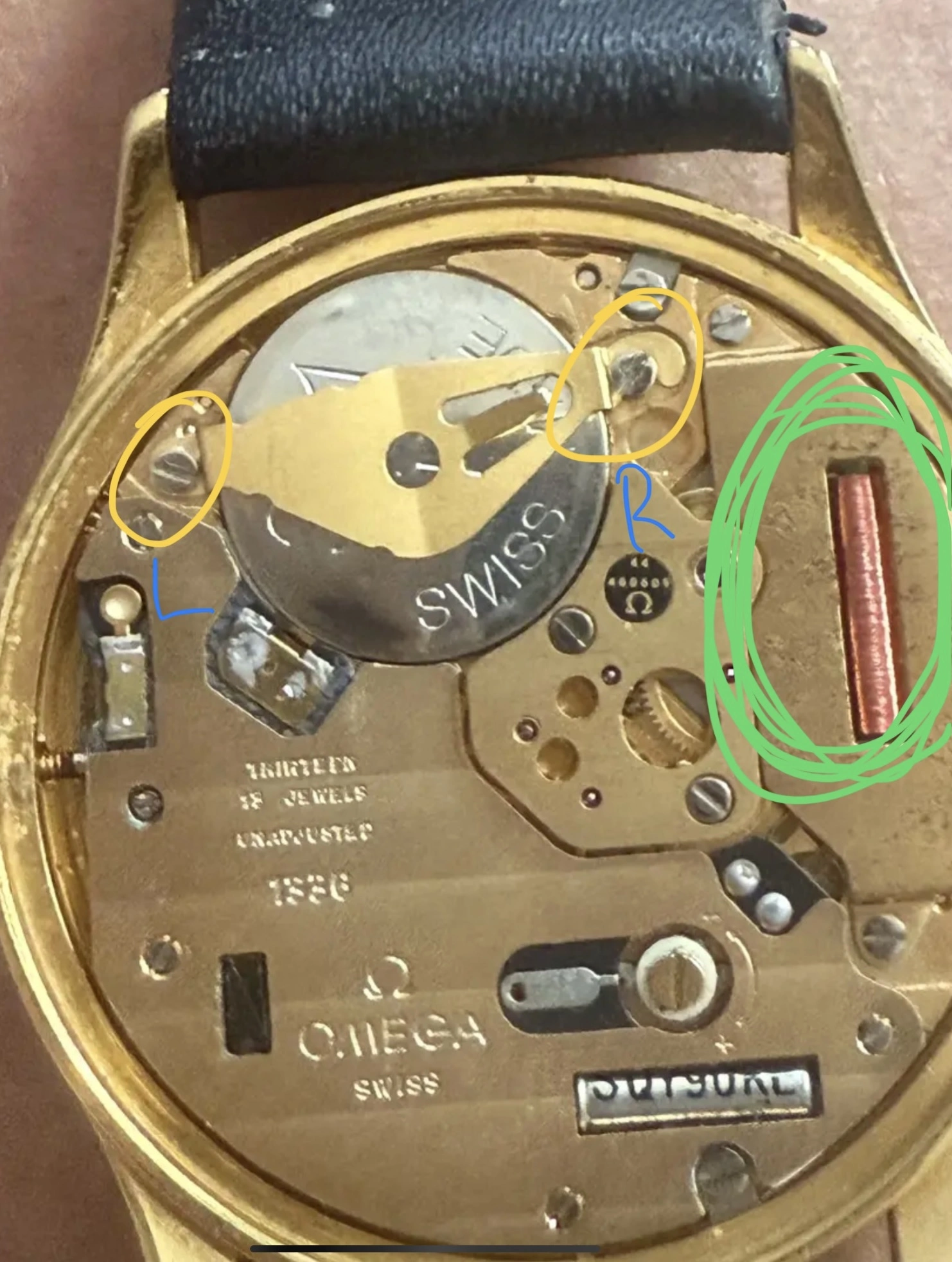

Little bit of advice if your wanting to change the battery yourself be very careful of the coil circled in green it’s very delicate. And don’t undo the screws all the way as they are fiddly to reinstall loosen the left one and then the right a little the battery bracket is on a clip on the right hand side and will just unclip from the right screw and you can swivel out of the way to install the new one. Don’t force this brass retaining either also delicate.
