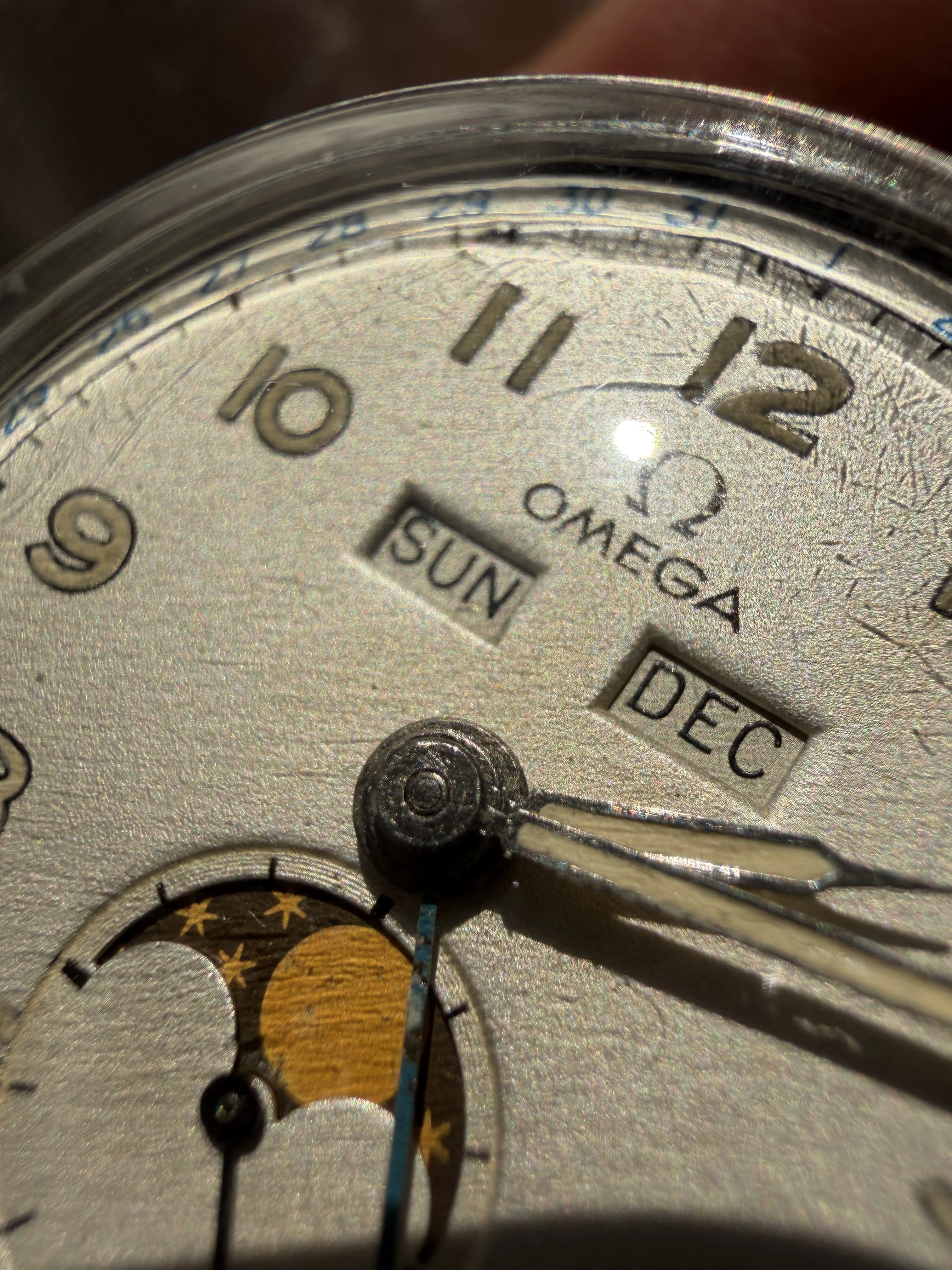

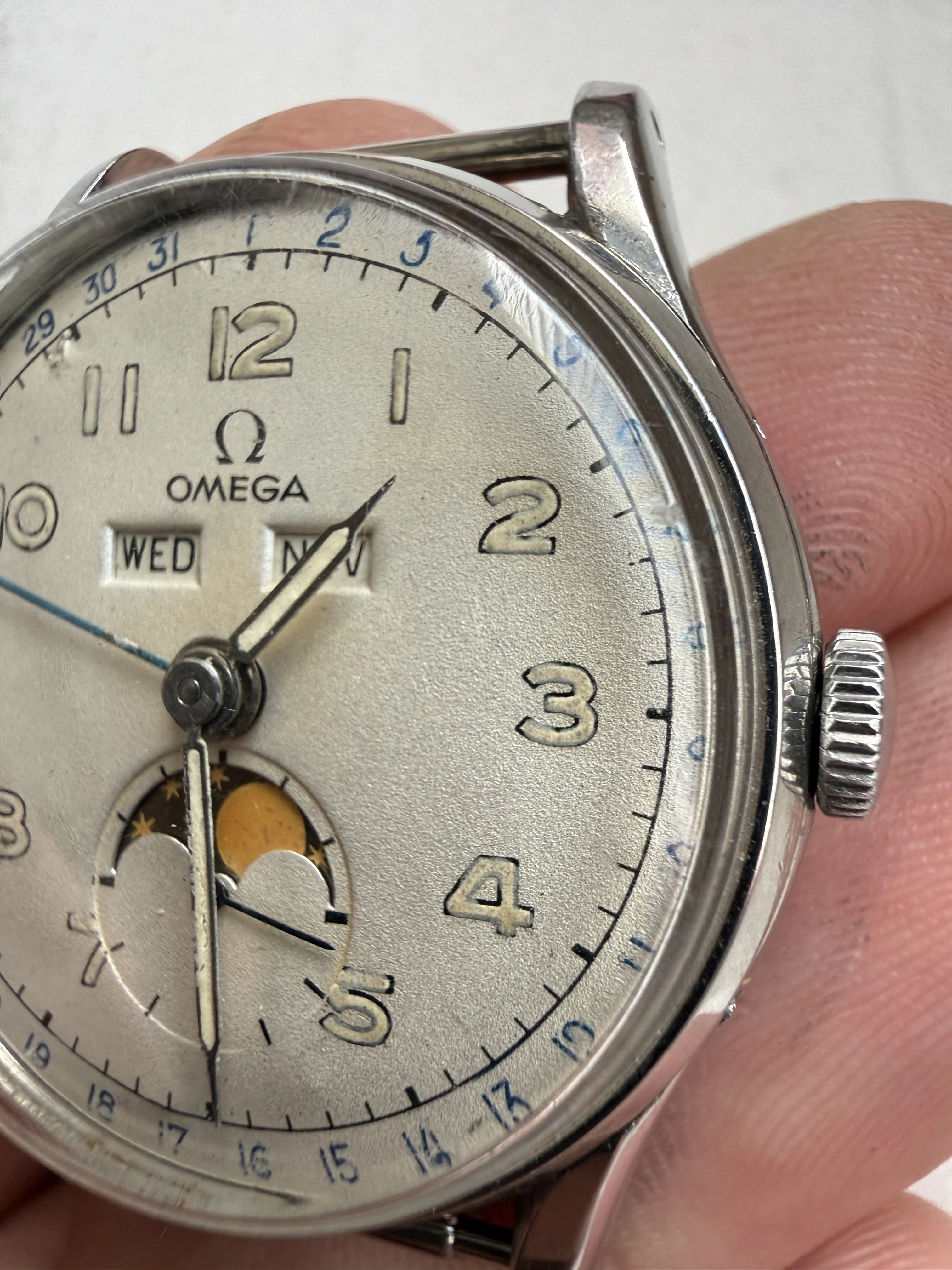

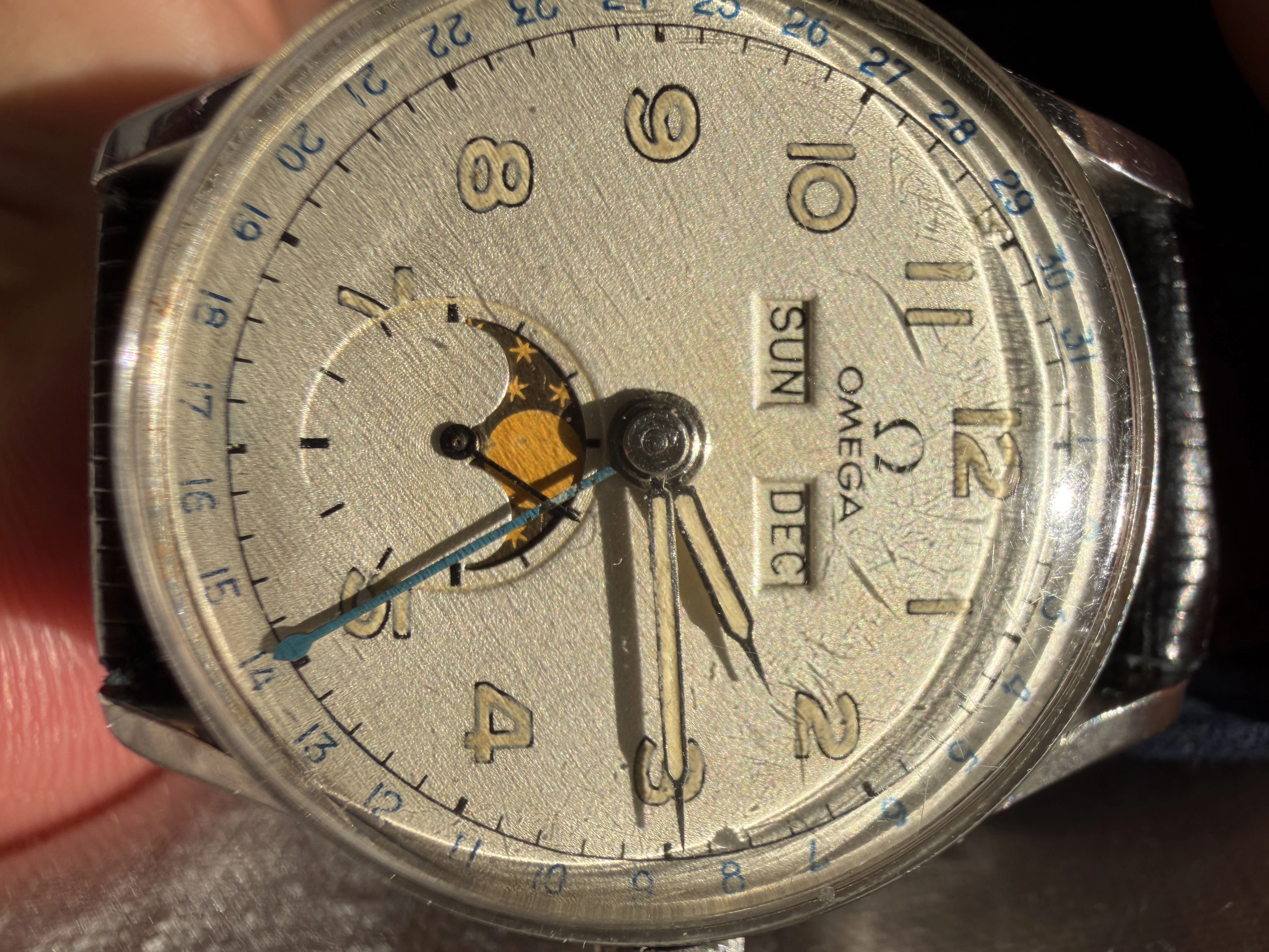

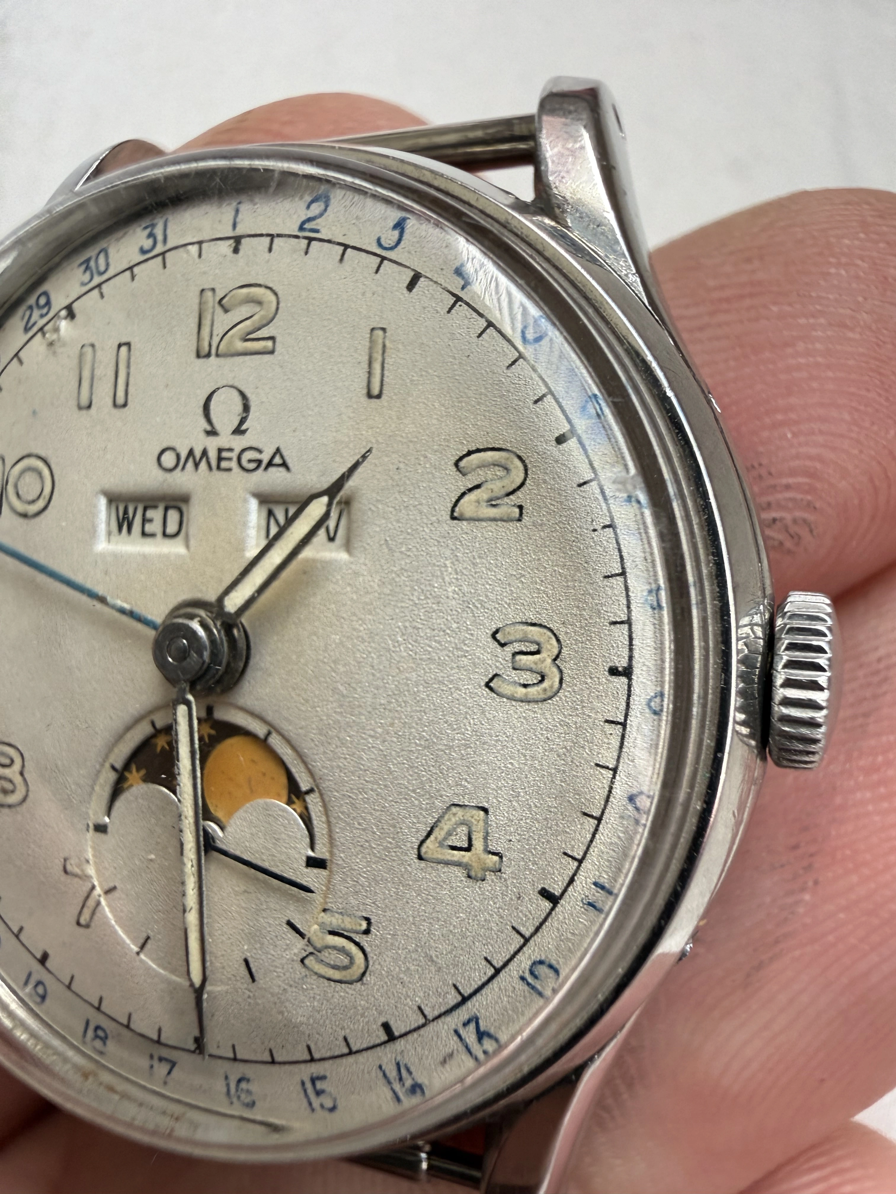

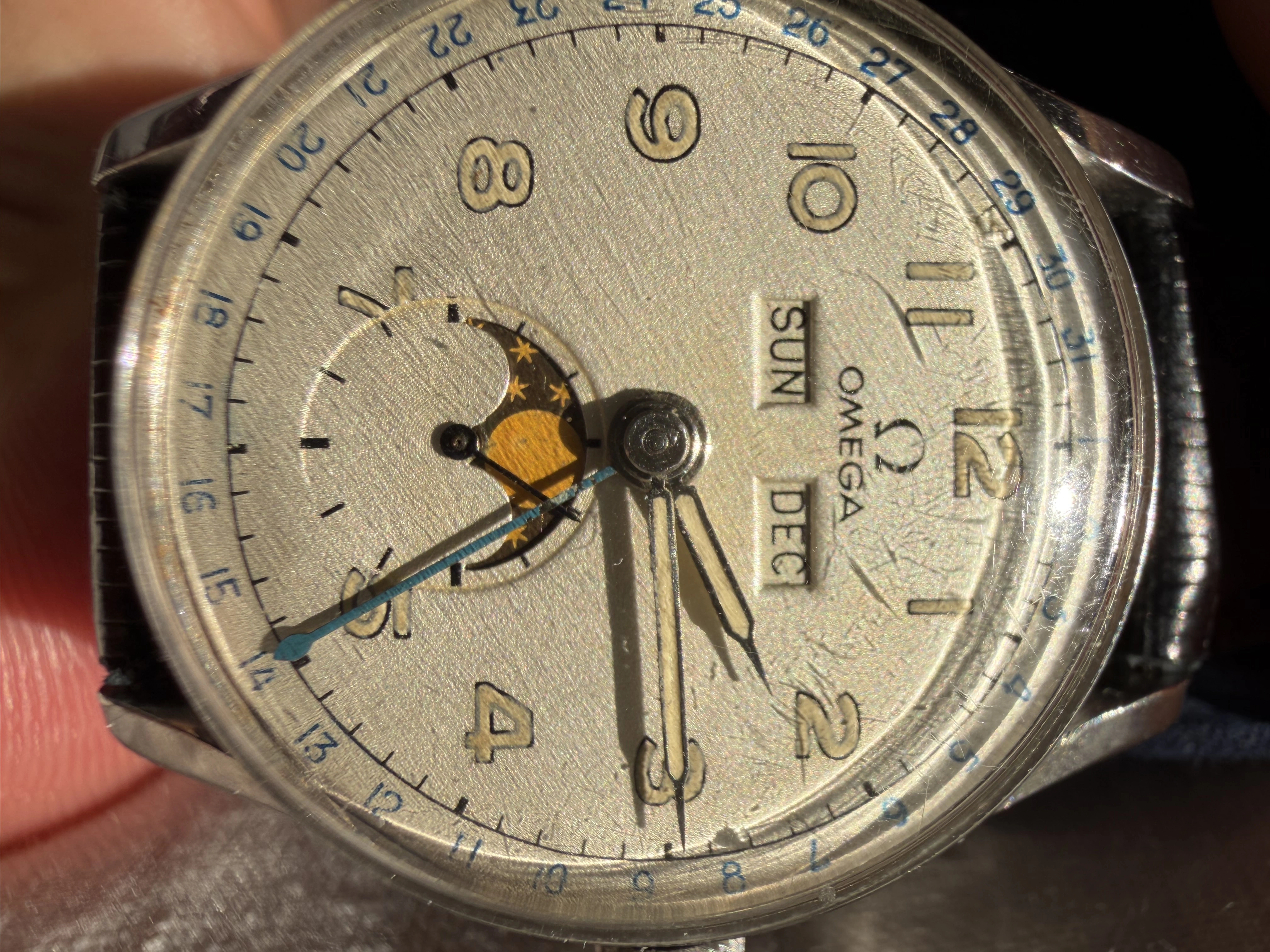

Hello,

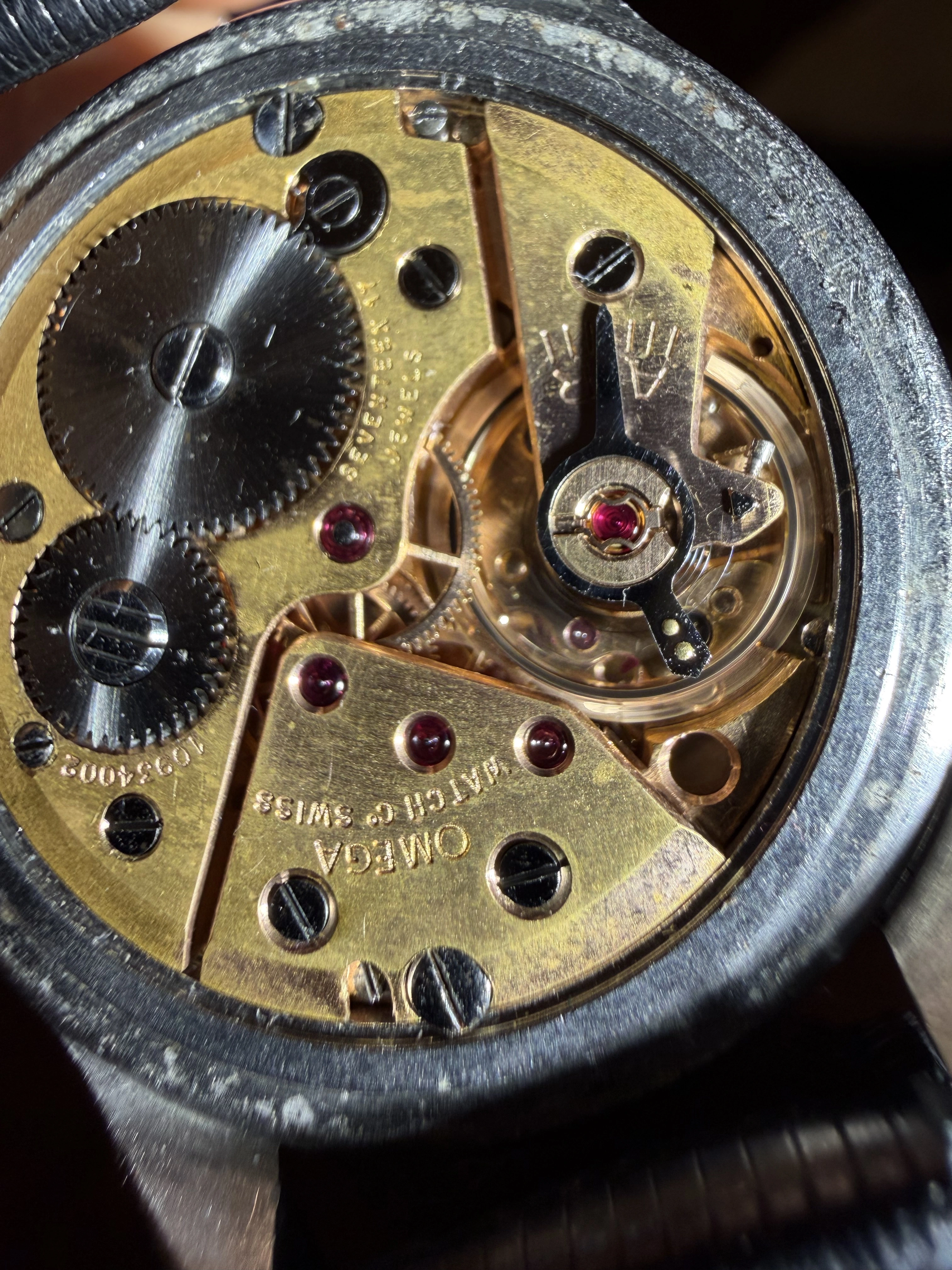

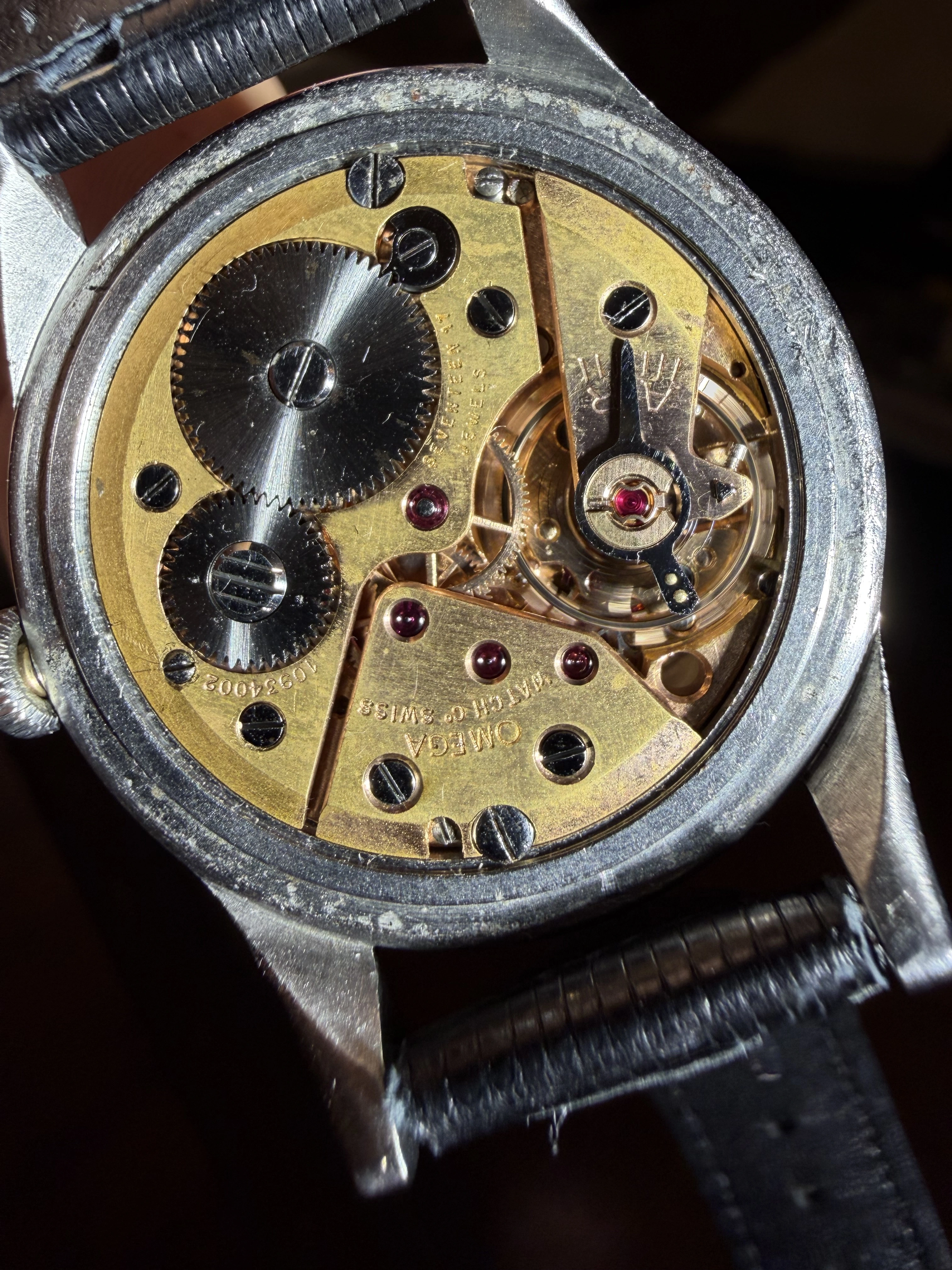

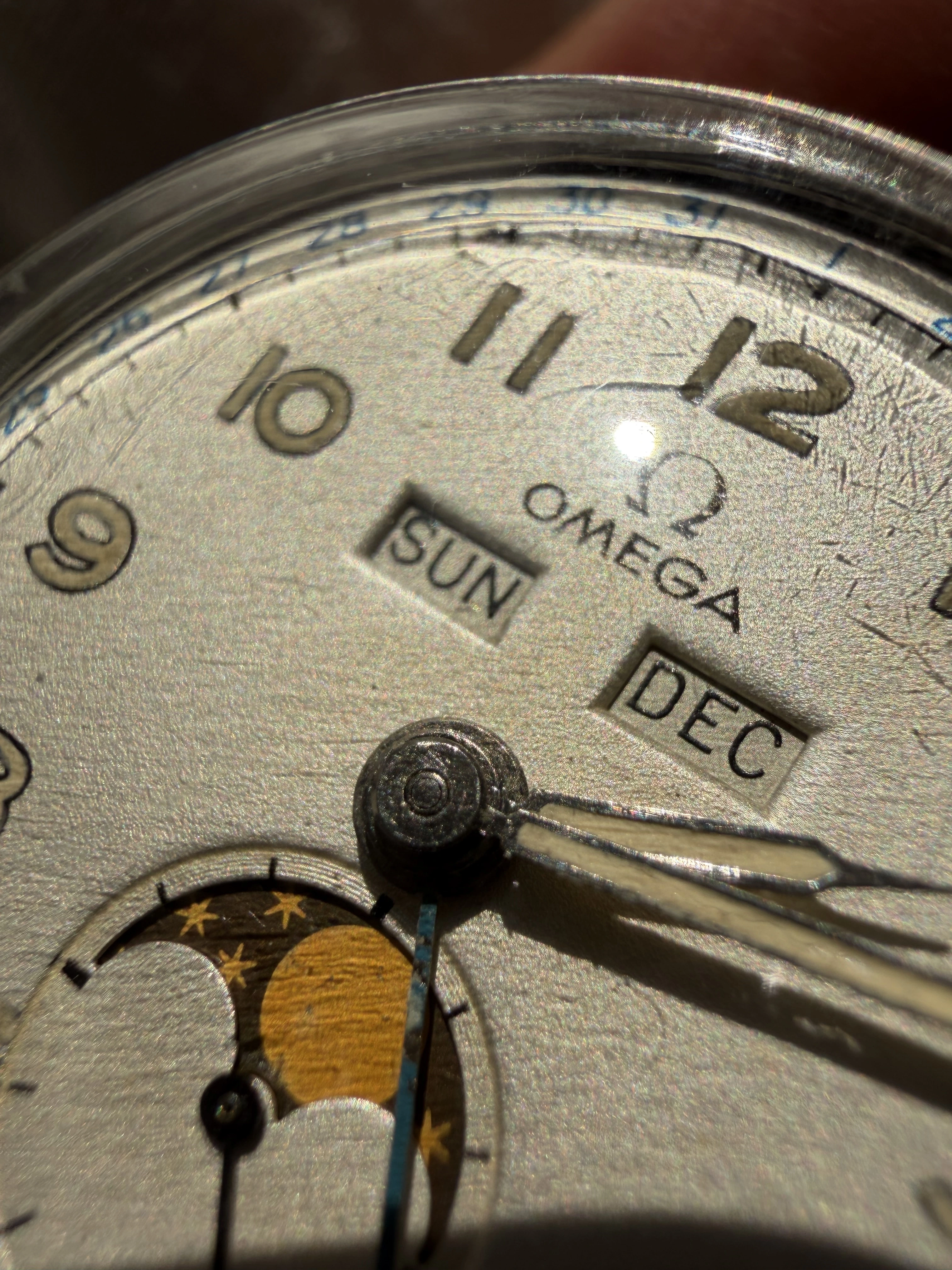

Got my hands on this omega cosmic moonphase. What is your opinion about the dial? Is it redone?. I’m also trying to source a crystal for it since this one is not original. Does anybody has /knows the dimensions of the crystal?
The watch was recently serviced. The case pushers were fabricated. Moonphase mechanism fixed.
Thank you!

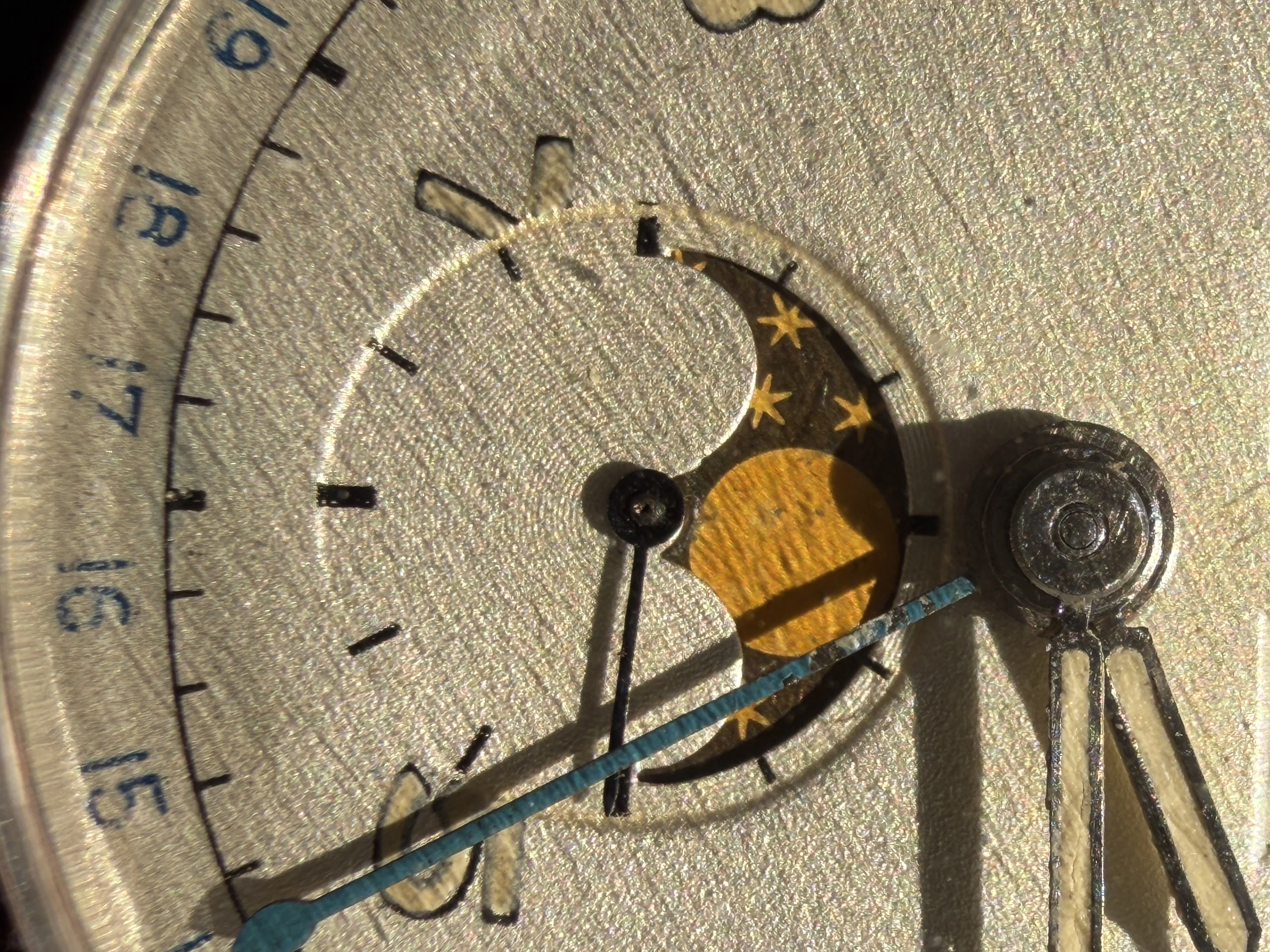

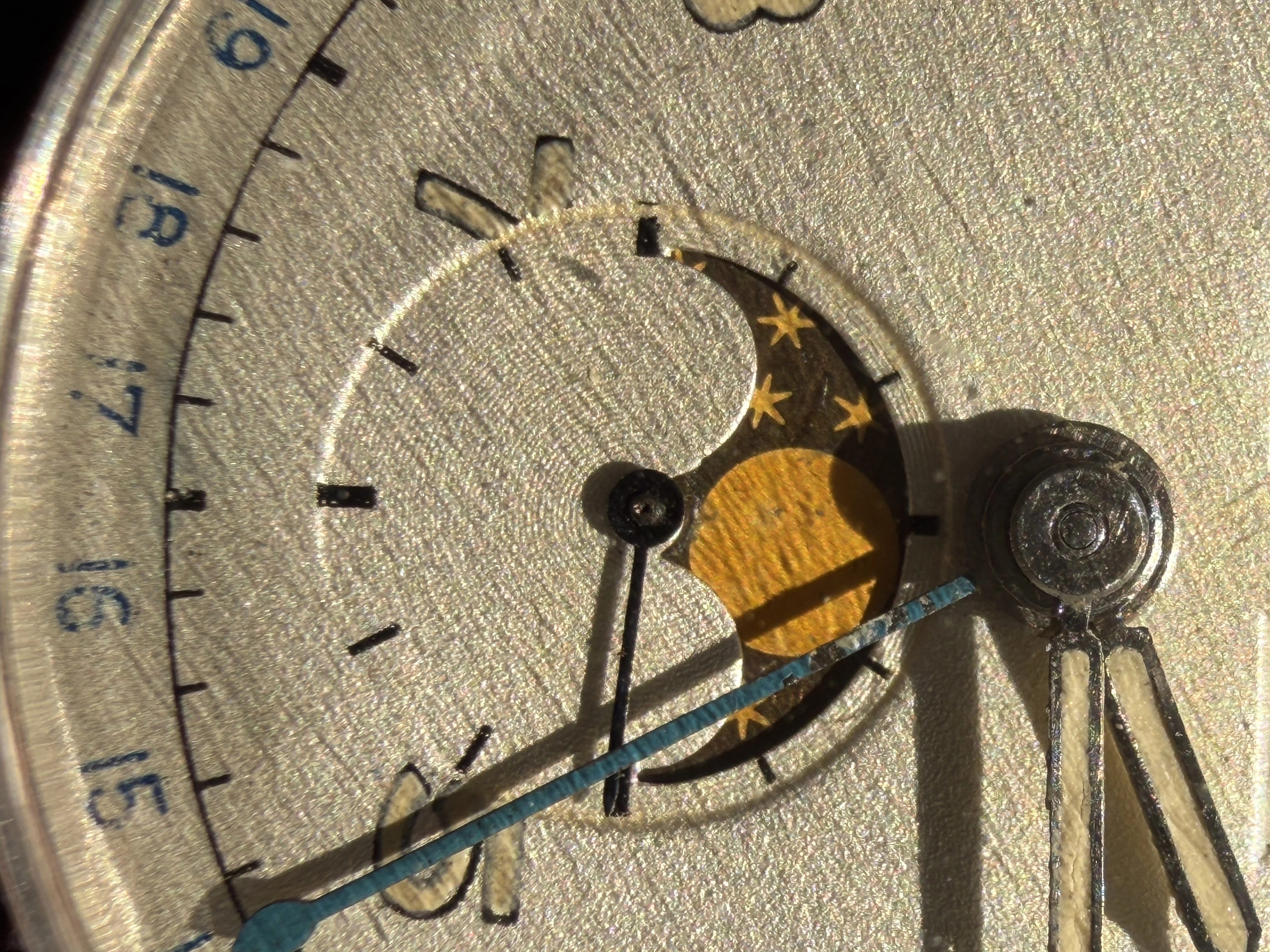

There also seems to be an issue with one of the dial feet at 11 o’clock.

The dial has definitely been re-done.

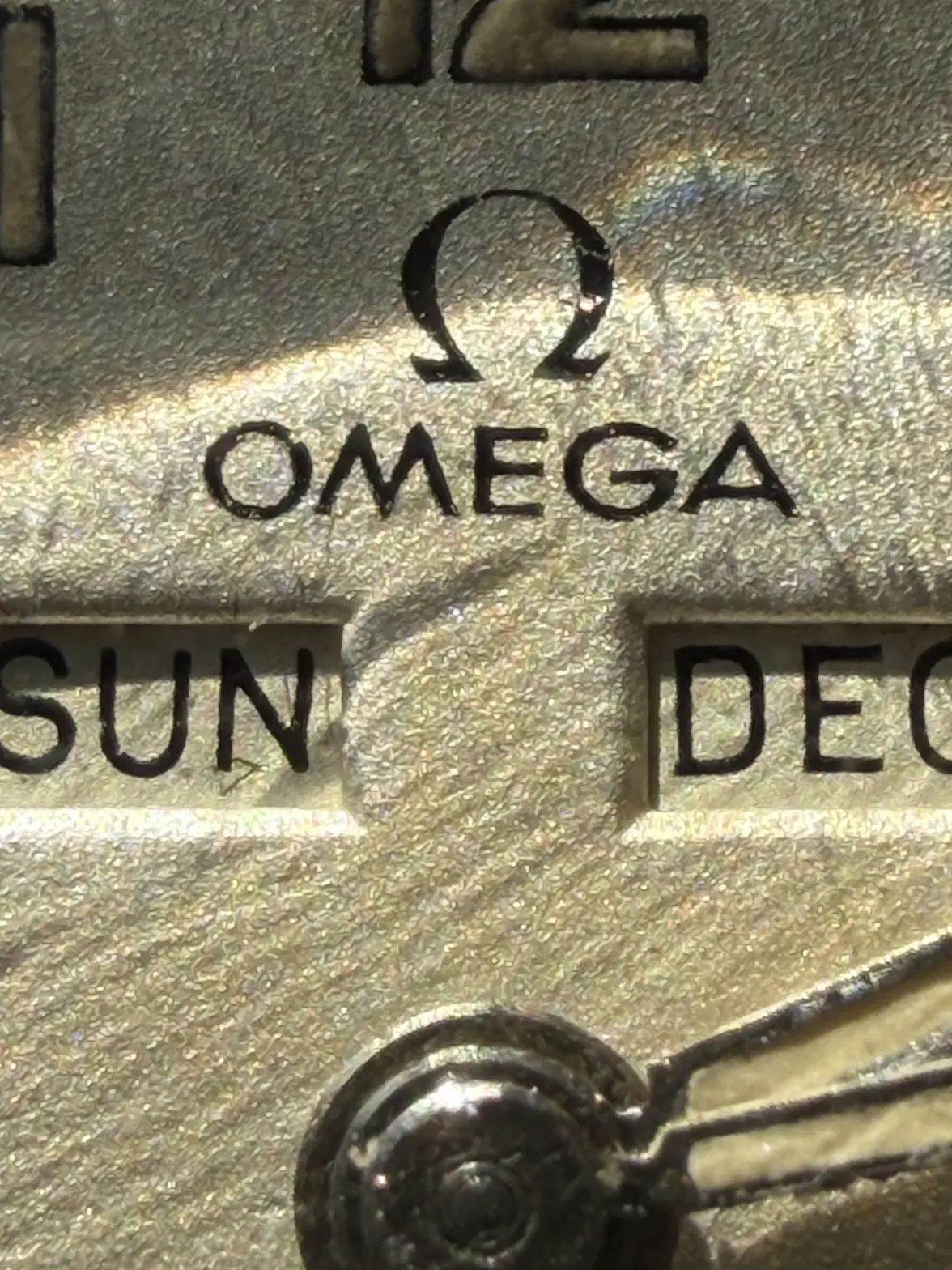

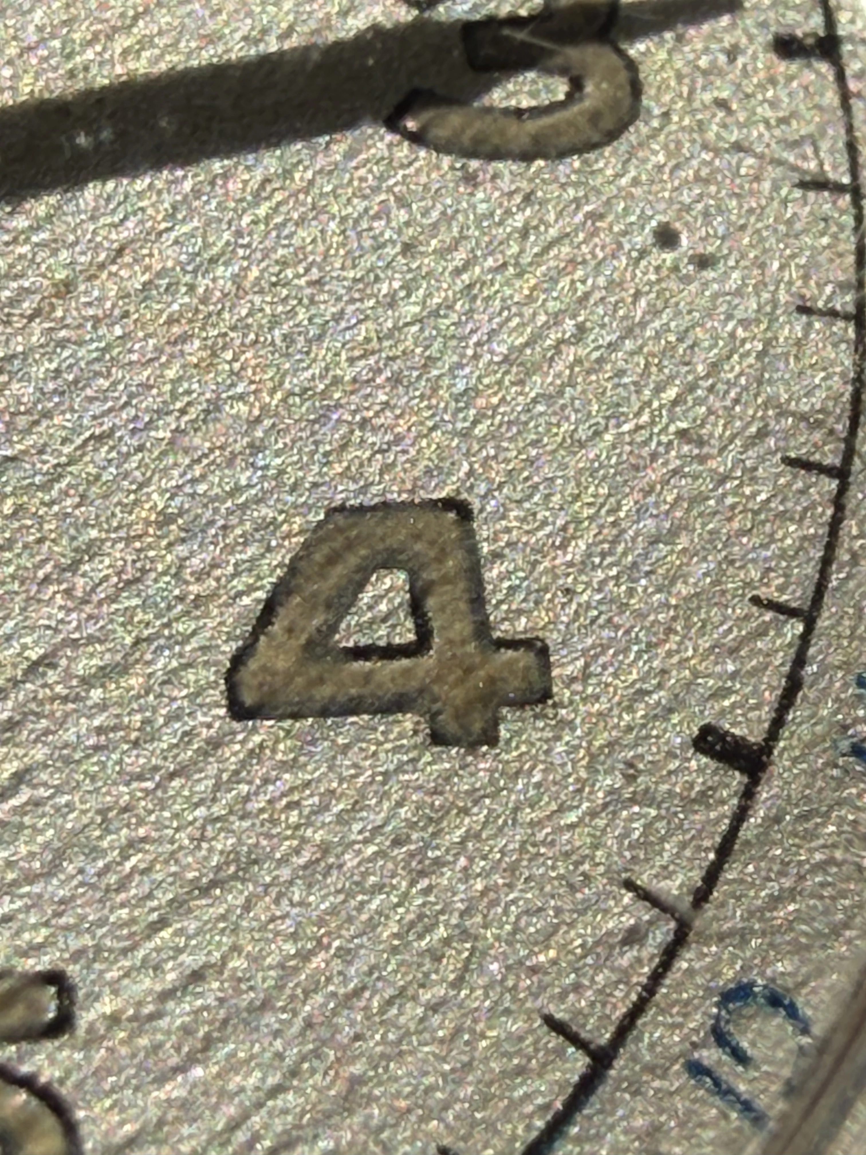

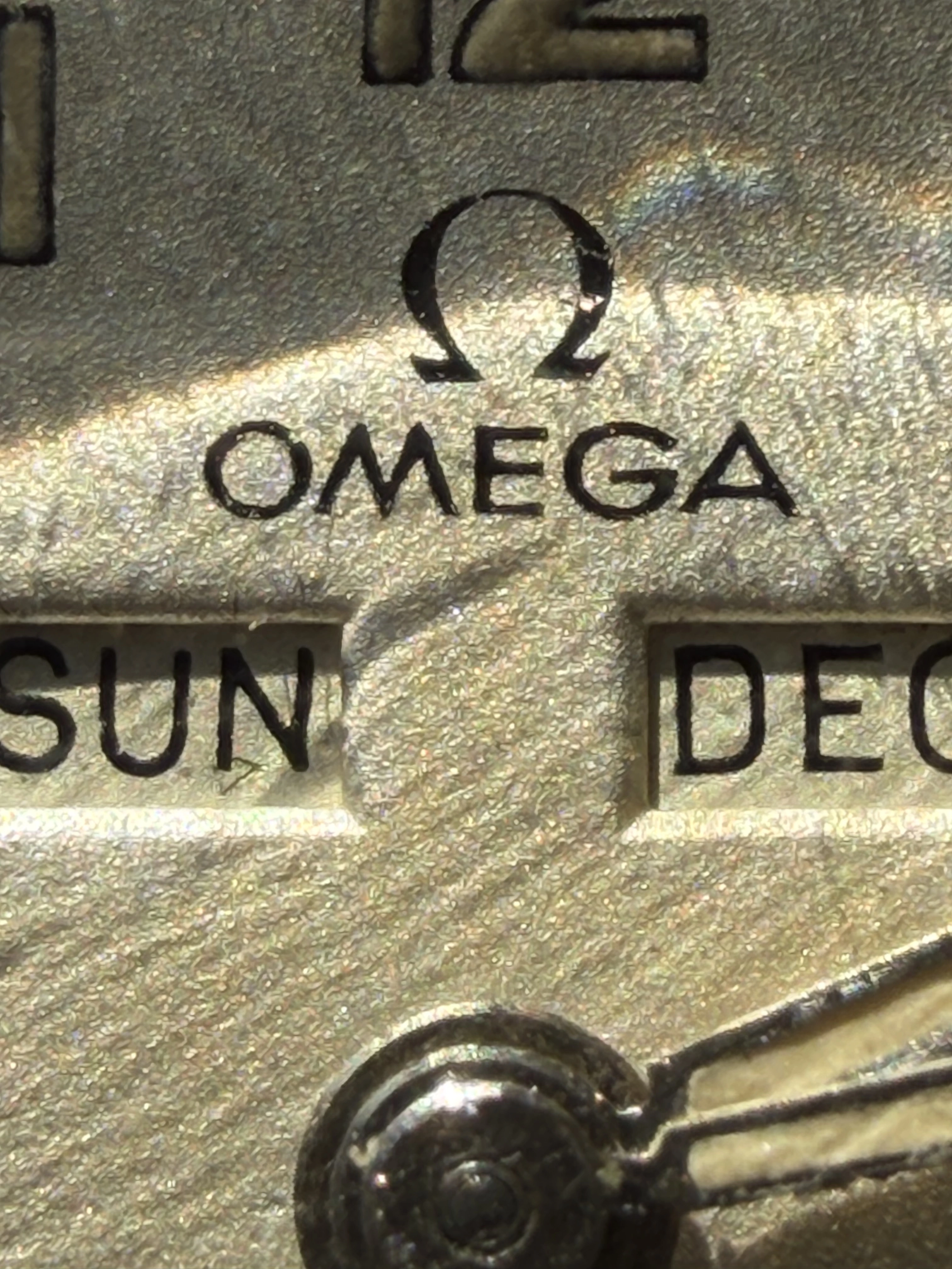

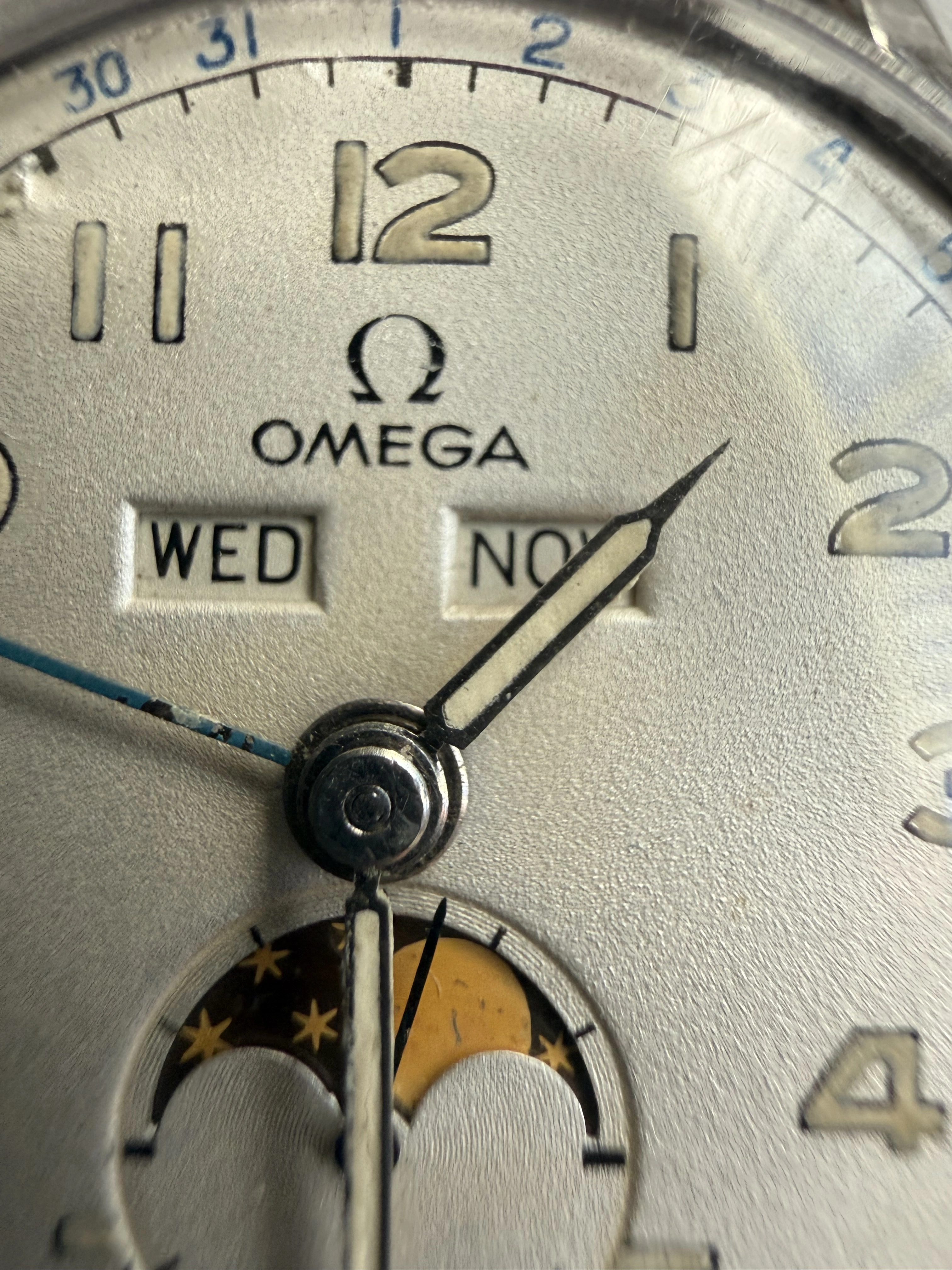

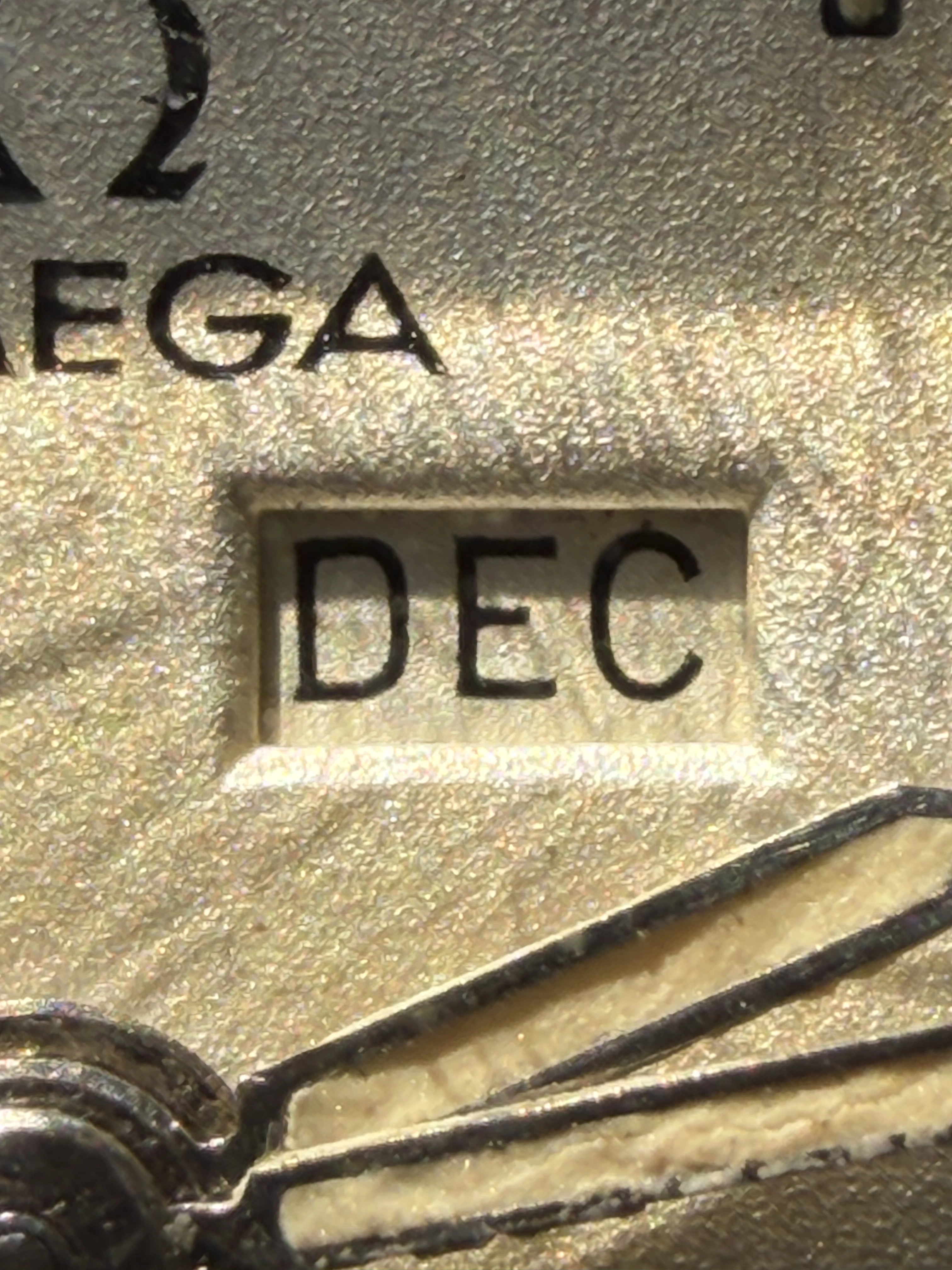

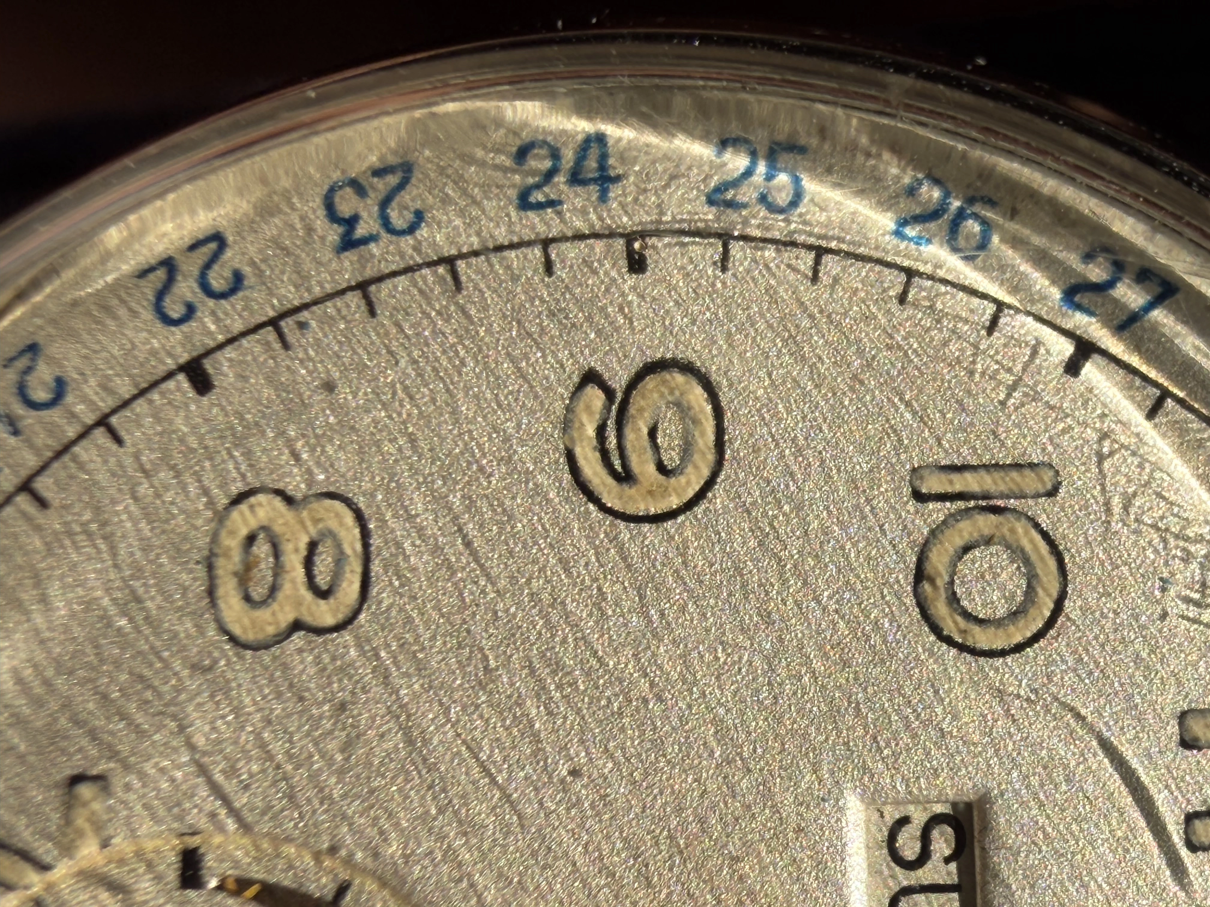

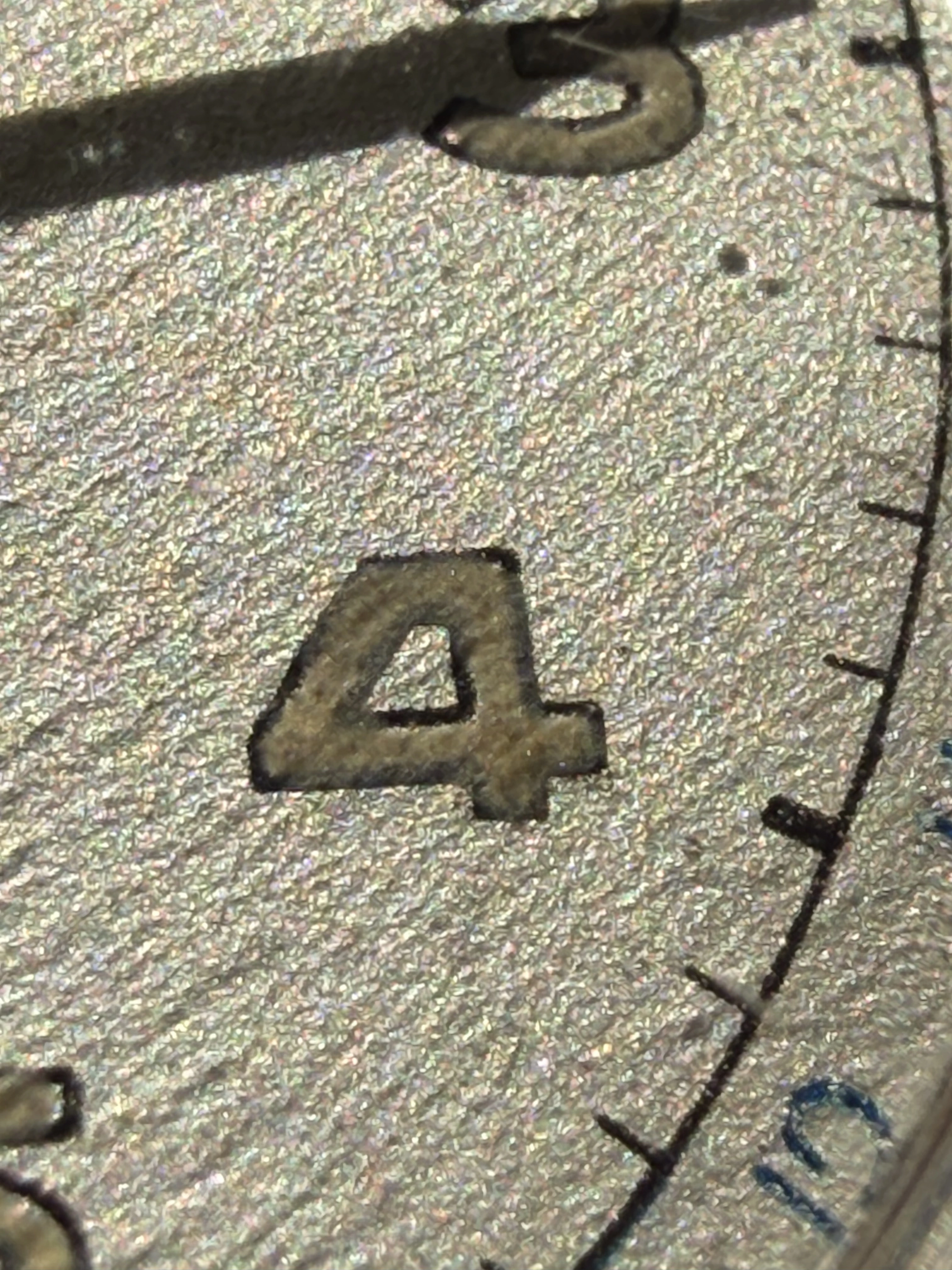

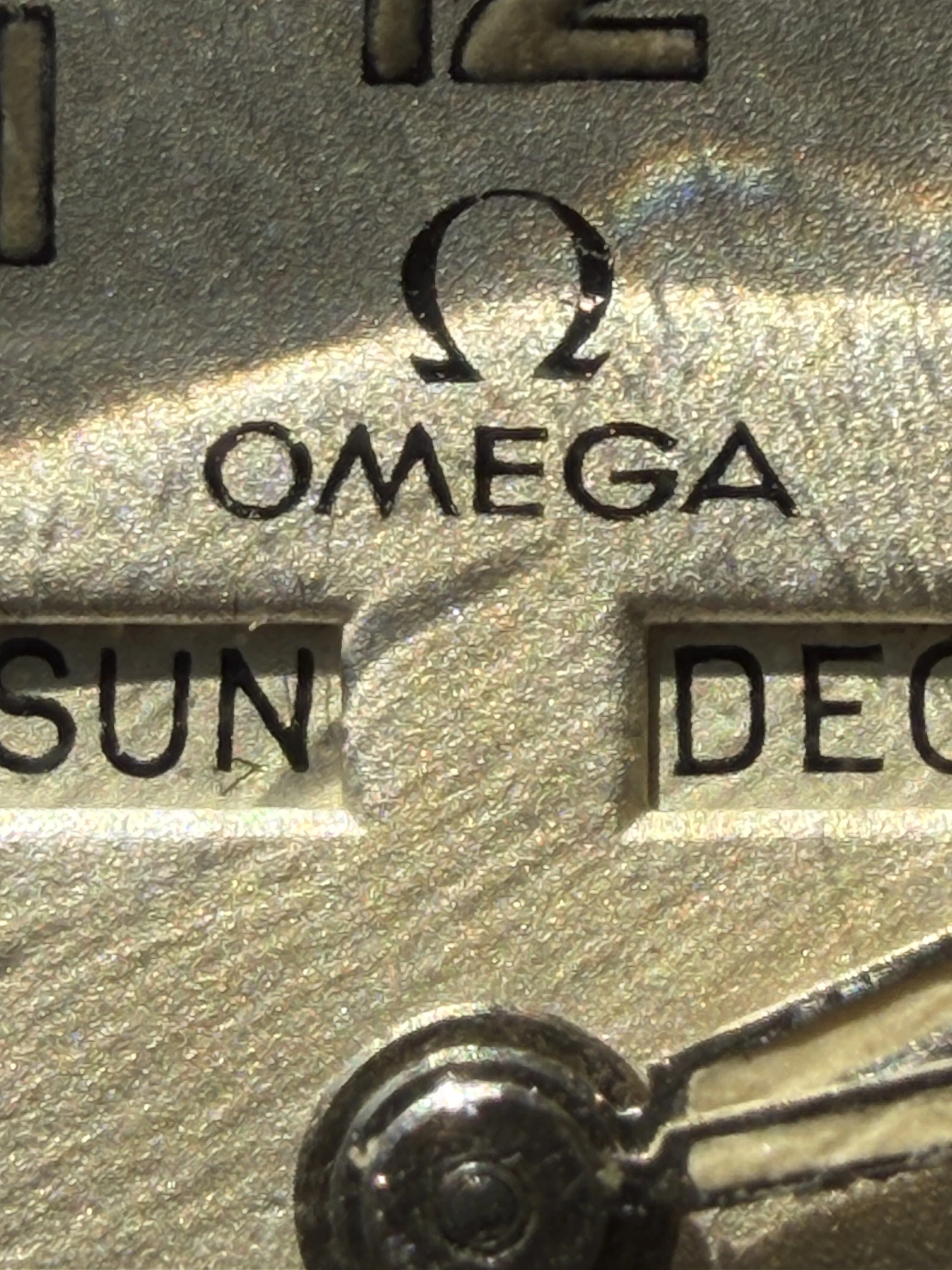

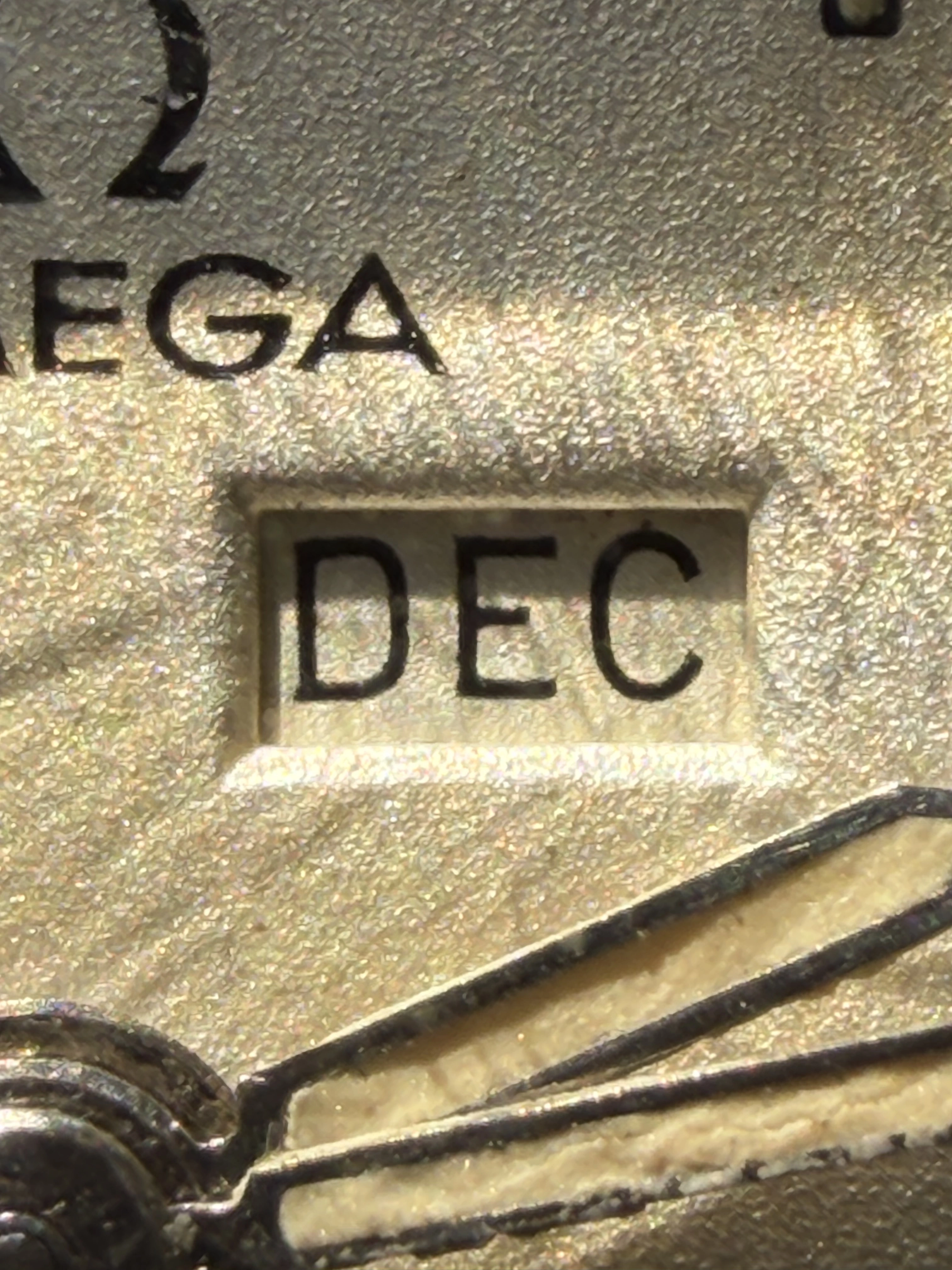

Appreciate the comments. I’m trying to understand the redial concern - could you clarify which detail looks off to you? I’ve posted macros of the printing, windows, and surface grain in case it helps.
6,327
9,917
About everything is off
445
373

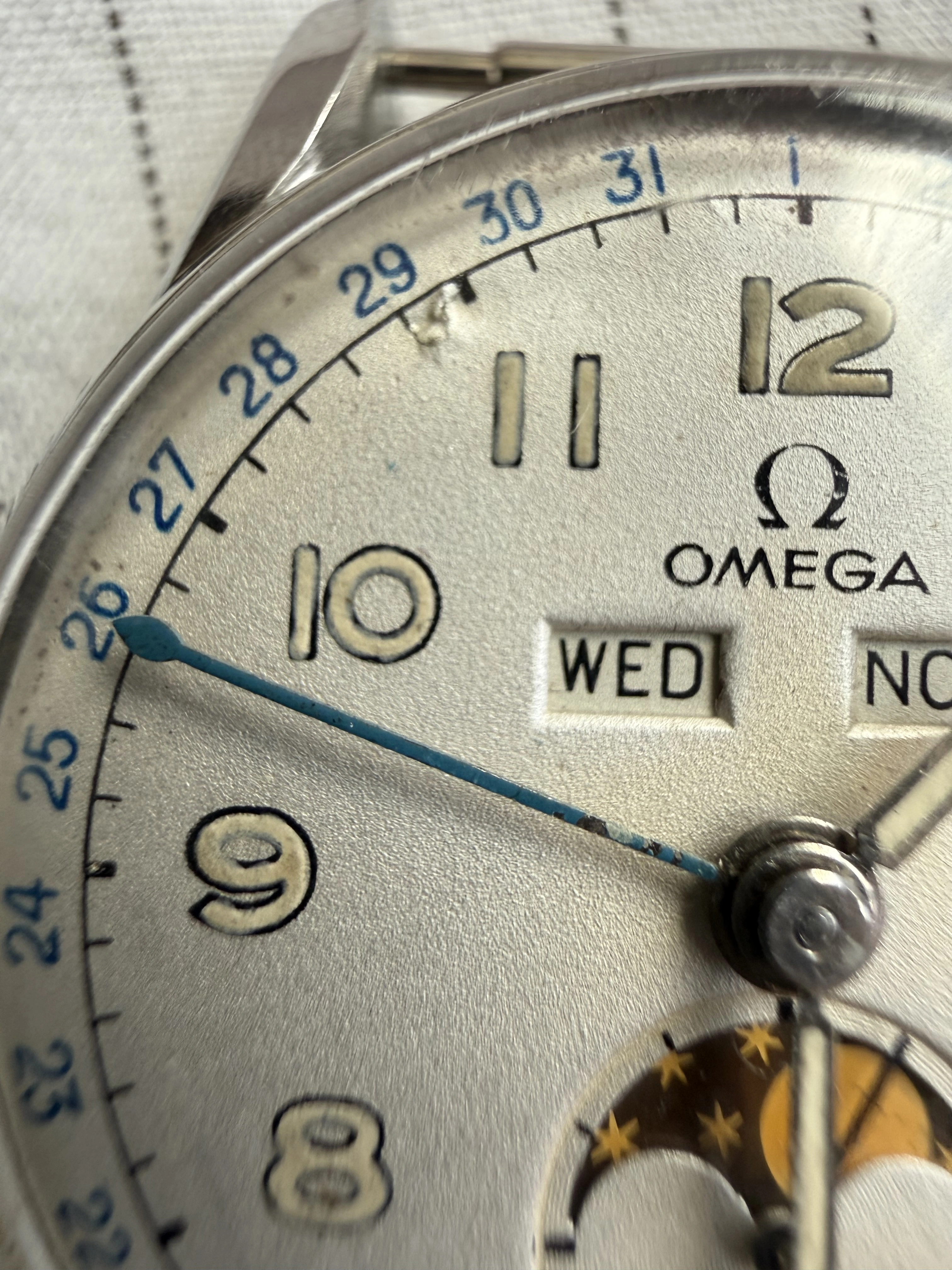

A couple of things jump out to me regarding this being a redial.

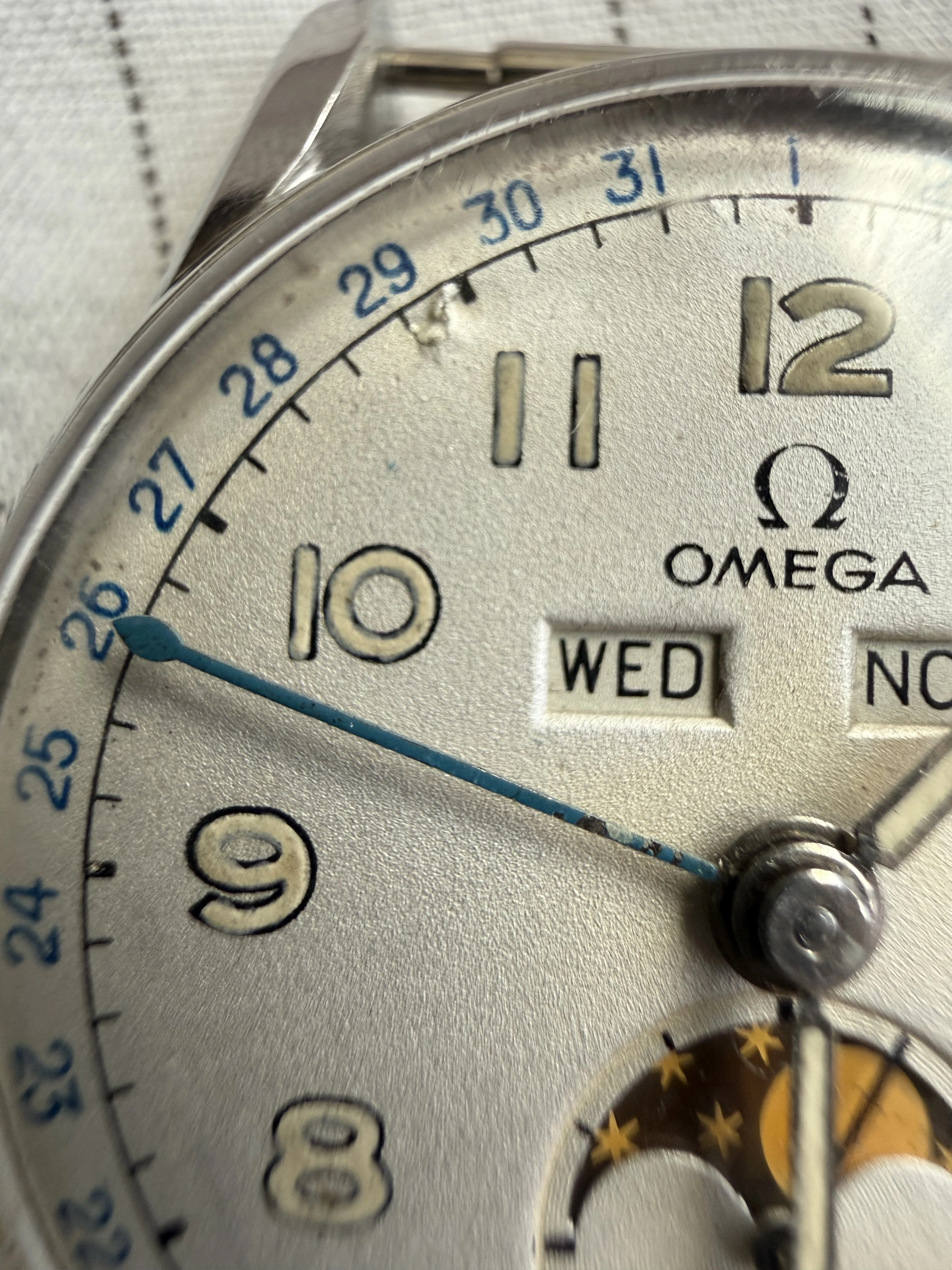

At 11 o'clock, it looks like the minute track is printed over the damage. That could not happen if the dial printing were original.
The date track is printed with a slightly different centre point to the minute track. The get closer and further apart as you circle around the dial.
The other members who know this model better than me can fill you in on the other tells.
3,582
8,168

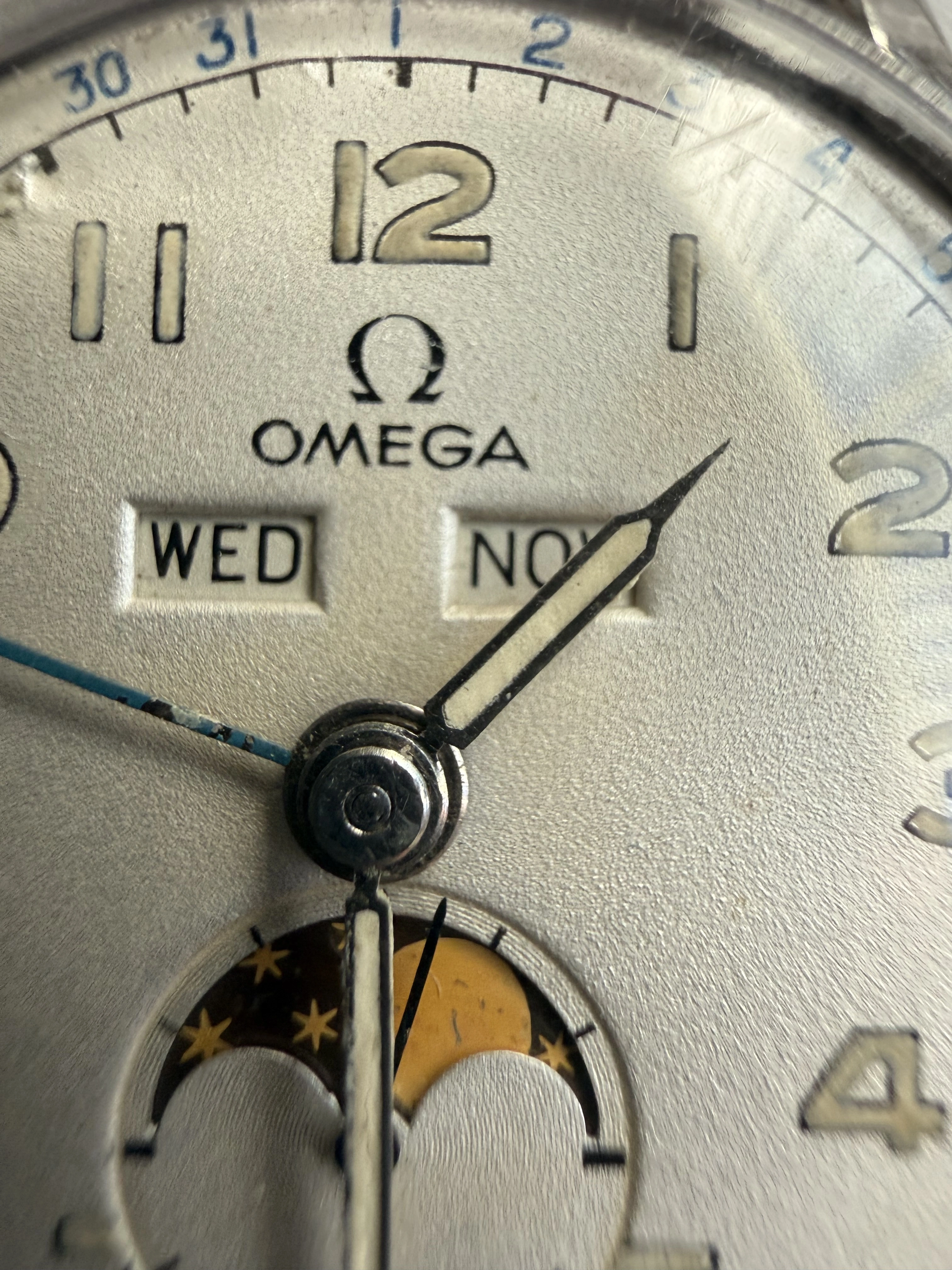

Quite a bit wonky, starting with the 1 date being off center. Sent you a pm and enjoyed our talk, we don't like to educate the transgressors!
Probably a watchmaker repairing water damage the best they could.
23,389
52,018
I don't think you need to look past the sub-dial to know that this is a sloppy repaint. If it wasn't disclosed, maybe you can return it.

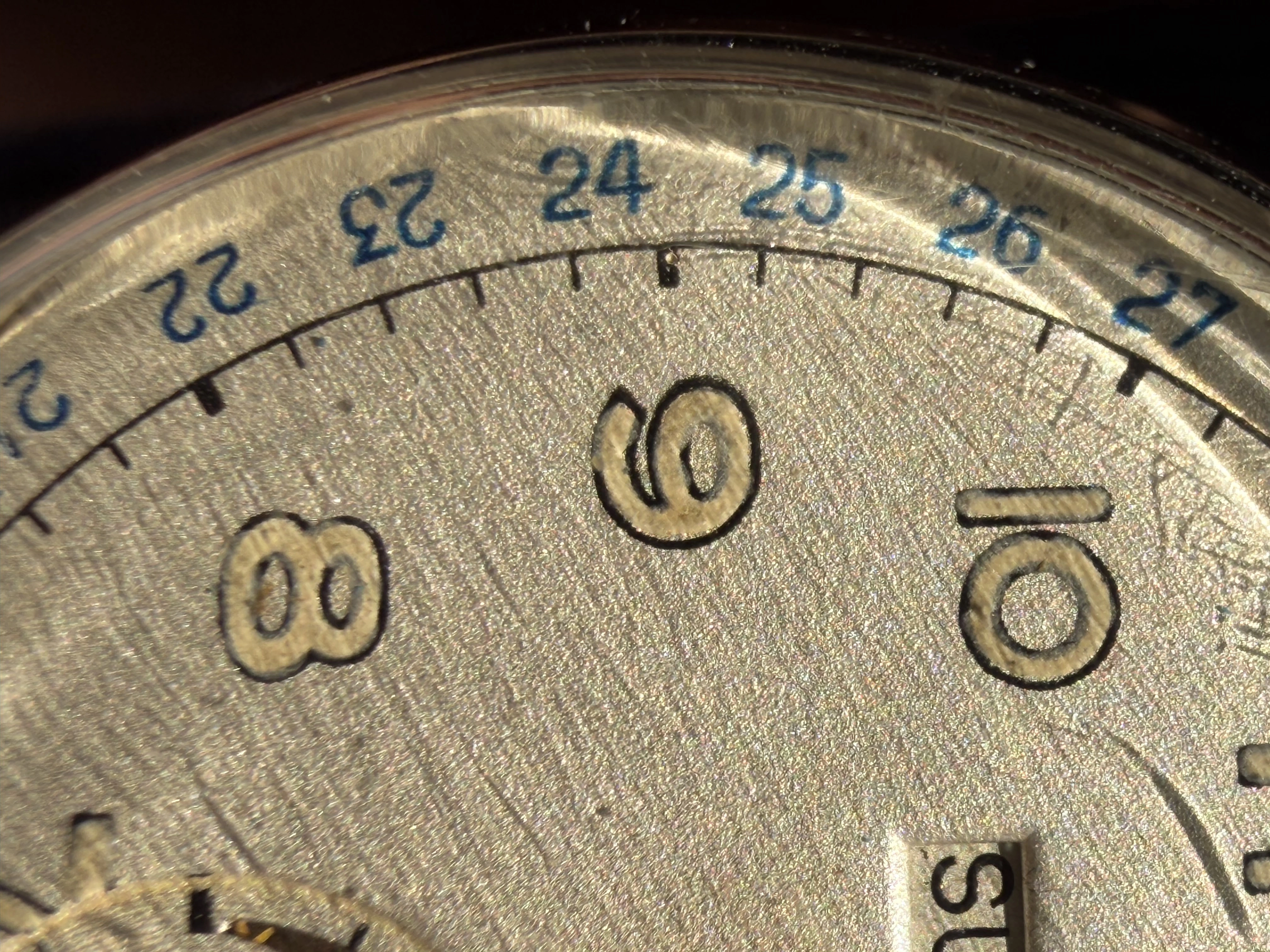

One thing that makes me look twice at a dial is if something looks uneven or inconsistent.
MOST watch manufacturers (Omega included) spent a ton of time making their printing masks perfect, and they will stamp/manufacturer very consistently.
A majority of redials (repaints at least) are an artist (at best) making a single dial. They are not going to be perfect on minute markers, numbers/etc. compare printed numbers for evenness, compare minute markers for spacing and boldness and length.
One last thing: most dials are printed with a mask, which means they typically go for "square" ends to lines. Painted are going to have round ends.
If I see anything above, I am going to be very suspicious at least.

Also, look first for obvious errors and misalignments, like the ends of the markers around the subdial. Some of them end short of the step and others overlap over the step. That's too sloppy. Looking at photos of many dials will help you know what the texture should look like. Again, the snailing in the sub-dial is partially painted over. And the overall texture of the dial has a weird diagonal sloppy brushing that isn't like any Omega from that era. Over time, all of this will become second nature, and you won't even have to analyze it in this way, you'll just know.

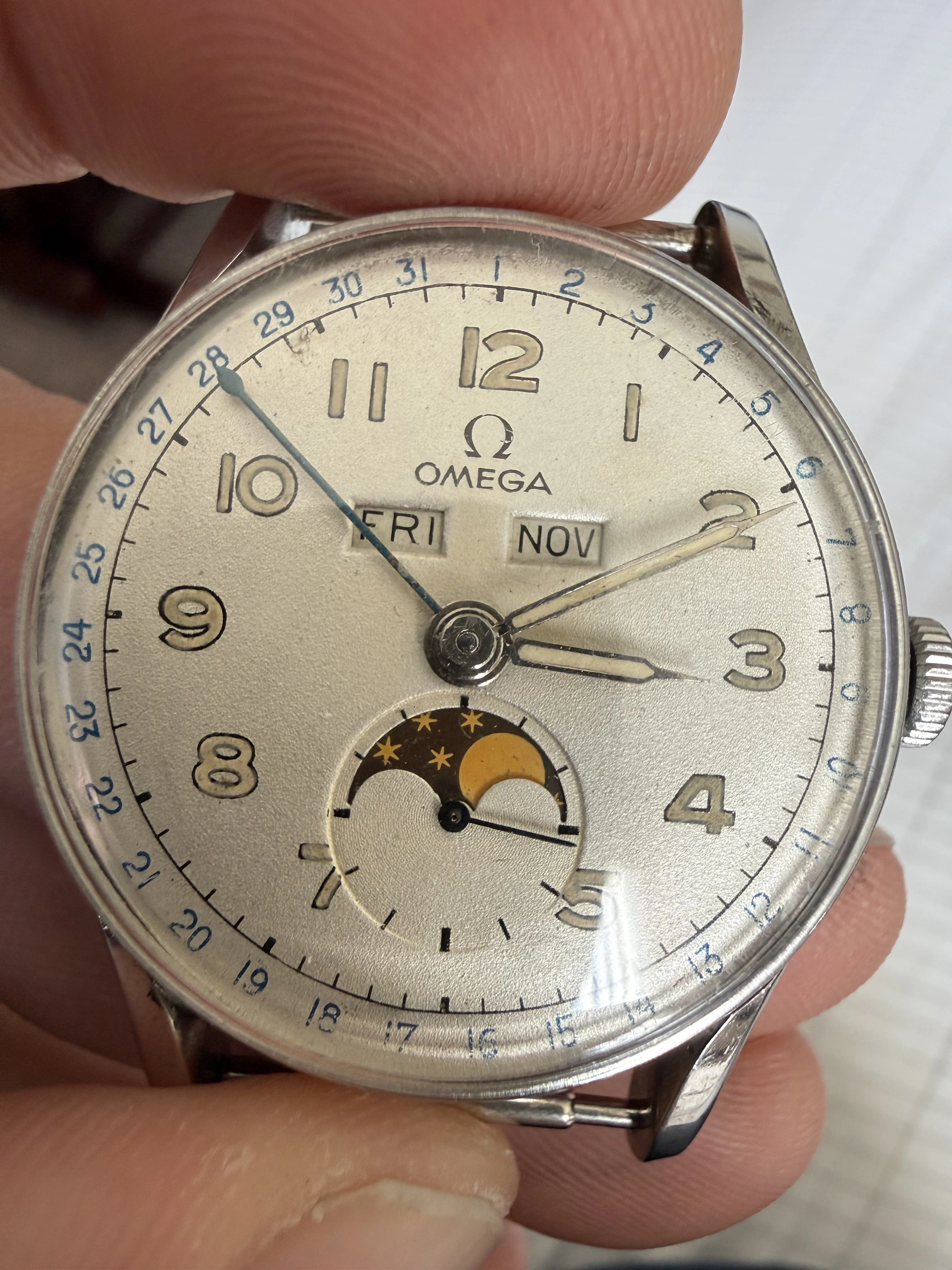

So many things off from the texture to the font and everything in-between.

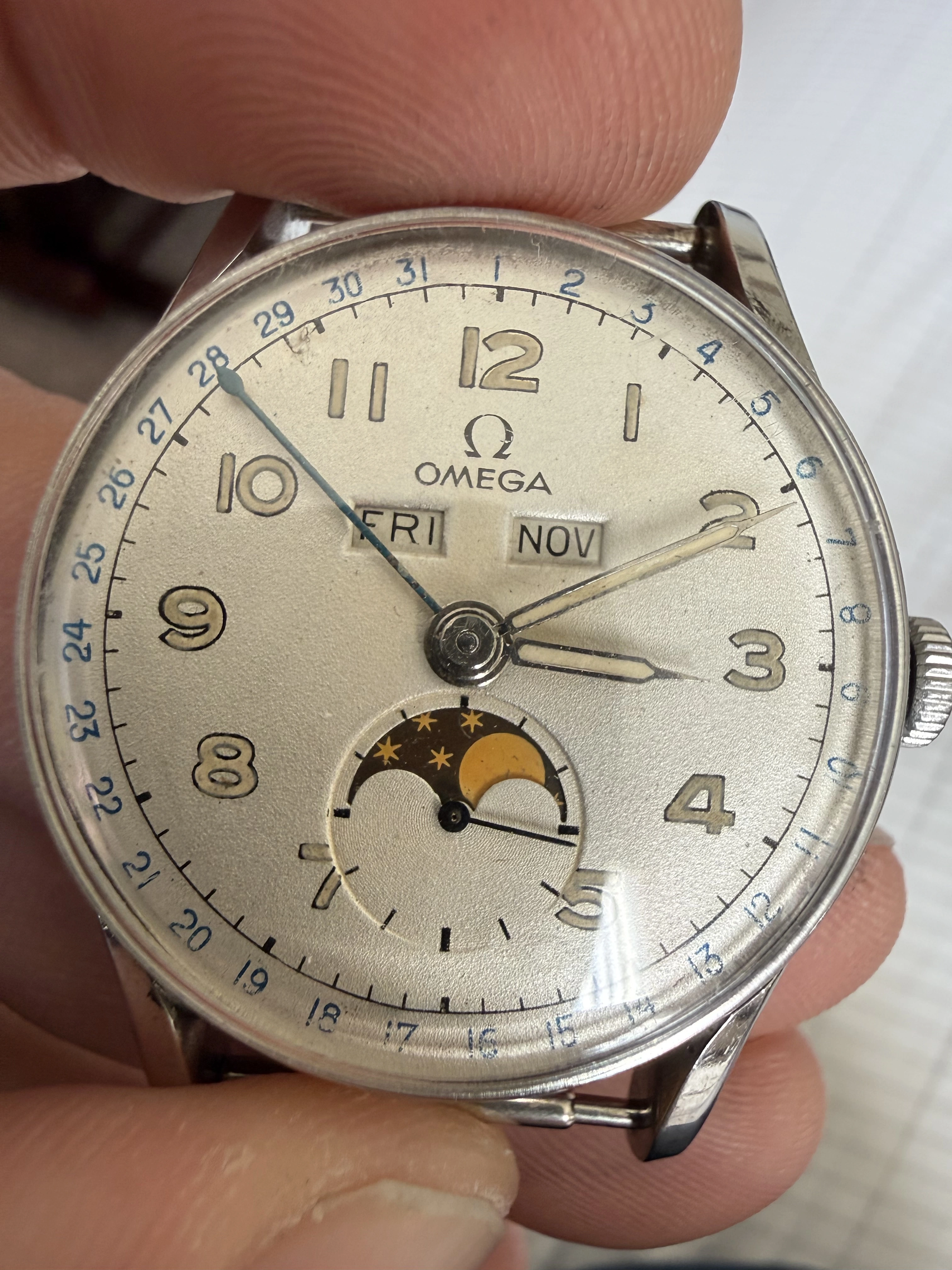

But an easy one to help in the future, if the date above the 12 o'clock is 1, then it's a redial as it should always be 31

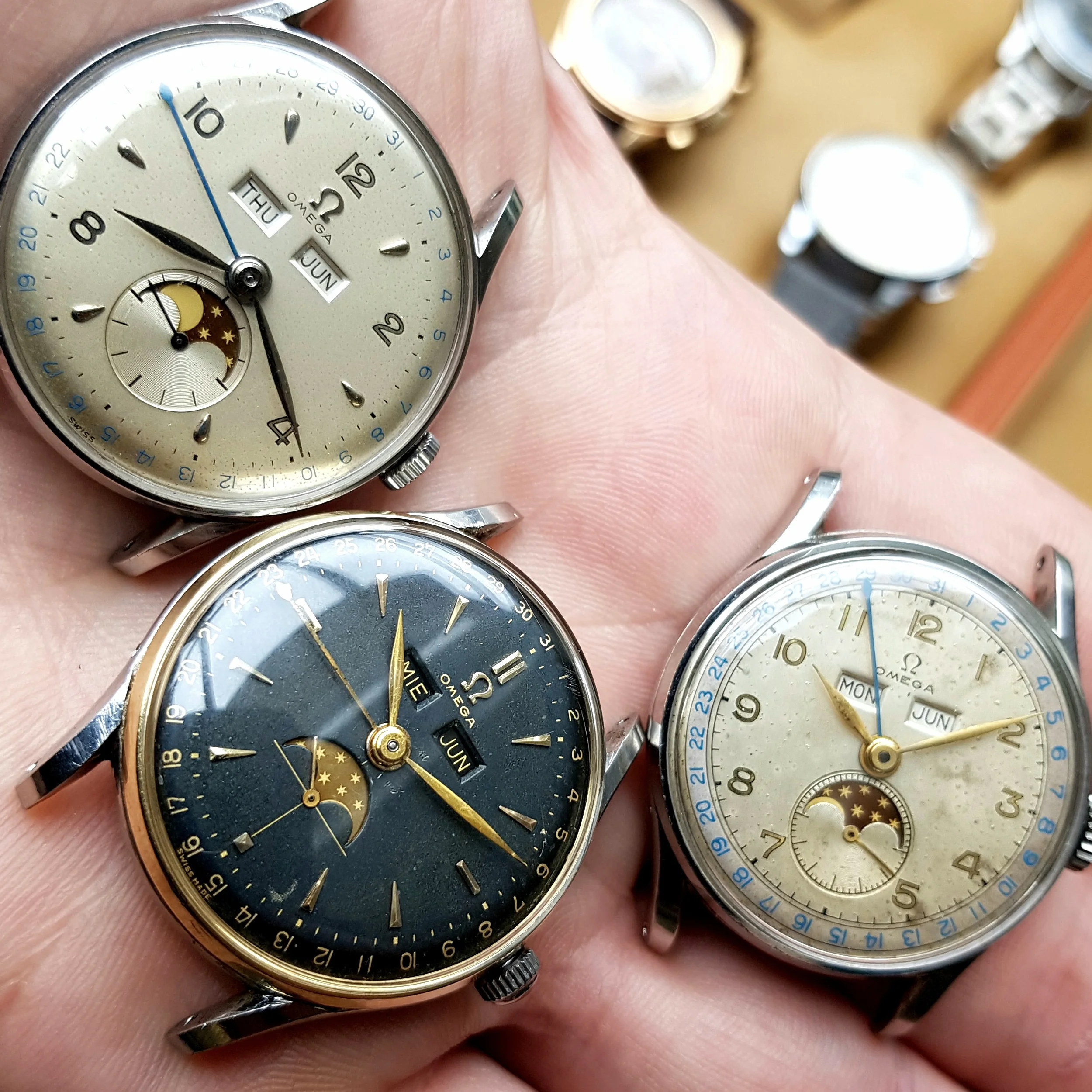

Compare to these which are all also ref 2471:
12
5
Definitely that is something I see now! Also there is no swiss made at the bottom, but i read different opinions about that. Thanks

The dial is fine in my opinion, for now… but one day yes… may need to be refinished again. I may wanna spend some money on spare parts. Can anybody tell me what are the Must buy if you find parts? I do have a lot of NOS parts for 381, however one thing I am trying to decide is if a Moon phase star breaks 1538 part nr ? I know is hard to find… I did found one NOS for $450 and wondering ….should I buy or that is a part that rarely breaks. PS: I am looking to buy in the future another one like this, hopefully this time with original dial. Thank you for all the input
