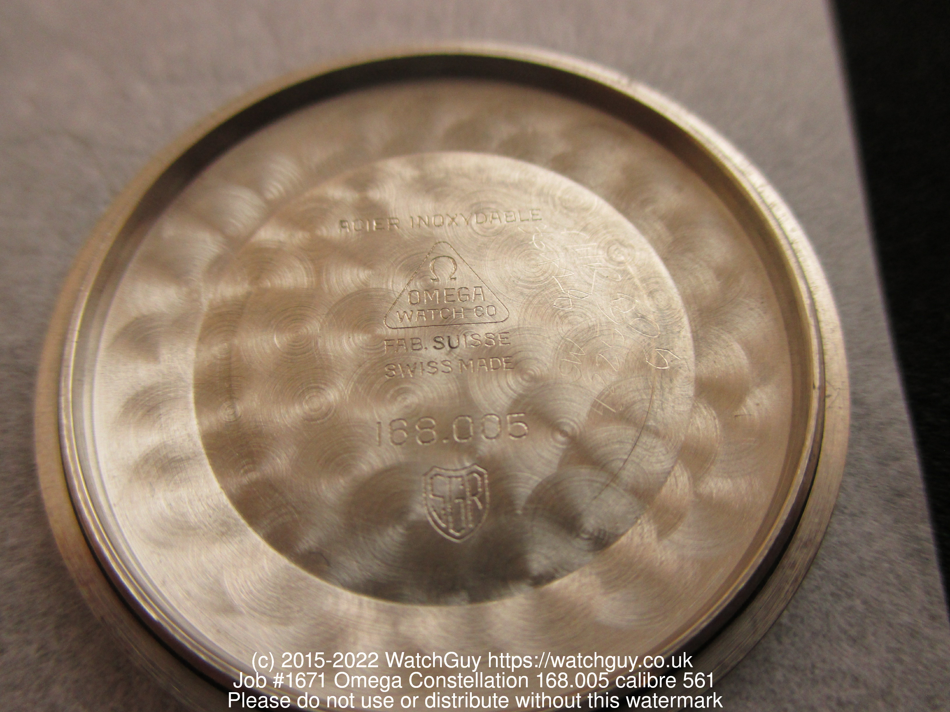

Omega Constellation Pie Pan ref. 167 005 cal. 562

You need to slow down and take your time.
This is an atrocious watch.
Fake dial
Heavily polished case ( not sure if it is genuine)
Wrong crown
Mash up movt
Wrong case back. ( for a date version)

I'm glad you're writing this @Peemacgee. I wasn't sure, either. The finishing on the inside of the case back, but also the medallion look fishy to me.
you're quite right @iamvr
the perlaging in the case back is wrong
Whilst SGR used various styles of engravings, the turned circles should be interlocking, like this 168.005
