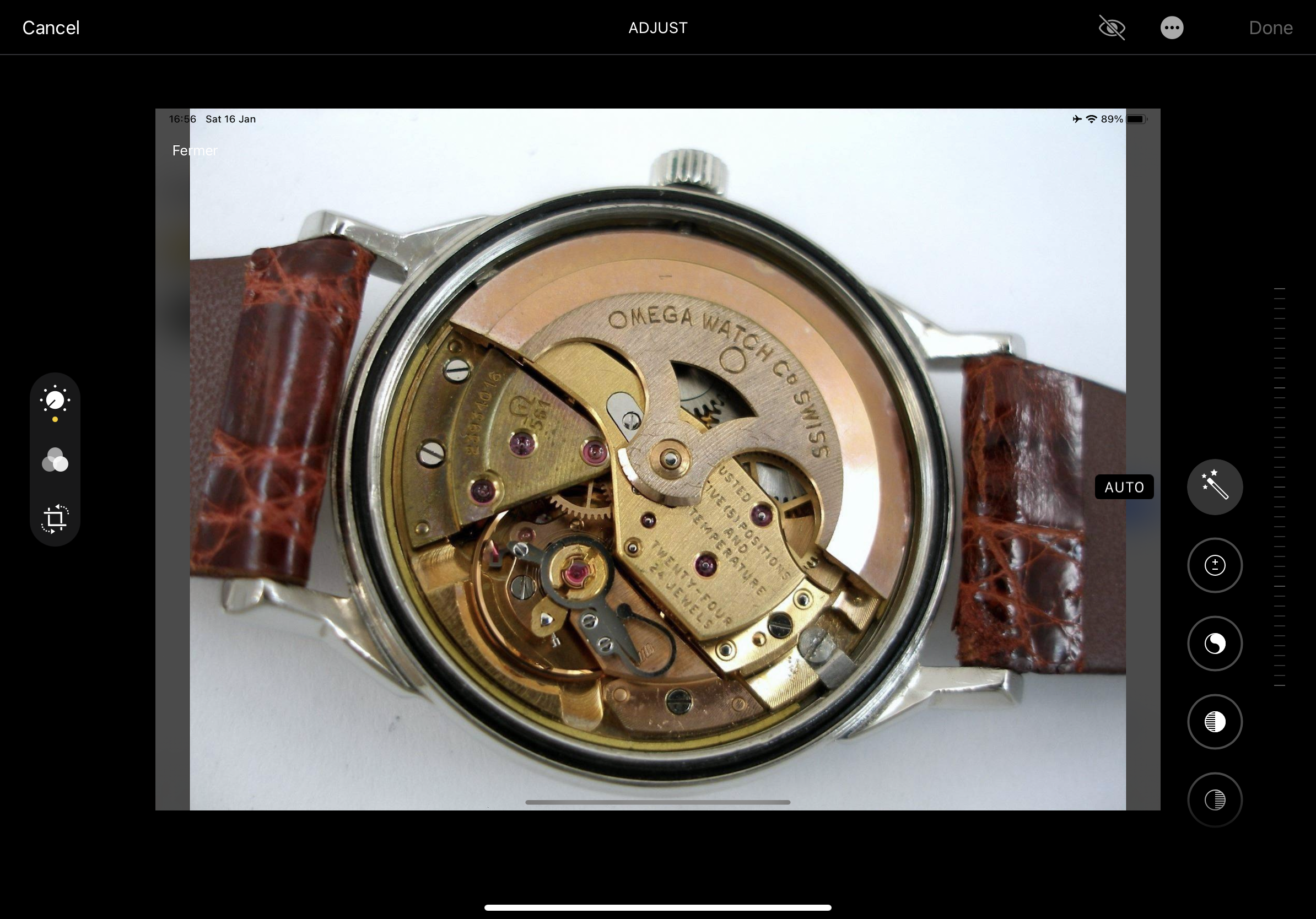

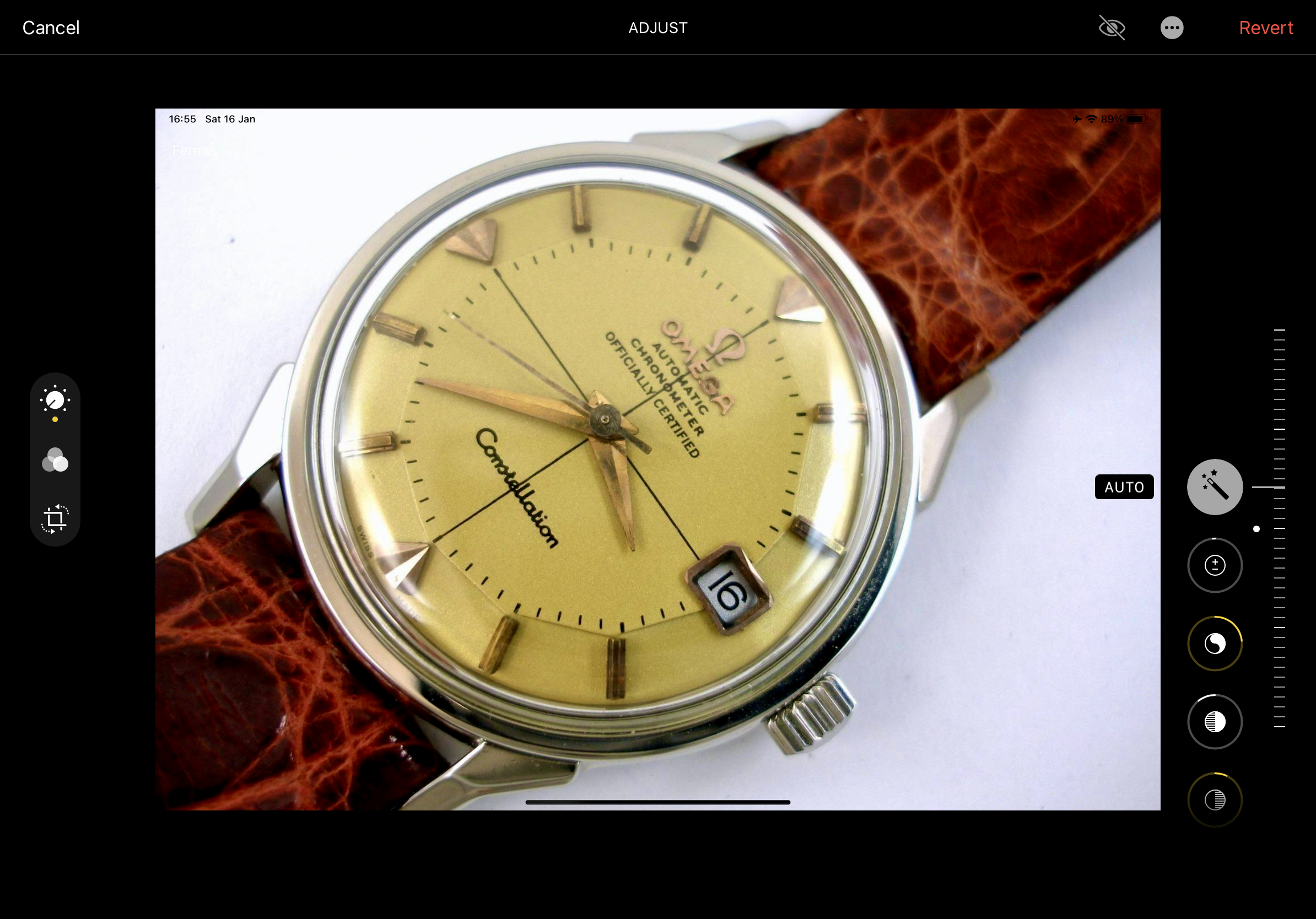

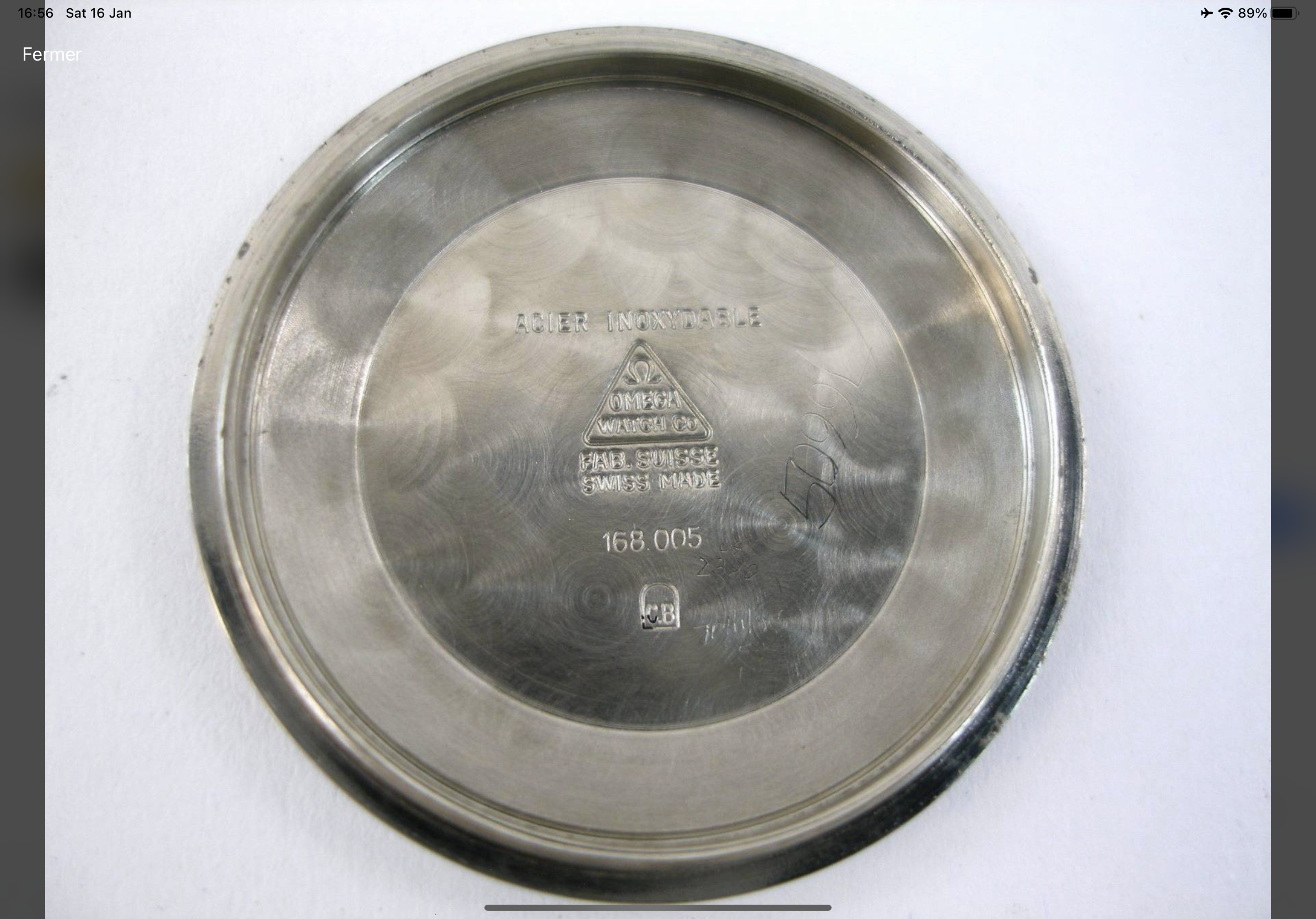

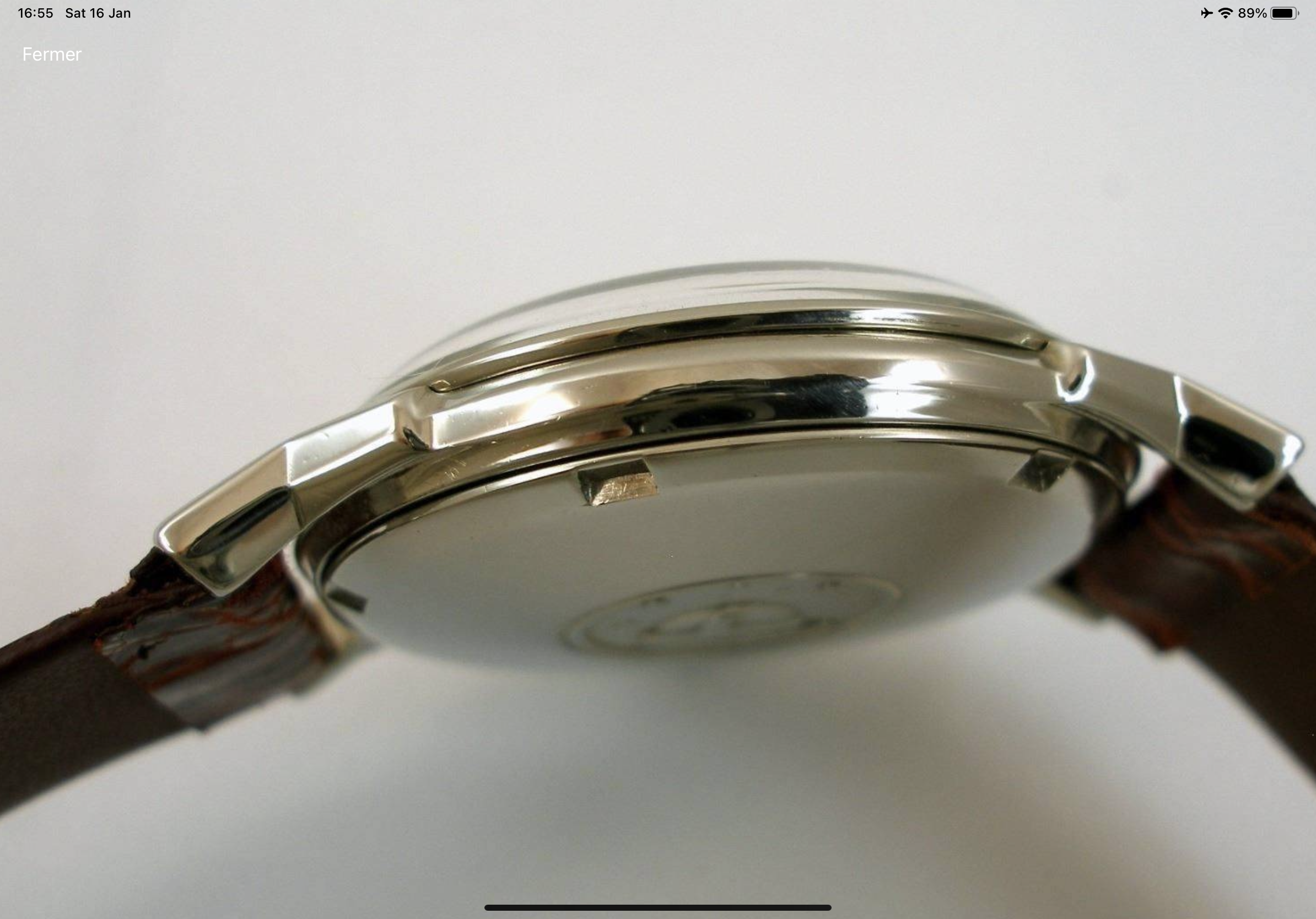

i get offered this constellation for a reasonable price , but some other pairs of eyes appreciated looks full correct for me but maybe I am wrong and before making the deal any other advise appreciated.
surely a traditional wrong crown
Paul
10,804
16,814
Obvious redial I am afraid. I'm surprised you didn't spot it yourself, you've been around a while now.
The fonts are wrong and far too heavily printed, also take a look at where the minute track misses the corner at 4 o'clock and 10 o'clock.
24,836
55,255
It's interesting that they gave the dial a uniform fauxtina shade before painting the markers. You don't usually see that. The case is also pretty soft IMO.
1,594
2,026
Holly shit 😀)) it is time to go to the optician those markers , the dial was appealing and the print was « correct , many thanks for that i learn something .
The speedmaster and those constellation is a market like the Australian lagoons allways a predator waiting on you 😀)))))
Paul
13,492
31,811
Completely fake dial, the markers aren't even close to correct.
