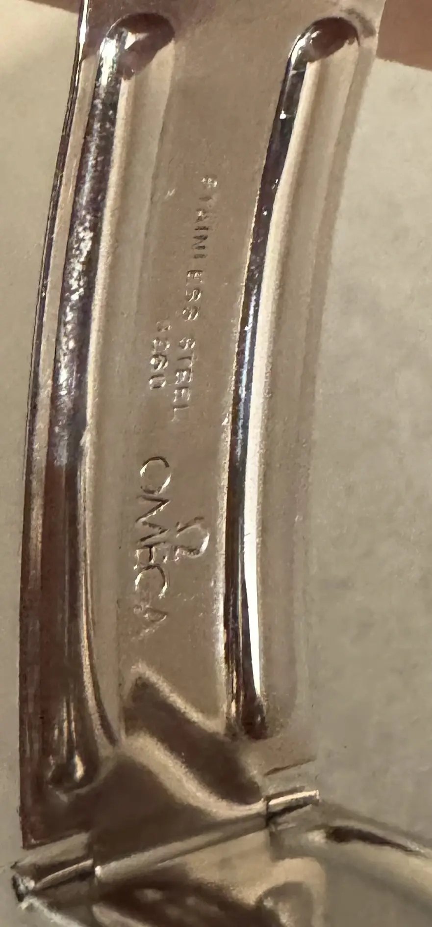

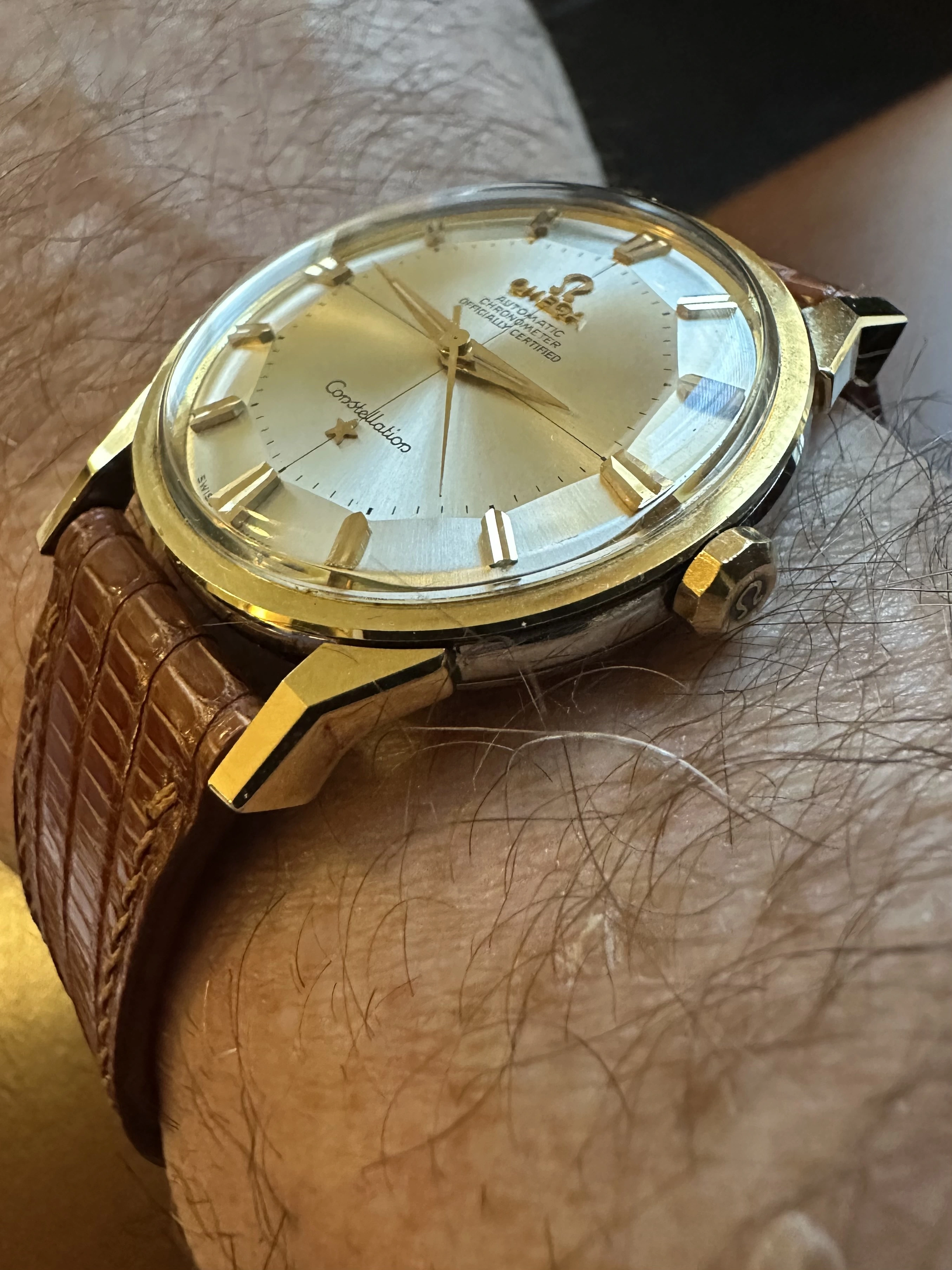

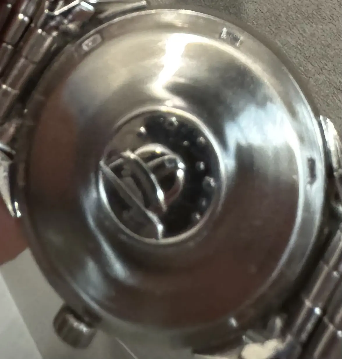

Hello everybody and thank you for making me join this forum. I am a watch enthusiast and just purchased my first Omega which is a Constellation 14900 62 SC with a 551 movement (please refer to the pictures attached, I don’t have a movement one unfortunately and I’m not good at opening up watches especially vintage ones). I instantly fell in love with it, especially due to the Pie Pan dial and golden touches. I have not found the same configuration on another watch yet (color of the indices/hands/logo, no crosshair dial, no ‘Swiss Made’ indication on the dial) and would like to know your thoughts on it. Thank you very much in advance!

It is unfortunately a repainted/redial watch, which is why the 'swiss made' is missing. Sadly a replaced crown an unfortunately way overpolished lugs. Hopefully you didn't pay too much, (or can get your money back), else enjoy it!.

I did not expect it honestly. I got it from a reputed seller who provided me with a certificate of authenticity and informed me the watch had been serviced and was all coeval meaning all the parts were from its original era. I really like it honestly and paid 1800 euros for it.

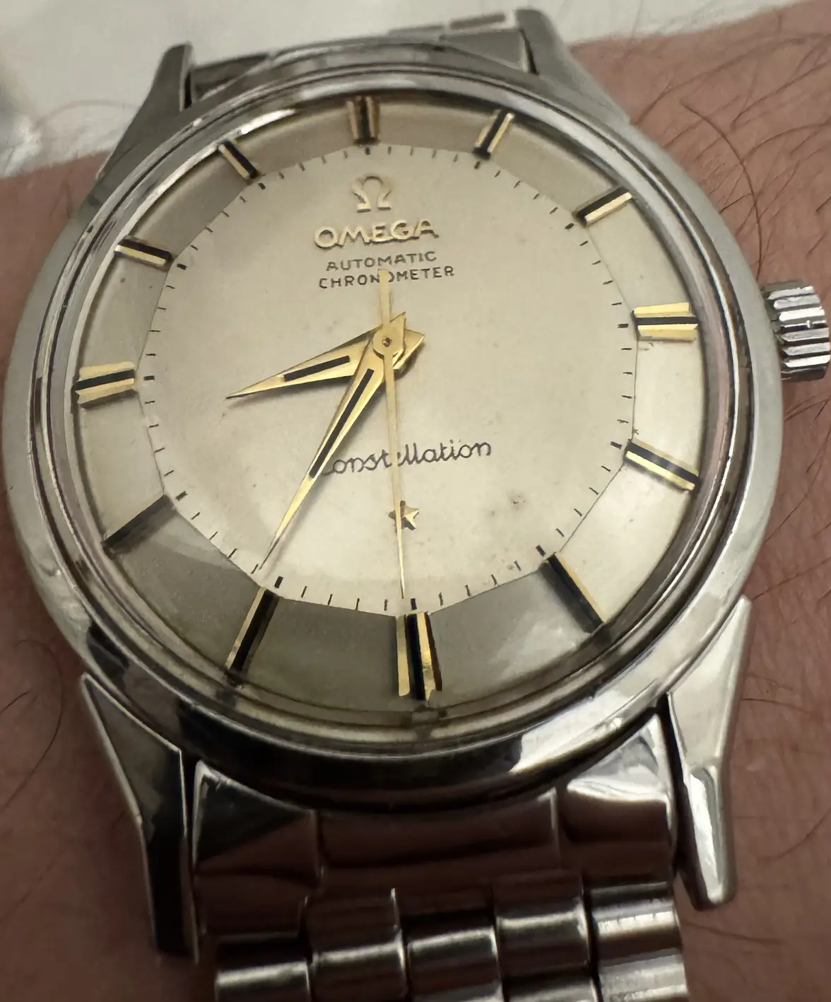

In that case, here’s what it should look like: https://omegaforums.net/threads/constellation-14900.171954/

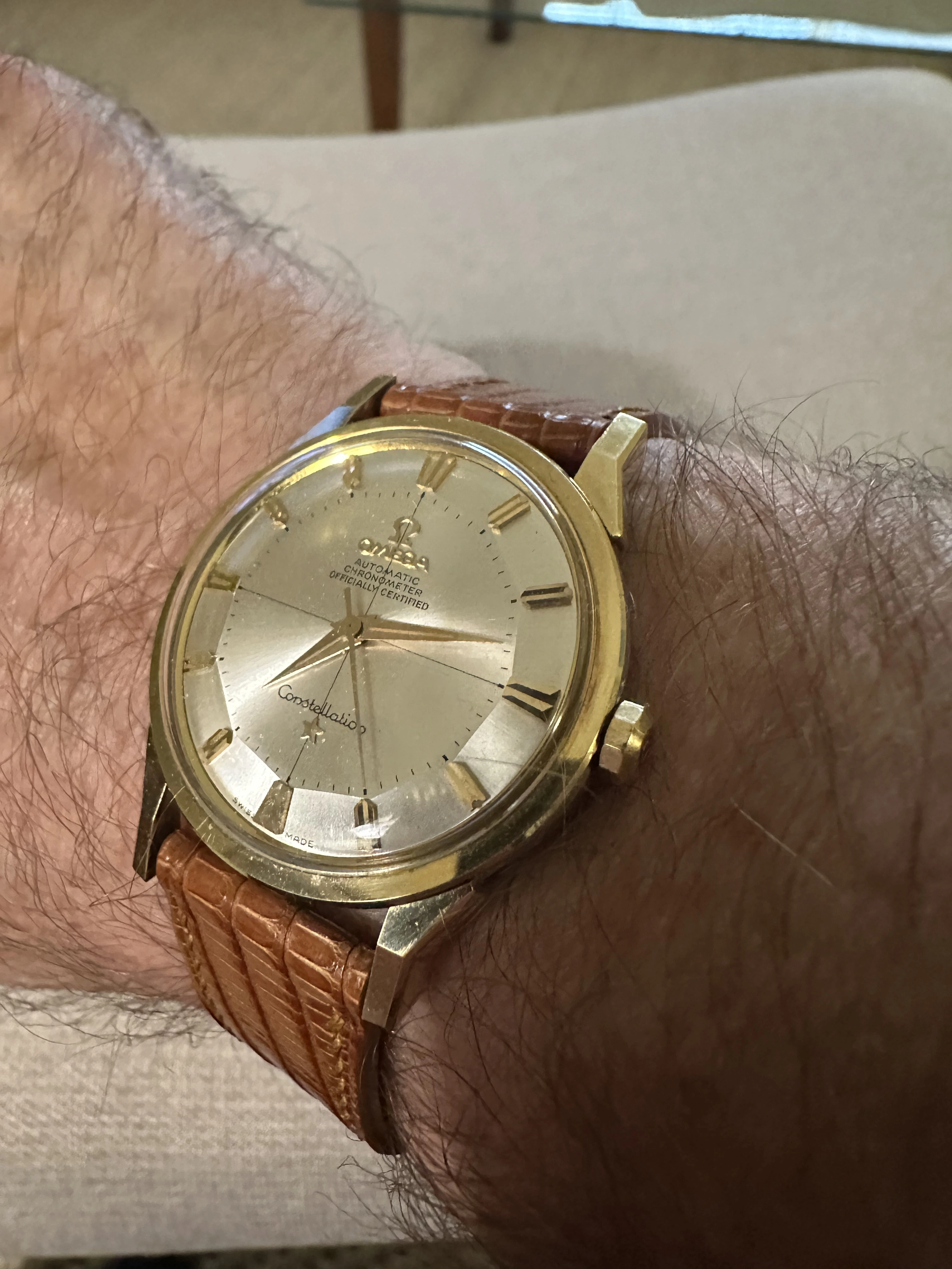

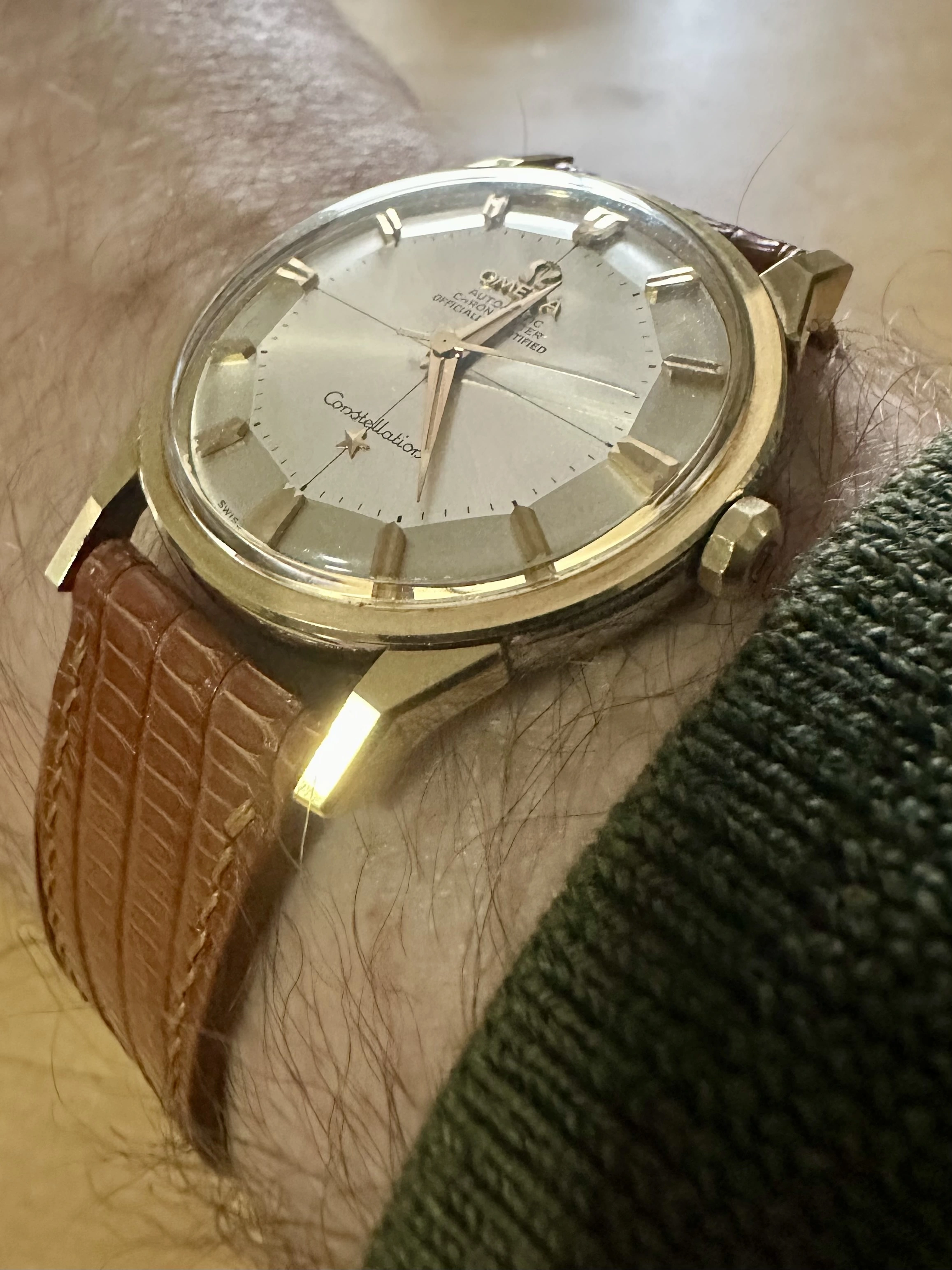

I would suggest trying to return the watch and get your money back. The watch has a lot of issues and it’s certainly not an 1,800 euro watch. Here’s a few photos of an excellent 14900 62 SC to compare. I think that you will become less happy with your watch over time when you have a better idea of what a good example is. Best luck to you.

Thank you, that’s a beautiful piece you have there, may I ask the current price for a model like yours in gold?
