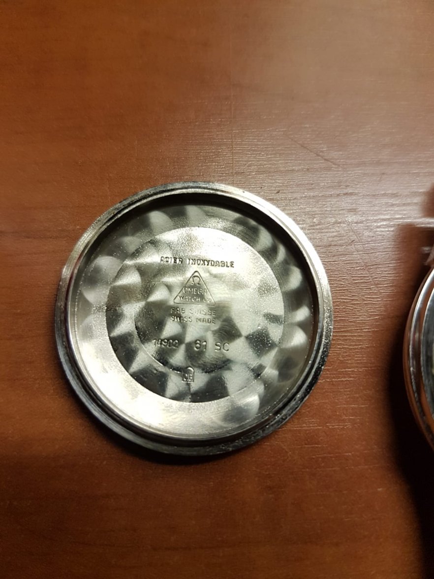

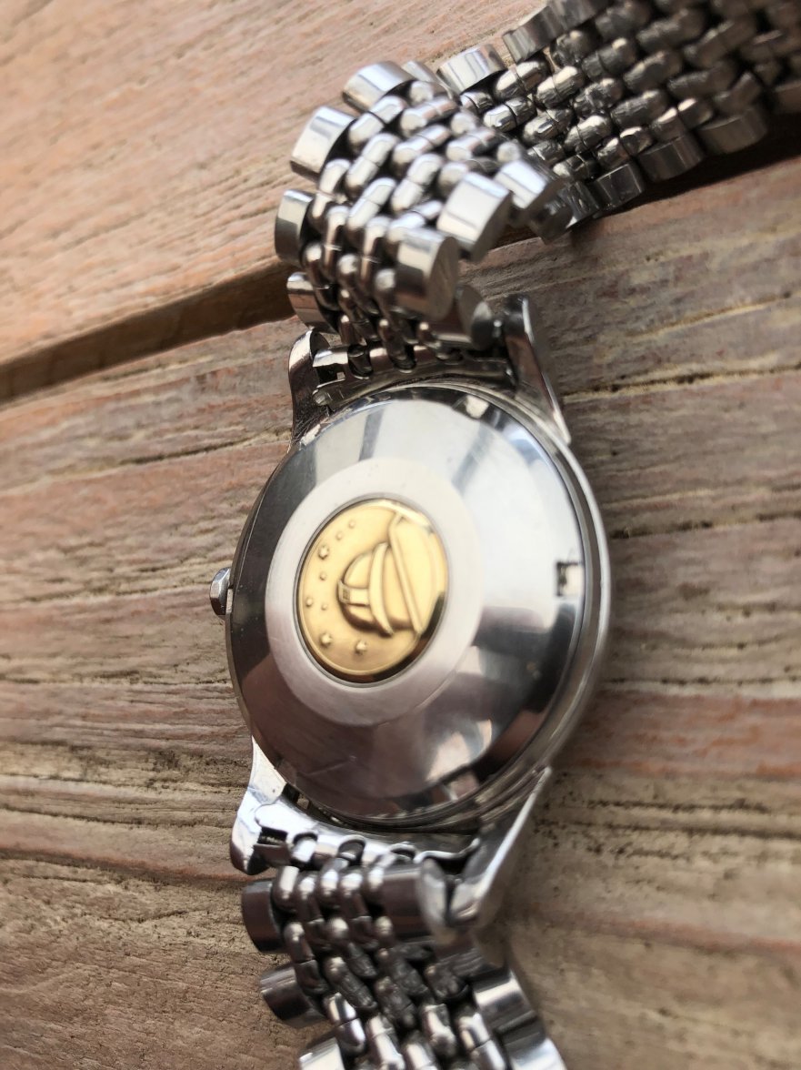

It seems to match pretty well. All original, except for one thing...the cap. The seller explained that this ones cap was replaced with the cap of a 14902 61 SC at some point, because the original was in bad shape.
If the rest is all original, I can definitely live with this fact. Anything that seems wrong?

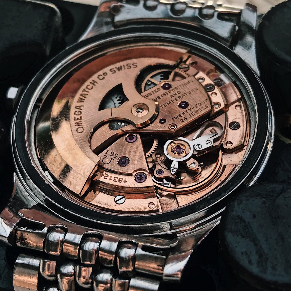

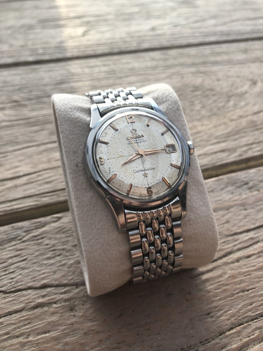

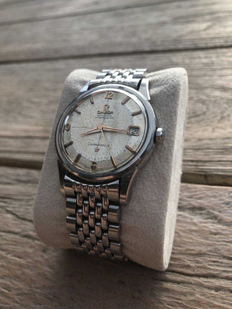

The dial corrosion is a deal-killer for me. Movement is dirty and looks like rotor has been rubbing on the caseback. Medallion is heavily polished (but since caseback is not correct, really doesn't matter).
The shallow depth-of-field in these photos means some items are too out-of-focus to judge. Also, there is no straight-on photo of the dial, and they (strategically?) omitted a photo of the crown.
All-in-all, this one would not interest me at all unless it were priced very low. You do not indicate the asking price...

That's not looking like a $1600 watch to me whether it comes with a BOR or not.
Besides the fact that the case back is from a different reference the nail in the coffin is the mismatched gold colour. The dial furniture looks to be rose gold and the wrong case back medallion appears to be yellow gold. A correct watch would of course have matching gold details throughout.
I'd say avoid, for that kind of money there are plenty of good Constellations to be found.
It might need a service, I see.

Is it me or does the rotor have a crack in one of the arms?
DON
It sure does. And it looks like there is a notch in the bottom -- just to the right of the crack -- that comes partway up the side.
