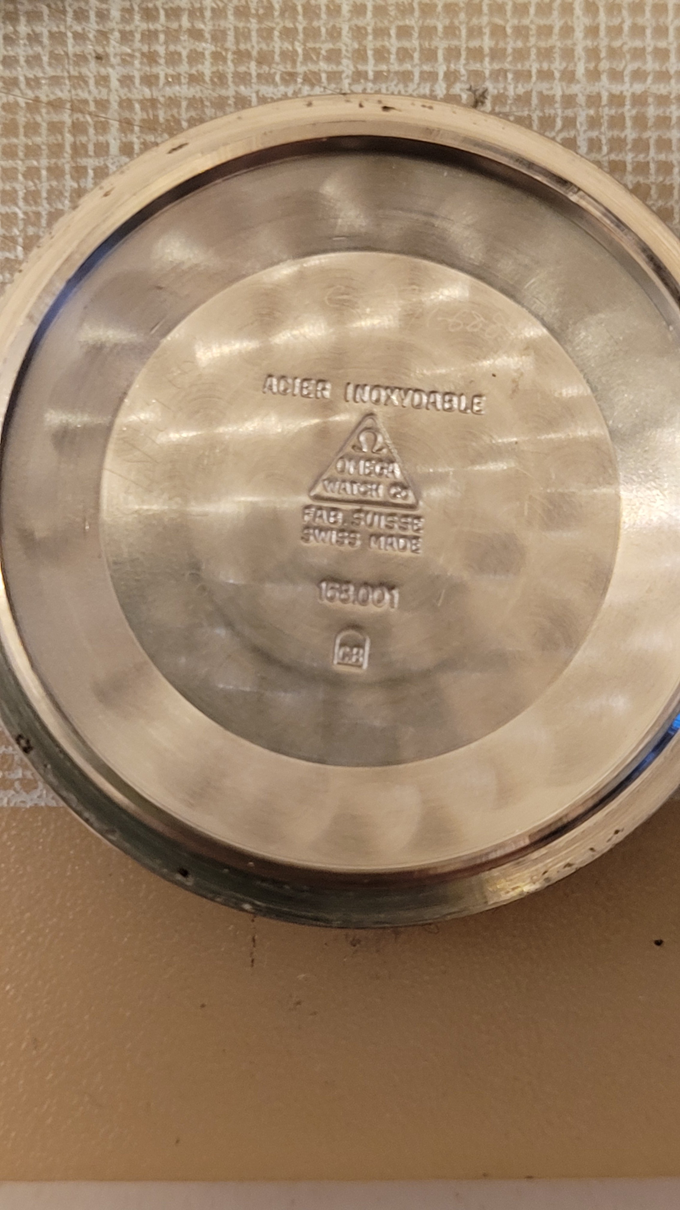

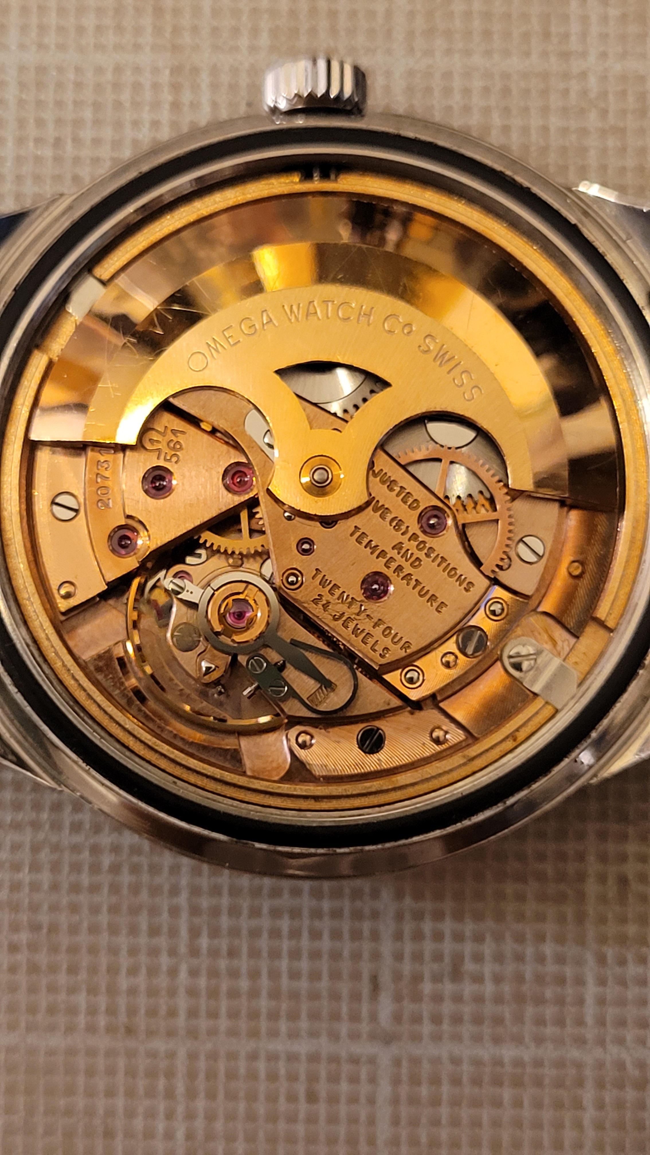

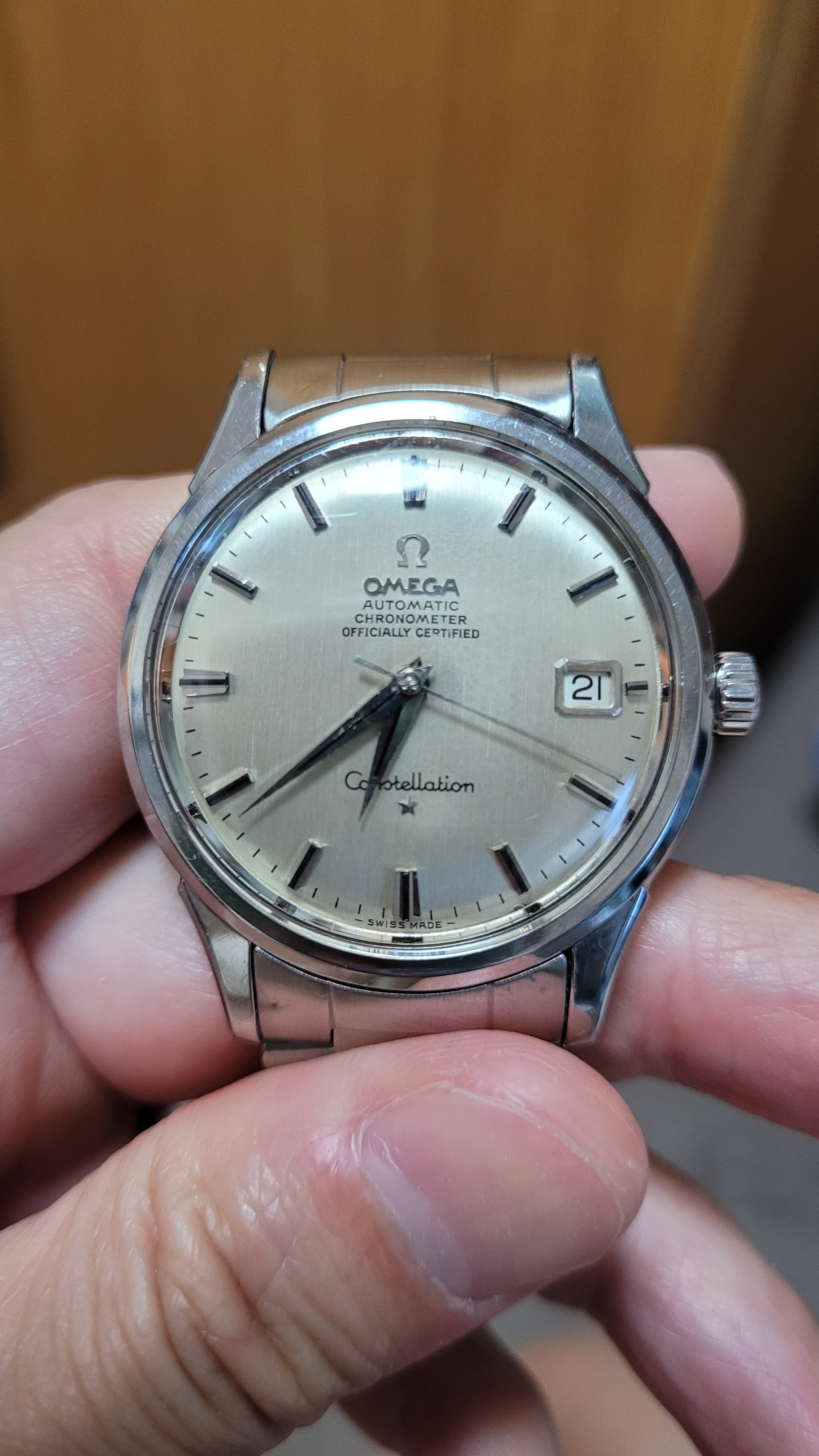

Just bought a vintage omega constellation watch. Please help to check if this is an authentic omega constellation watch. I did some research on the web and found that the font style on the "n" of constellation is different to others.
Thanks

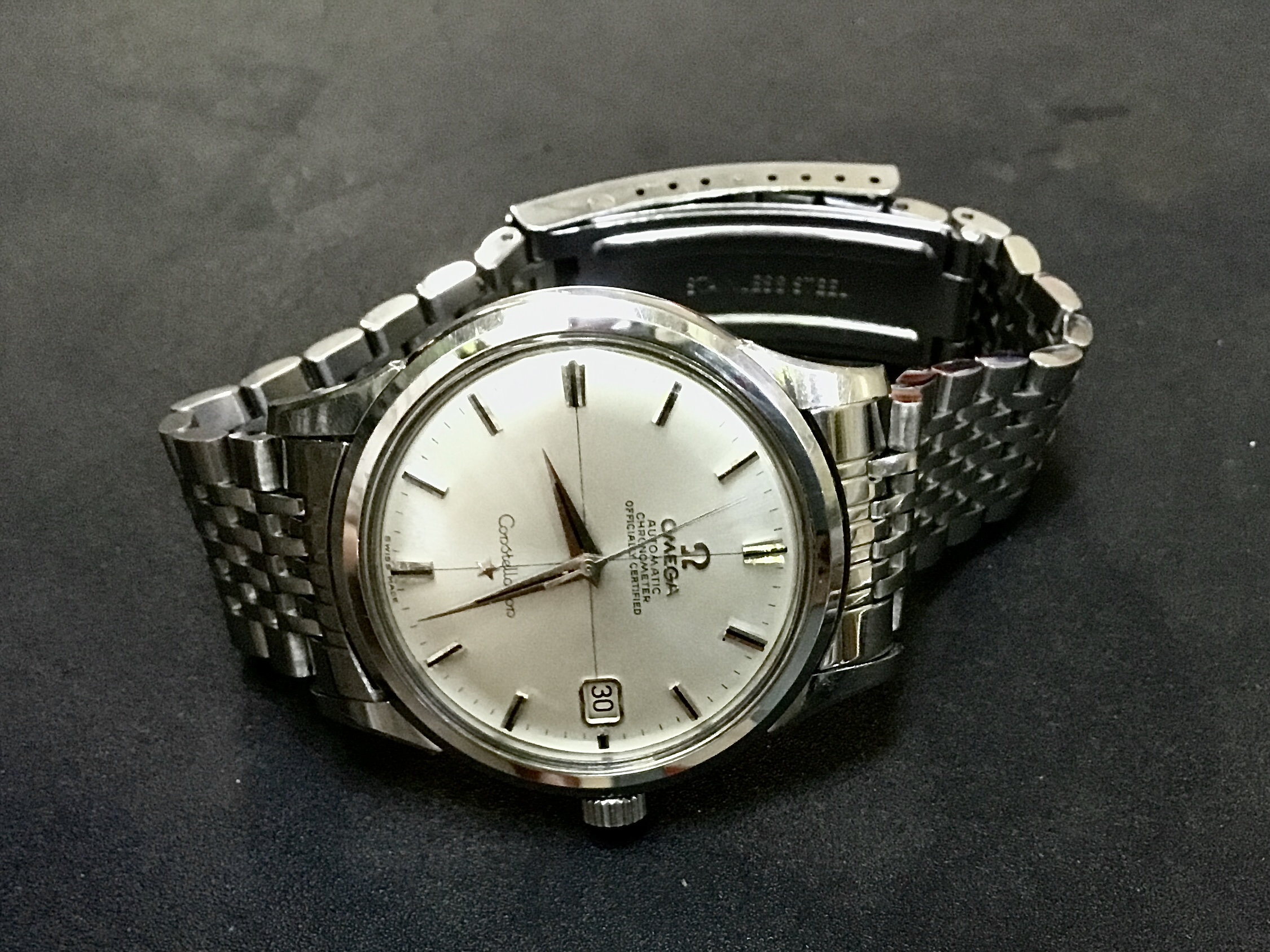

I would say a legit 168.001 Constellation. Mine (although wrong second hand, aftermarket bracelet) says hi

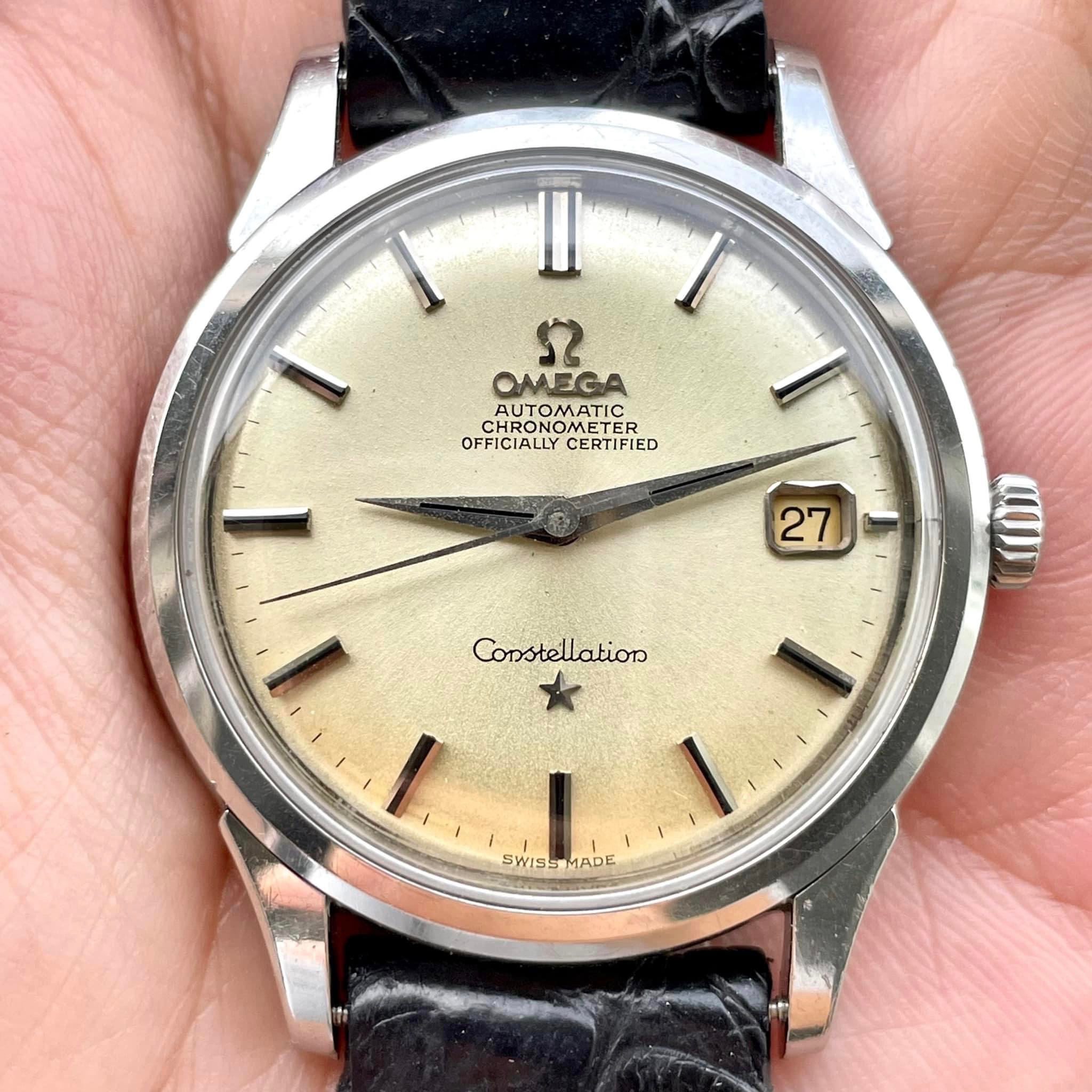

I vote for redial, the Constellation text seems too bold and the "n" should be curved, plus the minute hash marks seem too long and too bold and uneven.

Clearly a redial IMHO, as @iamvr said the "n" of Constellation is cleary a red flag, the texture of the dial seems strange... same thing for the dashes on both sides of the swiss made.

Funny how this…
…can be enough to know it’s not legit. And it’s not.
