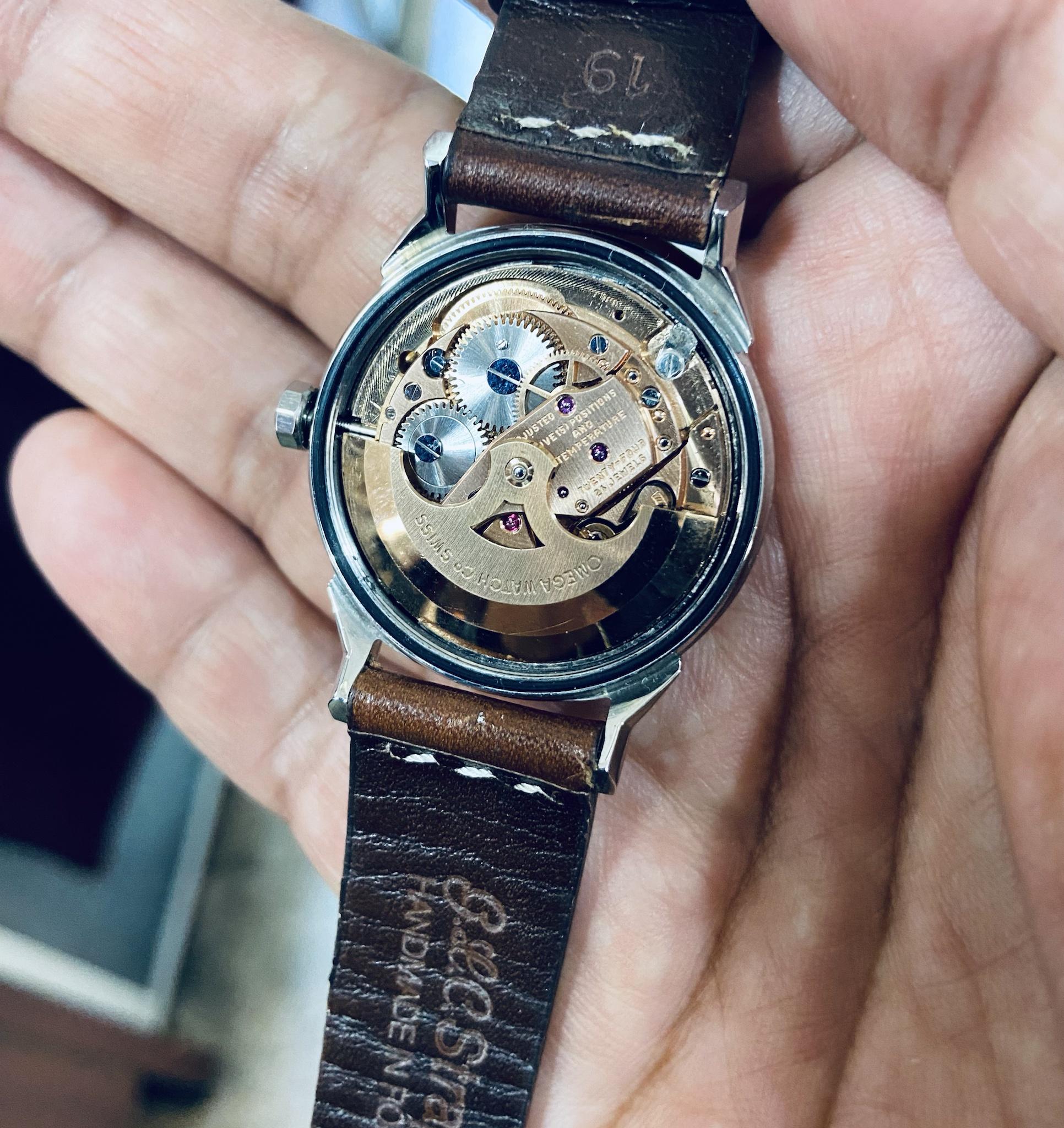

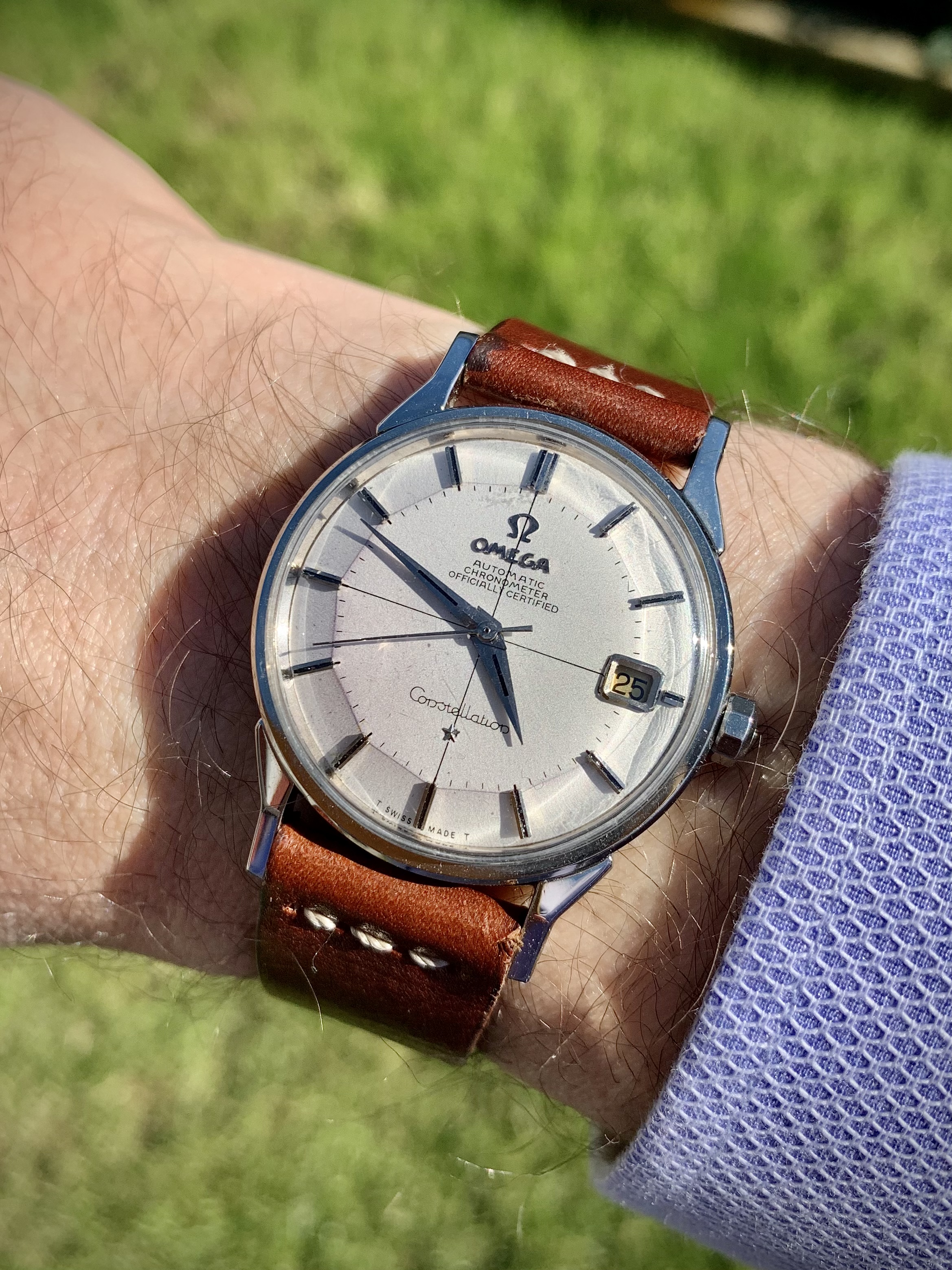

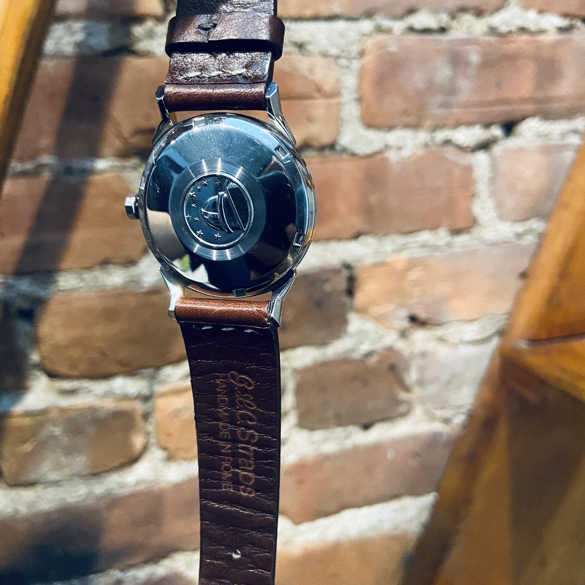

Purchased recently, and a little concerned with what I am seeing on the dial. Would love some feedback from those more experienced with these vintage Constellations.

Poorly refinished dial and incorrect hands ... but on the bright side, all the words are spelled correctly. 馃榿
13,491
31,809
All fake except the movement, sorry.

Sorry mate, that is a lemon
even the watchband is wrong (19mm) 馃檨

The first picture itself gives it up. The lettering is so badly done...

yup, classic fake case and dial.
unusual in that it actually has a chronometer grade movt - unless they switched the bridge on a standard movt.

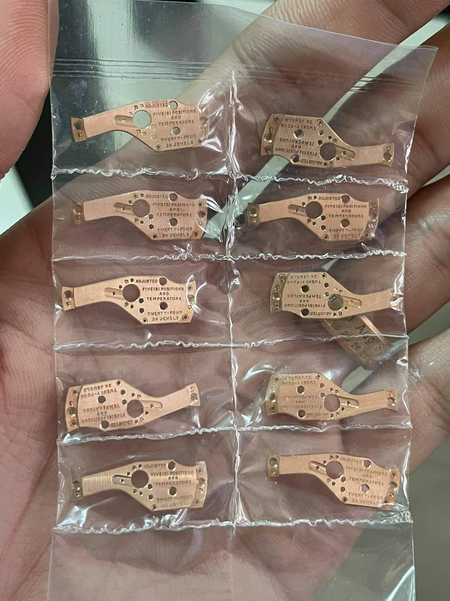

Are you sure?
Jeez, are you serious, this is really going to the next level, the movement is then a chronometer designated 565 or the suchlike? 馃檨

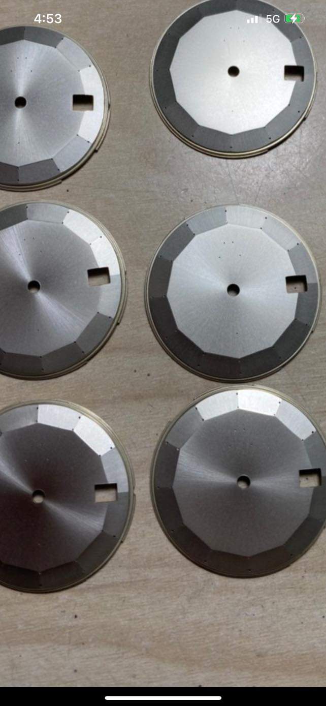

But if you have this and other kinds of evidence of fake parts ( for example I remember the stepped pie-pan dials ) would it not be more helpful to post it earlier as a warning sign to us all. That would be greatly appreciated by many, many here, myself included 馃榾

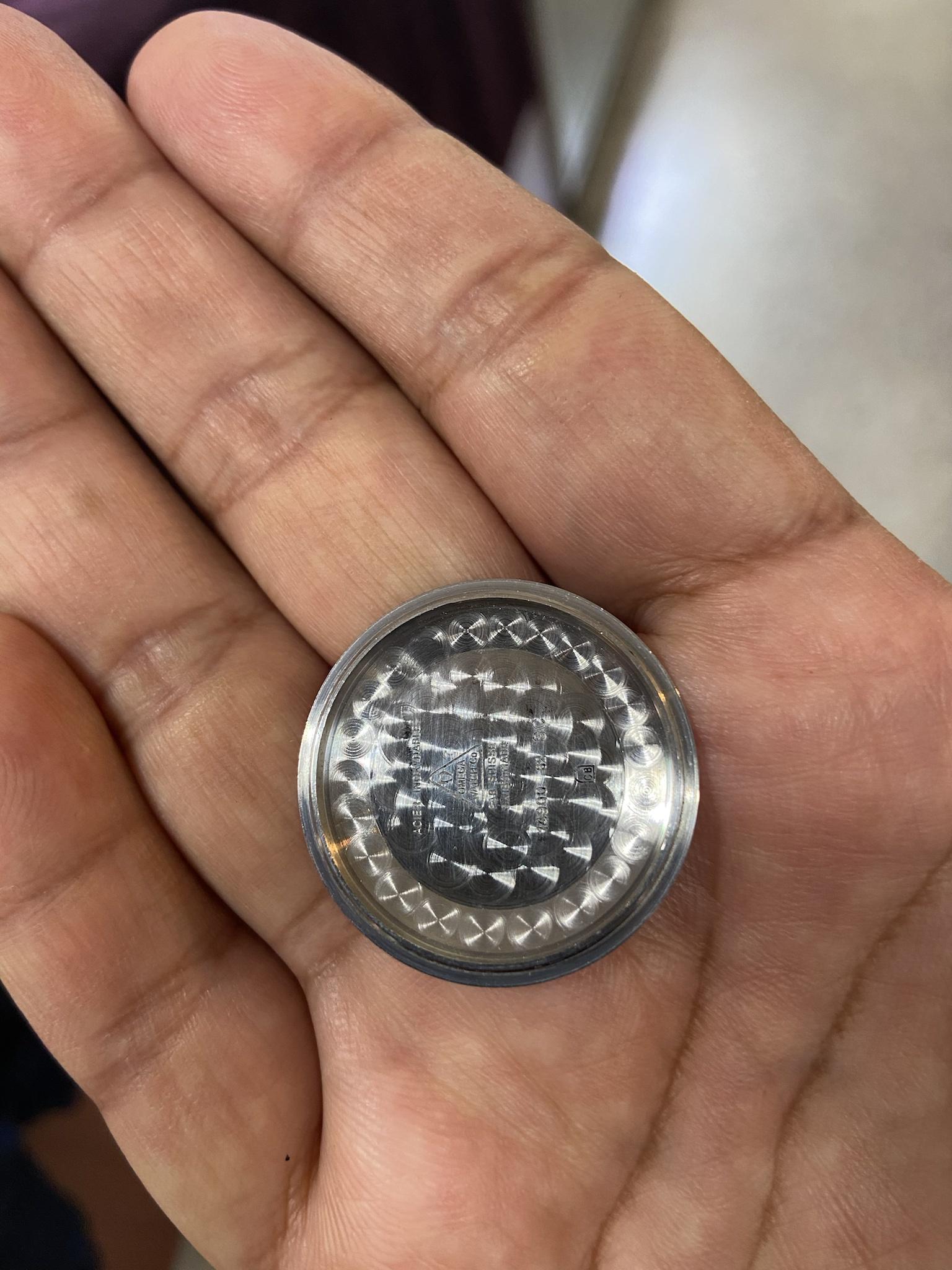

More for you

These pics frighten me 馃槻
