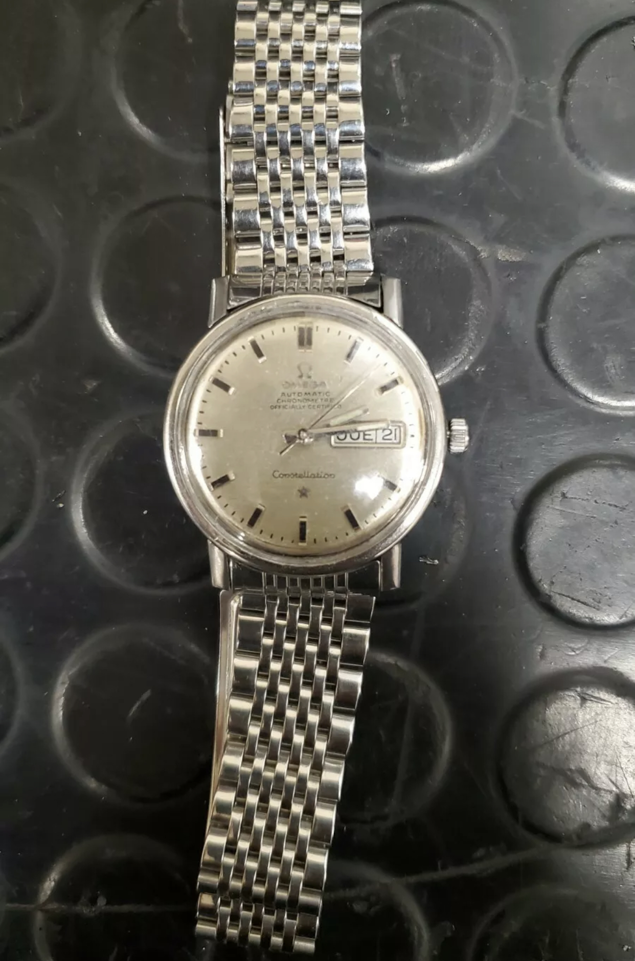

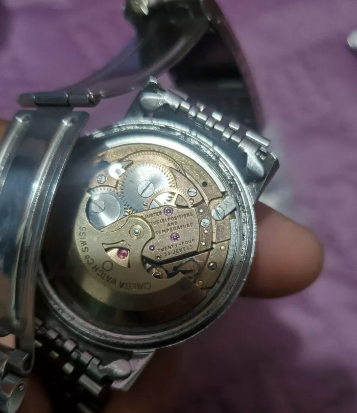

Hi all, still learning about these watches and started to do more research on my own.
Saw this watch on eBay and also asked for some more photos.

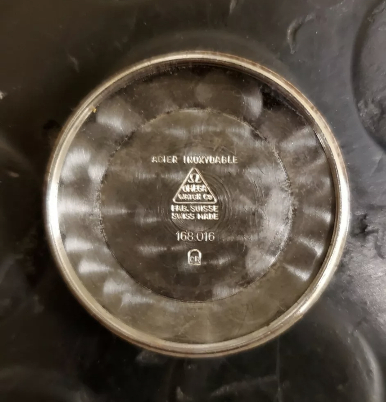

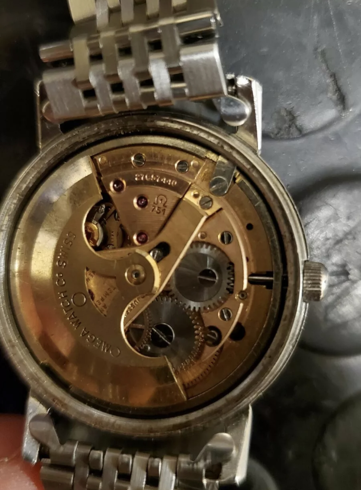

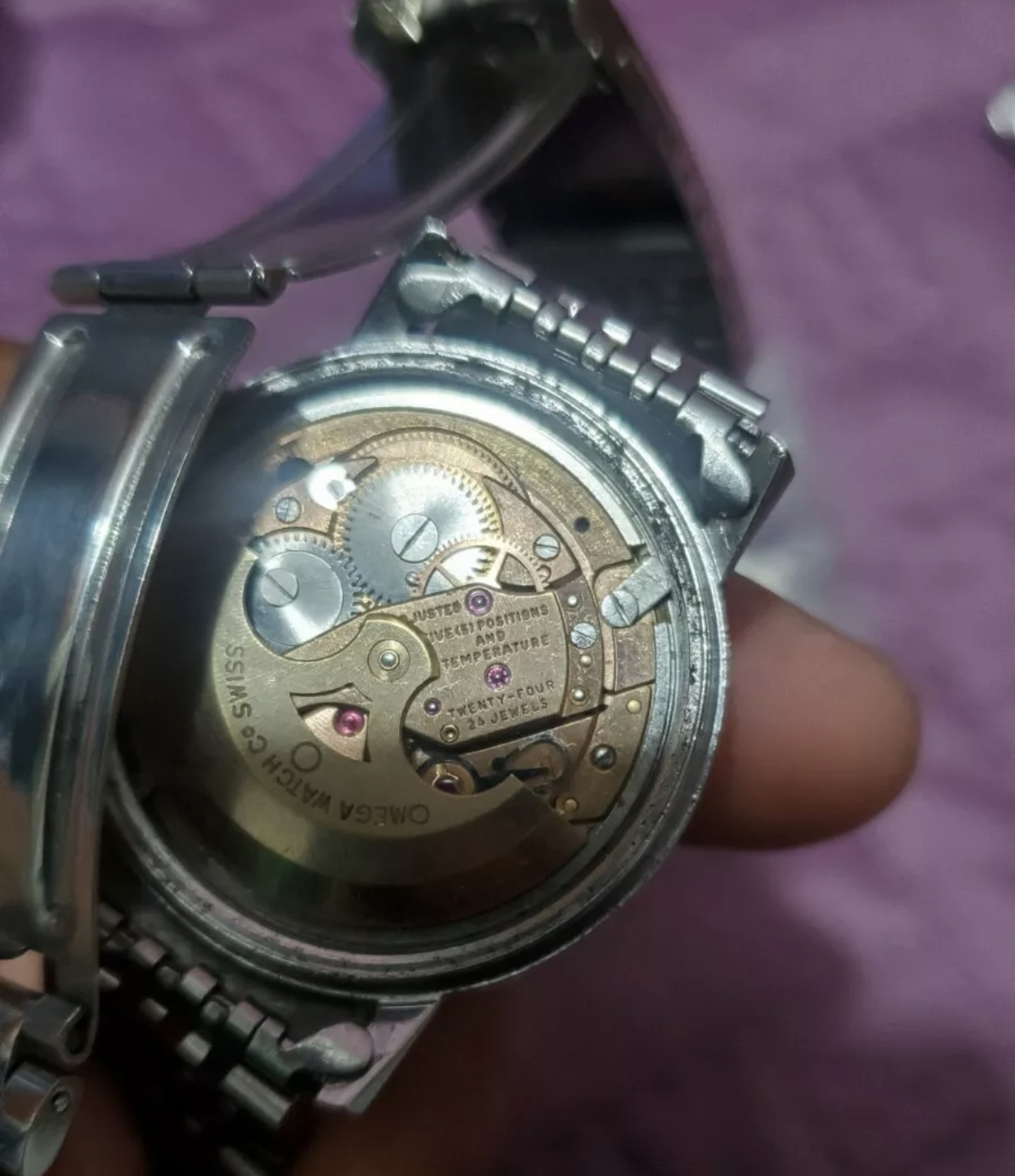

The hands don’t look original to me and the pearlage on the inside of the case back also seems a little off. Other wise anything else stand out?

Movement looks to be very tired, case tabs are sus, dial looks to be re-painted.
I personally would pass.

Not original movement clamps. Agree, dial is a repaint.
