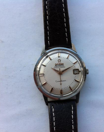

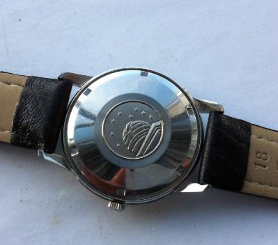

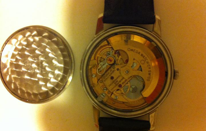

    I am looking to buy a Constellation, and I found this one for sale.
    It looks to be in good condition, although I have 2 problems.
    1) Is the dial original or has it been tampered with?
    2) The given reference (168.004) should be of a cal. 561?
    I would appreciate any and all advice/help possible.

    The 168.004 should have cal. 561 not 564, but the mid-case is also wrong for that ref#. It's a complete franken!
  8. X350 XJR Vintage Omega Aficionado Mar 14, 2016
    12,625
    29,941
    +1
    A complete mess.
