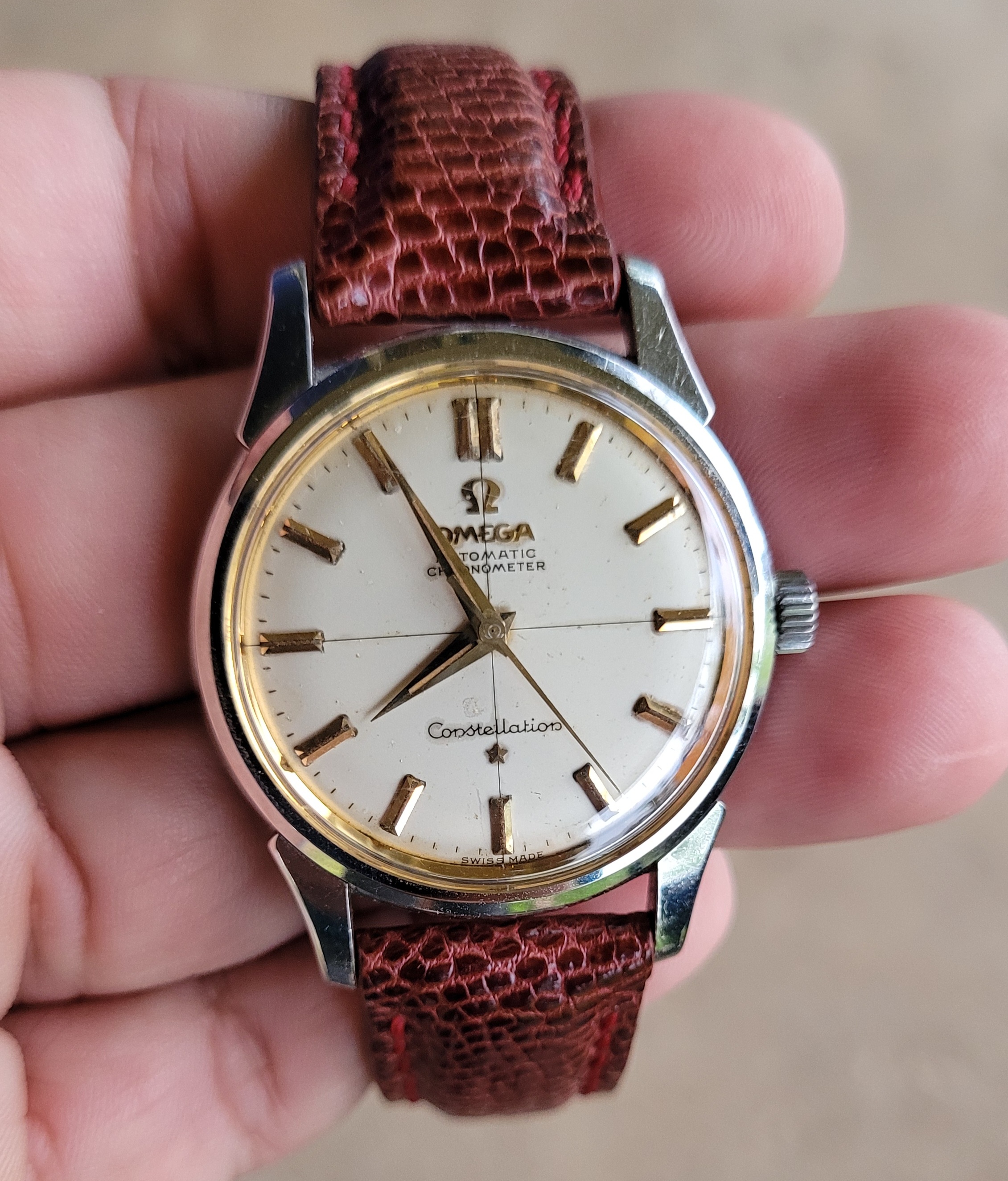

Here's my 1960 14381. Notice that the minute hand extends to the track, this is something to always look for. You'll also note that the crosshairs extend through the "Omega Automatic Chronometer," and the "Constellation" scripts, something else to slays look for.
On a 14381, yes. But for other refs, there are exceptions to the rule:
Yes, you are certainly correct and I should have been clear on that point.
