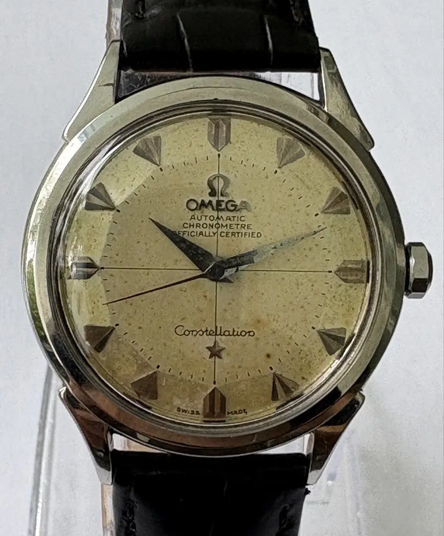

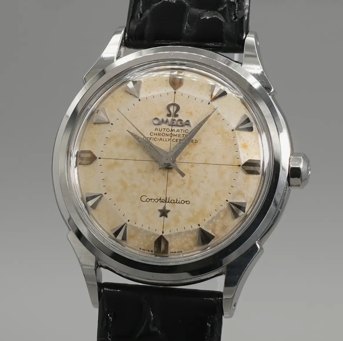

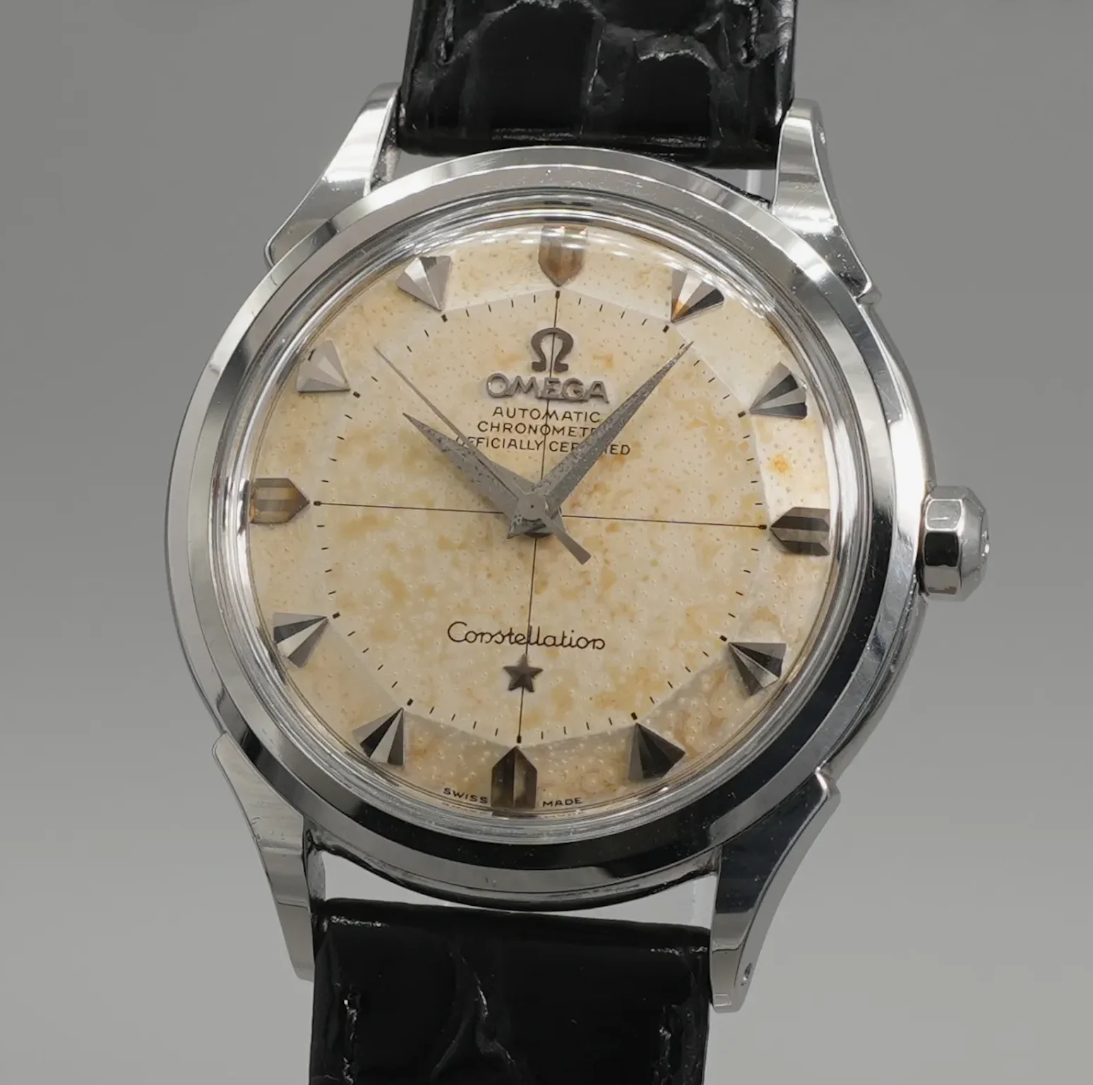

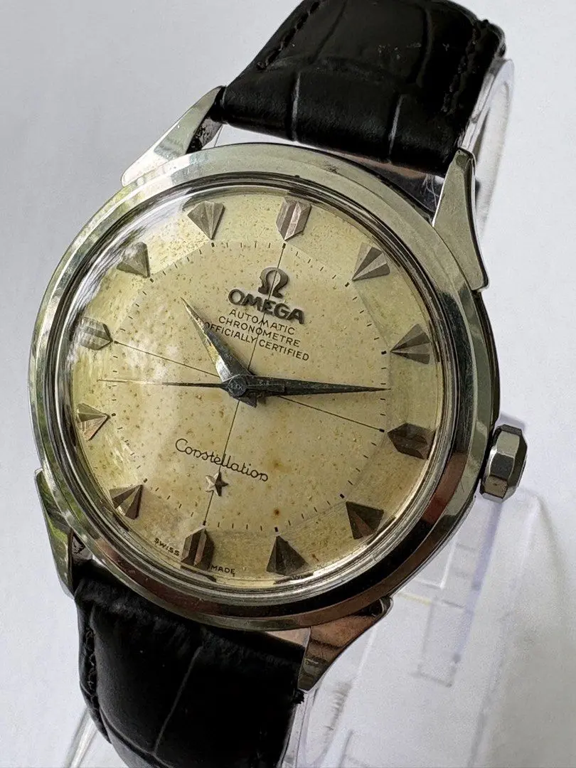

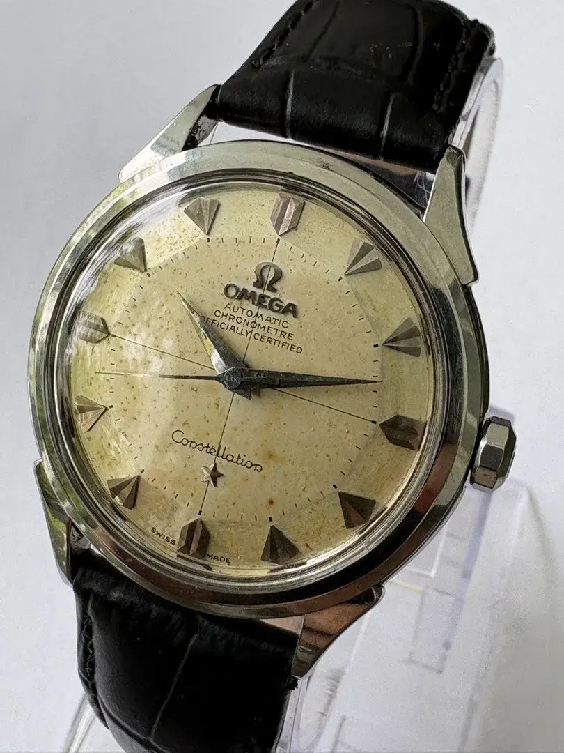

Hi guys. I am looking at buying this 1950s Arrowhead. Patina looks wonderful and I am hopeful it's no redial. The MOY checks I think, the bottom n's, the positioning of the arrows. To me it looks good and I already have a 1952 first gen Constellation in original condition and an olympic champion presentation Tresor with documents. But I dont have some of your expertise, and would appreciate your eyes and collective know-how. I've asked for close ups of the movement and inner caseback. So hit me please.

Hello @Singapore202000
The watch has polished lugs but bezel sharper
Dial quite damaged with possible water ingress signs on crown side
Hands looks damaged particularly minute hand but could be reflection
Dial has irregularities of minute track, and markers next to arrowhead points are typically round dots so that is question.
Let’s see inside for reference
What is asking price

At first glance, it seems to check out. If you like the watch, and the condition is reflected in the price, then I don't see an obvious problem.
If possible, you should get photos of the movement and inside case-back, to see if everything is correct and consistent.

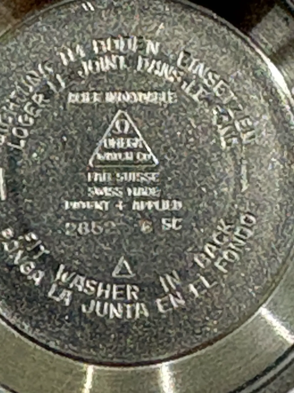

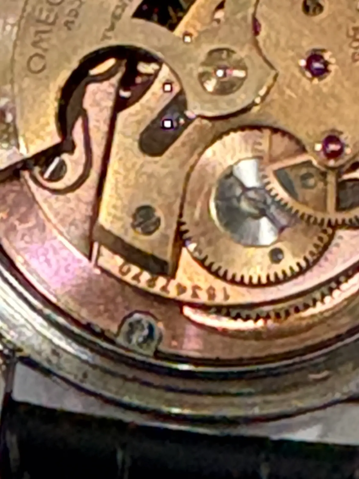

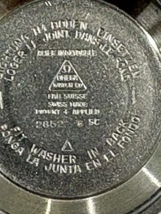

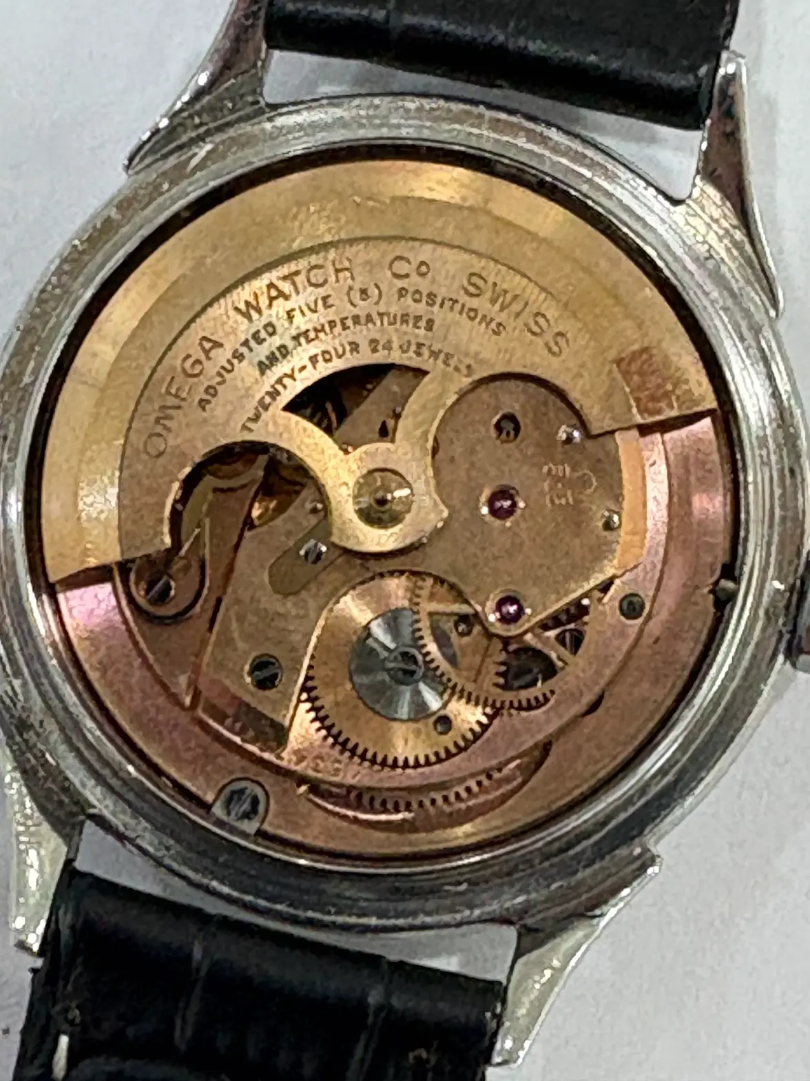

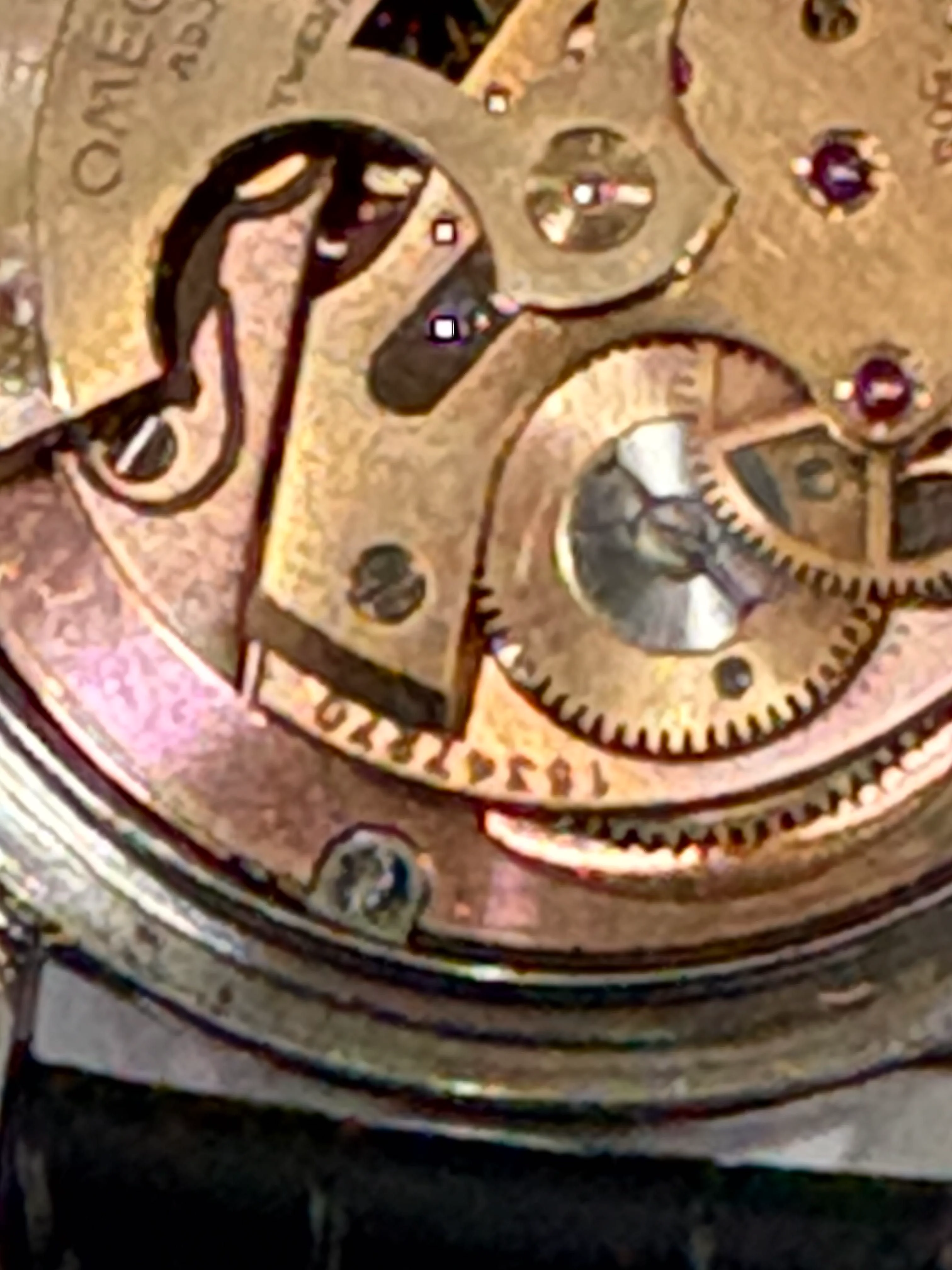

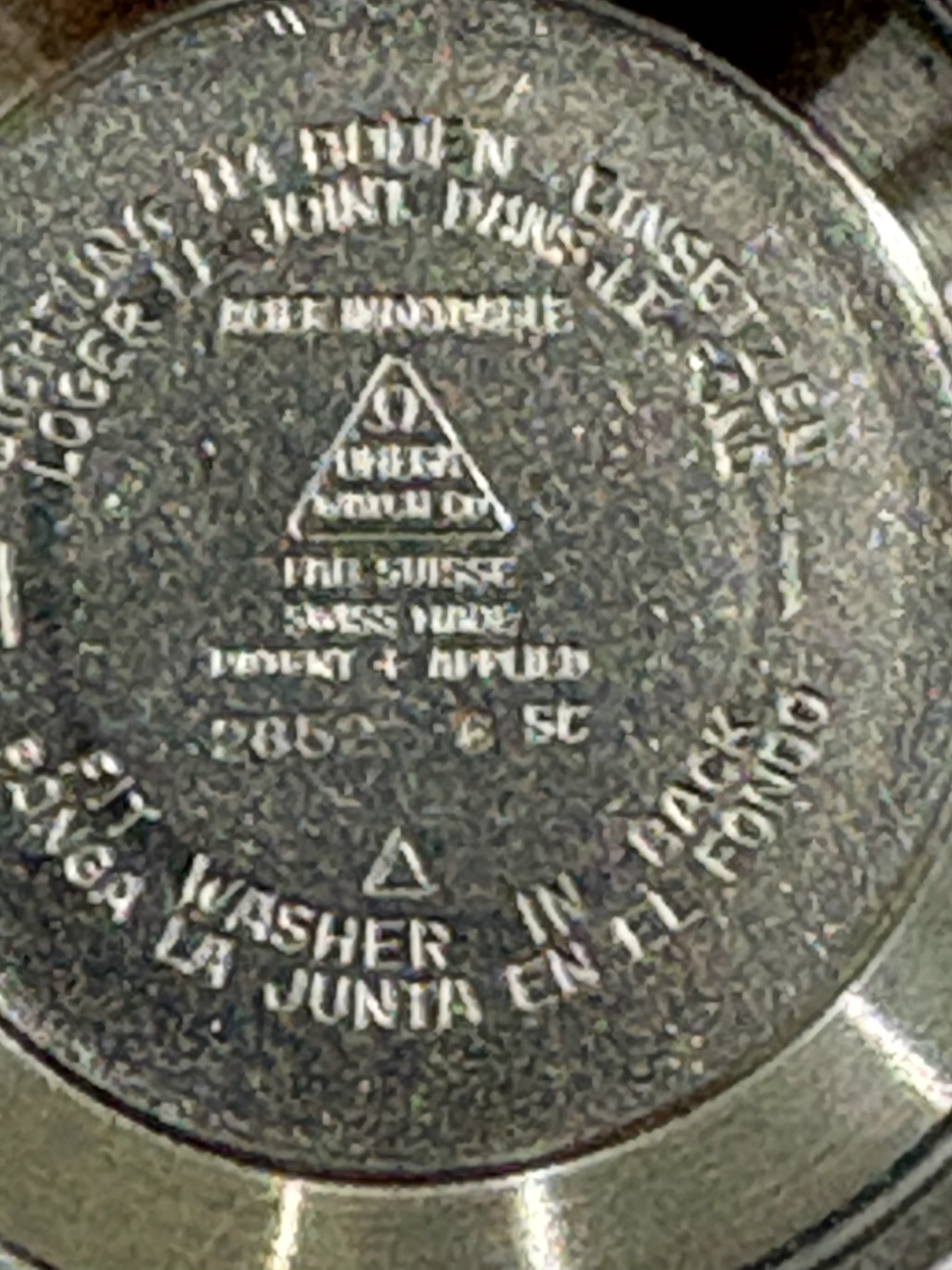

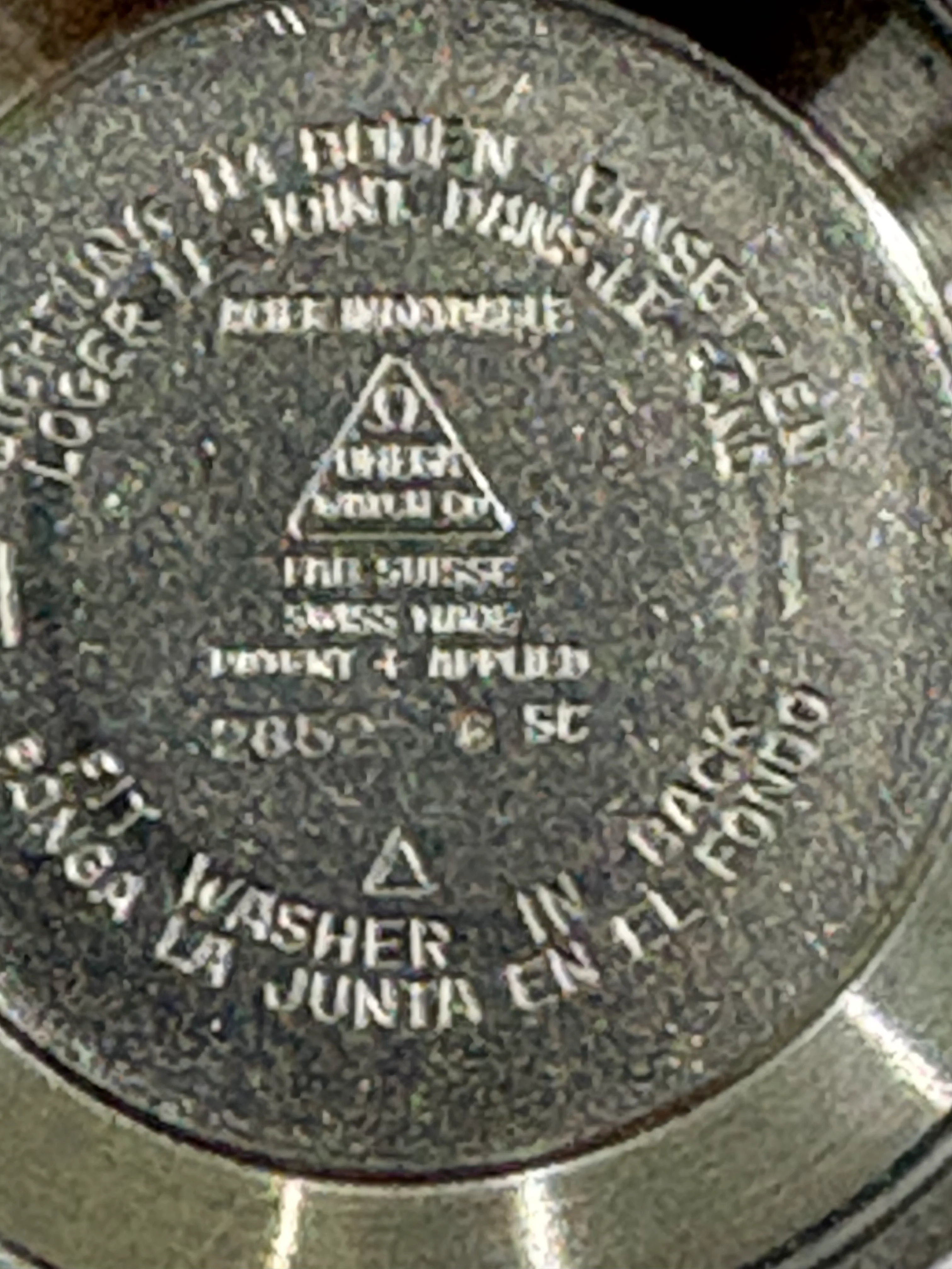

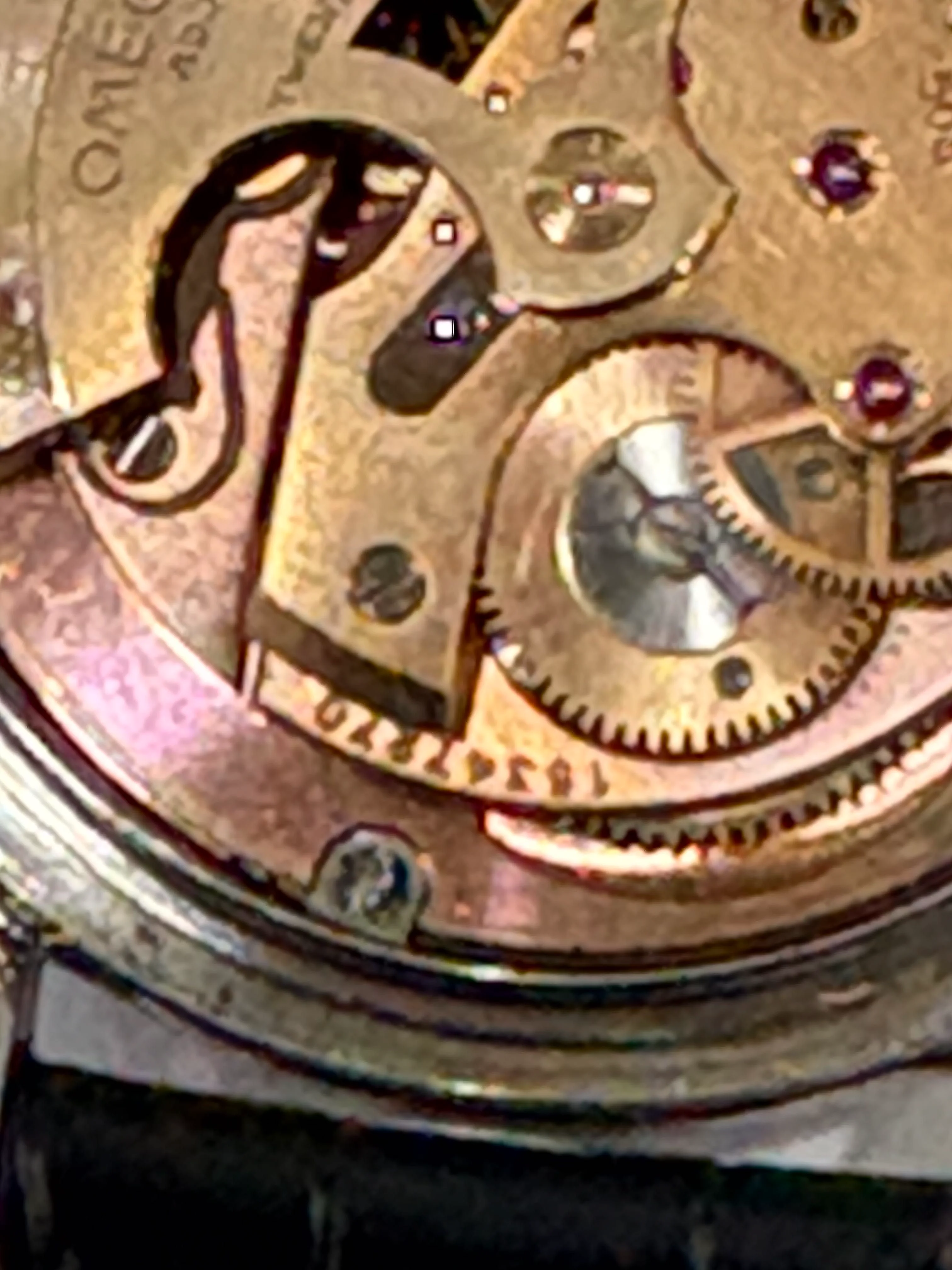

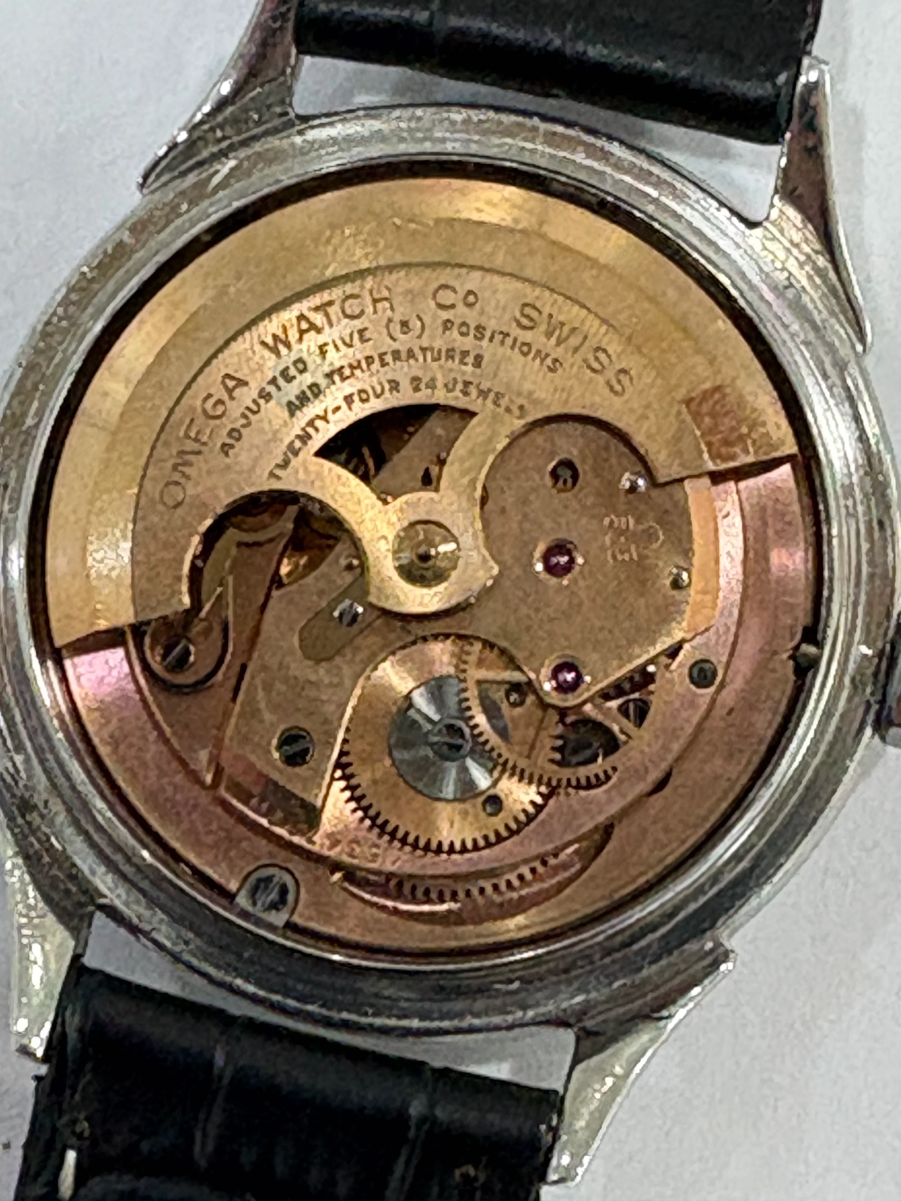

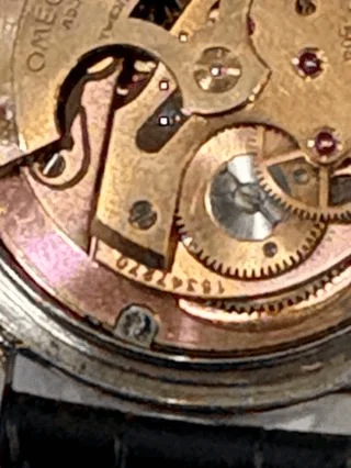

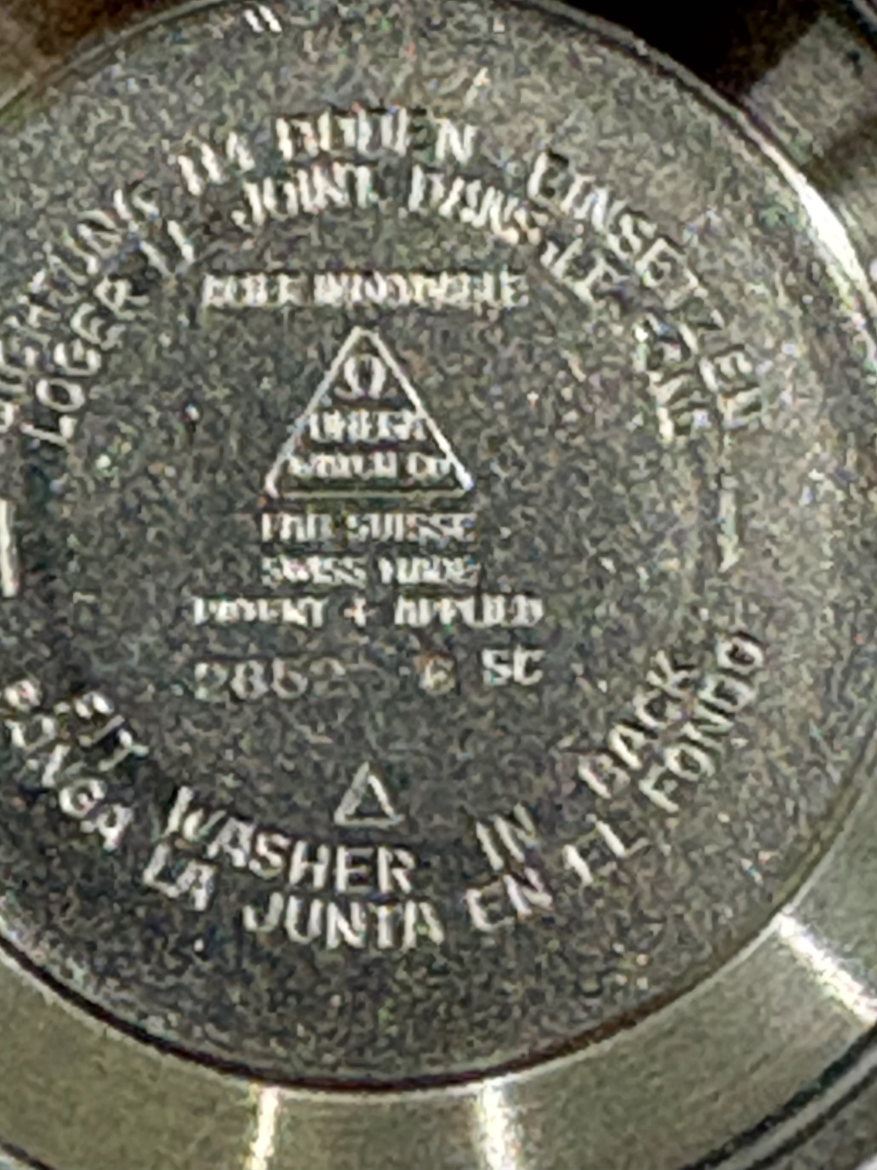

Caseback reference no is 2852-6 SC
Which I believe is a model transition. Movement number
15,347,872. Calibre 505, 24 jewels, full rotor, no bumper.

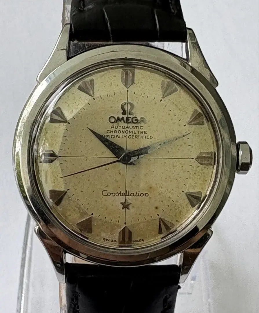

this is not so.
mine:

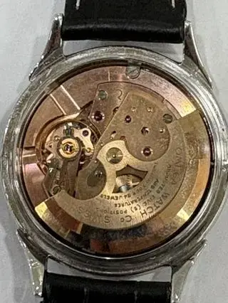

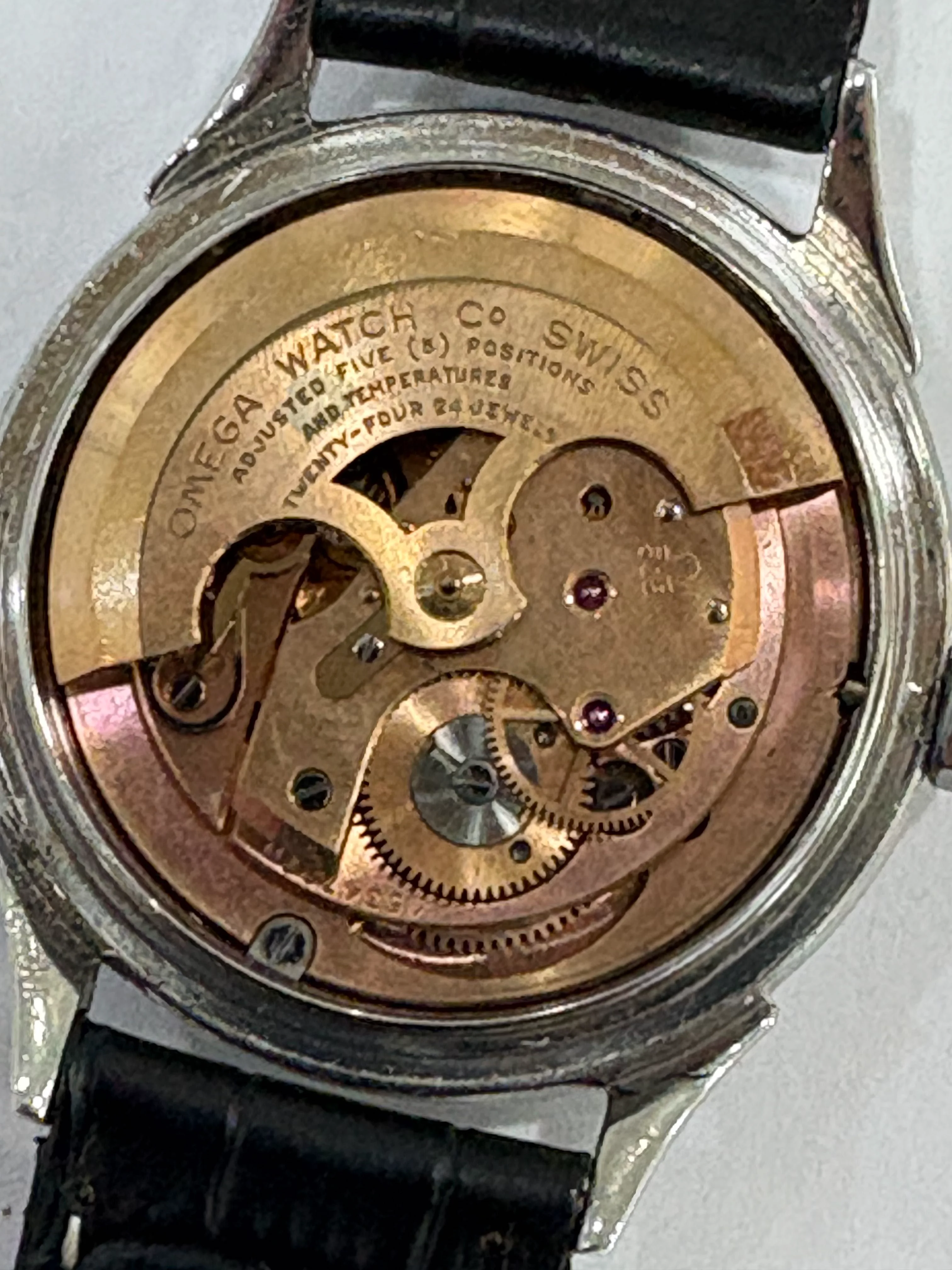

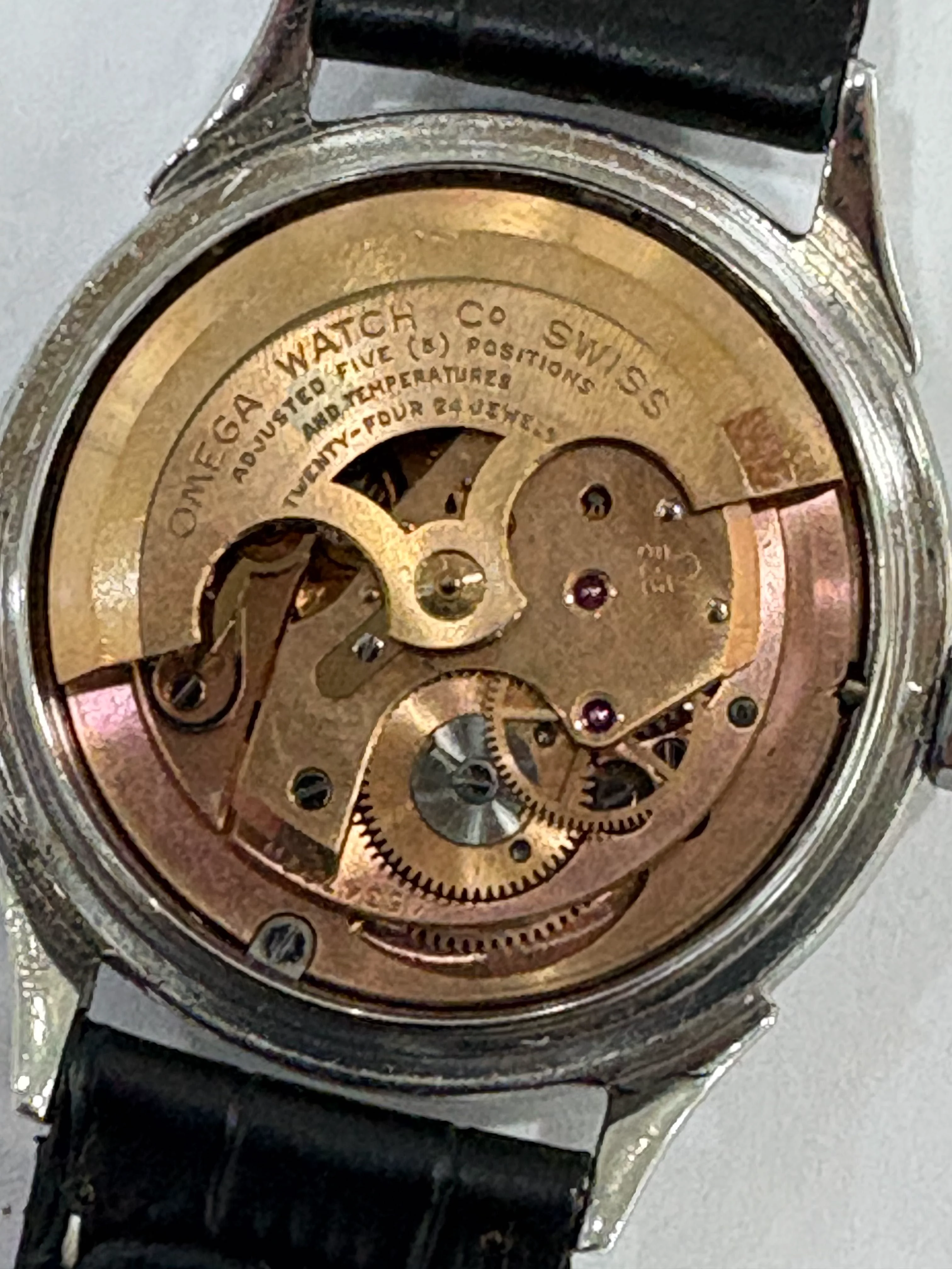

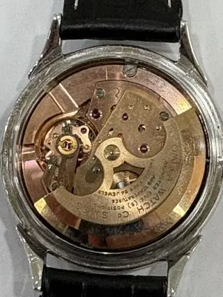

hi the watch is priced at around $1,000. Here are the inside pictures.
here are the pics. The watch price is around $1,000. Cheers.
3,334
7,345
Looks original for cal 2852 the rectangular marks at hour markers ok for this reference.
With limited photos lugs seem quite polished to me. Dial damage/spotting an issue but some ok with this it’s matter of personal taste.
Price is not unreasonable given these issues

Thanks for all your responses. At this price I will go ahead with the purchase. The patina, at least to my taste, is perfect. If the dial was perfect it would either be a redial or a watch kept in a safe for 70 years -- unlikely. Thanks again.

so what do you think? 1,000 dlrs? i like patina.
It's great that you like the dial, personal preference is the most important thing. If you're impatient, you like the watch, and it fits your budget, then you should buy it. The watch is legit and I don't think the price is crazy.
However, I will just say that in my opinion, your comment is off the mark. Many Omega dials and cases have held up very well over the years, and you don't need to settle for a poor example if you don't want to. And I am not talking about pristine safe-queens. Just spend a few weeks perusing photos posted by collectors on this forum and you will see hundreds (maybe thousands) of vintage watches with clean and appealing dials and cases that have retained their original shapes.
But it does take patience to hunt for vintage watches that are in good condition, and if you just look quickly at what is available, you might be left with the impression that you have to settle. I completely understand that many people don't want to spend months hunting patiently for what appears to be a needle in a haystack.

Thankyou for those considered remarks. They key takeaway for me is that you and the others think it is an original, honest watch. I personally just love patina on a dial, although i have limits. I think this one is fine -- for me. This will be my daily watch. I have a 1952 gold capped Constellation, with patina, but much less, and a 1953 Omega Tresor presentation watch to an Olympic gold medal champion in the Melbourne 1956 Olympic games with documentation -- also with patina. I guess its become my thing, lol. I once had an enormous Henry Moser solid gold single pusher chronograph wristwatch from 1915 Russia with original leather strap and unblemished, totally pristine enamel dial. Not even a hairline crack. Must have been kept in a safe for over a century. I was too frightened to wear it, lol. To each their own.
