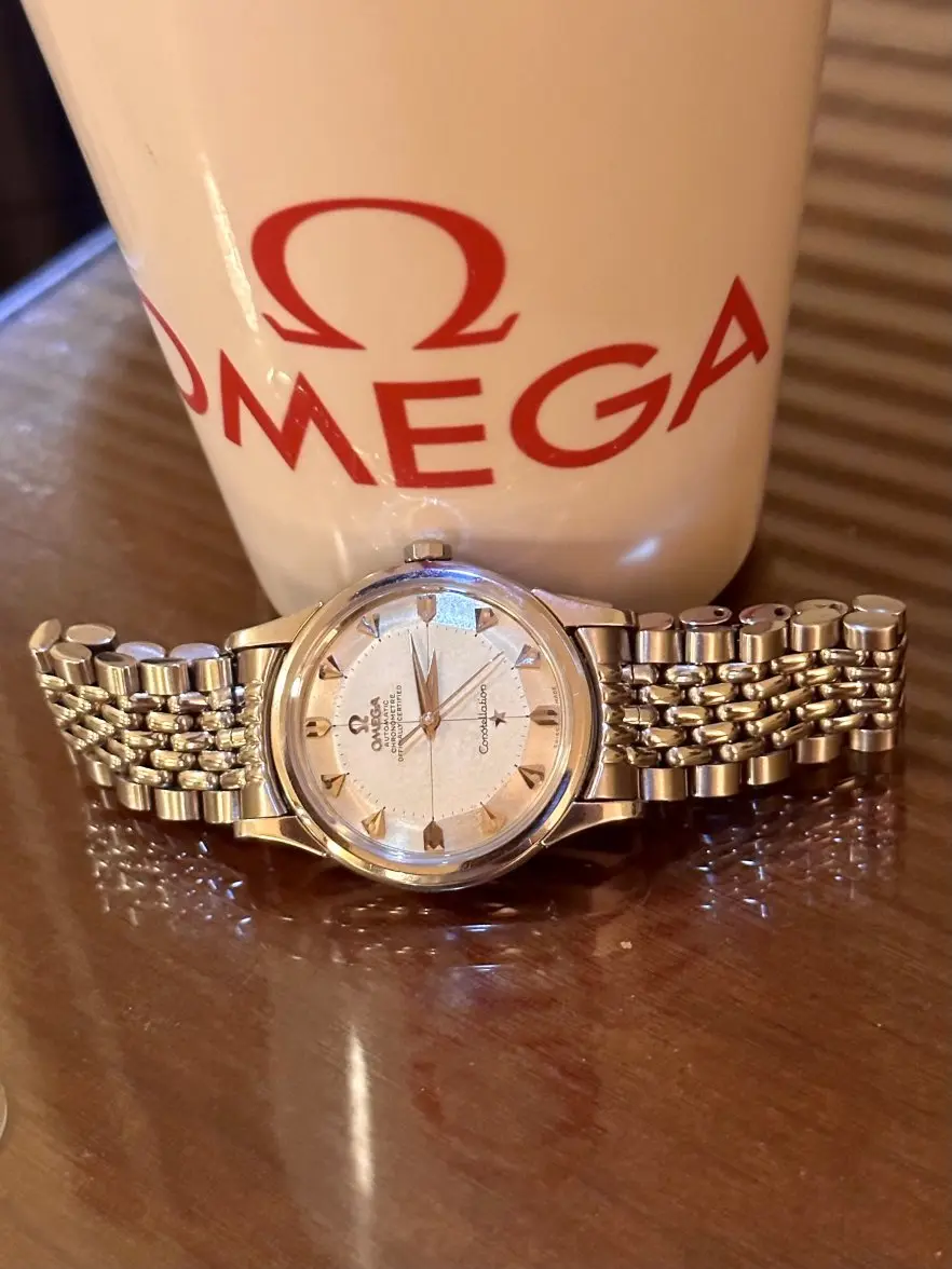

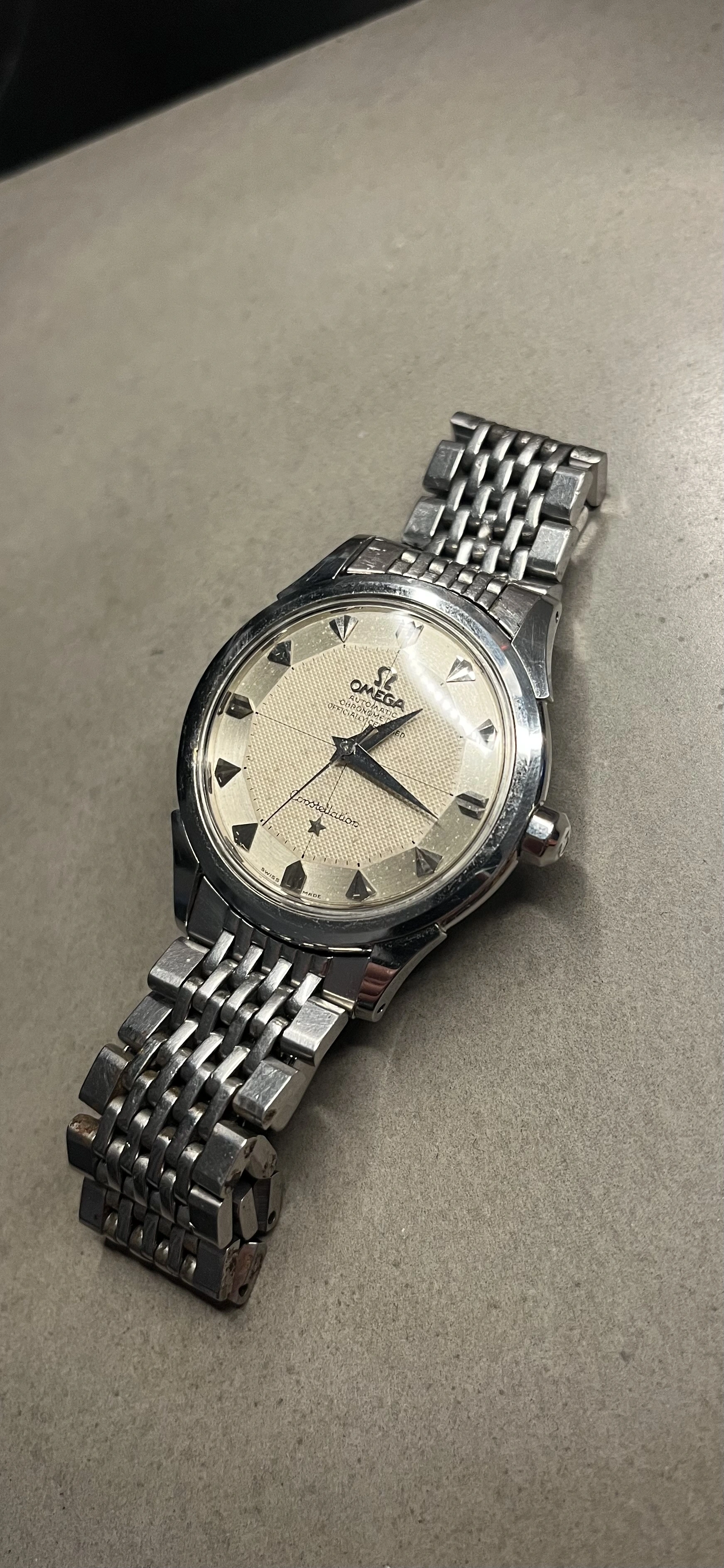

I just finished purchasing a bracelet and endlinks for 2852 on Ebay for under $300US... from my recent research that seemed reasonable. My bracelet is arriving on Tuesday so I'll post so u can see. By the way I wrote the seller and he had said he was going to list another... he goes by OmegaAddict on Ebay. Super responsive and has tons of feedback.
268
967
....oh I went with the 7 link version... I heard that you can do a version like that as well...hopefully... lol
268
967

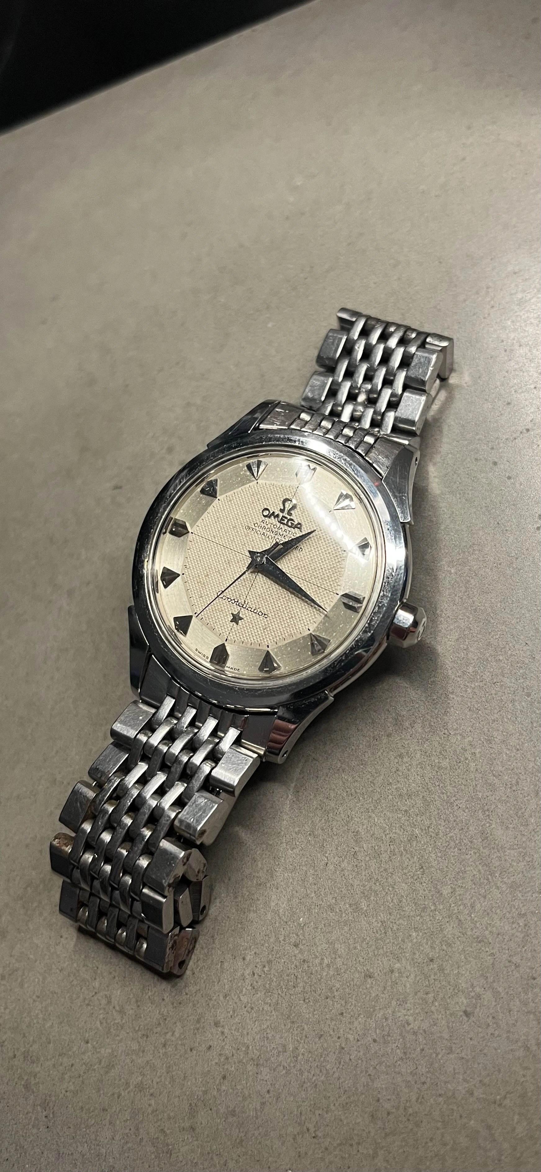

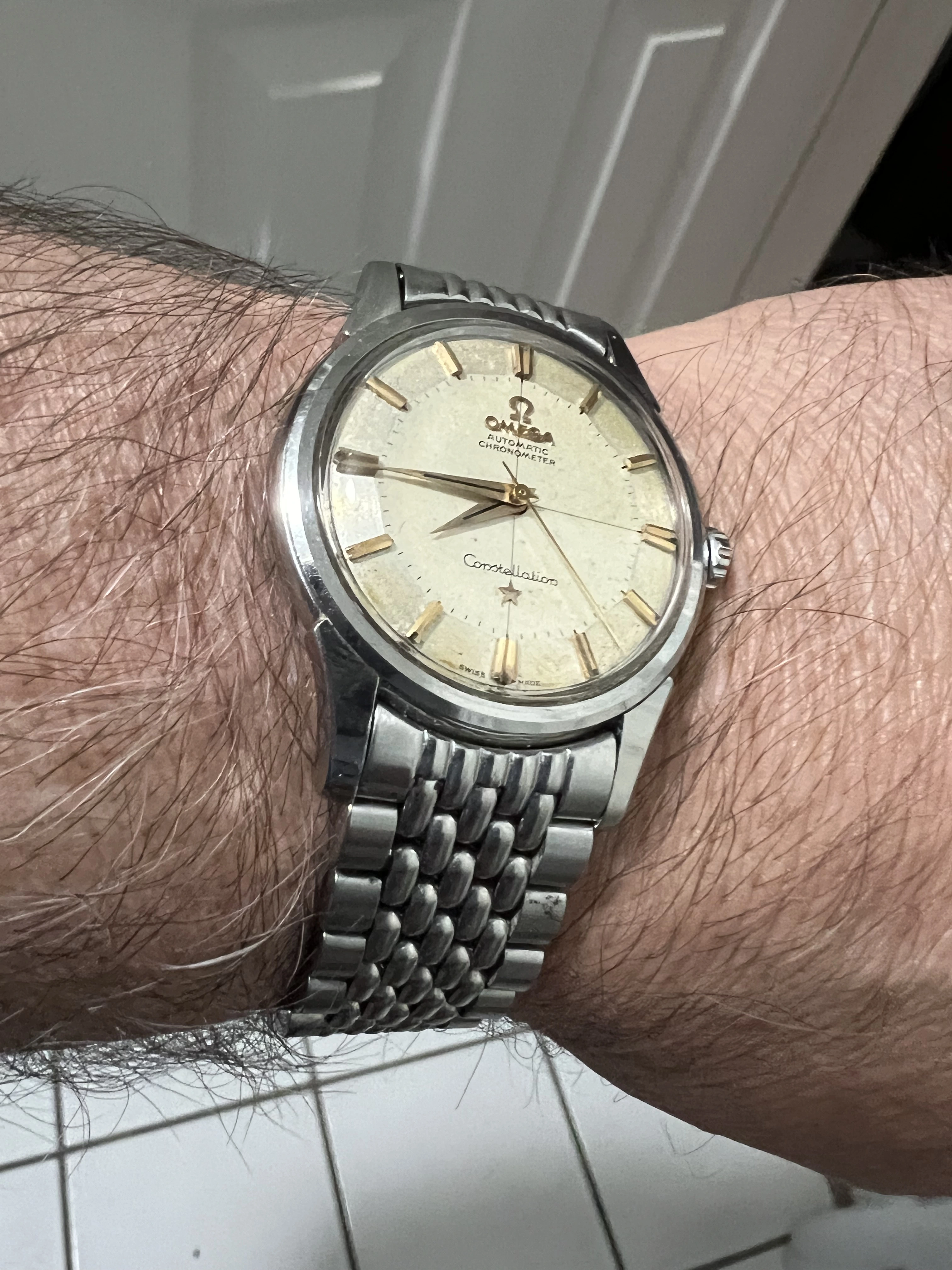

Tah-dah! #70 endlinks Whew… took me half an hour to install the dumb spring bars lol (really flush fitting). Hope this pic helps 😀.

The drilled lugs didn't help much with the install?

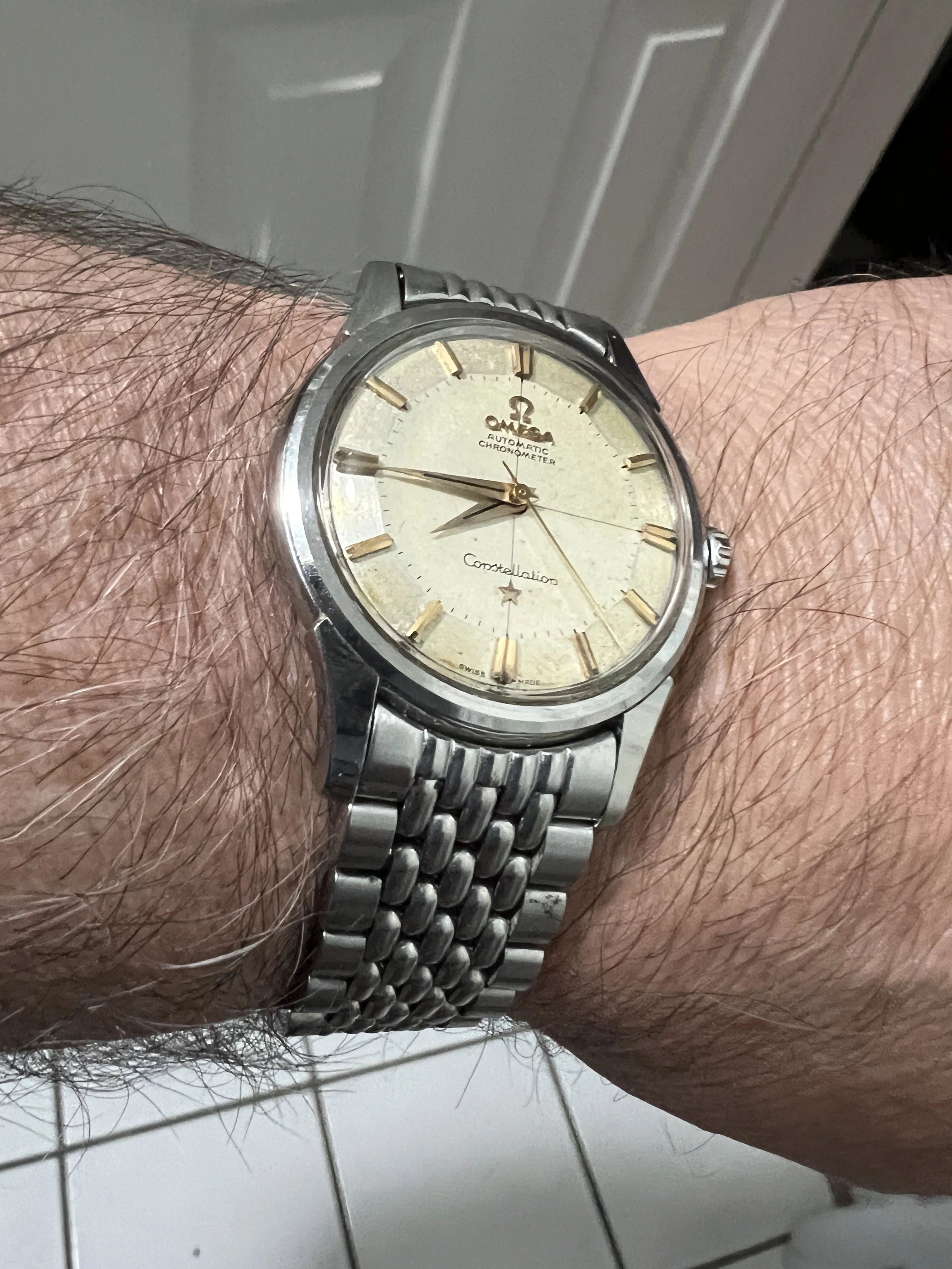

That does look like a perfect fit, very nice and I have experienced the same putting these bands on, can take a littel while. But now I am slightly confused: What would be the original end links, this #70 or BOR 8220/11? The difference I can see is the latter is curved down between the lugs. I'd say both look nice, I can imagine a problem if #70 is not completely flush, like wearing out shirts.
2,816
6,951
5-row bracelets are generally considered period correct for this watch; 7-row bracelets (as pictured) were introduced later.

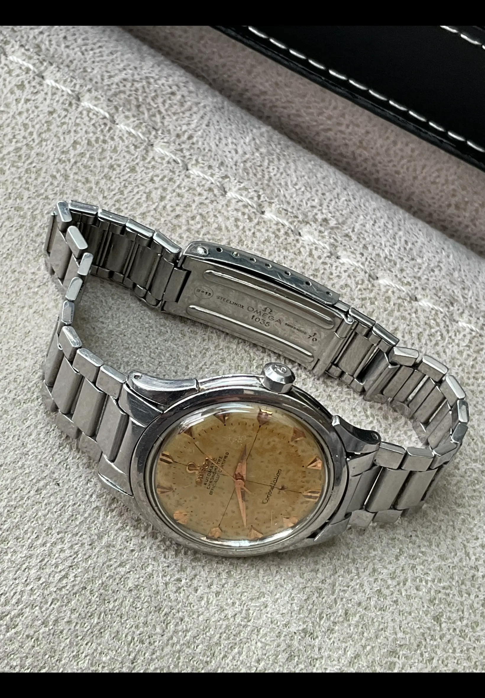

What about a flat link ? I think it’s fits and suits lovely (No 4)

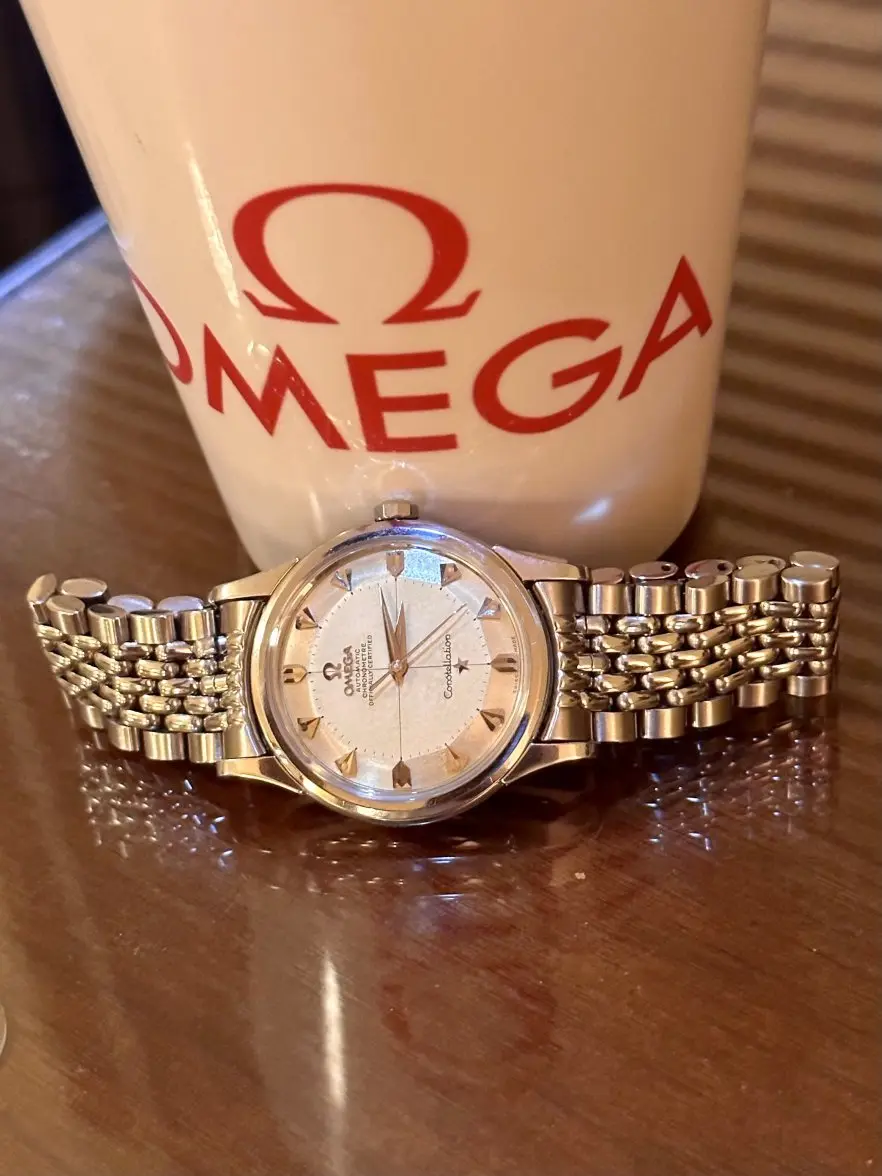

Here's an Omega 14381 with a five rows Omega rice bracelet and endlinks #11's.
