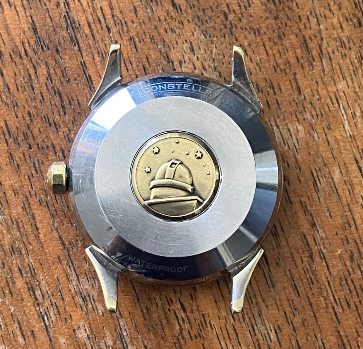

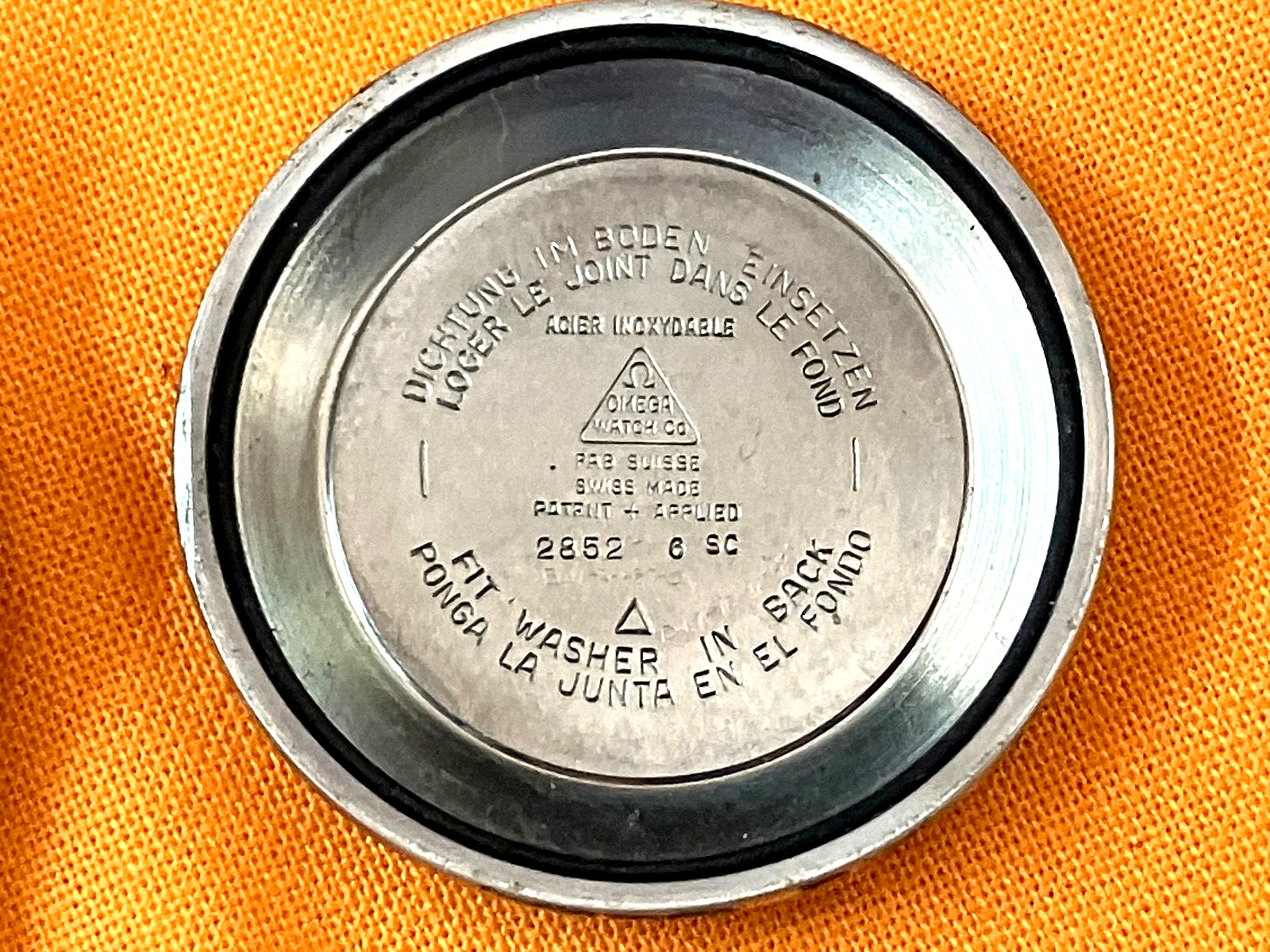

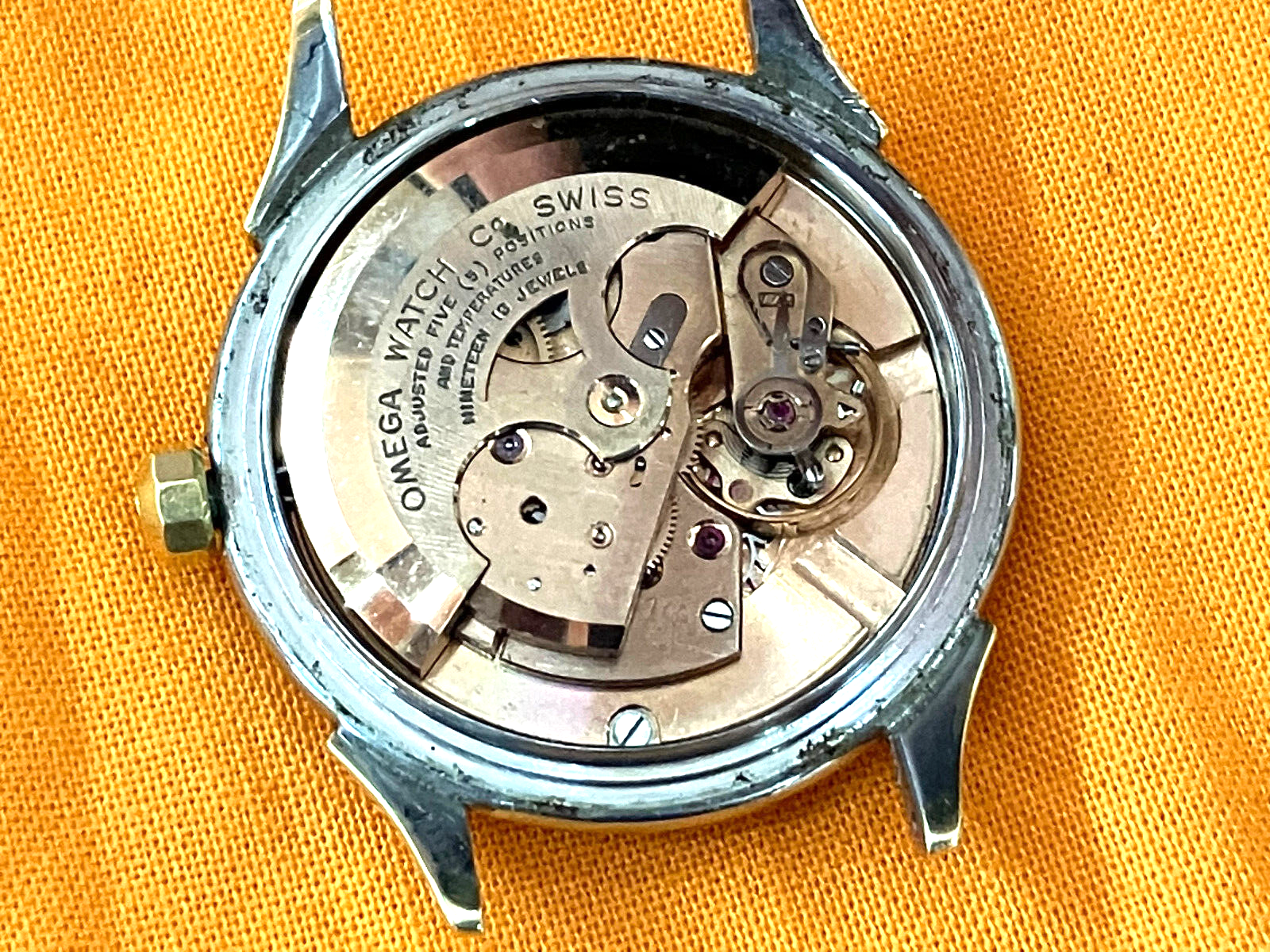

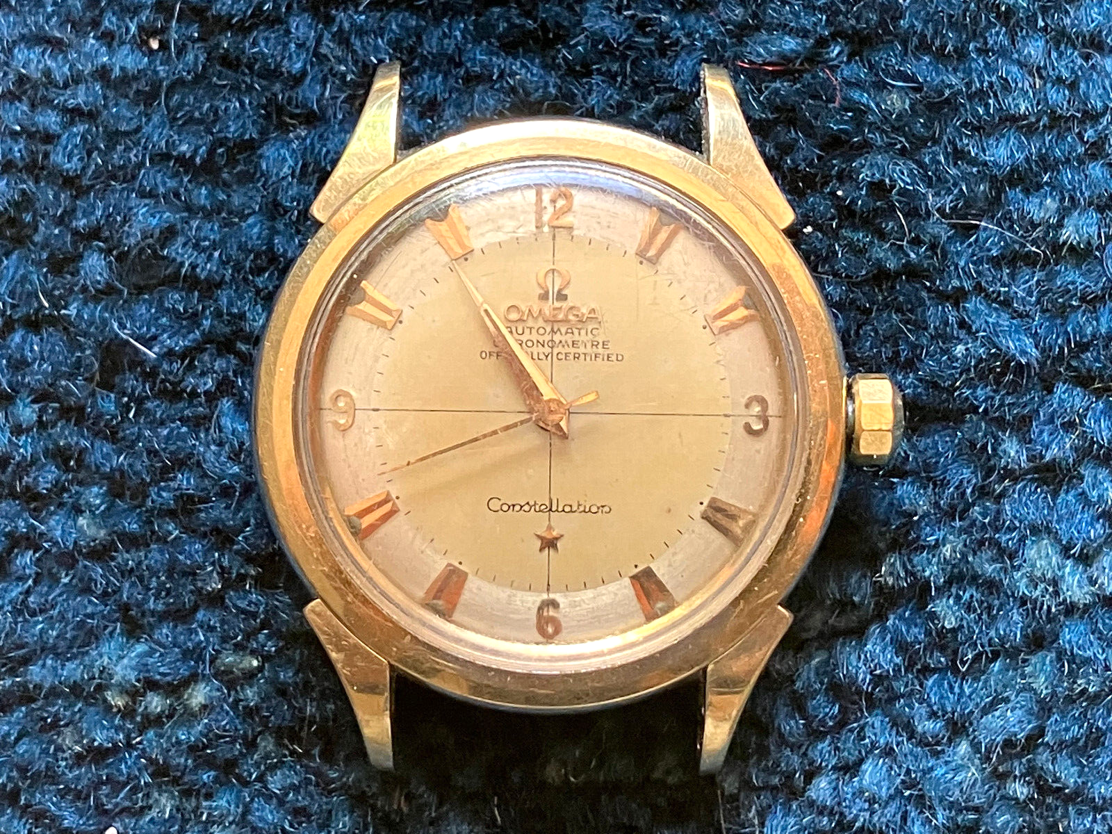

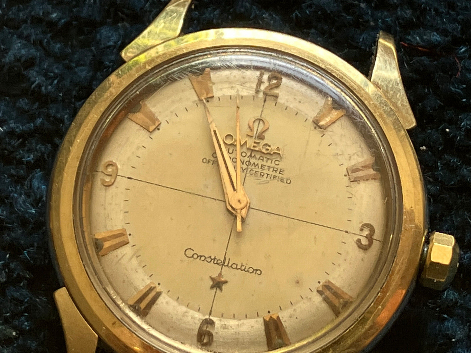

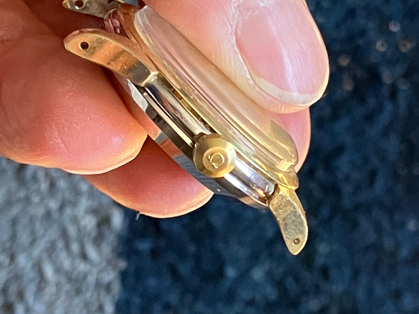

this Omega Constellation 2852 is currently being sold. The case has some dents but doesn't seem to be overpolished. The dial and hands look correct imo. The dial satisfies the MOY test. The only concerns for me are the spots on the dial, as it is very hard to identify what is on the dial itself and what is projected by the very scratchy crystal. Also the crown seems to be to far from the case? Maybe some of the more experienced members could comment on the condition and what current prices are approximately.

Dial is original. Serial number based off of that appears to be between 14.5m and 15.5m. The dial has damage to it. Hard to give advice on that because that is personal preference and personal tolerances. The crown is correct; however, modern service replacement. I cant comment if its too far out or not as I am not a watchmaker. Perhaps its not pushed in. The dial also may have been relumed in the past. Color looks kind of green. Price are variable. This is the least desirable case configuration for collectors.
10,125
57,953
I’d pass. Better examples are available and not that hard to find.
