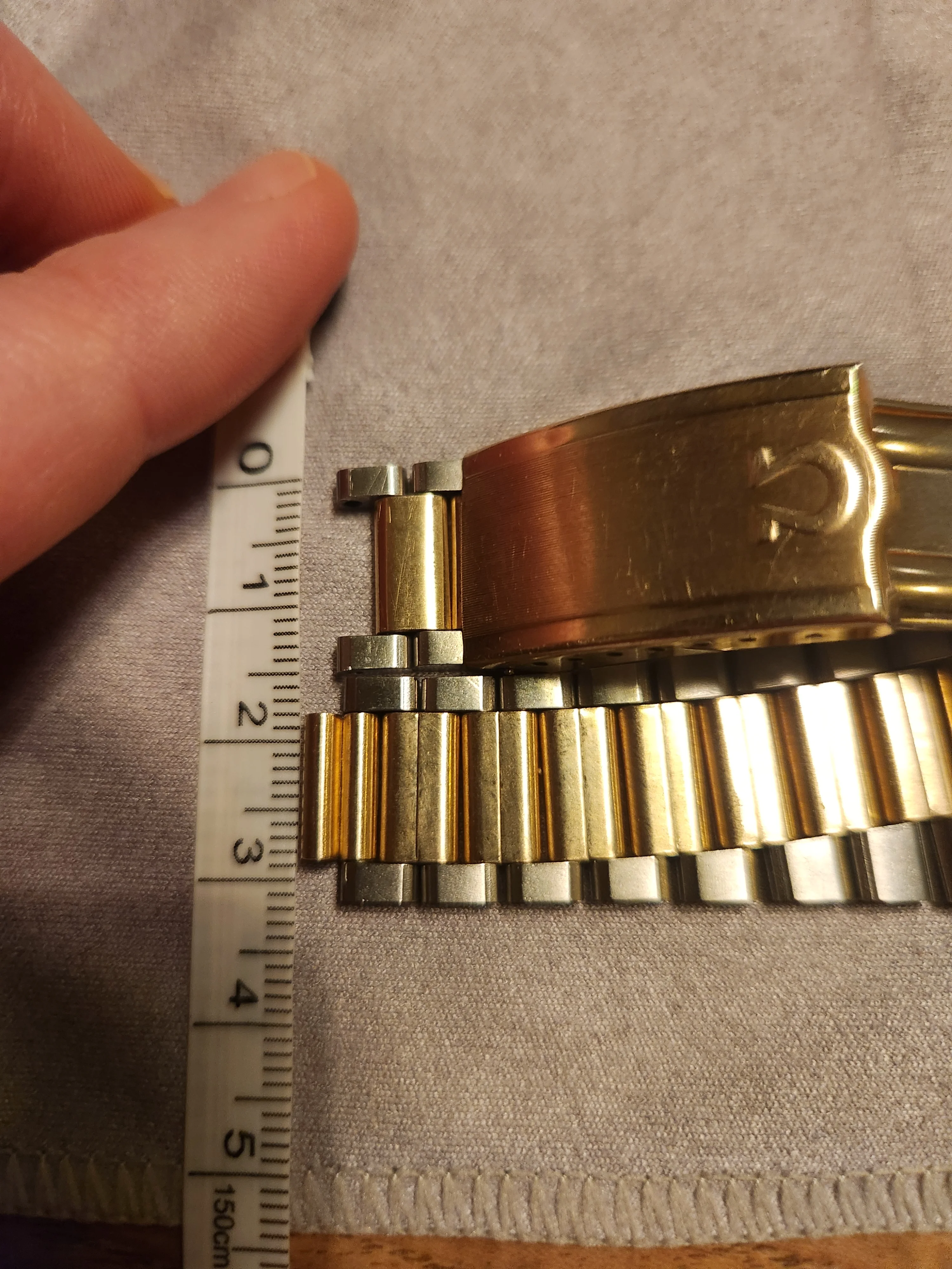

I have a vintage Omega Constellation Ref 168.041 that is about 1 link too small (or possibly 2). From my (admittedly very novice) measurements, the links on the clasp are c. 15mm in width.
I have tried clasp extenders and unfortunately they do not fit the bracelet. My local watchmakers/repairmen have noted that it is a rarer bracelet and don't have any idea where I could find a link or two that might fit. I would like to wear the original bracelet as possible as I think it nicely complements the dial. If anyone has any suggestions on where I could find a link or two that would fit, I would be very grateful! They don't have to be original or even Omega.

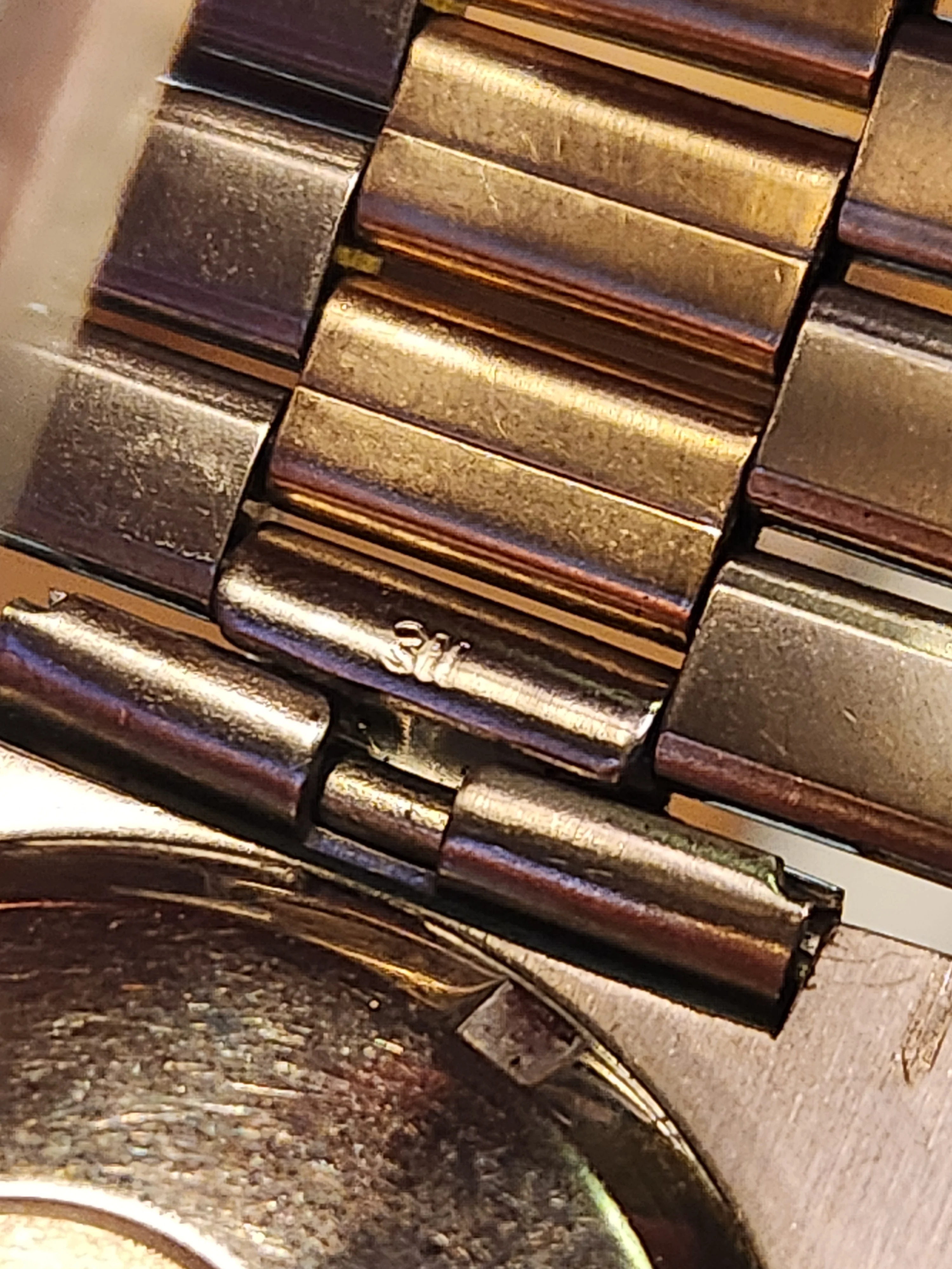

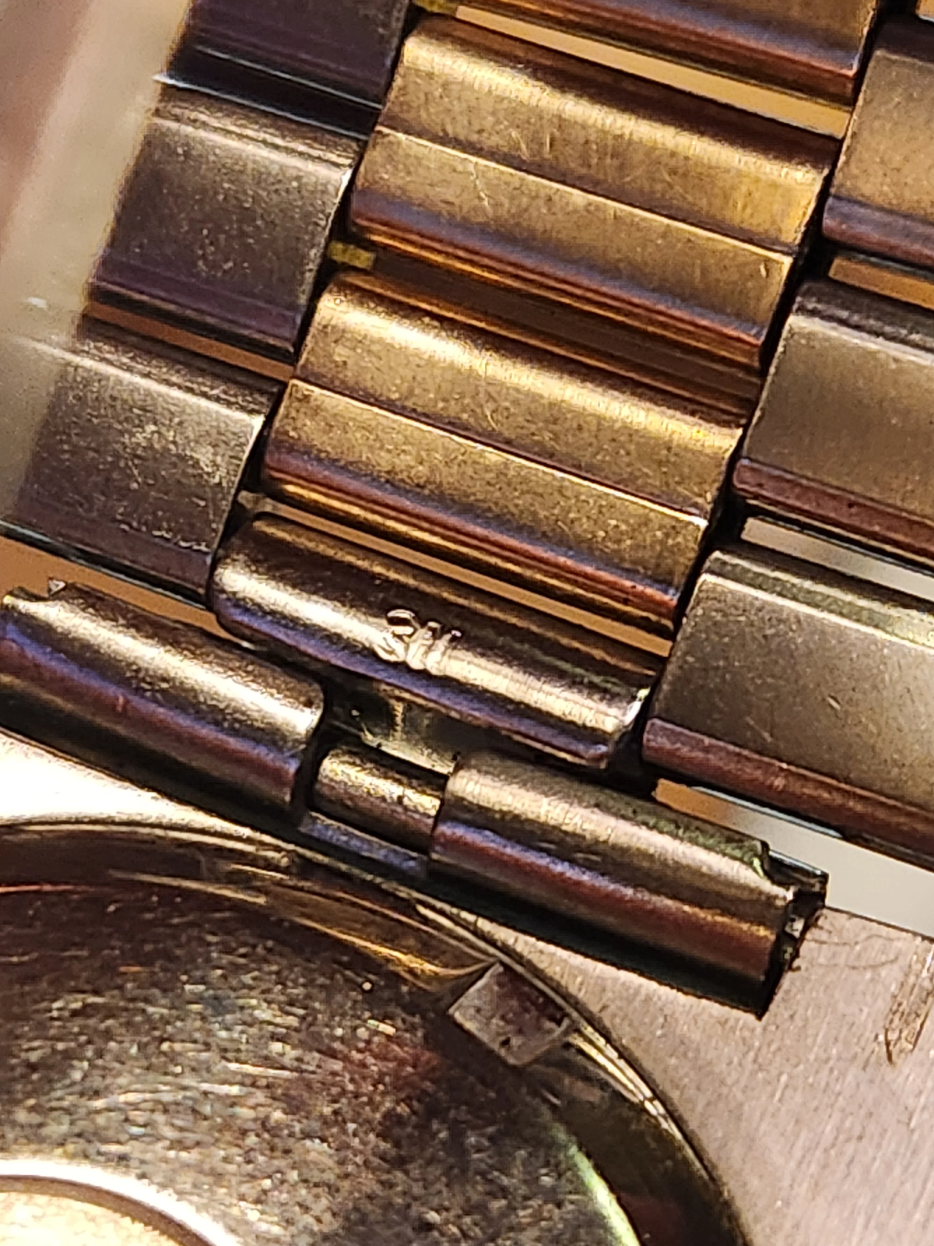

Annoyingly the bracelet does not have the reference no. stamped on it. The end links look like they have "311" stamped on them, but it is very small (see attached).
935
1,059
The 311 endlinks are new to me, from the shape of the steel parts it looks like a 1175 ti me.

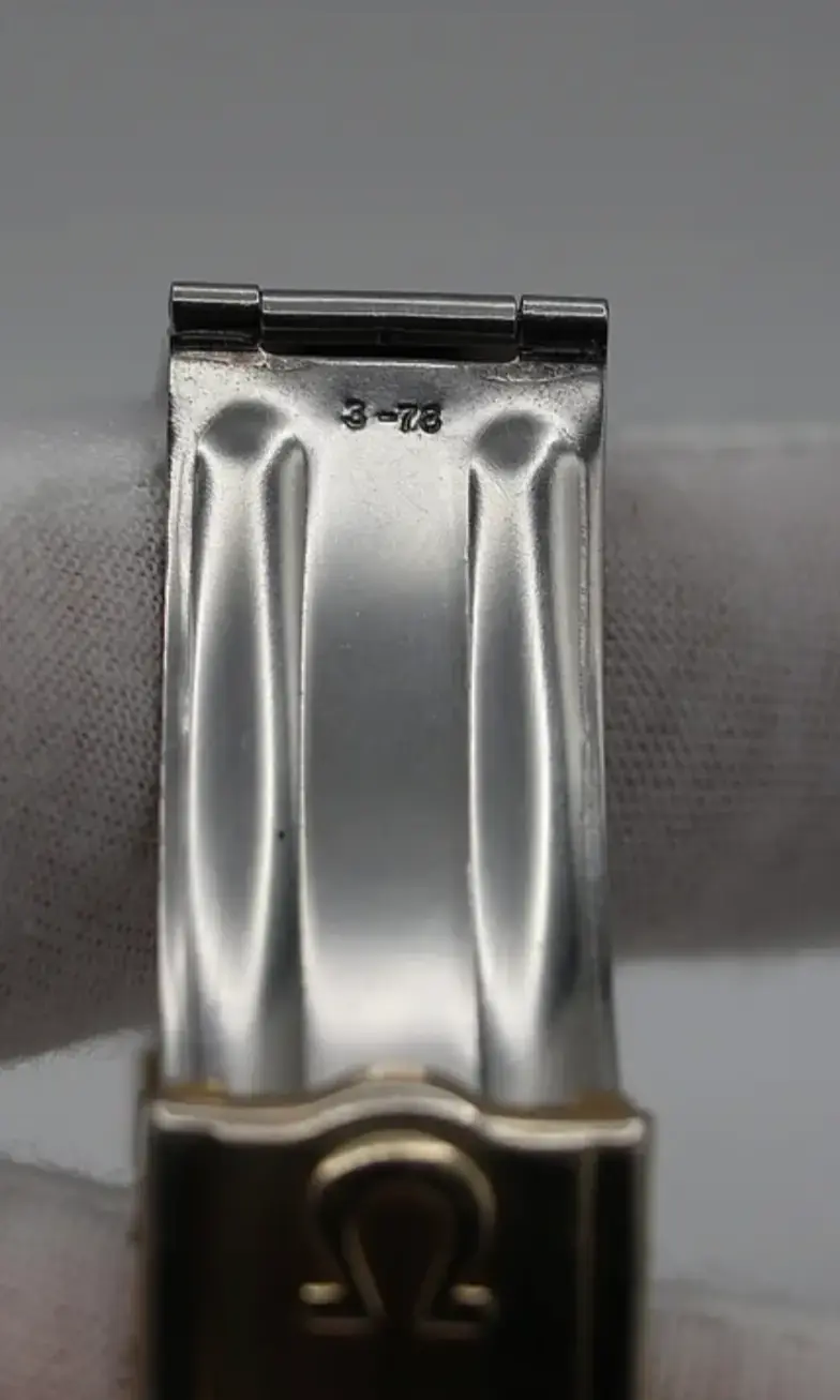

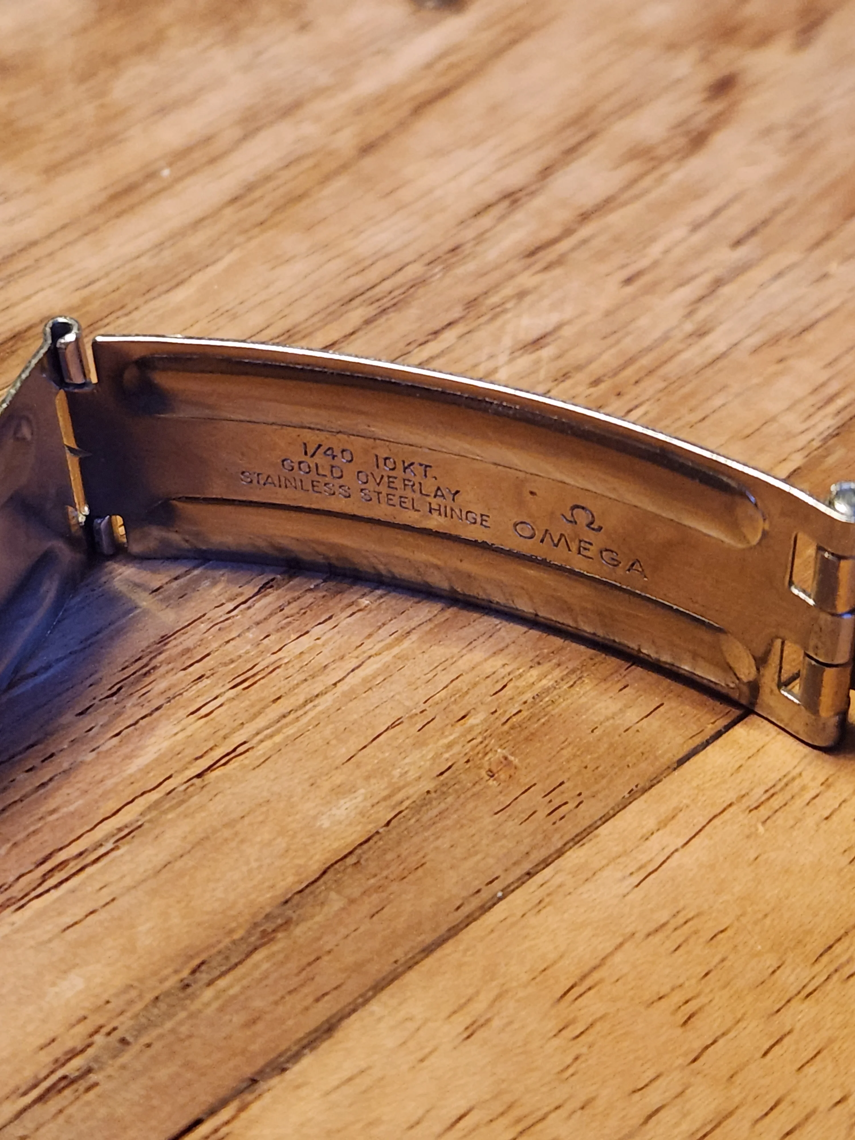

Does it have a stamp like this on the blades of the clasp?
7
Does the 9-75 mean anything or should I just assume it's a ref 1175 bracelet and try to find links for that? I appreciate everyone's help so far.
935
1,059
9-75 indicates the month/year of production to me and is also a hint it might be a 1175. From the shape of the links it looks like a 1175. So worth a try looking for 1175 bicolor links,
