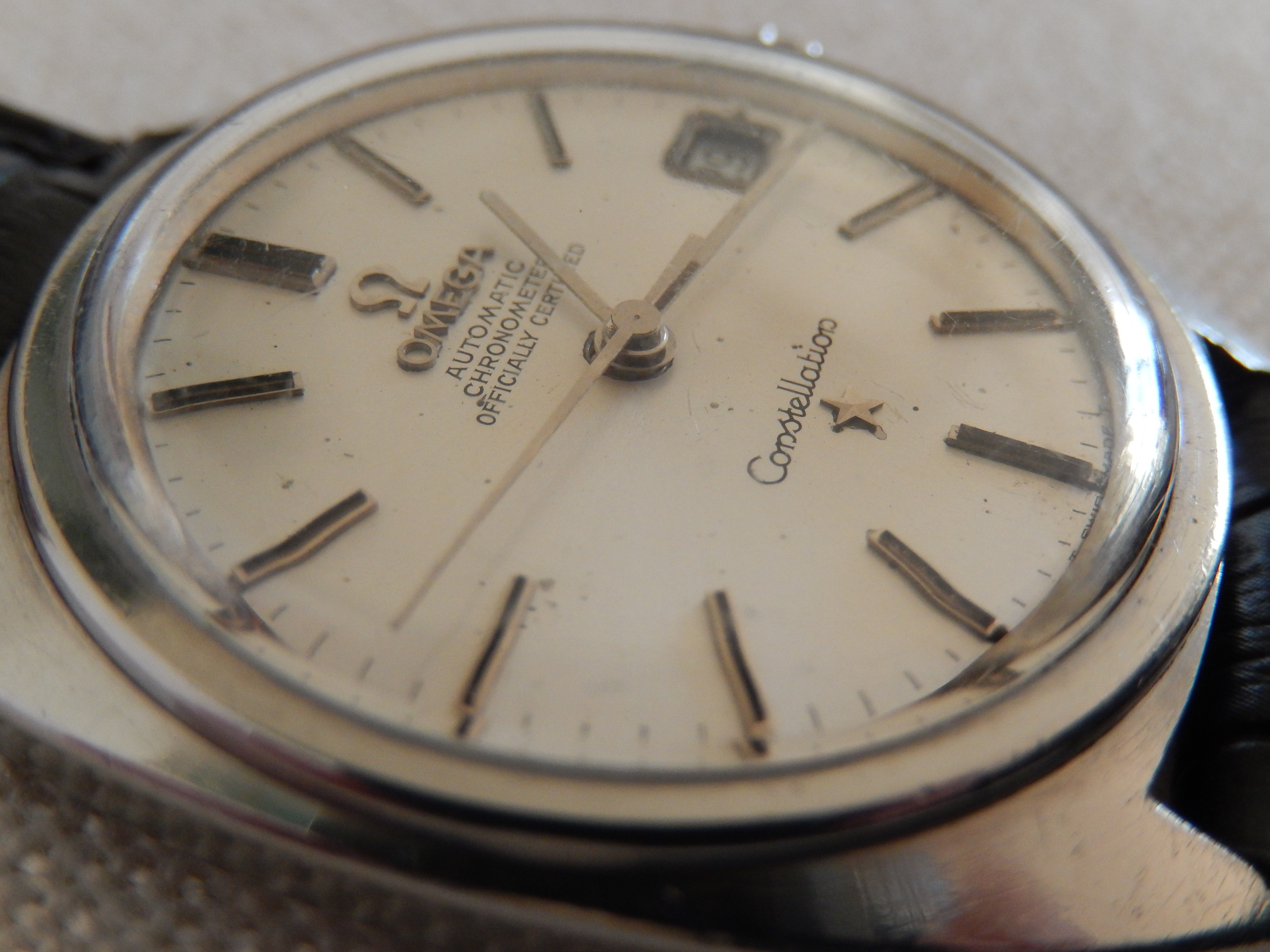

    Hello,
    I bought this Omega to give to my father.
    It should be a reference 168.017 Caliber 564.Confirm?
    At the moment I did not open the screw back.
    Now I would like to bring it back to its ancient glory.
    But first I would like to have clear ideas on some points:

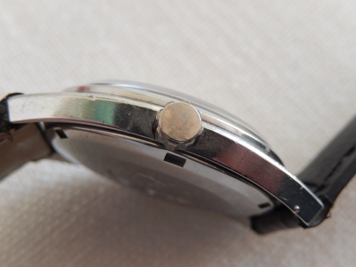

    1) the crown does not report the Omega brand.
    this is original or has been reassembled? if refit which crown model is correct for this Omega?
    Measure are 4mm x 2mm.
    2) Hands fit . Not seem original. What is your opinion about?
    Any other suggestion/ info or idea is very appreciated!

    Hands should have lume.
    Crown should have Omega logo.

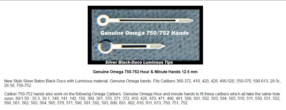

  3. Astropiteco Dec 29, 2016
    Thank you!
