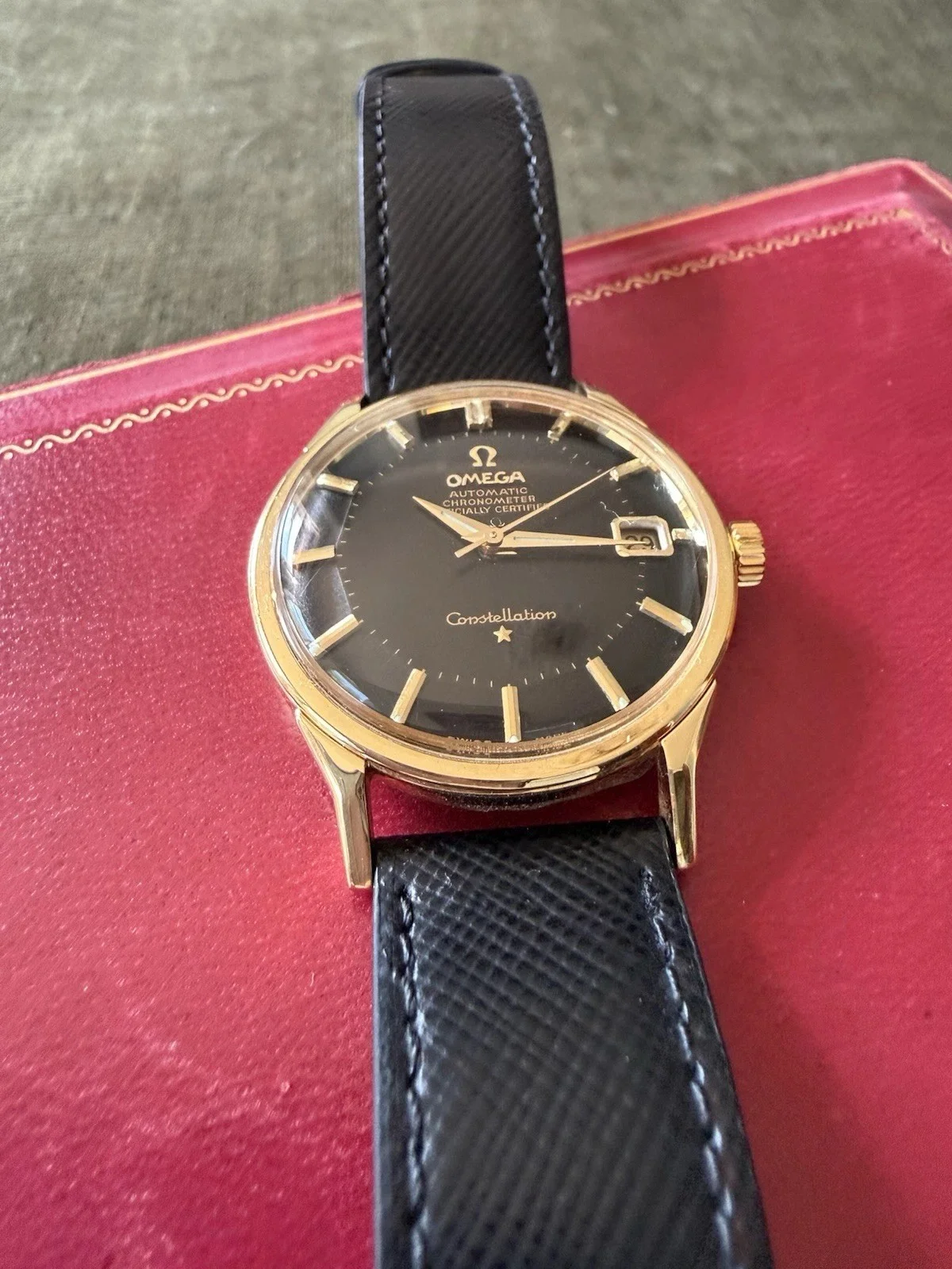

OMEGA Constellation 168.005 THOUGHTS????

Are you looking for an untouched, all original Omega?
9,846
55,486
It has been completely restored. If you want a vintage Omega that is untouched and completely original, this isn't the one.
6,385
9,881
“The solid gold case is pristine with minimal signs of wear”
On what planet does this watch show minimal signs of wear? - it has been polished within an inch of its life.
And the “period correct buckle” is quite right - the period being 2025.
I wouldn’t trust a thing this seller says.

The dial on this Connie looks original- not refinished. Black dials are highly sought after for this model, and the auction could reach a high price if a few buyers get competitive.

Hi ! Perhaps one should request a copy of the invoice of the "Omega historic shop " ..
The font of the “n’s” in Constellation are not correct.
Here is part of the seller’s description:
“I had this restored by Omega Historic Workshop in Bienne, Switzerland over a period of 1.5 years. I received the watch back in 2025 and since then it’s only been worn on very rare occasions.”
The work may have been done well, but how is this dial original?

The second letter "n" in the word "Constellation" isn't rounded enough at the bottom, but if it's a repaint, they did a good job
The letters 'OM' in 'OMEGA' appear rather re-finished to me.

As nice as re-dial as you're likely to find. The case ... not so much.
Yes, and there are many buyers who don’t care whether a watch is original as long as it looks good. I don’t agree, but just look at the interest on it: there are currently 172 watchers and the watch is already up to $2,100.

Well... what is interesting... I asked the seller if omega did the dial work and he said yes. I did'nt know omega does this. I know there are service dials but omega repainting dials... hmmm. That's interesting. Shall I ask a copy of the receipt?
I seem to recall that someone had told me that there is a service in Bienne to restore watches, but my recollection is that the cost is shockingly expensive. In addition, no matter how good the work may be, it’s still a redial.
