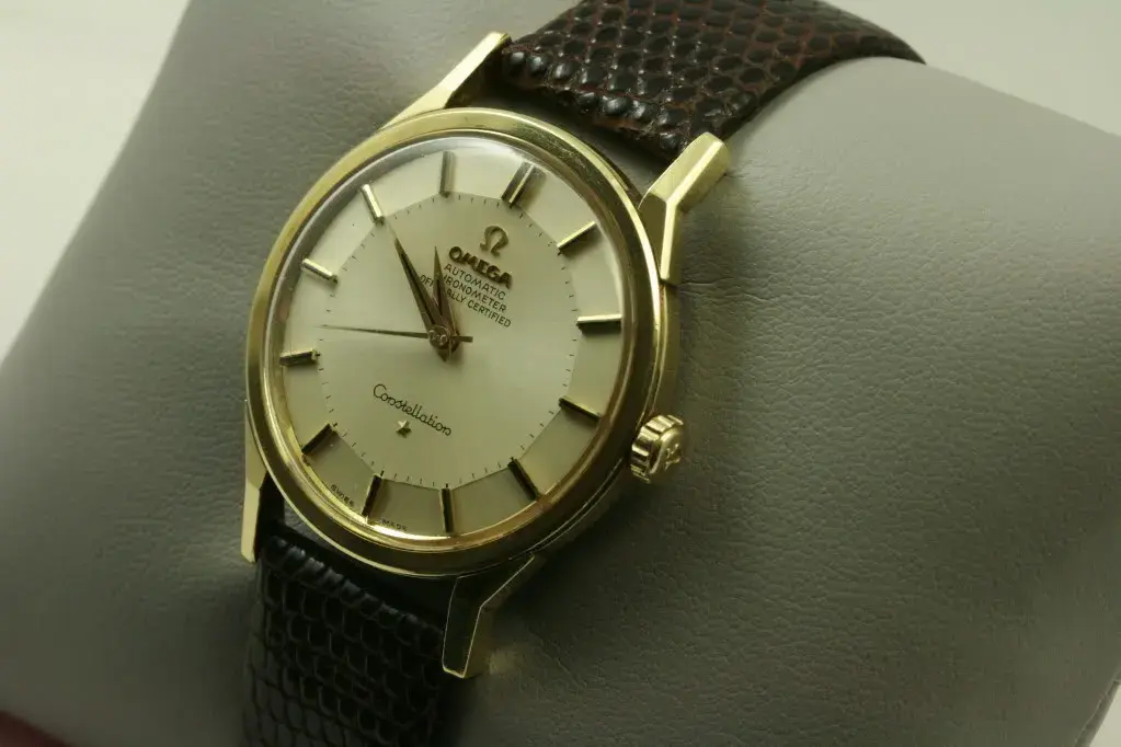

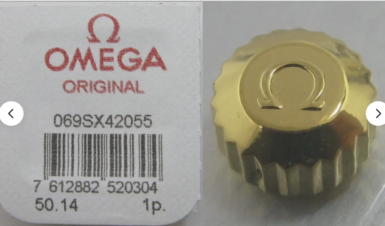

Hey everyone, trying to figure out how to use Crown-glass-gasket-list, I looked up the crown for a constellation model 168.005 and looks like its saying 42055 crown. I know the correct crown is suppose to be 10 sided but 42055 isn't the 10 sided crown, am I reading it wrong? Thanks!

This may be a replacement crown that omega would use as I don’t believe the decagonal crown is manufactured any longer.
eBay has the ten sided crowns available although gold toned are a bit harder to find than stainless

That is probably a later correct service crown for that reference.

Would it impact the value alot if its a service crown?

What crown is currently on the watch?

Just hypothetical, I don’t have a 168.005 but I know that the right crown is 10 sided and wanted to cross reference with the list but was confused when the part number wasn’t the 10 sided crown. If the watch was replaced with a service crown, would that technically be considered the correct crown or how big of an impact would that affect the value because it’s not the original crown?

It would be considered a "correct" service crown, but not the "correct" original crown. For a dog leg the decagonal crown would be a big appeal for me as it matches sharp angles of the case style. It would affect value.

It does have an affect on value but only minimal.
The condition of the watch (case/dial) is much more important.
Although not readily available, correct crowns can be found and collectors know that - hence the minimal affect on value.
On the plus side, the replacement crowns, although aesthetically less pleasing on the eye, are much, much easier to use.

That last sentence is VERY much the truth 😁 I swapped my 168.005 to the right decagonal-crown, and every time I have to wind it, I regret swapping the crown. That said, I re-affirm my decision every time I look at it.

The crown you list is the correct service crown specfied by Omega - just verified that on the Omega Extranet.
It would be the crown I would order from Omega if someone was more concerned about water resistance than they were about having the original crown. Different people will value that sort of thing differently, so it may or may not have an impact on value depending on who is buying the watch, and how careful (and how much risk) they want to be with it.
