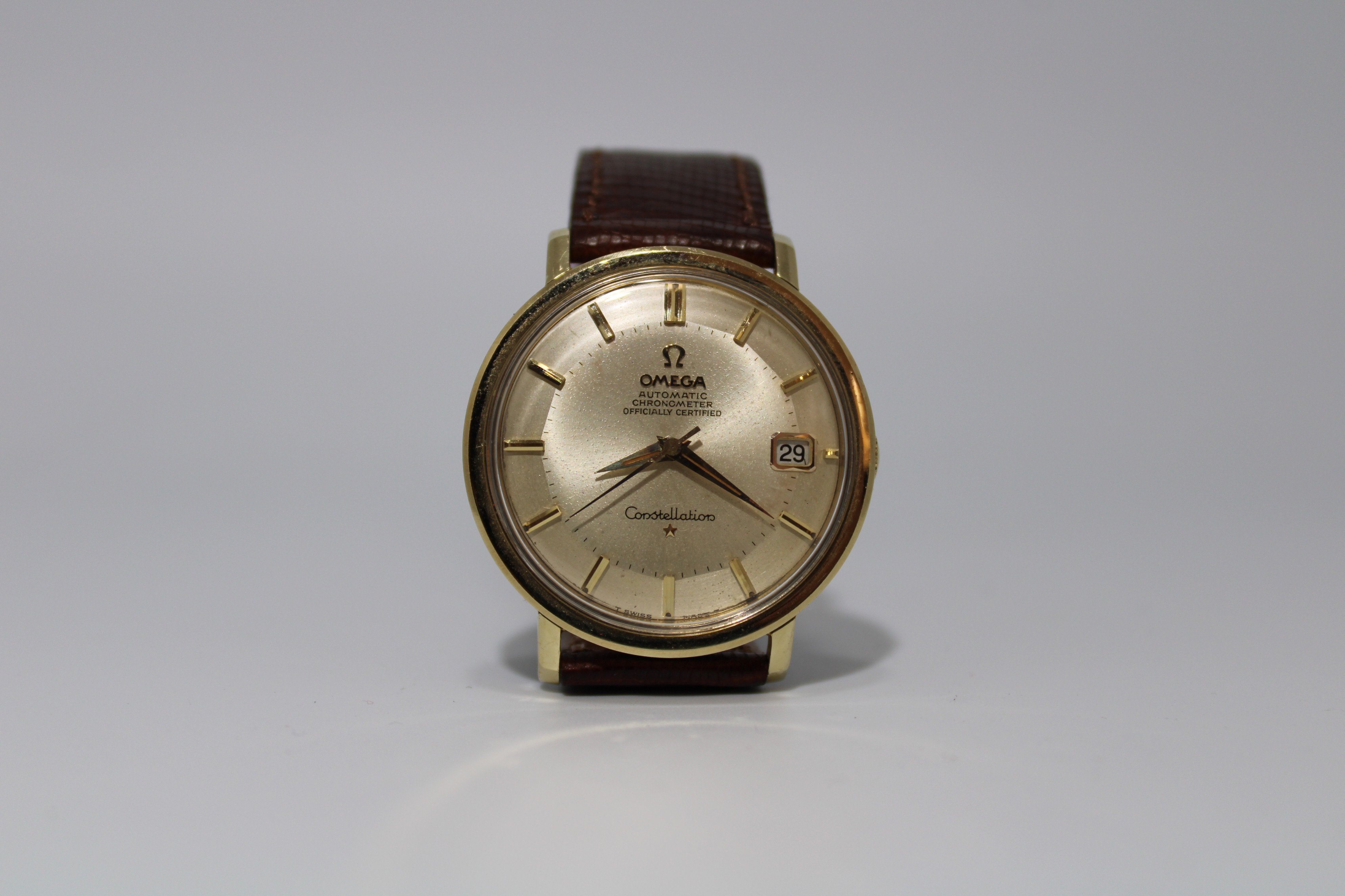

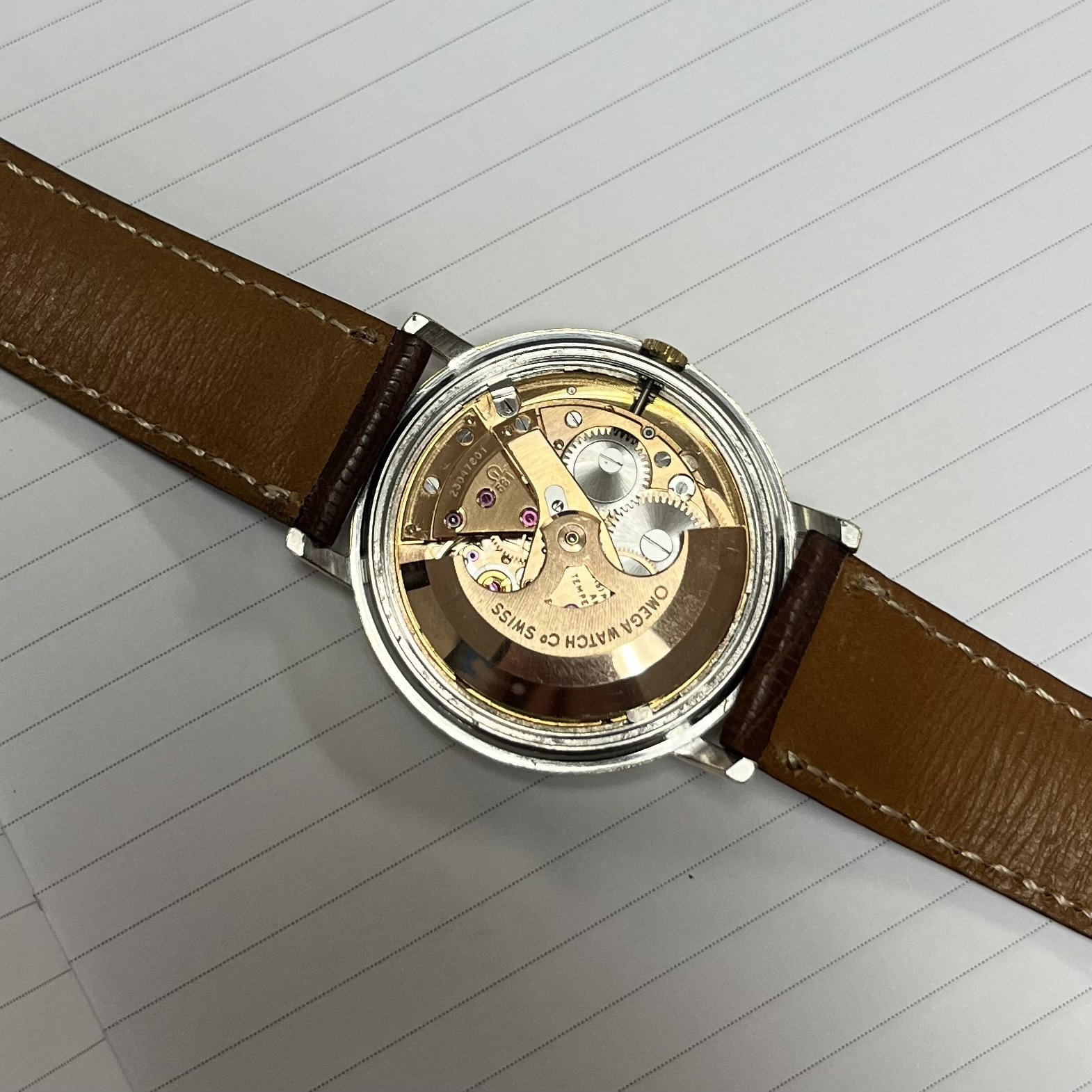

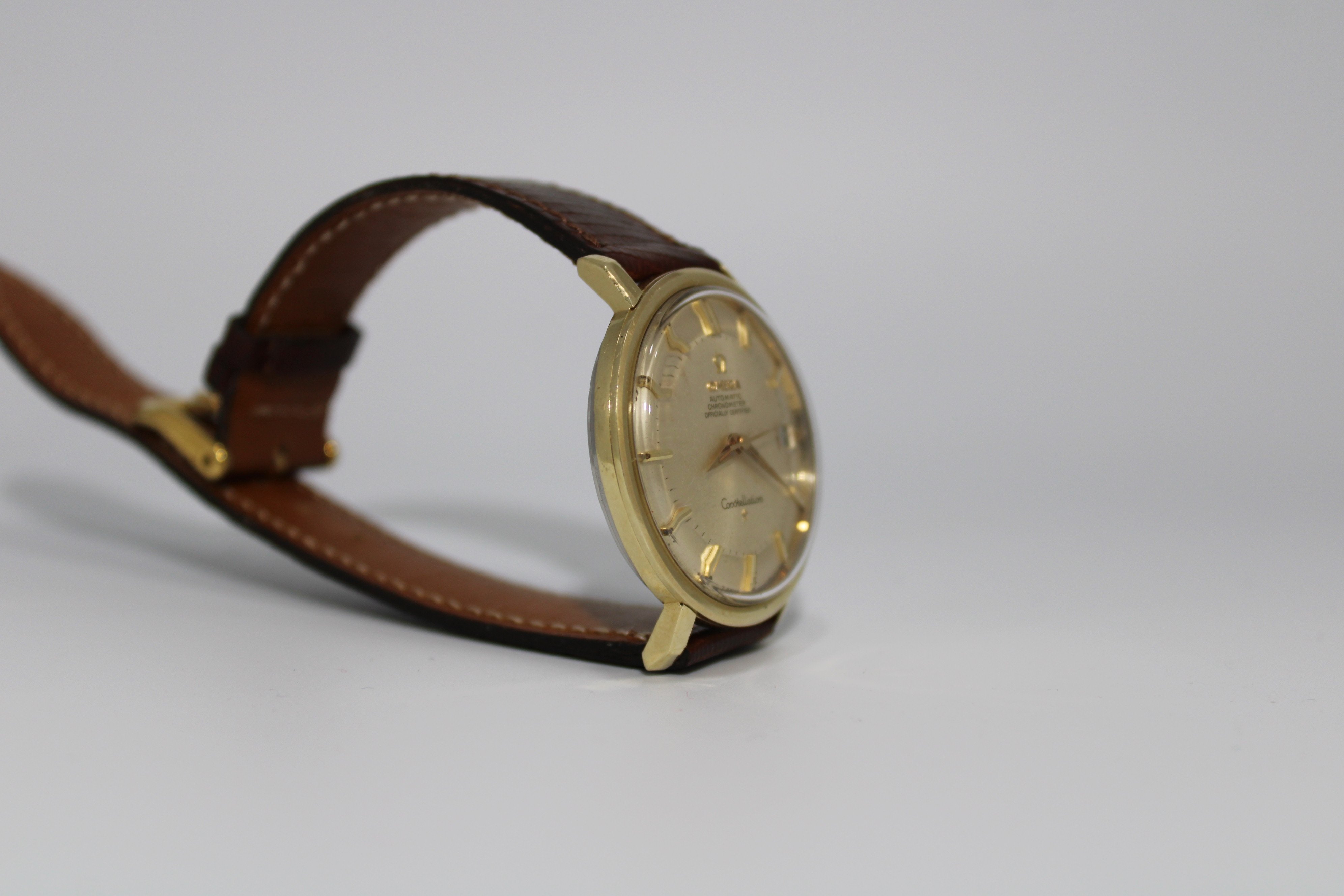

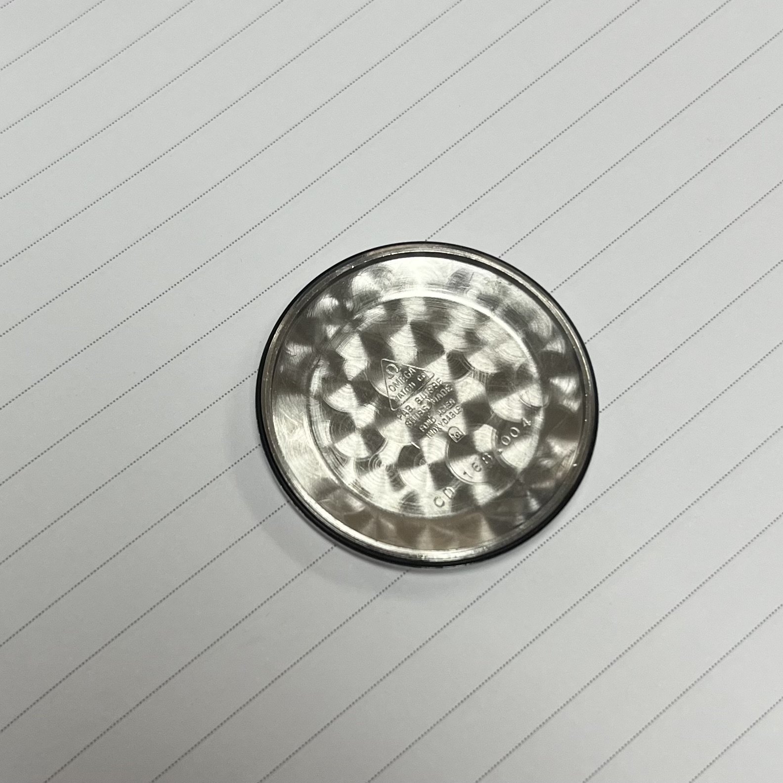

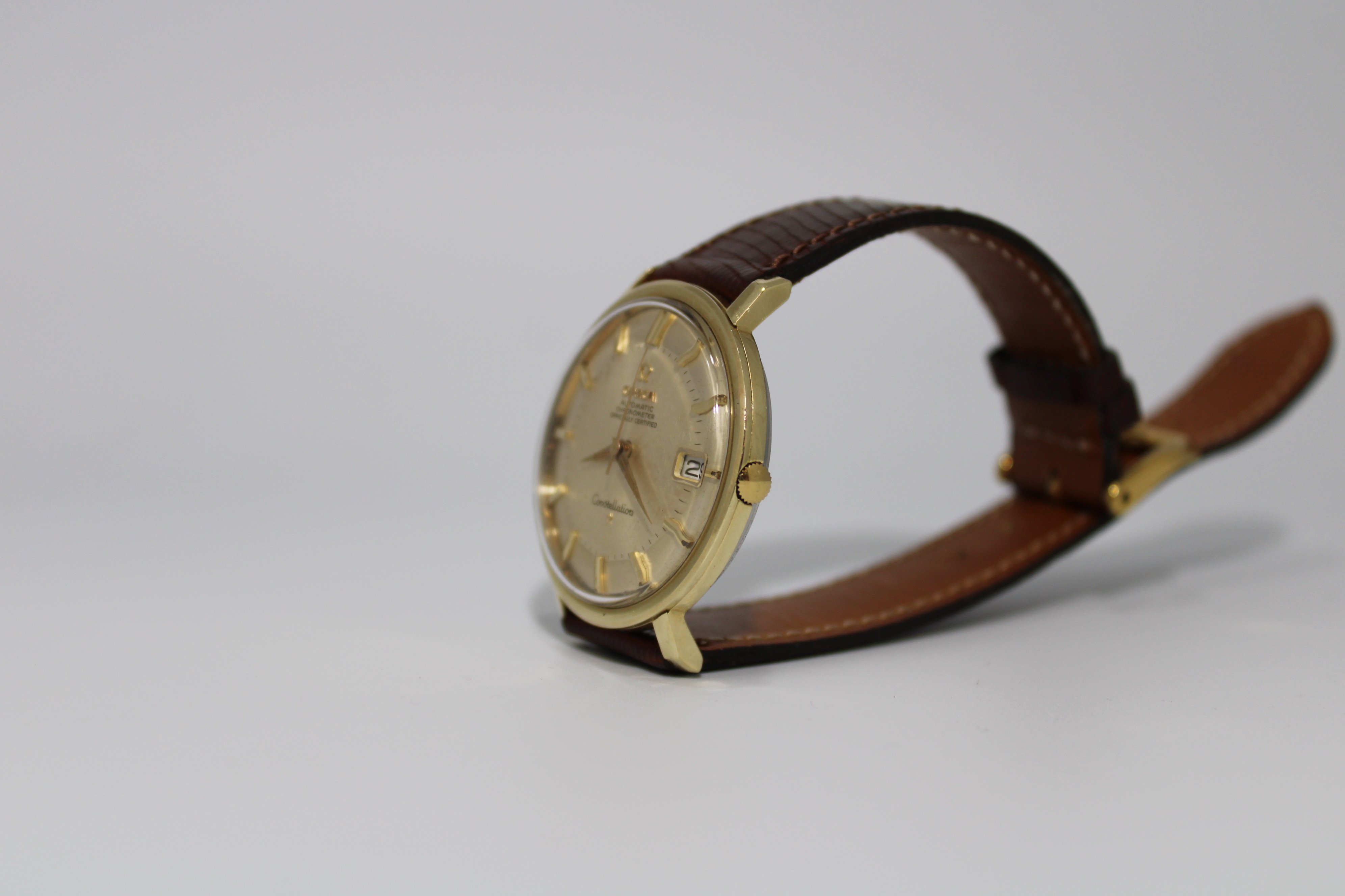

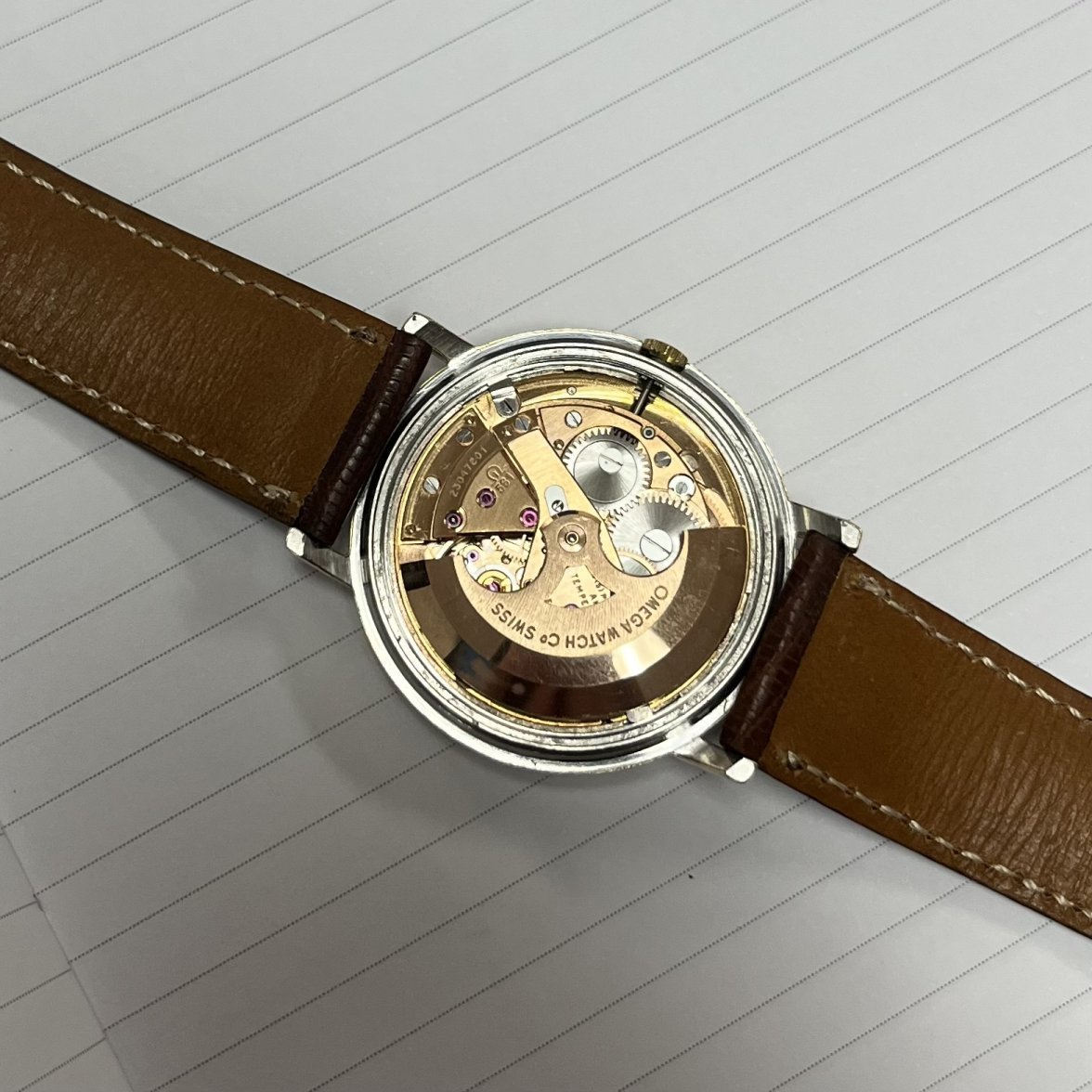

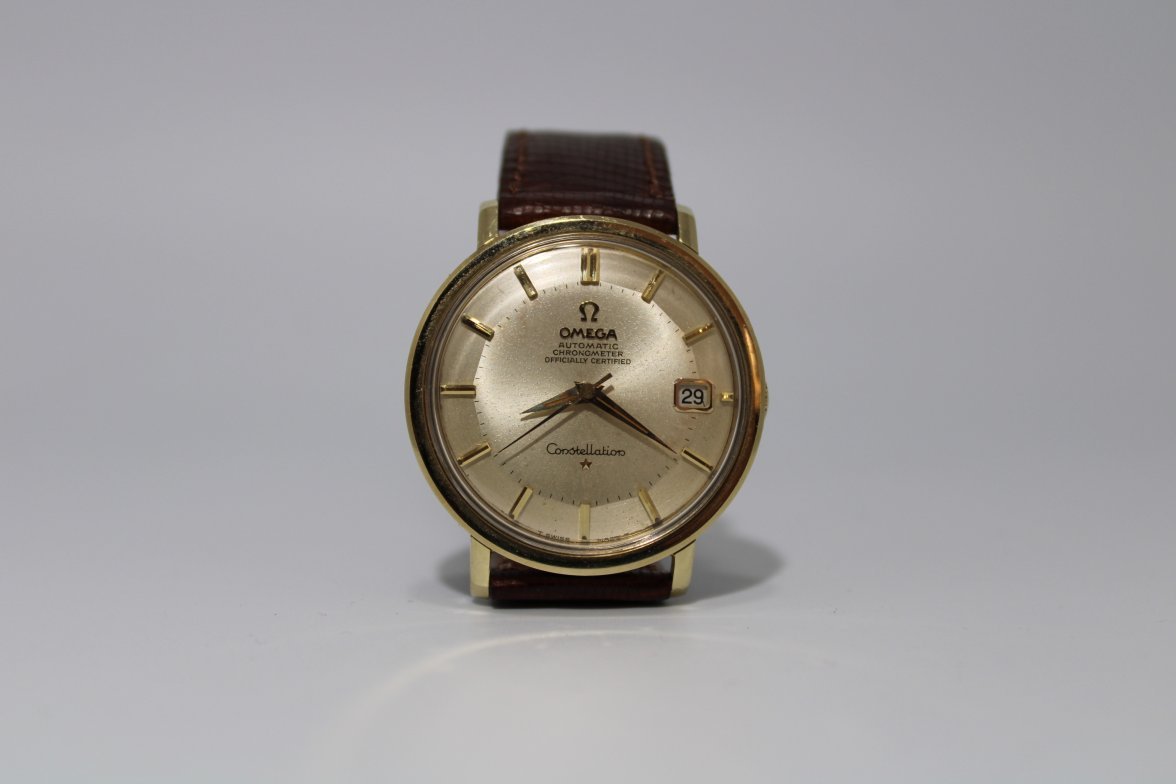

Posts 63 Likes 30 johnk22 ·Aug 29, 2023 I just picked up this 168.004. Cal 561. Wondering if anyone can help point me in the right direction to find the correct replacement crown.
Posts 912 Likes 3,845 rendo ·Aug 29, 2023·faux legend Cousins shows 42522 as the correct crown for the 168.004. You can find more info here, and even be able to source it from an OF member if he still has the crown for sale.
Posts 6,832 Likes 10,502 Peemacgee ·Aug 29, 2023·Purrrr-veyor of luxury cat box loungers @johnk22 If @No Mercy still has an original crown for an .004 then you should jump on it as they are no longer available from Omega. The stated available replacements protrude and are not hidden.
