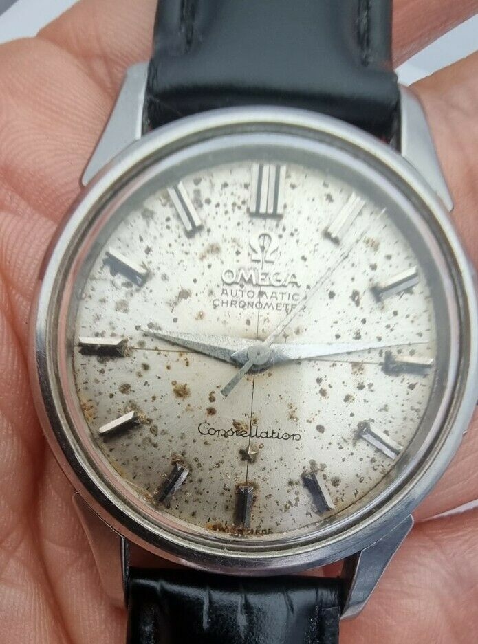

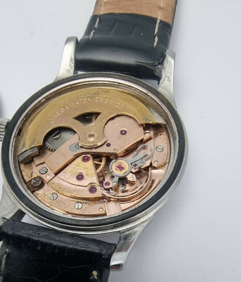

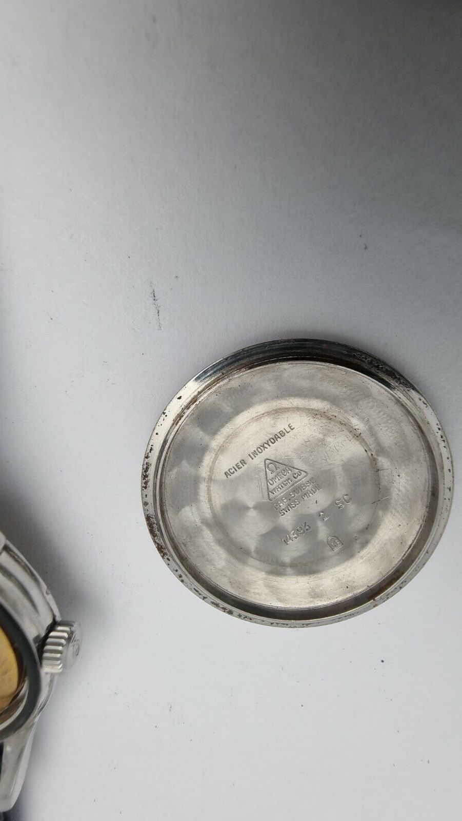

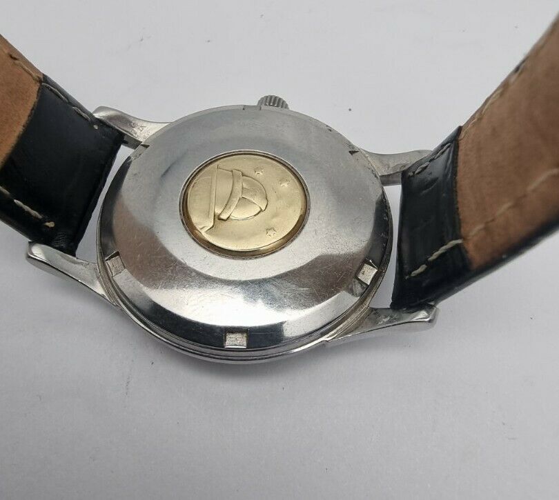

I spotted the following on eBay and recognised that the dial doesn't match the case number - maybe a replacement dial or the back isn't original to the case? The movement seems right for the case style, although there's something not right about that rotor.
I've not been able to find any information as to what the case codes actually mean. Can anyone point me in the right direction?

Wow, that's had some hard life! 馃槻
Looks like a 14381 with the wrong case back

Thanks. That was my thought. Is there a list of case numbers somewhere? - I can only find records for the post 62 case numbers.

From the damage to the leading edges of the rotor and the corresponding ring in the caseback, the wrong caseback has been on there for sometime.
Wrong (plain) hands for the lumed indices dial too.

Fully agree regarding the condition, but 14393 and 14381 cases should be identical, so I assume the rotor rub isn鈥檛 due to that but caused by another problem, faulty rotor bearing for example.
6,835
10,505
I should have been more clear.
I don't mean the rubbing is caused by the wrong case back.
I meant the rubbing on the case back looks like it was caused by that rotor - so they must have been together for a while while being used.
Could be onyx, it looks to me like it has fallen out of the one 'o clock marker.
6,835
10,505
That鈥檚 what I thought at first when I saw the colour of the insert and the naked 1 index but the chamfered indices usually means lume.
-and I would expect a black insert in the hands of onyx on these references.

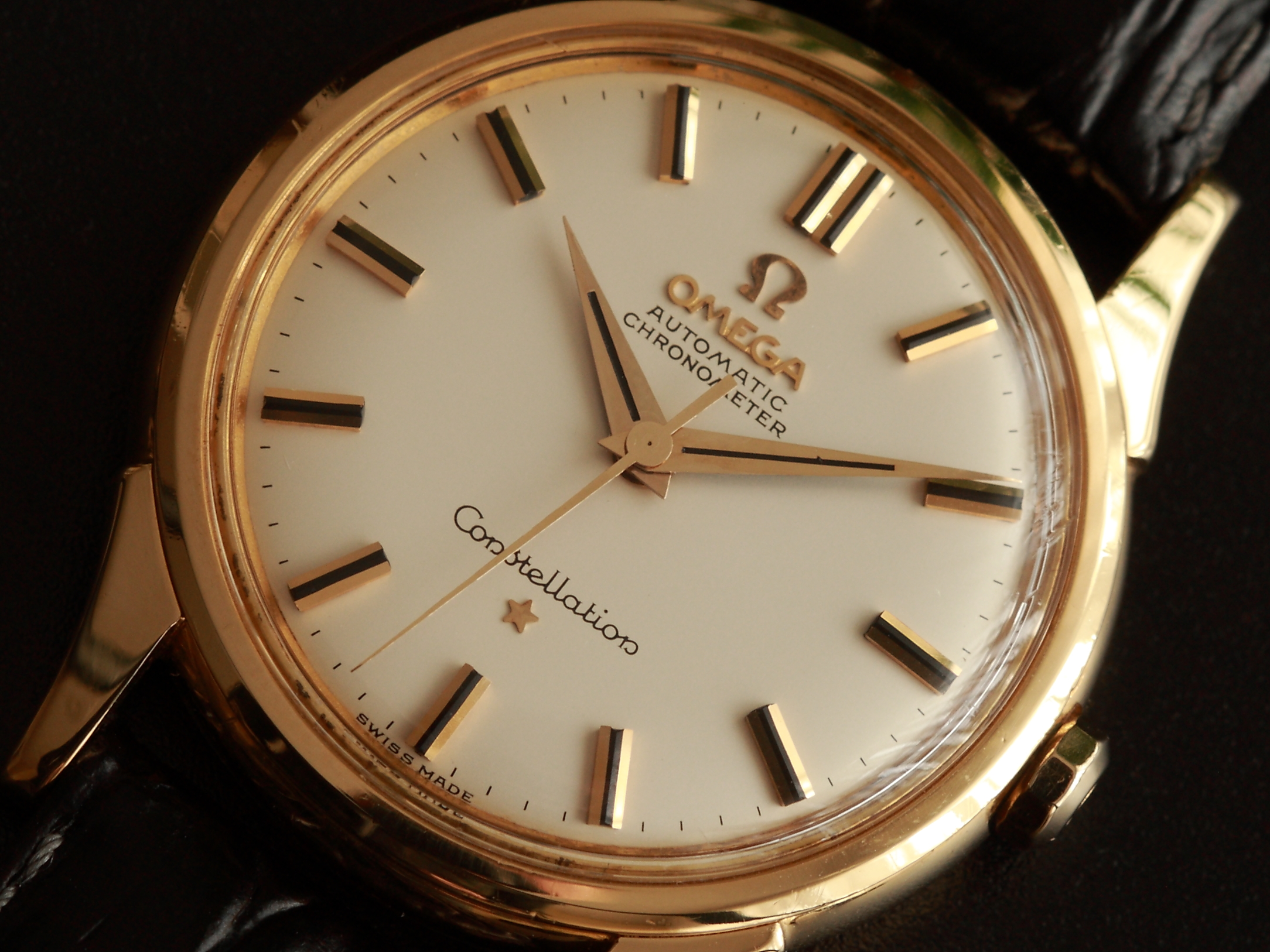

Agreed about the hands, but I've been looking through some of my old pictures and this 14381 is what I had in mind when I posted regarding the onyx inserts. These are of course gold, but both chamfered and onyx.

you鈥檝e no idea how much seeing that watch pains me ( I think it鈥檚 fabulous) but I meant chamfered ends (rather than sides) which is usually reserved for lume
Could you somehow ascertain that those hands have onyx inserts? Your watch is absolutely brilliant and comes with onyx marker inserts and no doubt with original hands. My question is whether we can be certain that hands with onyx inserts were ever produced/fitted by Omega.
I don't know one way or the other. My impression is, and I may be wrong, that onyx dials either go with solid hands without insert or, if they have inserts, with black lacquer inserts. This is not based on any hard proof, only on my observation that all black hand inserts I have seen up to now (including yours based on that pic) do not protrude at all but seem to form a slight pit as lacquer or paint would.
the hands have black painted inserts not onyx.
@cristos71 was referring to the indices.
Dials with onyx insert indices usually have black insert hands.
Yes, I misunderstood @cristos71 , should have read his post more carefully.
So are we in agreement then that there are no examples of hands with inserts of onyx?
touch茅 - My language was somewhat clipped in my response and could have been confusing.
yes, we can agree that the black inserts in Constellation hands are some kind of paint or lacquer but not onyx.
