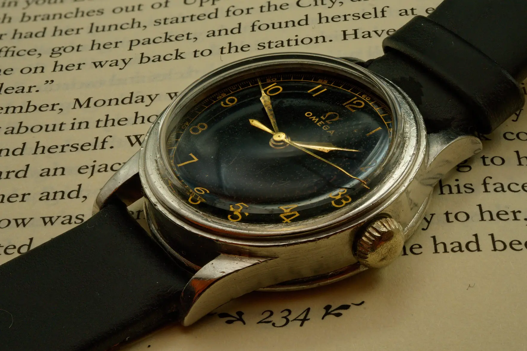

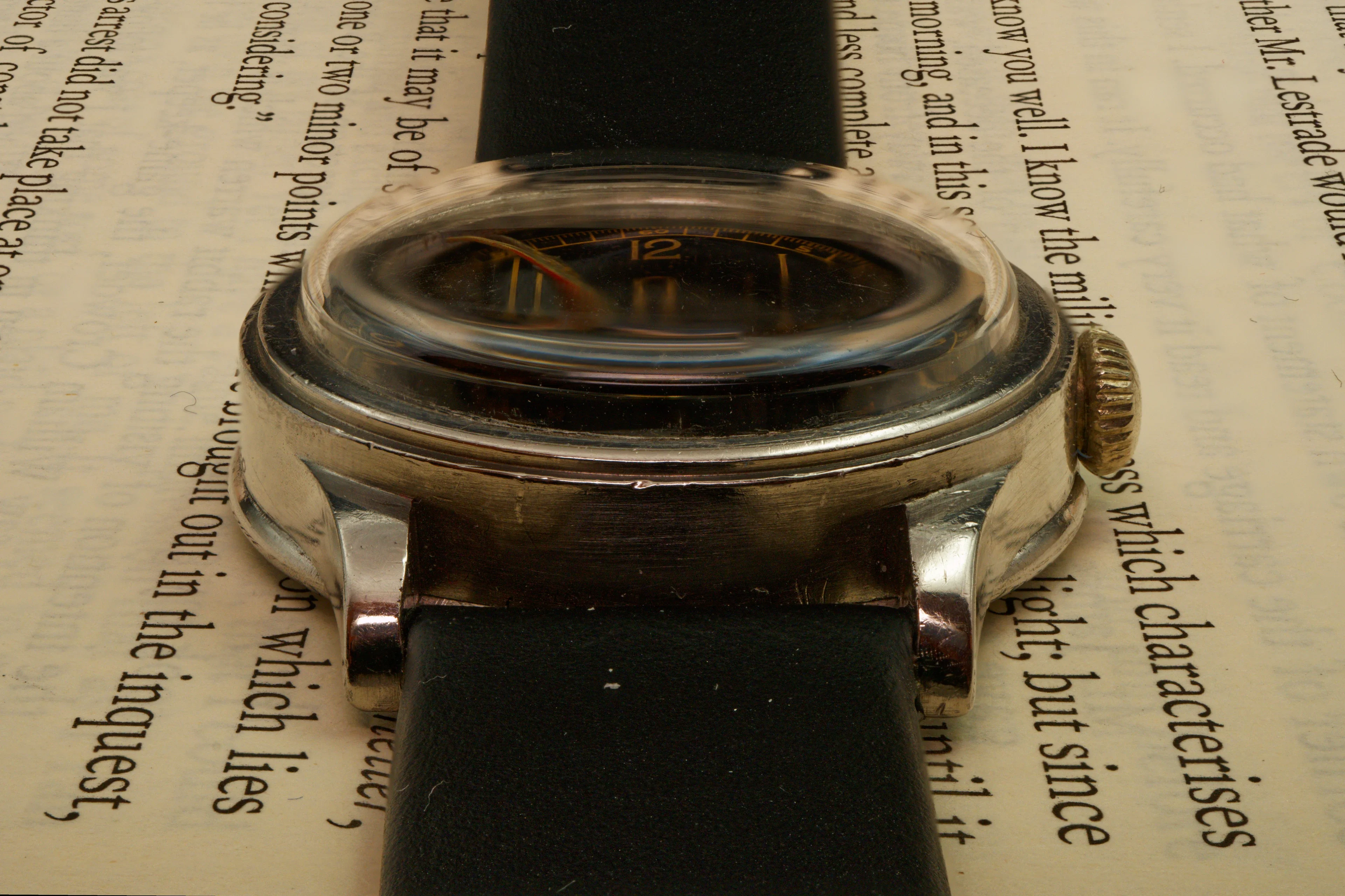

Omega (CK 2064) from 1938/1939 - how original?

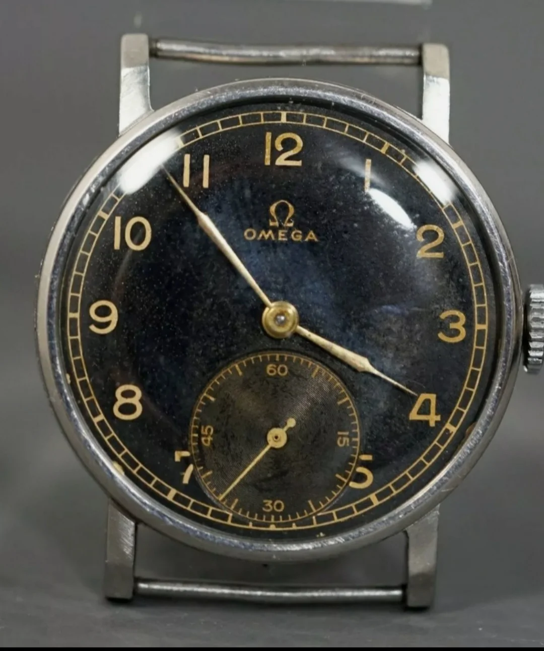

I have a similar one, too.
besides the dial design I don´t see any similarities - well, ok both have stainless steel cases...
3,760
6,391
Both were made by Omega, both have plume hands, black dials, ss cases, gilt dials and both are manual winding.

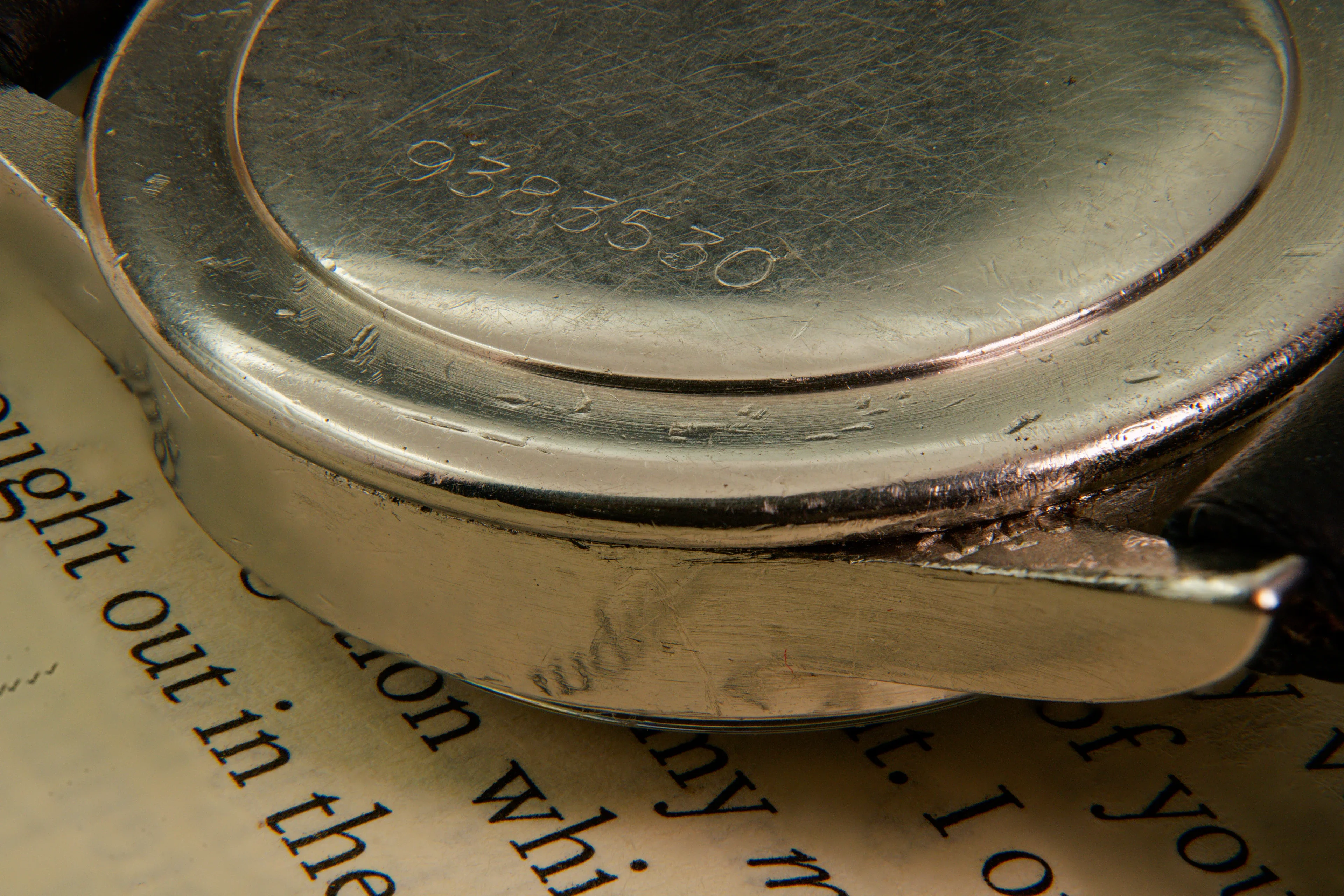

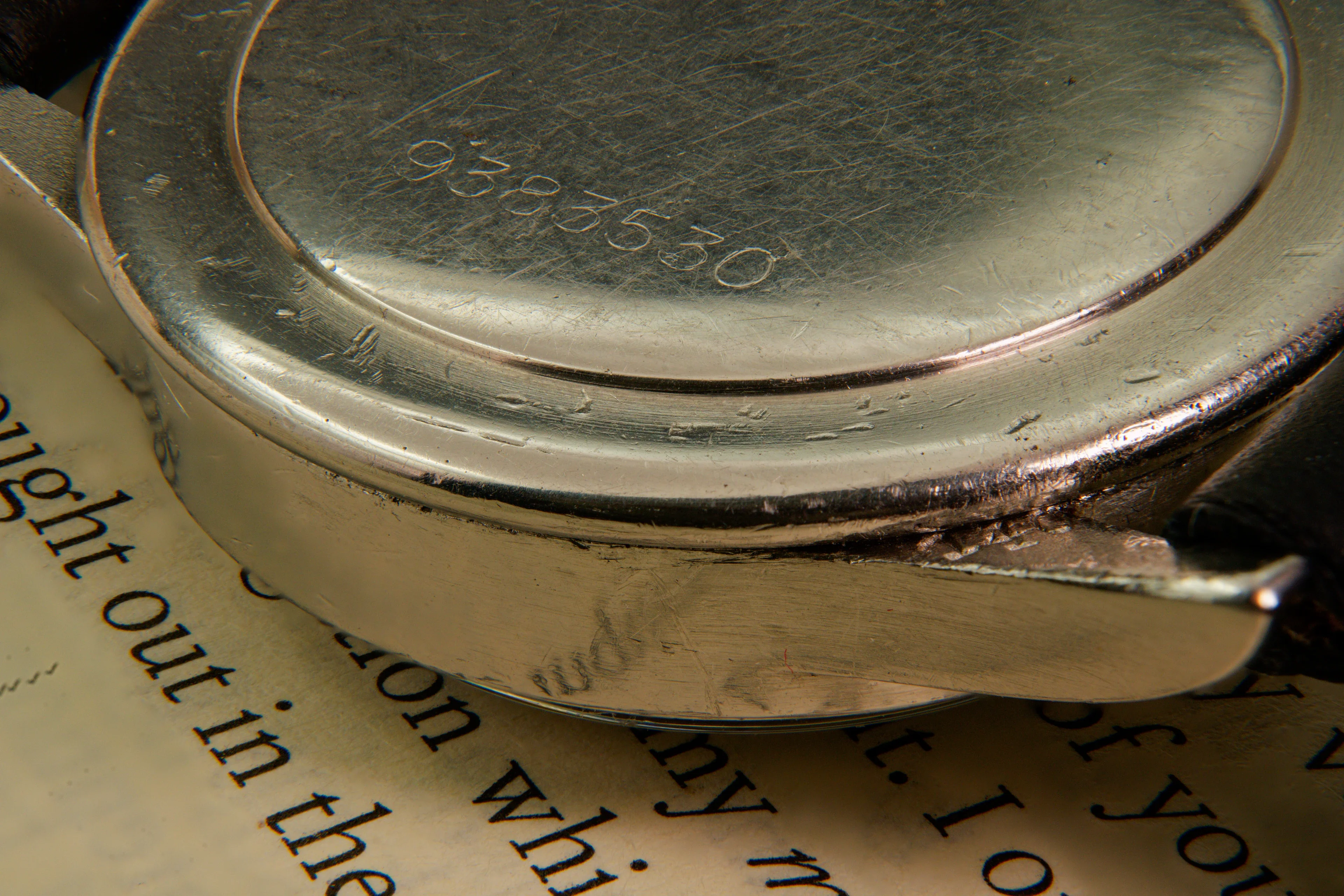

24,527
54,498
IMO these numbers were needed during the production process to pair the caseback with the upper part of the case as these parts were finished seperately. Quality in machining was not as high as in our days with CAD turning etc - hence the casebacks were not interchangeable due to too wide tolerances in production. I have experienced this with the screw down models 2410 and 2254. You hardly can mix casebacks up because they mostly only fit on the correct case with the corresponding number.
This is a plausible explanation that I have not heard previously, and I have not personally tried to swap casebacks on one of these references. It does make sense to keep well-fitted cases and case-backs together, to facilitate assembly.
However, as we all know, one does commonly find watches with mismatched numbers on caseback and lugs, especially military watches, where watchmakers serviced many identical watches simultaneously. So in most case, it is apparently not so terribly difficult to swap them.

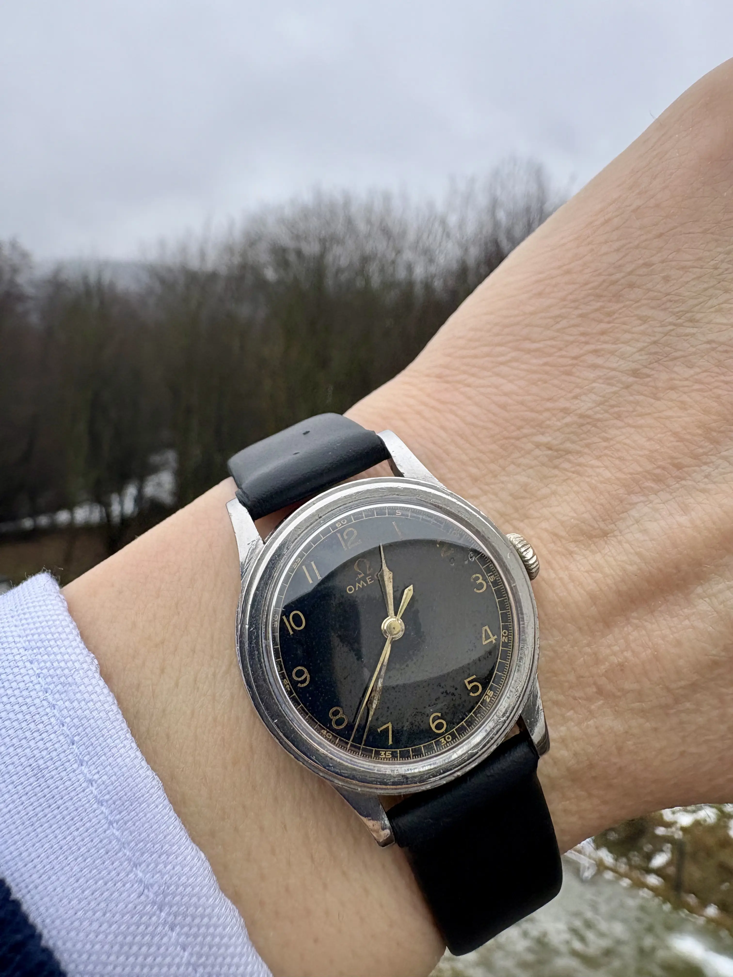

The watch is back from the service and here is the promised wrist shot. It's gorgeous! 😀
A bit busy today and tomorrow, but I'll add some photos I've got of movement etc. a bit later.

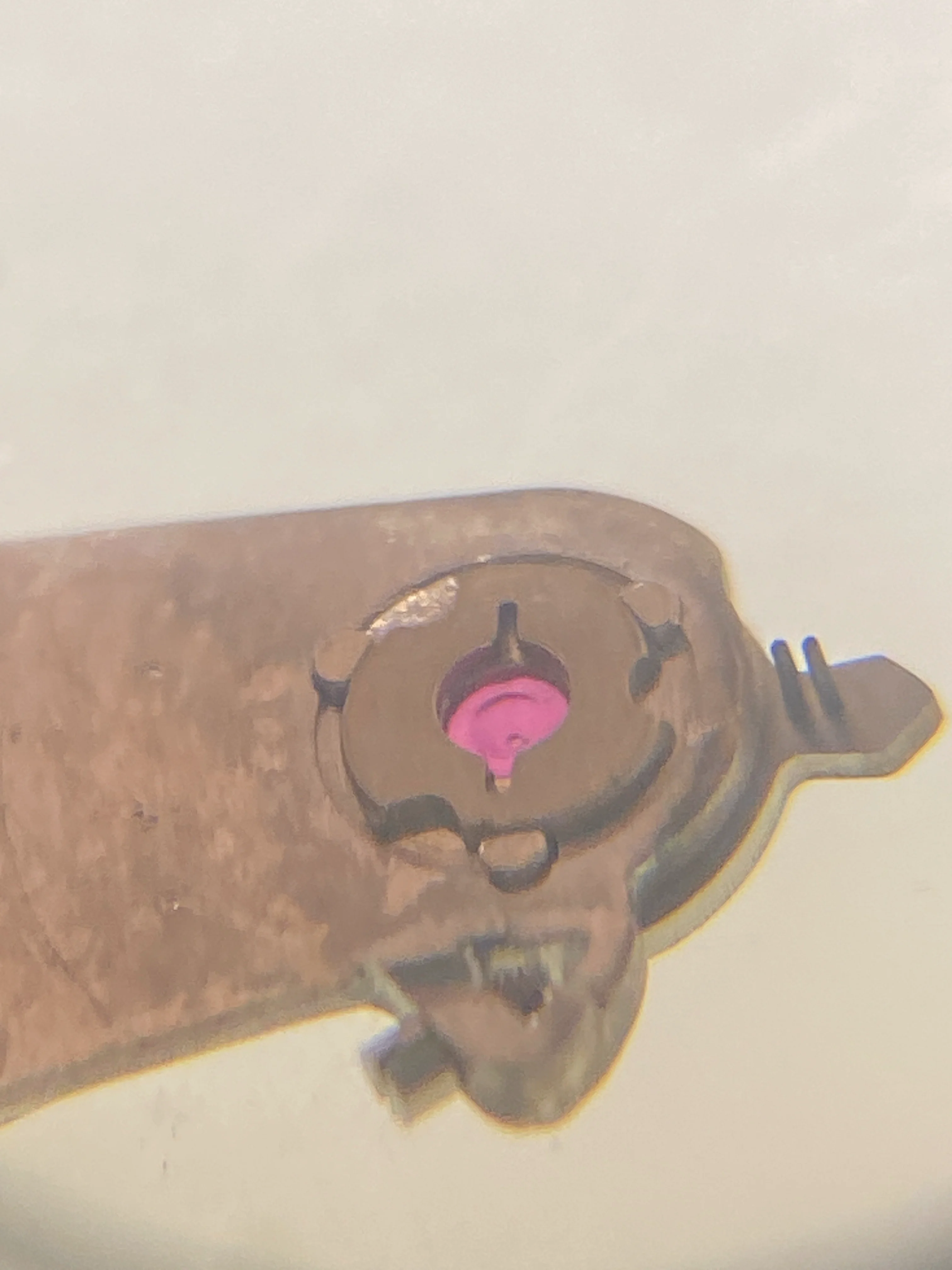

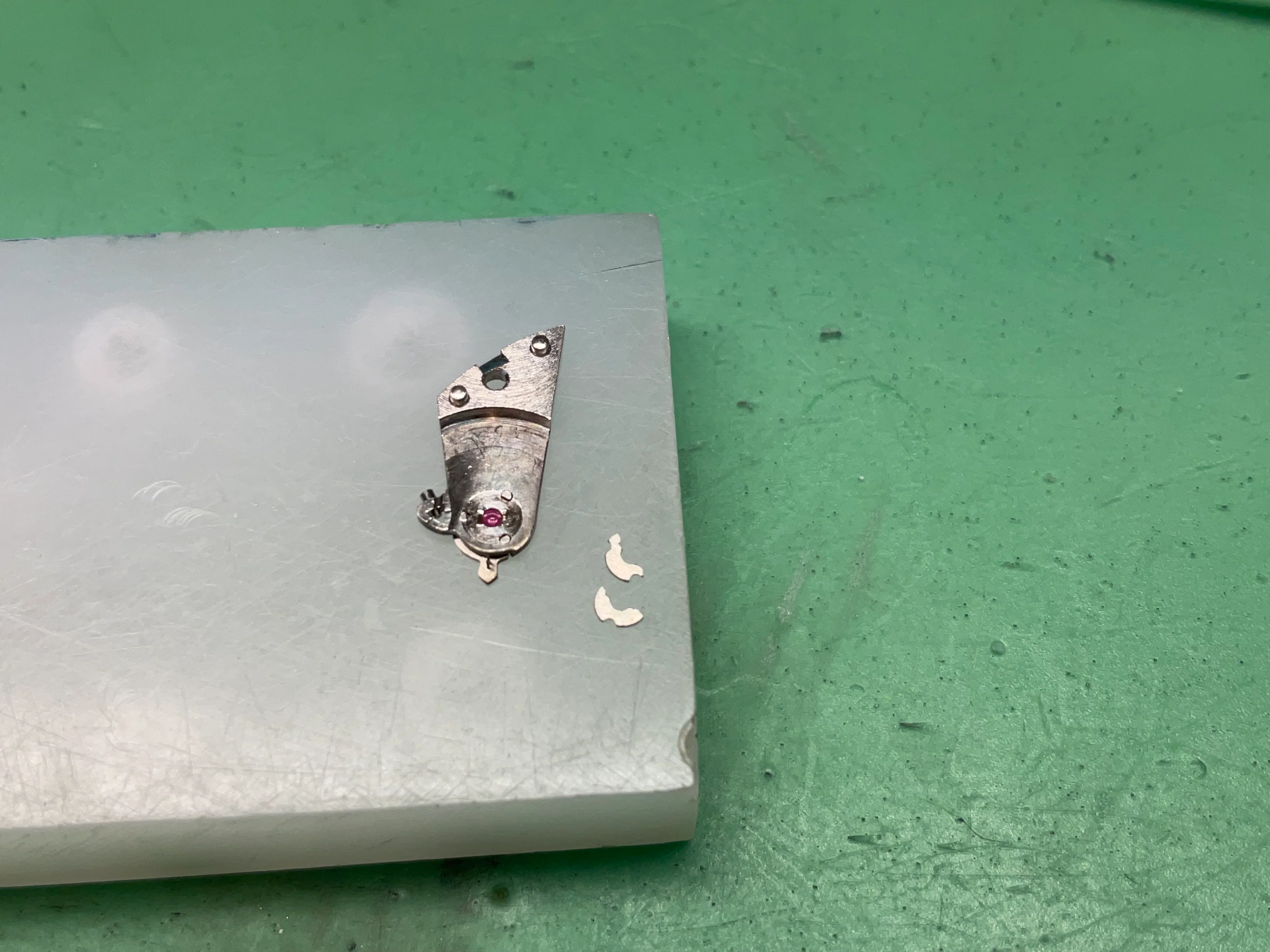

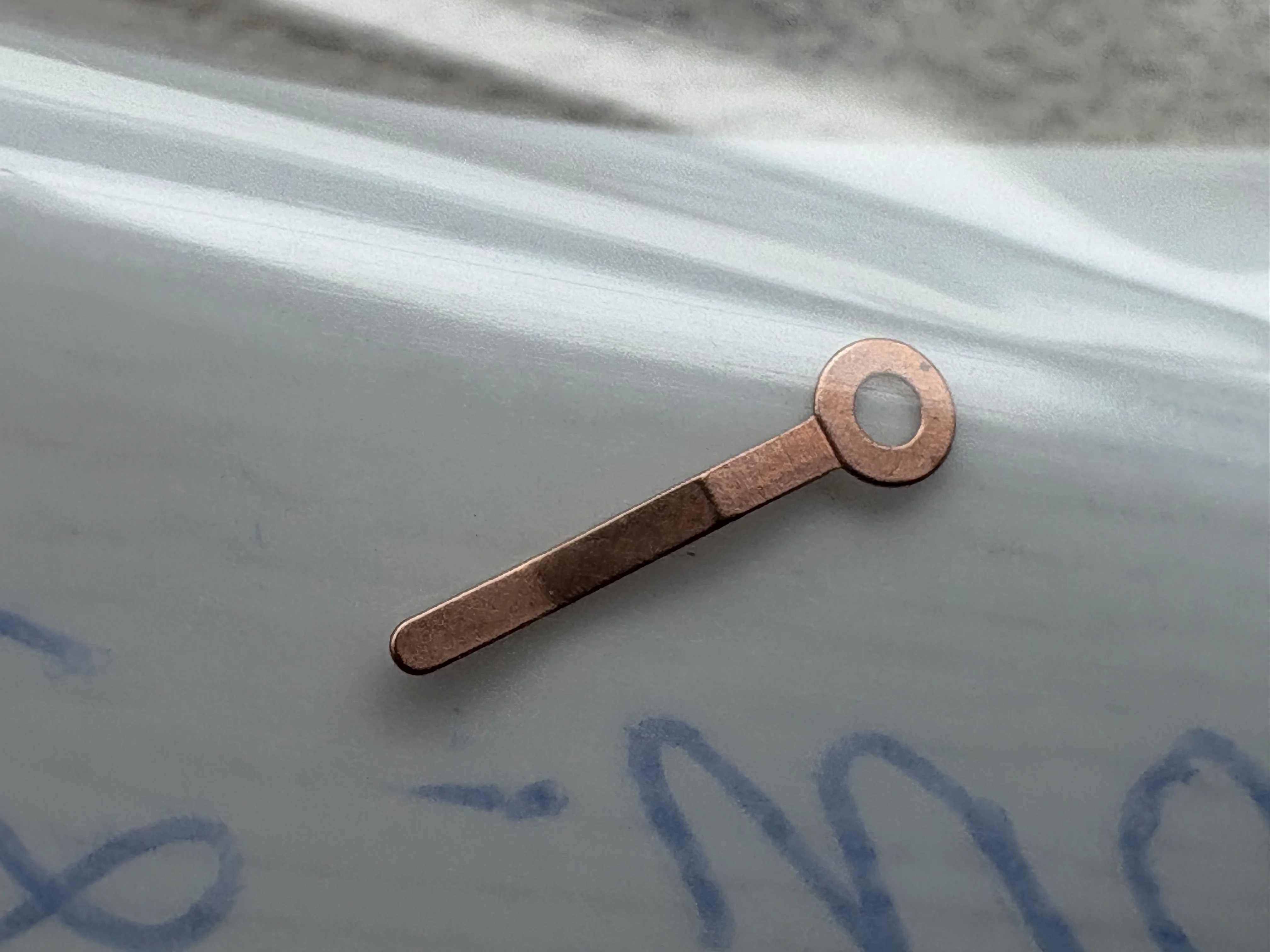

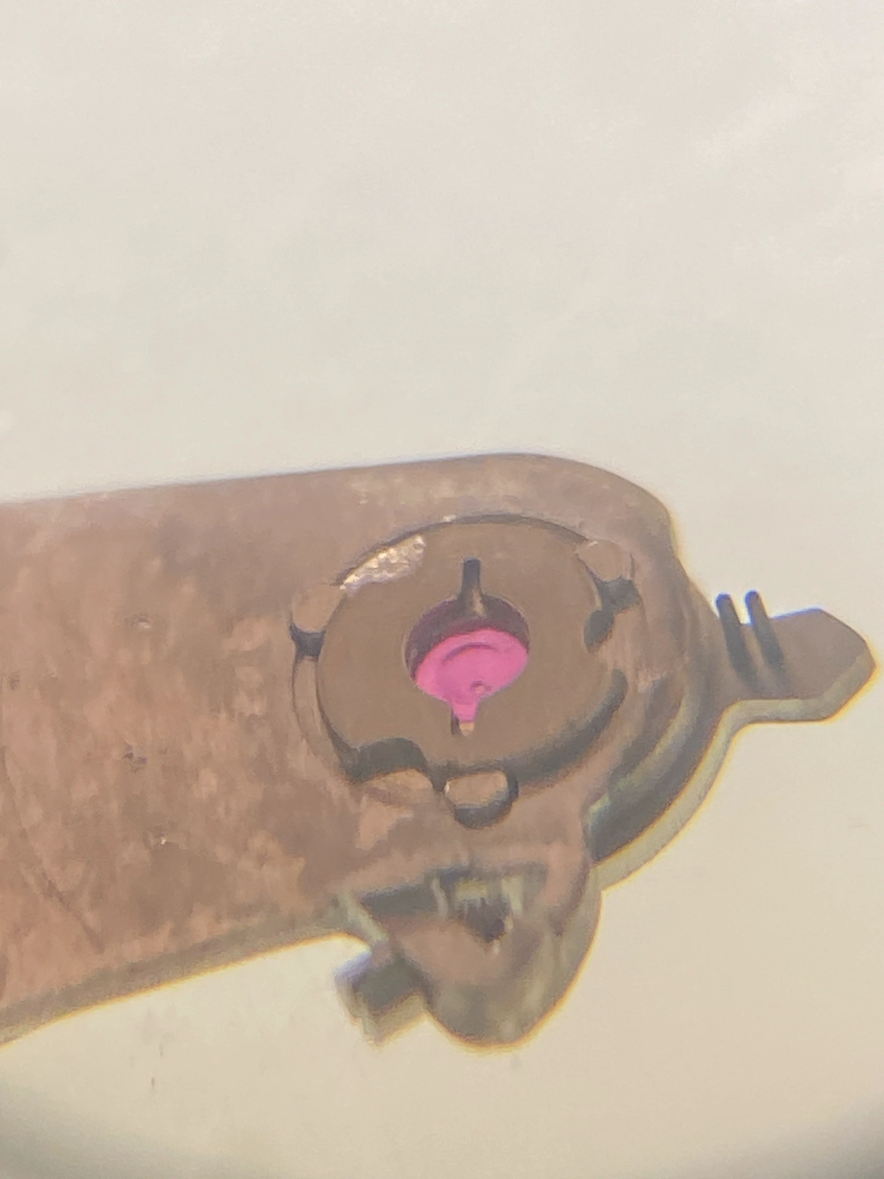

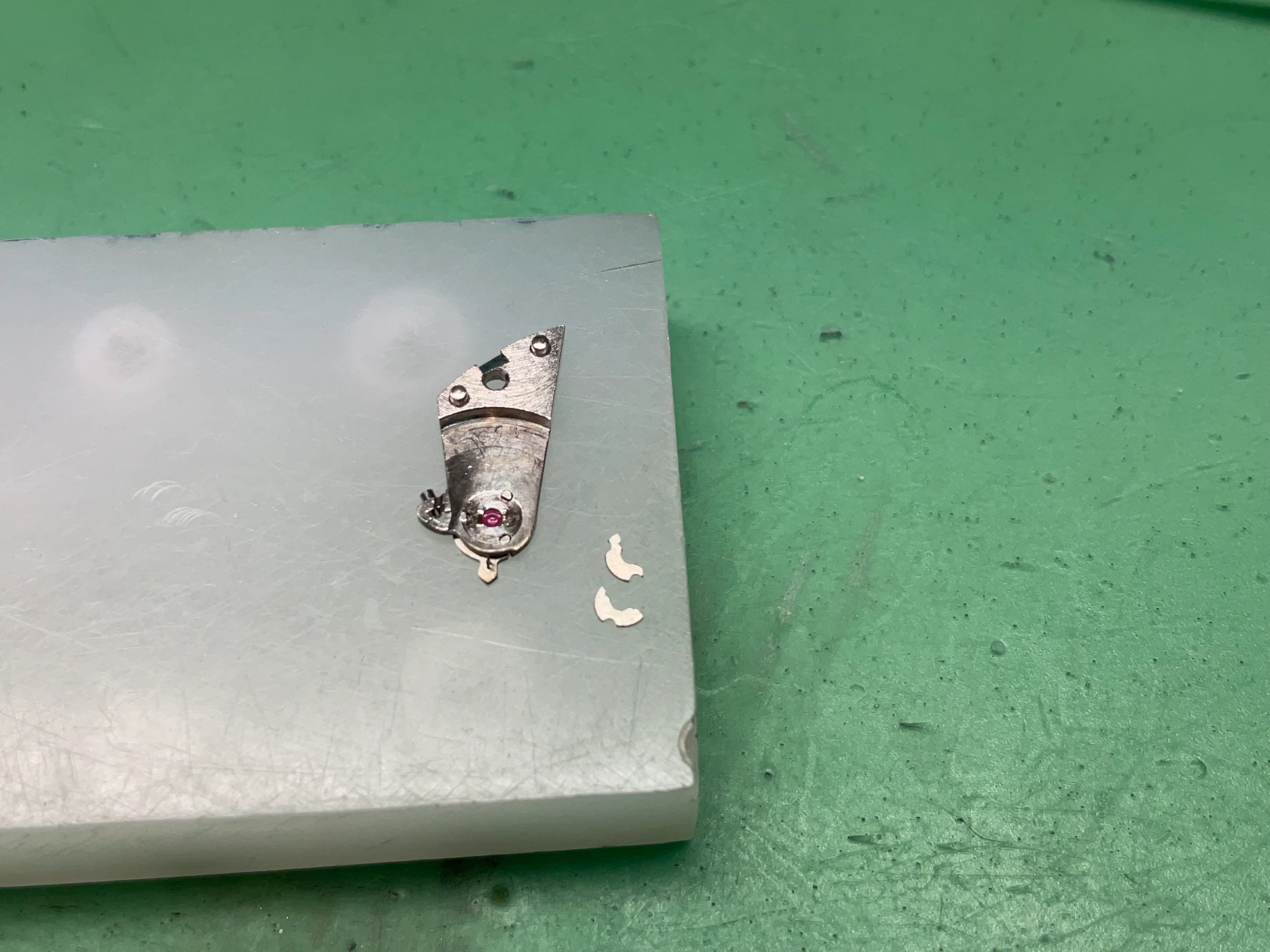

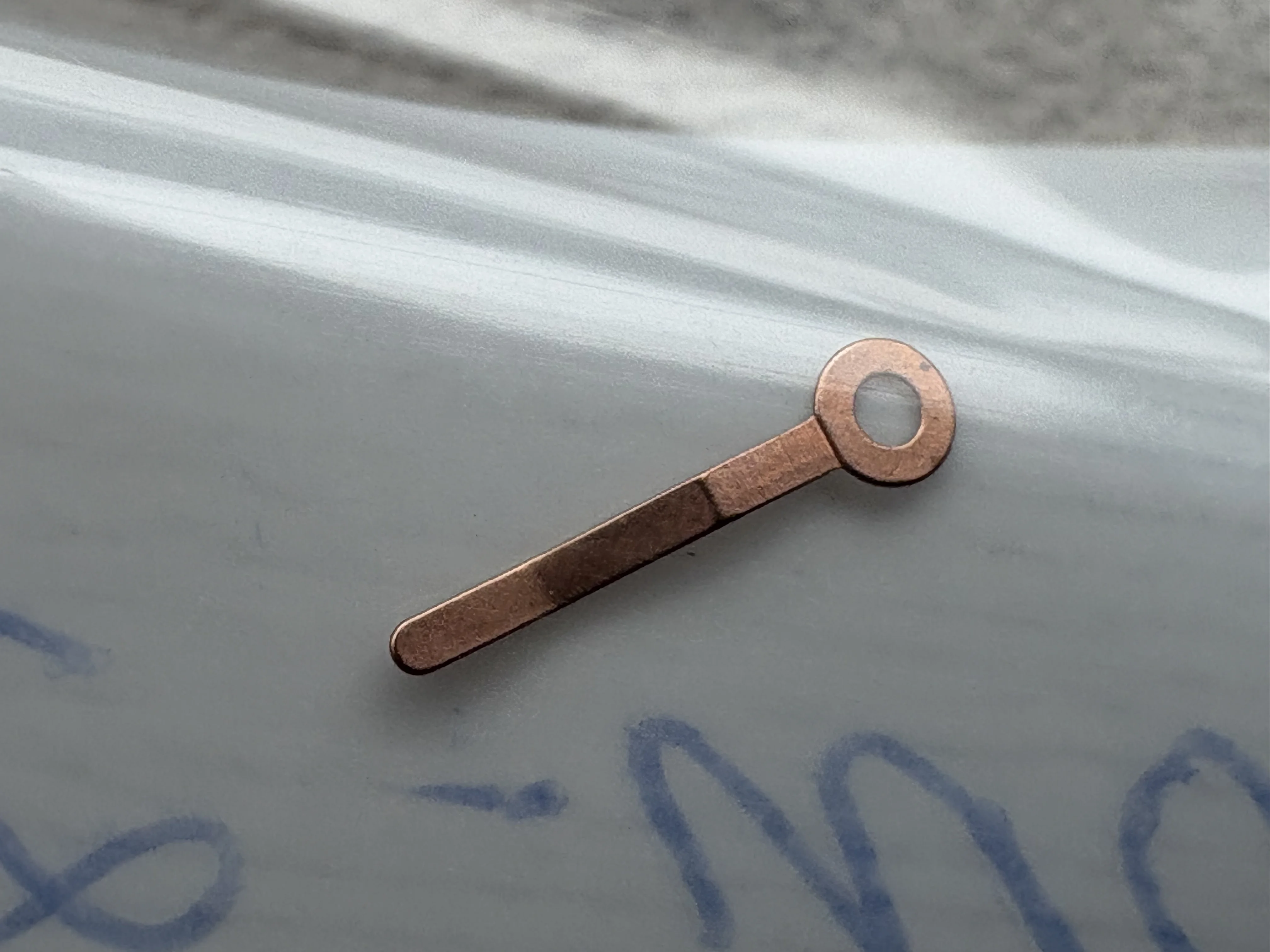

During the service it received a new friction spring and jewel lock. Friction spring was sourced from Perrin Supply (Omega part no 471/98) and jewel lock from Ebay (Omega part no M/203, 1335/OME 220). According to the watchmaker the amplitude is in and around 260° when measured in different positions.
Broken jewel lock and the replacement in place.
New friction spring
Video closeup of movement running with a new friction spring in place.

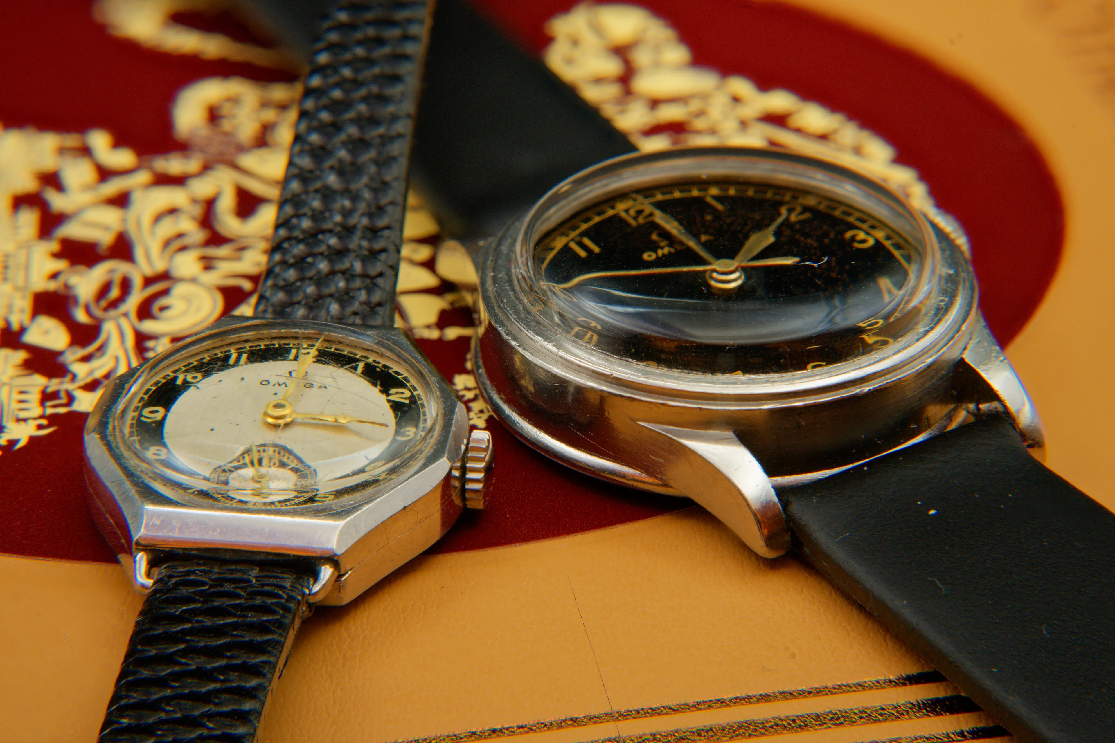

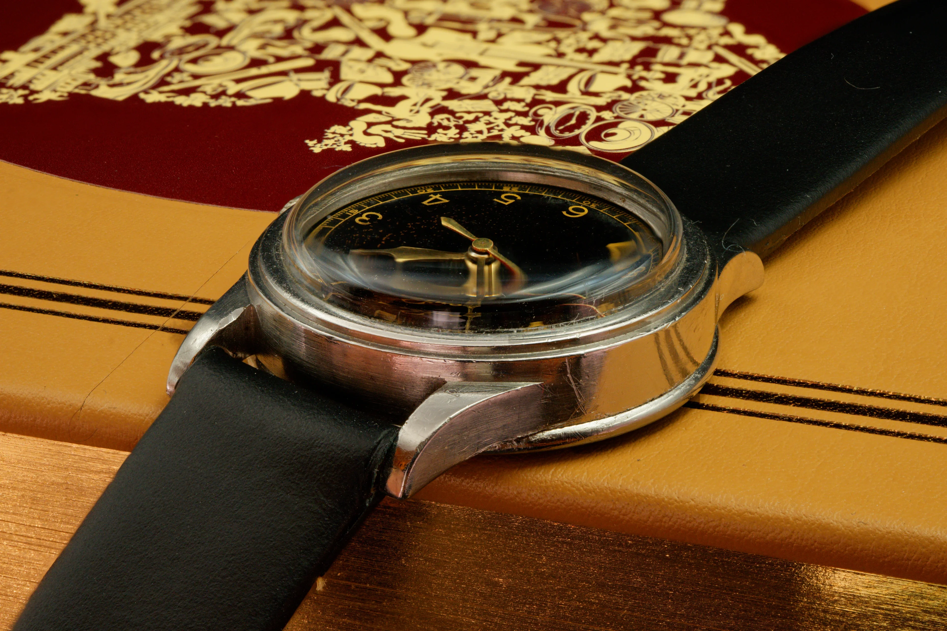

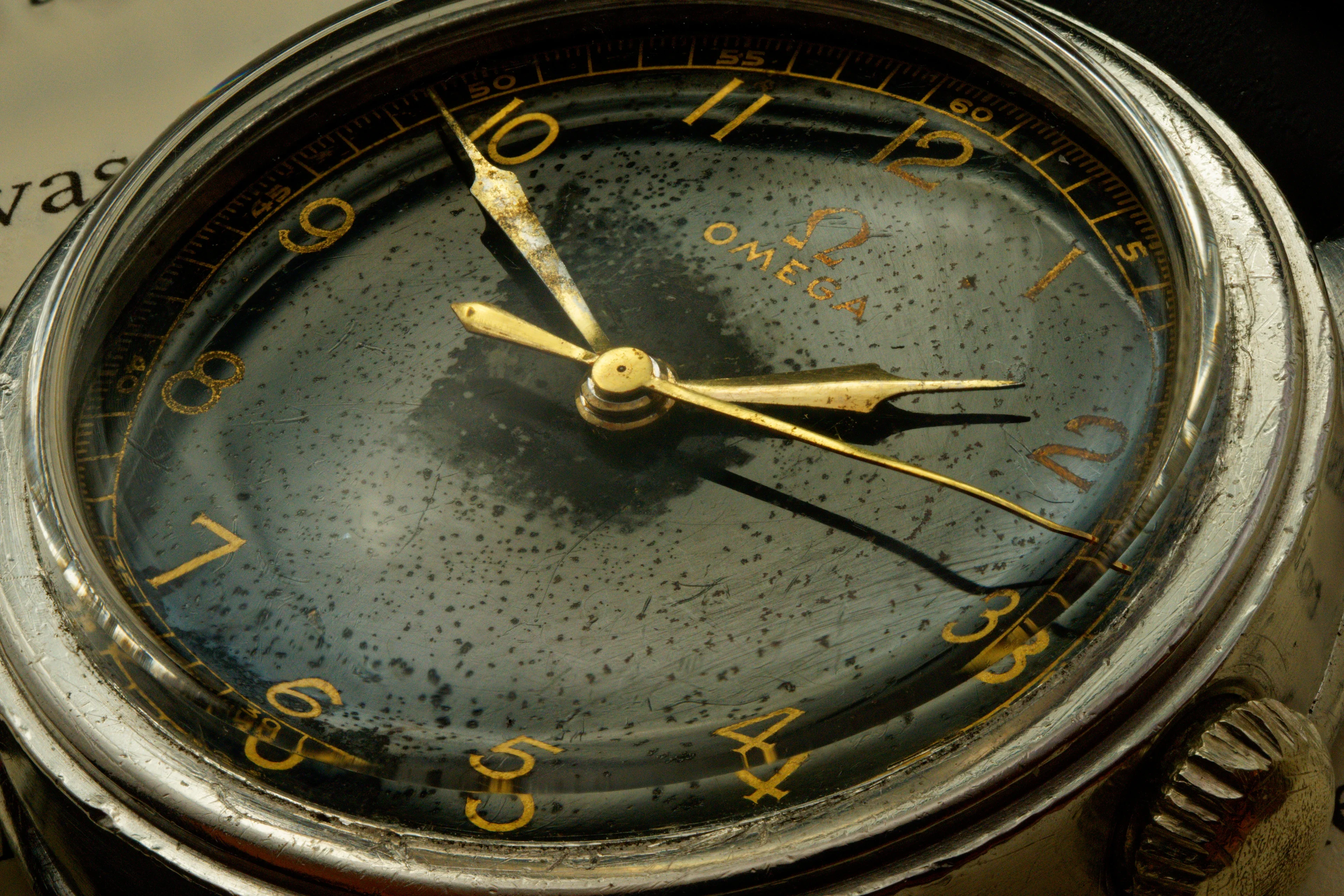

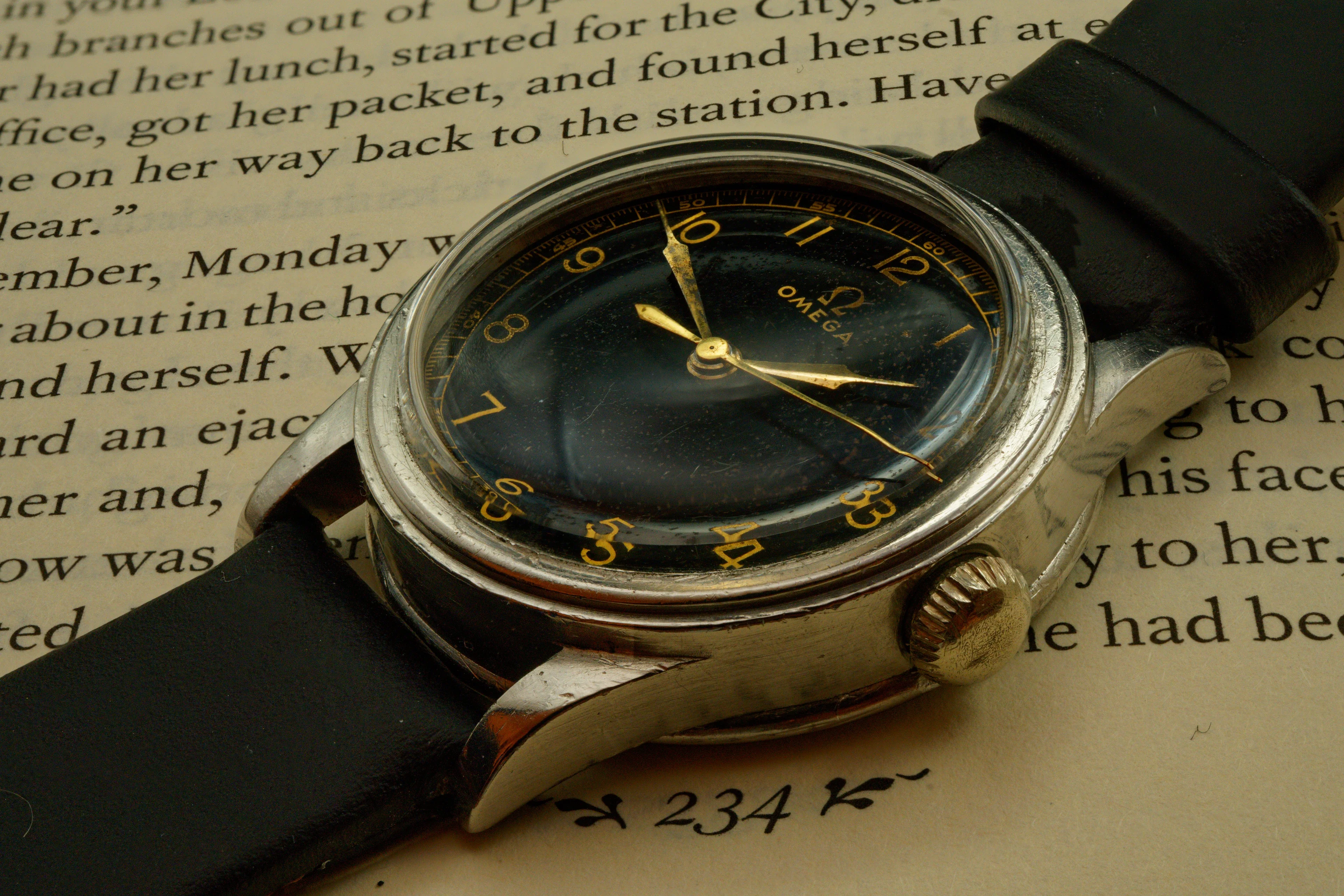

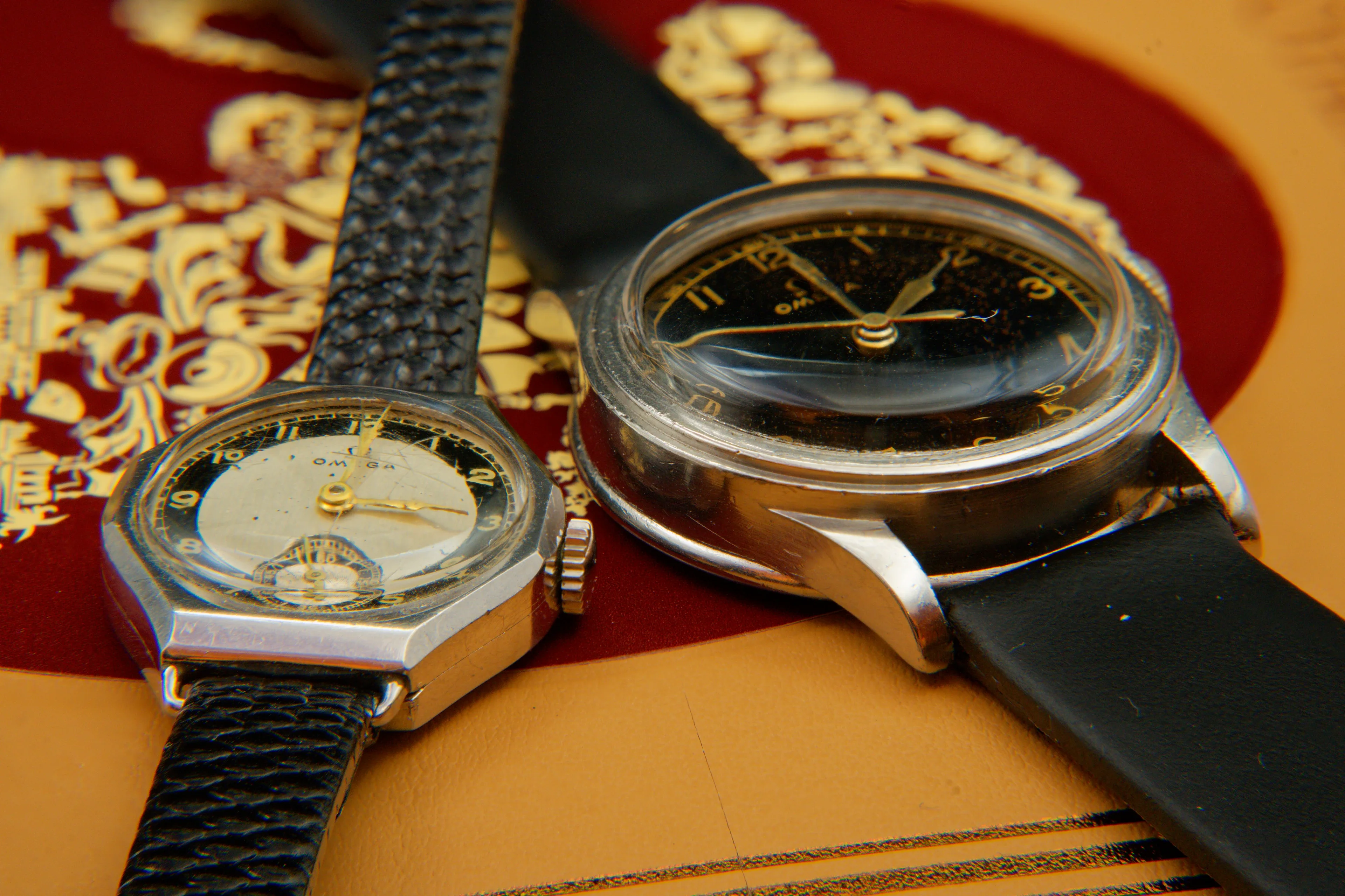

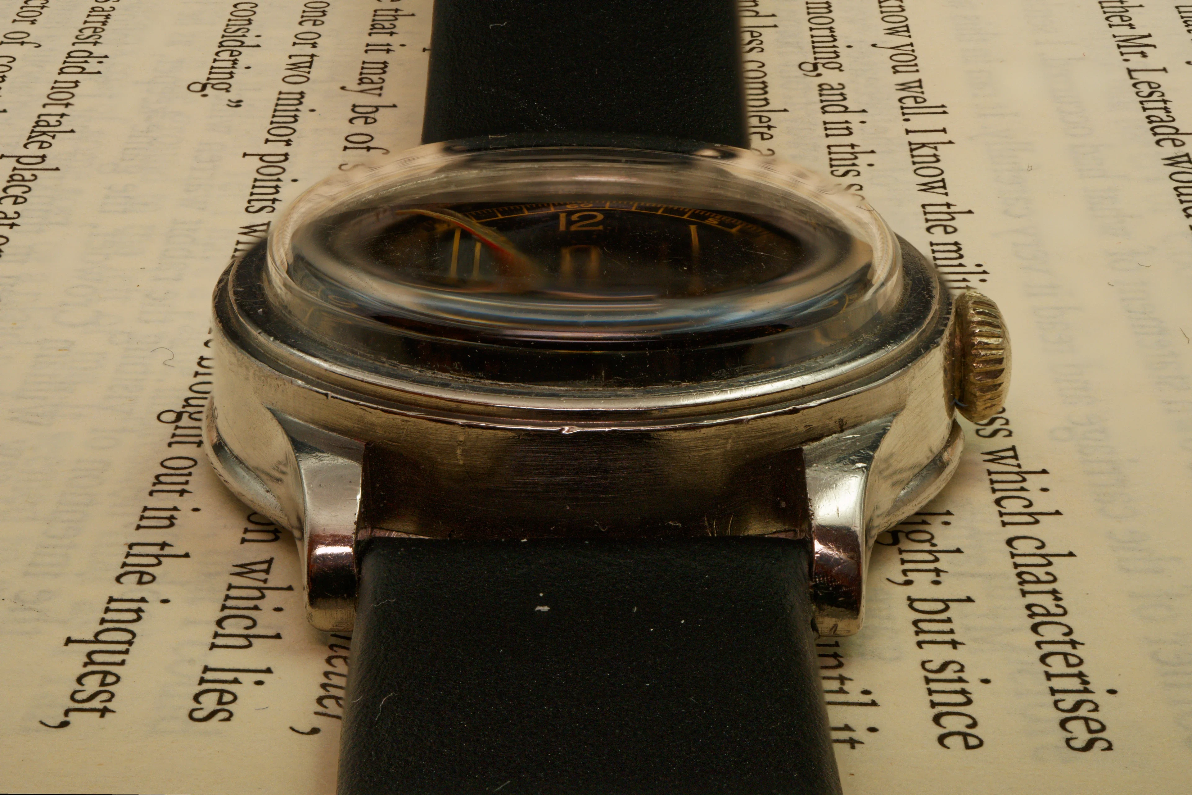

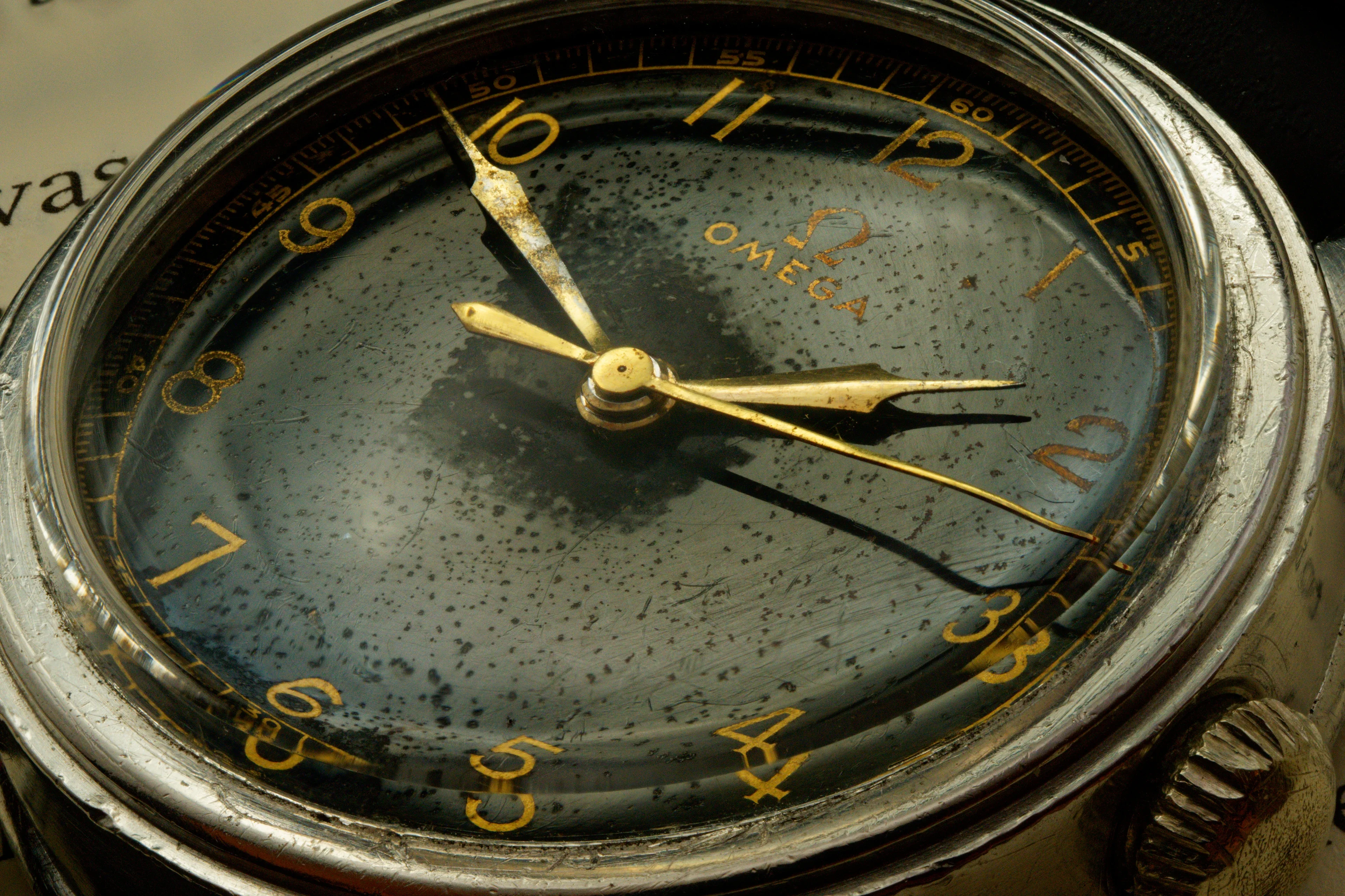

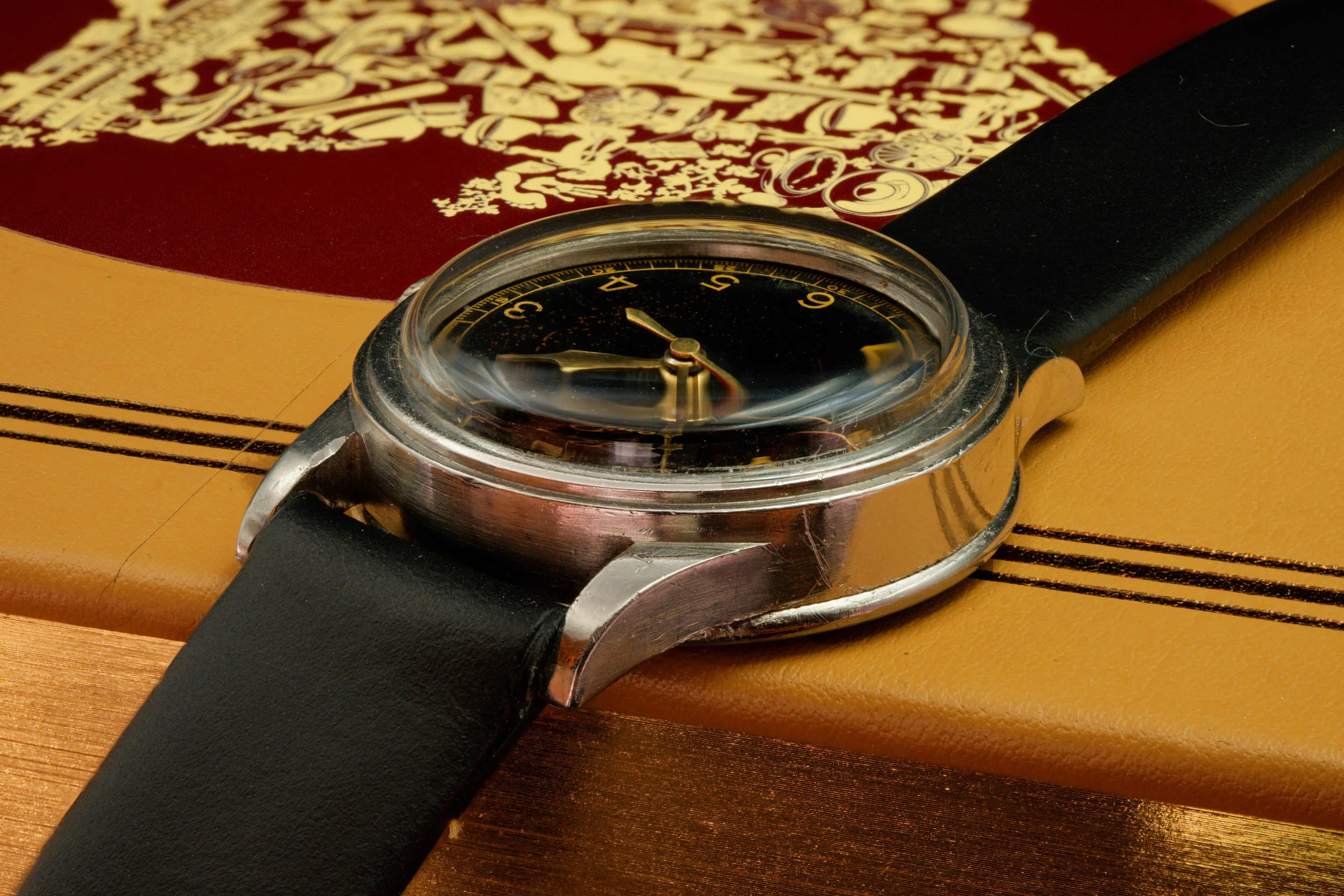

I've been lately trying to improve my watch photography and finally yielded and started practising doing focus stacking last weekend. Here are some 'artsy' photos I just took of the CK2064... Enjoy! (and so much for being 'busy'.... 😥 )
And in the last photo the CK2064 paired with yet unknown reference maybe 19.4T2 based ladies Omega that I snatched up from an 'estate pirate' for my wife because well why not... 😎

what are you using for photos? iPhone? I still have a 12 which is prior to them making all their enhancements to the camera and I cannot get pictures of this level yet
143
1,087
Sony A7R4 for these kind of 'art' shots. I am still perfecting the technique/workflow but I am now practising shooting focus stacked 240MP images (via a7r4 pixelshift). 😅 I should add that although iPhone is wonderful in how close you can get to the subject, at least on non-pro versions the effect of computational photography on fine detail is absolutely infuriating!
