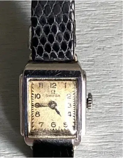

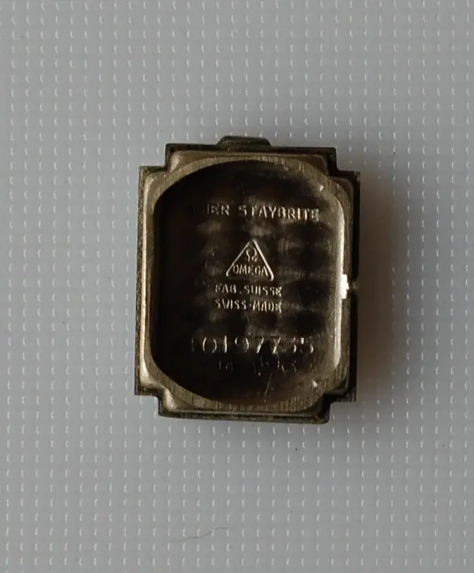

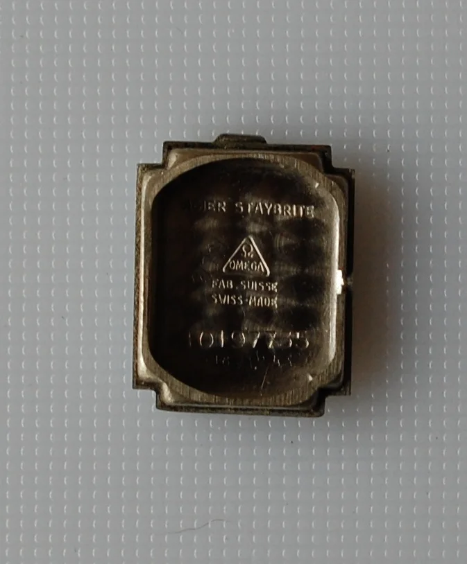

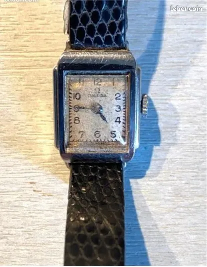

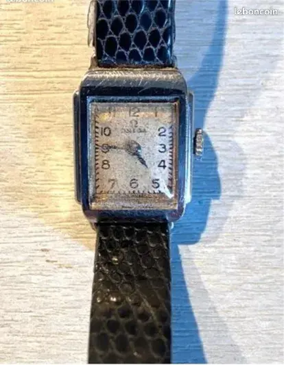

Hi everyone.
I buy at 60 euros a poker move this watch.
I plan to make it look better..
But i need help to find the model.
I still not have receive the watch

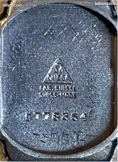

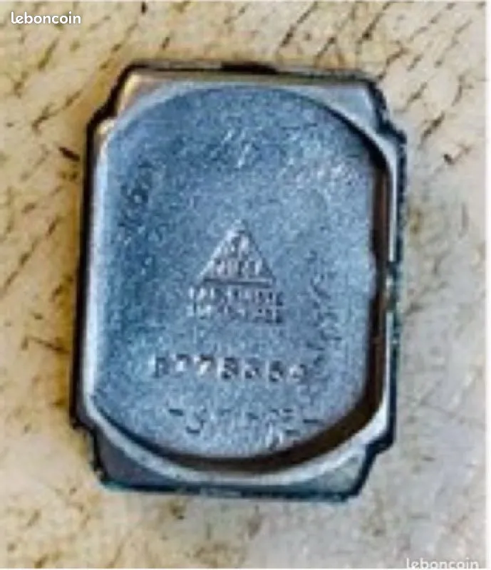

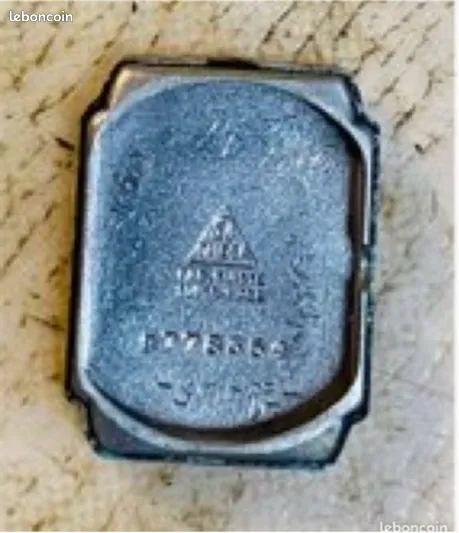

i find some reference On the back case
Can you help me?

Neato old Omega!
A photograph of the movement would be both appreciated and helpful.

Hi everyone first thanks you all
then as I said I made a poker move. So I still need wait to receive the watch.
I hope not a sausage !
As soon I get it I will send.
I keep explore every corner now.

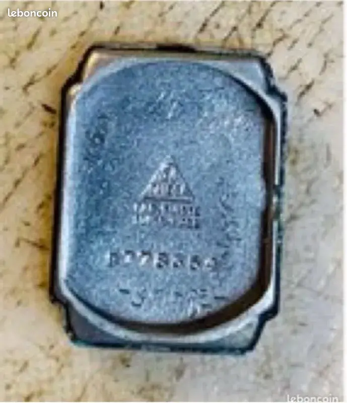

I barely read something like
778354 as number.
24,606
54,642

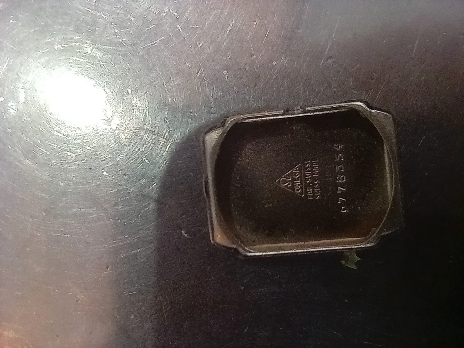

778354 as number.
I believe there is another number before the first "7", perhaps an 8? The case serial number should have seven digits.
Thanks
Good to know for me to progress

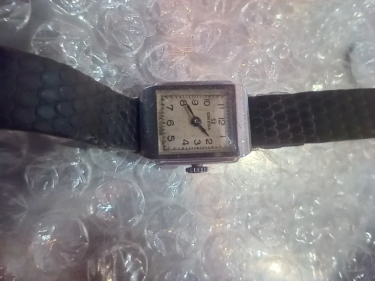

I should receive the watch next week.
I will share it..
Good find at 60 or a sausage let's find out soon.
Pray for me

Maybe if erased number will read 877 ?.

Thanks for the heads up Tex.
In fact I think @Tire-comedon would be the right person to answer this (difficult!) quiz.
I guess it’s late 1920s - and if so could be one of several calibres (such as 19.4, 23.7, 26.5), depending on size. We’ll see when you receive it and can show the movement.

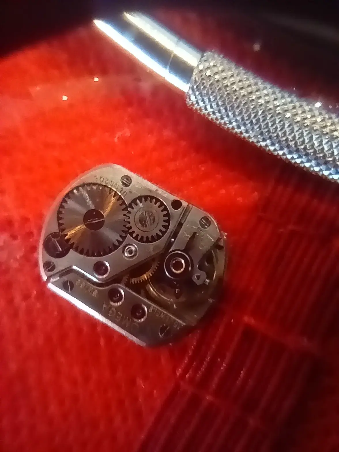

I will for sure, I just hope don't find a 233-66 cupillard on this one 🙏 even I will can re-use the movement.
Just now waiting for the package 4-5 days.. then I will share the inside of this watch, hopefully survived whit his own story inside...

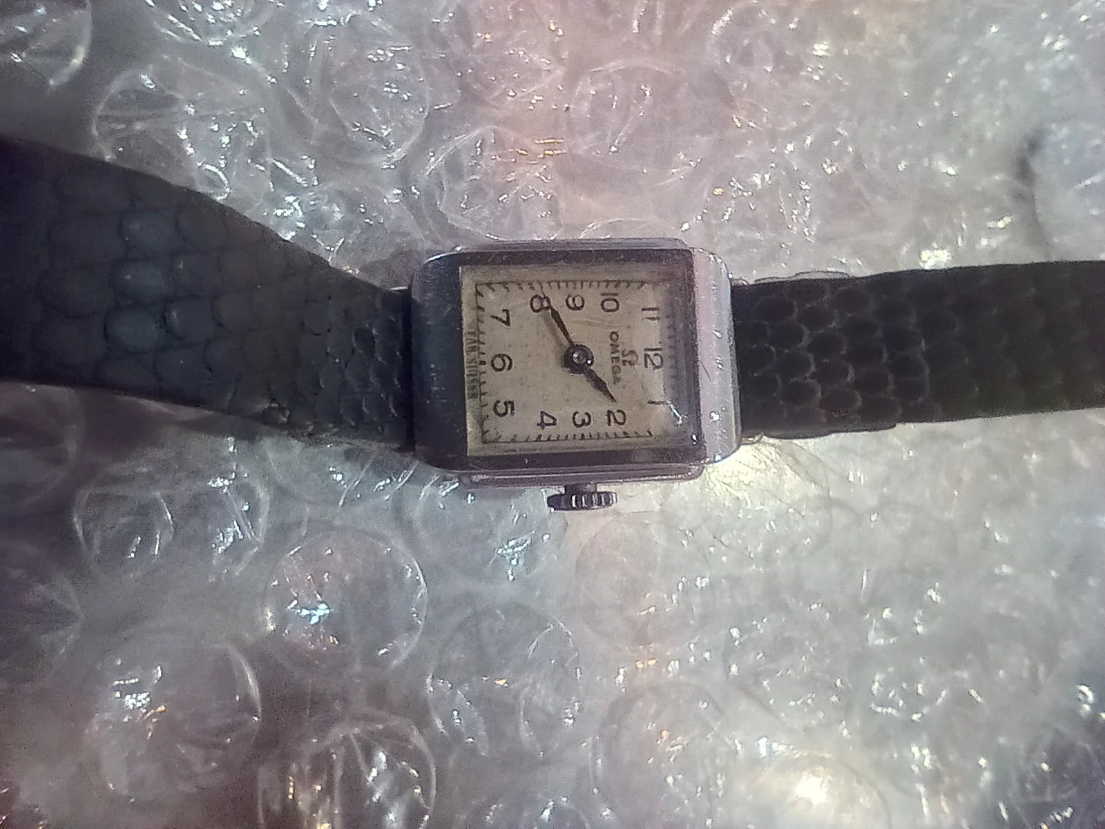

A poker move.. nobody wanted to buy it at 60.. poor picture. The watch look dirty, I say poker move because at 60 nobody buy, probably they all think it's a sausage, a fake, a frankenstein or whatever... but there you can feel the beauty hide behind..
This watch are like humans.. need someone love to be alive again..
So OFF COURSE 😊I will show you all the result, the inside and the before after

How large? Two hands. Not sure what that movement shape is called, but perhaps a 244 caliber
18,209
37,976
Looks small. Ladies watch? Maybe a caliber 210/11/12/13.
Guess we'll have to wait.

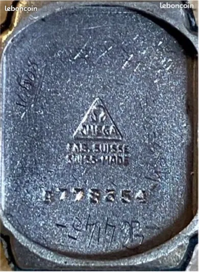

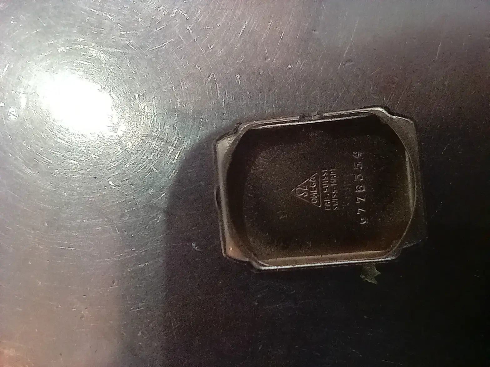

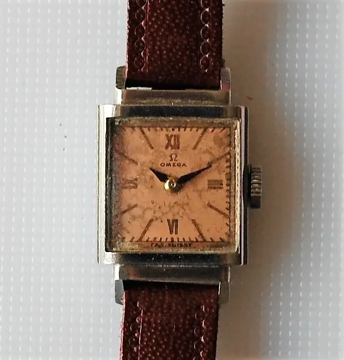

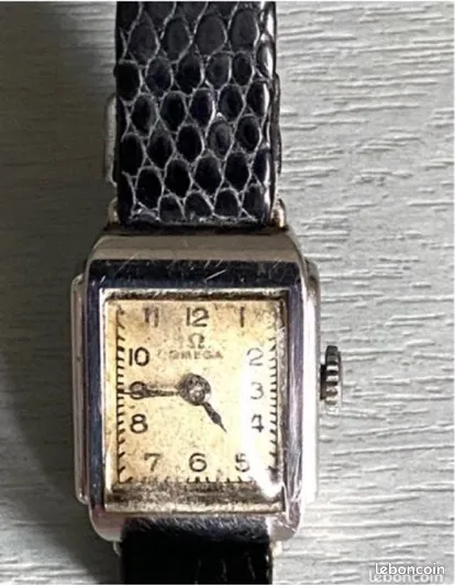

I compared my back case to one other find online.? Very similar..
2 first pic the similar. Last one my own
let's wait 3-4 days to find out

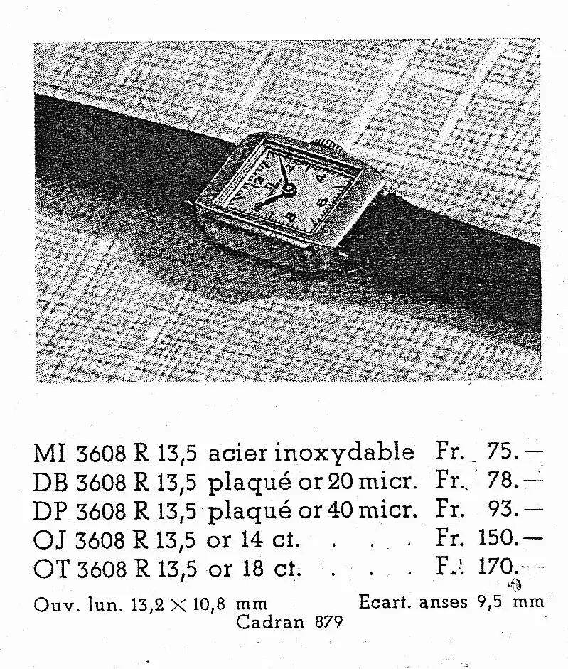

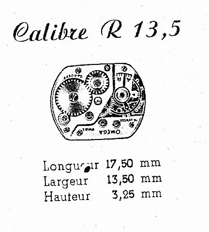

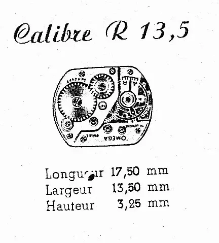

I would bet for a ref MI 3608 with caliber R13.5 inside.
Here in a 1940 caliber (then the serial should be in the 9 million range rather than in the 7 million range) :
The R13.5 caliber in the same catalog :

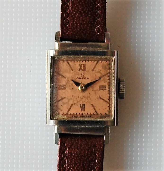

This one looks like a steel version of ref OJ3671 from the same period. Here in the same 1940 catalog :
