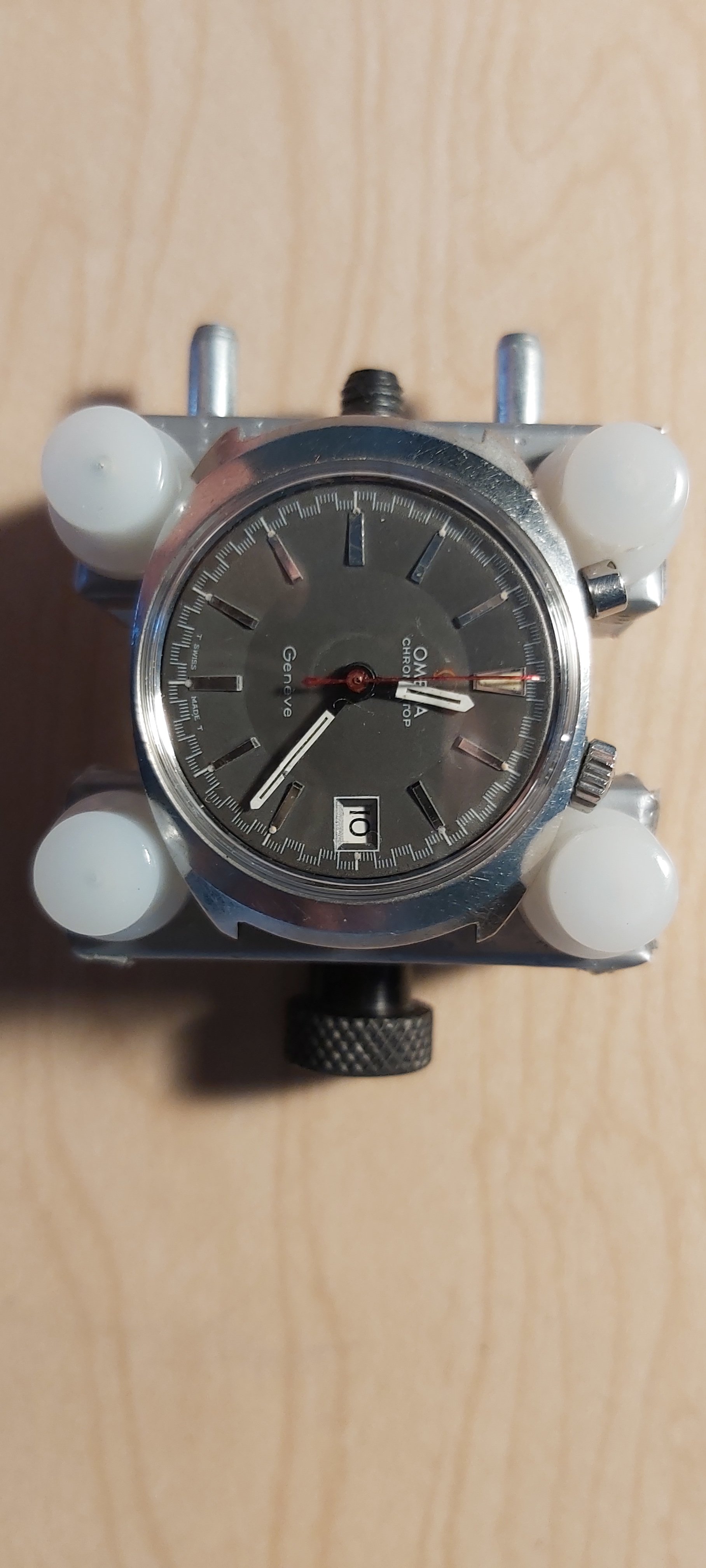

Hello all,
I recently recieved an Omega Chronostop Geneve Driver from my grandfather that got damaged by a bad repair service (supposed to be a crystal replacement but the "watchmaker" had a mind of his own). I've been steadily working on getting it back into order (repairing bent and delumed hands, new gaskets, missing parts), however I've struggled to find a dial screw for the Cal. 865 that is housed inside. I've tried ordering new/old stock, but have had no luck in finding one that fits. Are there any tried and true methods that will secure the dial without messing up the movement or are there any individuals willing to sell a Cal. 865 dial screw? This is a special timepiece and I want to do the best possible job to get it back I order.Thank you all in advanced for your help.
Photo of the watch (before working on it) below for reference.

Once again, the screws were too big. After some more research I found that I had the Calibre 920 housed in my Chronostop as the 920 had the date wheel that the 865 did not. I have the correct screws coming in and will have the dial firmly secured in a few days. Unfortunately the canon pinion is loose so the entire movement may have to be disassembled...
