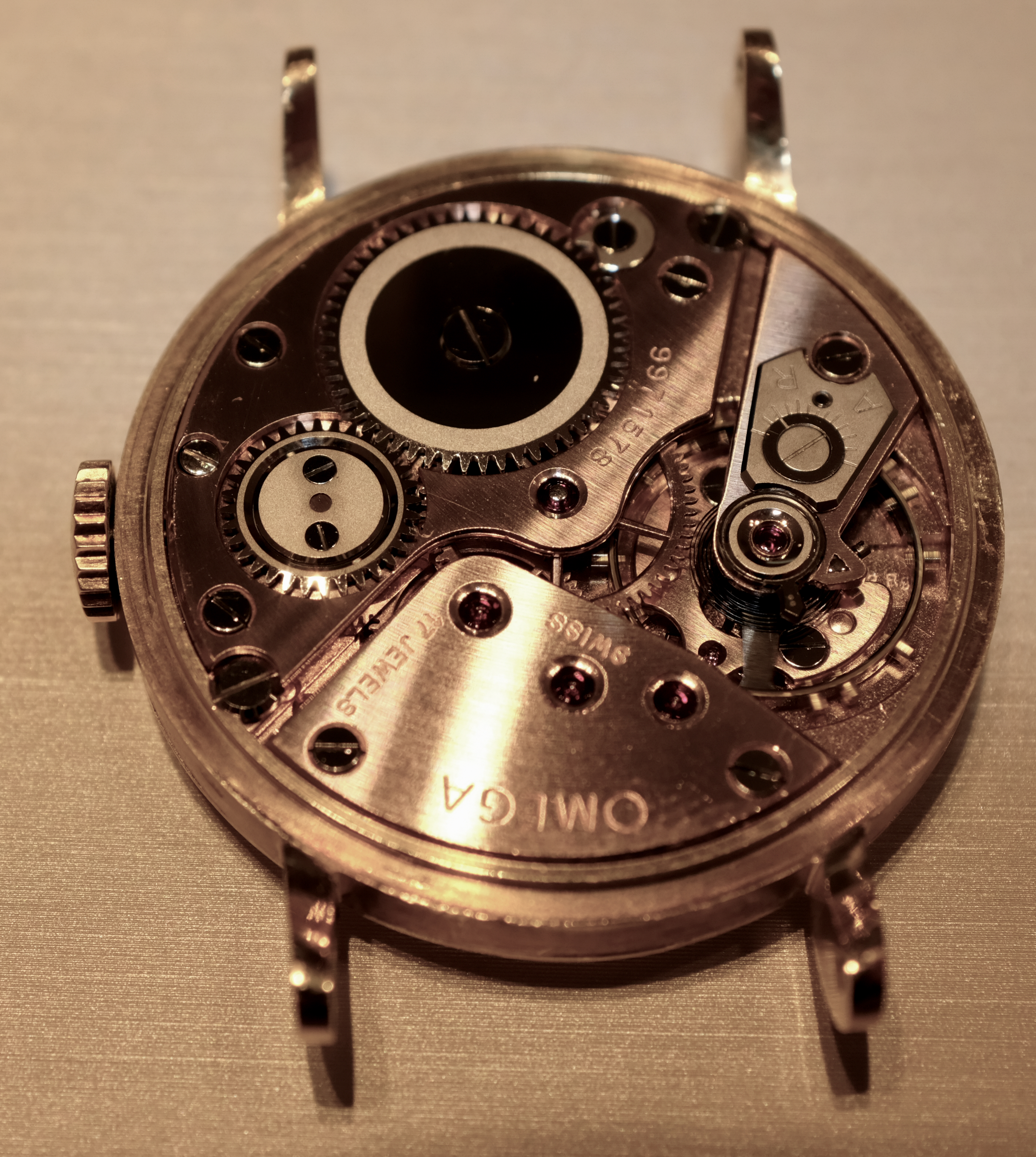

The movement looks in excellent conditions and no marks from humidity, which is what you expect with such a pristine case and dial.

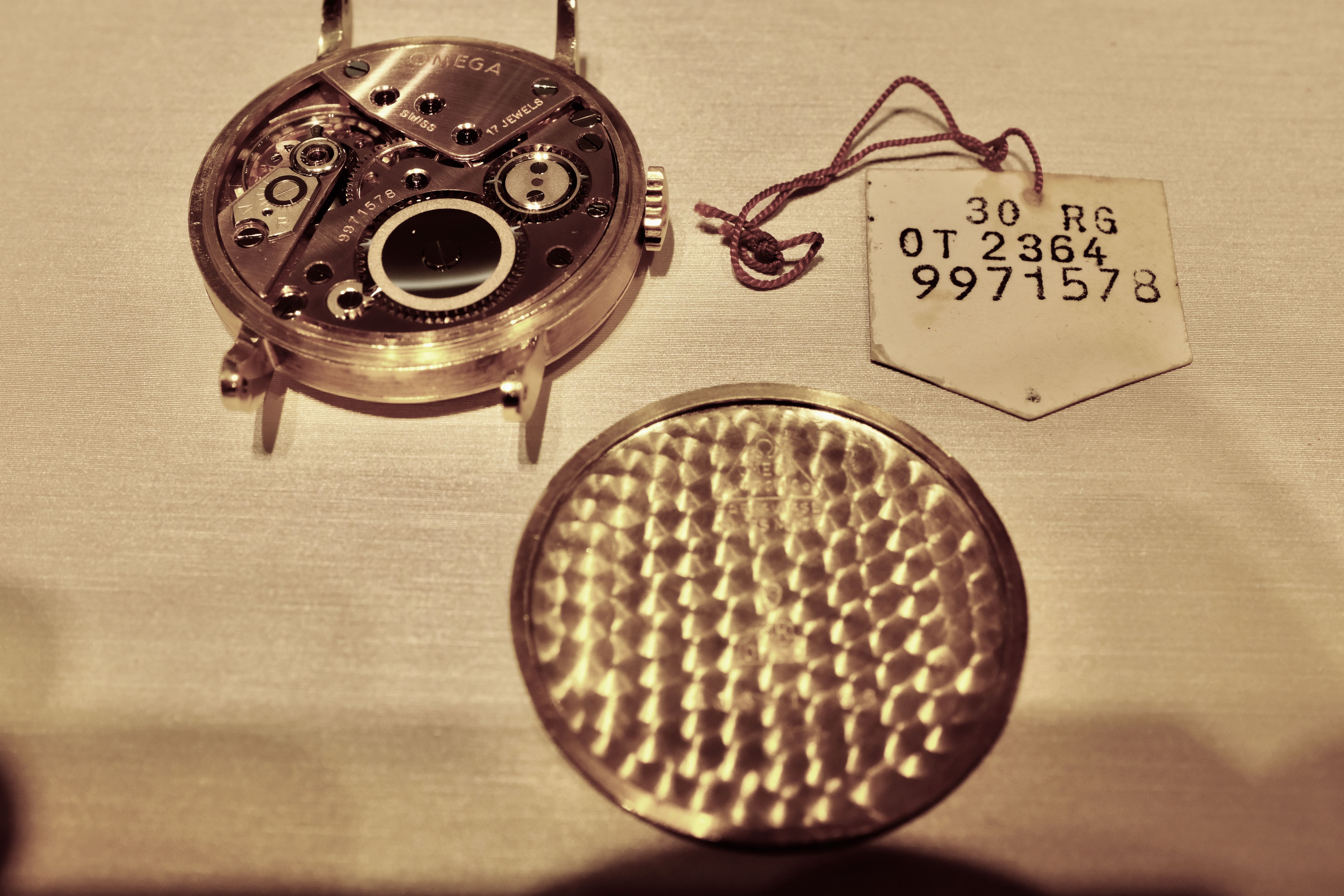

Hello,
Franco, indeed I did find your excellent web page (squelettewatches.com), which has been my primary reference so far (that plus the help received here). I am starting the process of moving (for my job) to the east coast (US). Erich's book is certainly something worth having but will have to wait until I'm settled again.
I looked at the watch again yesterday (hence the picture) and confirmed a few more things. I am leaving the watch with the seller for another week so they can put the strap on for me (they had to order one).
I've been trying to post a picture of the open case, case back and hang tag but, for some reason, it isn't uploading correctly (??) - it is showing as an attachment at the bottom of my draft post (any ideas?). I'll keep trying. Once I have it home I will take pictures of the watch and case (in good light) and post them here for review.

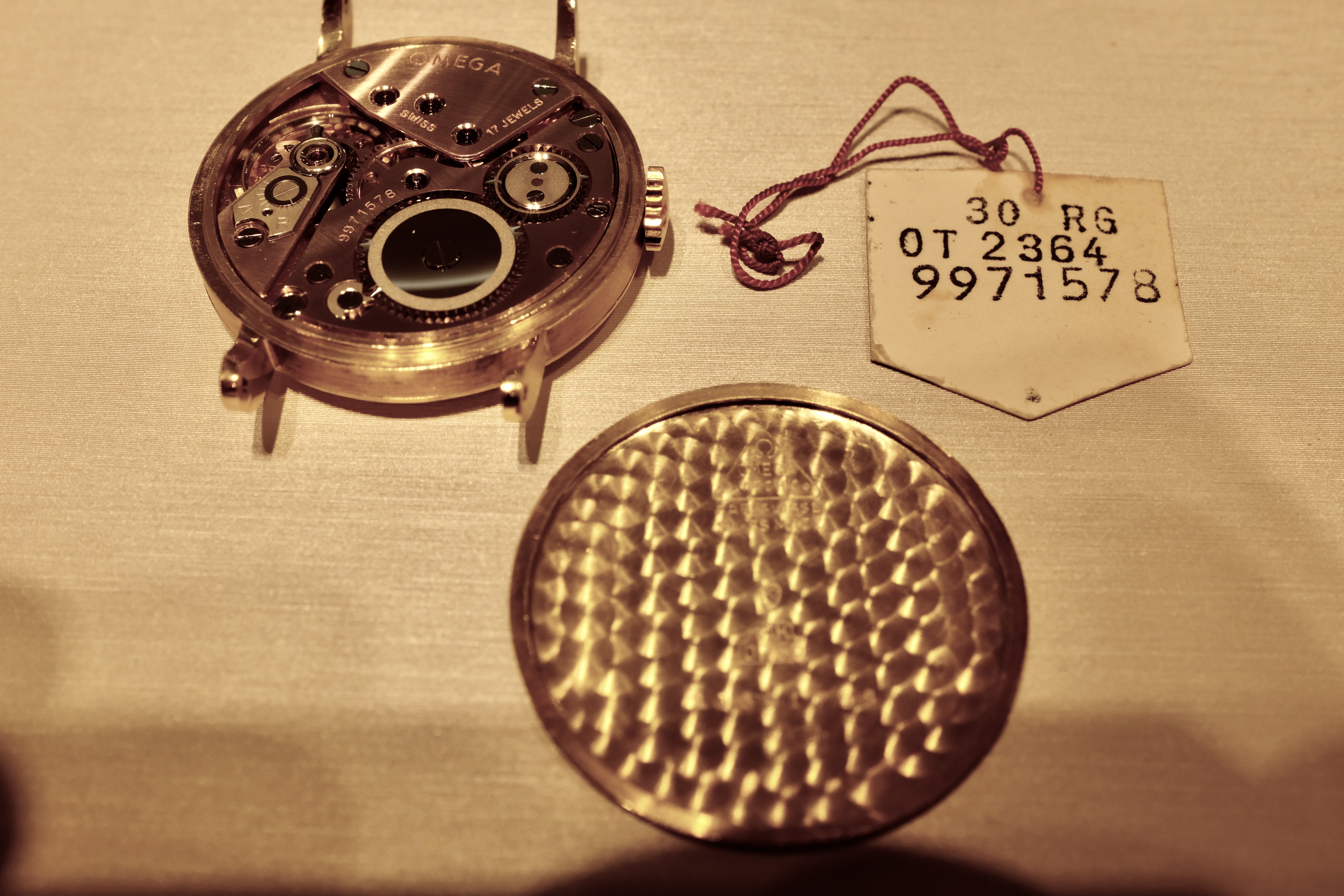

The box for the watch I am looking at is identical to the one in the post by MSNWatch - as above (as well as the hang tag).
I am curious about the strap - is the one shown original to this watch? If so, it is also identical to the one I'm purchasing (and it's in very good shape if it is). Someone in this thread previously said the strap was not original to the watch.

That is the exact watch you are looking at.
