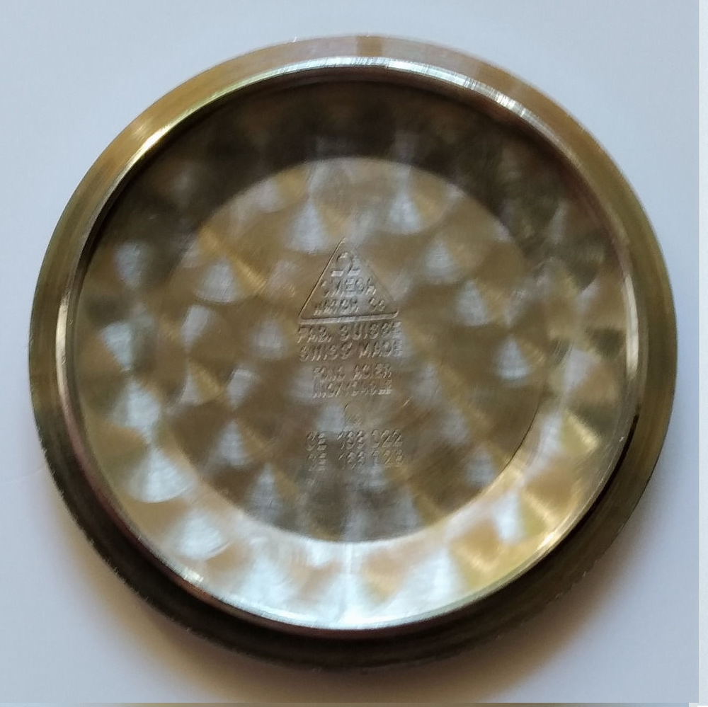

I’m sorry but I have to disagree with this. The Seamaster (although stainless and non-chrono) I have was my fathers and I know the case back was never replaced. I believe the dual reference was only because the chrono and non-were installed in the same case, therefor the the same case back would fit, and didn’t need 2 separate model case backs. If wrong I have no problem being corrected.

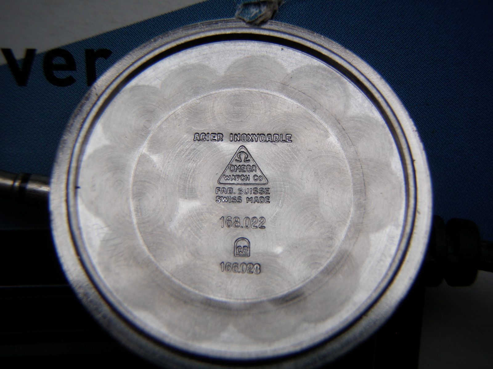

I agree with the above. A double stamped caseback does not IMO necessarily suggest replacement, it is a practice used by Omega since at least as early as the 1940s as a way to use cases for multiple references. For the model being discussed here, it is a way for them to use the case twice as chronometer and non chronometer versions but there have been examples of triple and even 4 x marking in my experience. It does lead to confusion though since many sellers don't know which model they have and often list both or the wrong one.
In short yes it might suggest replacement, but on some references is the norm, the 2846/2848 fat lug SM and the sparkle dial SM to name but two.

OK, stand corrected. Is there any indication of a transition from single to multiple references or is it somewhat random/arbitrary? I think both of my Seamasters are single reference casebacks, but the parts are either mounted or in the bank* so a bit hard to check at the moment.
*The steel has an additional service replacement caseback installed due to engraving I had added by Omega and didn’t want to mod the original.
Edit: Just found an image of the original steel caseback. It is indeed dual reference, so another piece of the puzzle corrected.

The caseback that intended me to ask questions in this thread also has double serial, sorry for blurred pic
