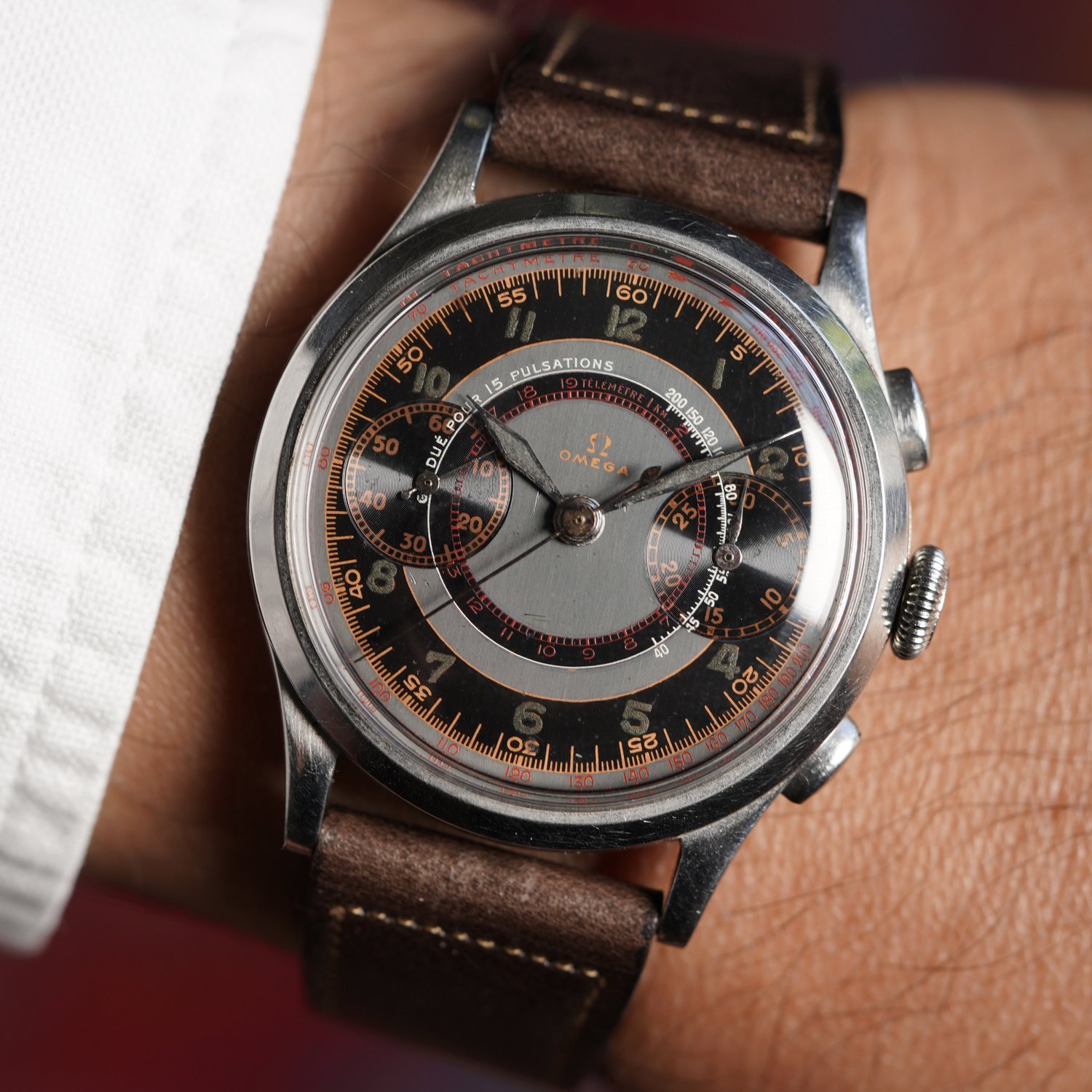

Omega CHRO 33.3 Redial?
8,752
62,052
What has your research shown?

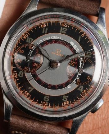

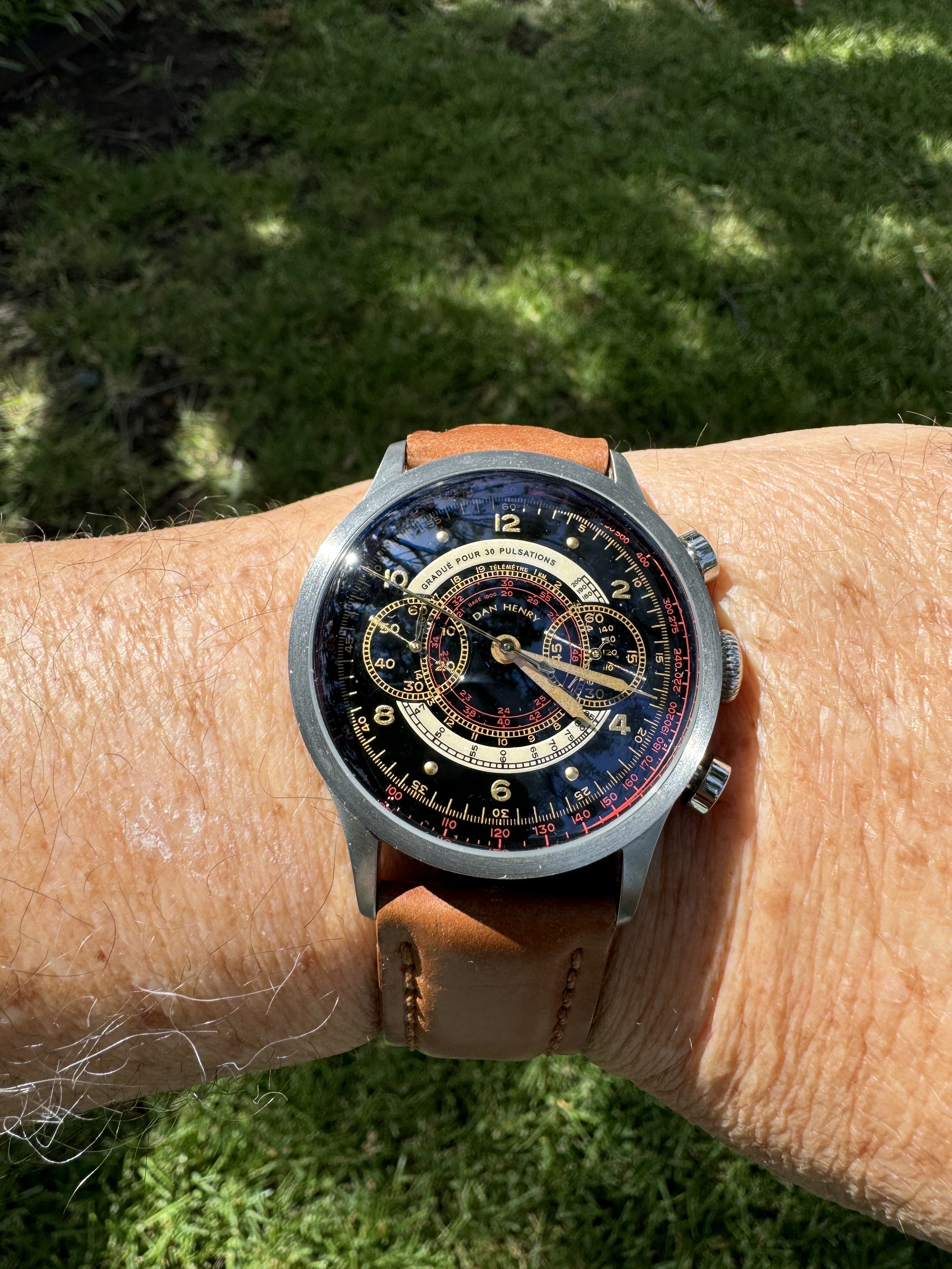

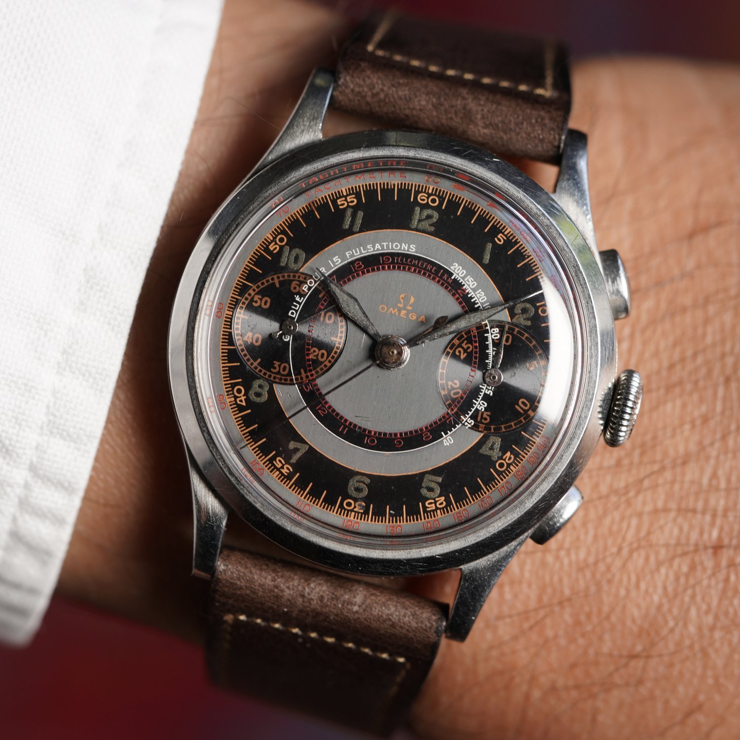

And what are your concerns after comparing 100 known original dials to this one?
34

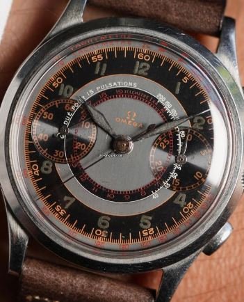

My concerns
1. On the very outer ring about the 160 and 170 markers there is some black which crosses over into the silver.
2. The fletch on the arrow does not appear to be as crisp and defined as other purported original dials.
3. The orange railroad track on the subdials - some of the indices below the numbers have red dots or marks and some do not.
I am not an expert so am curious to know what the forum thinks and if members have other concerns with the dial.
Thanks
