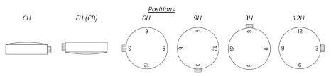

The timekeeping should not change in a few weeks - if it did, any certification process like COSC or METAS would be useless.
For finding the ideal position, you need t test is=t over the 6 positions you show. Each watch is different, so you will need to find the specific positions that run fast or slow for your watch.

After testing all 6 positions on my Planet Ocean 8900 over a 24 hour period i found out that the crown down position is the optimum for keeping the best time.
