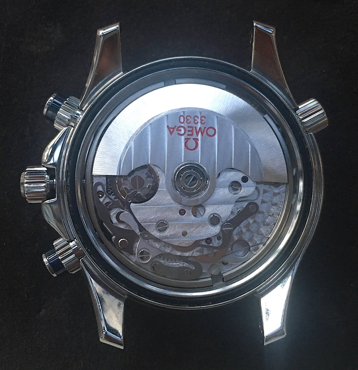

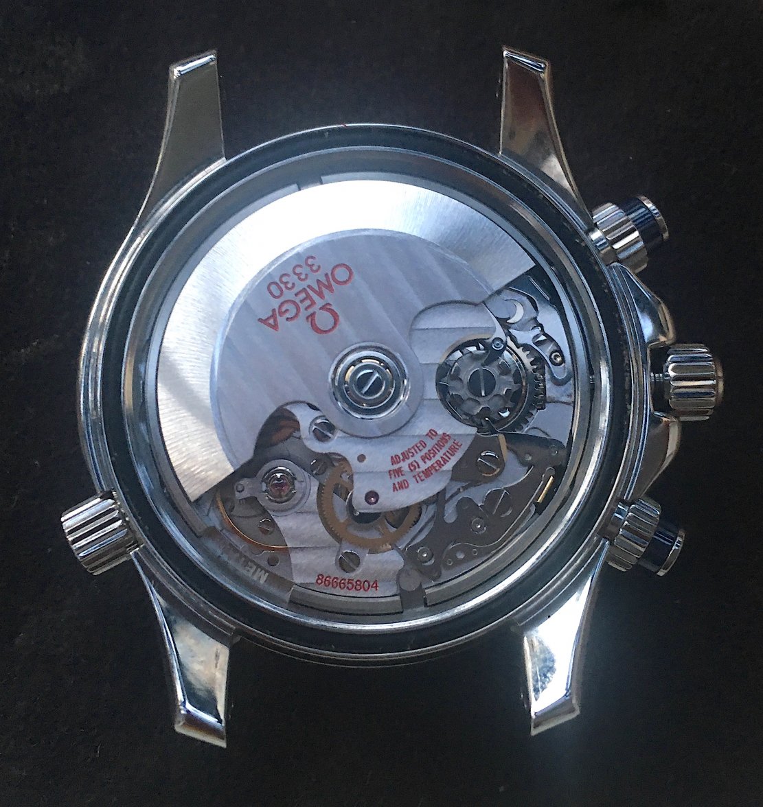

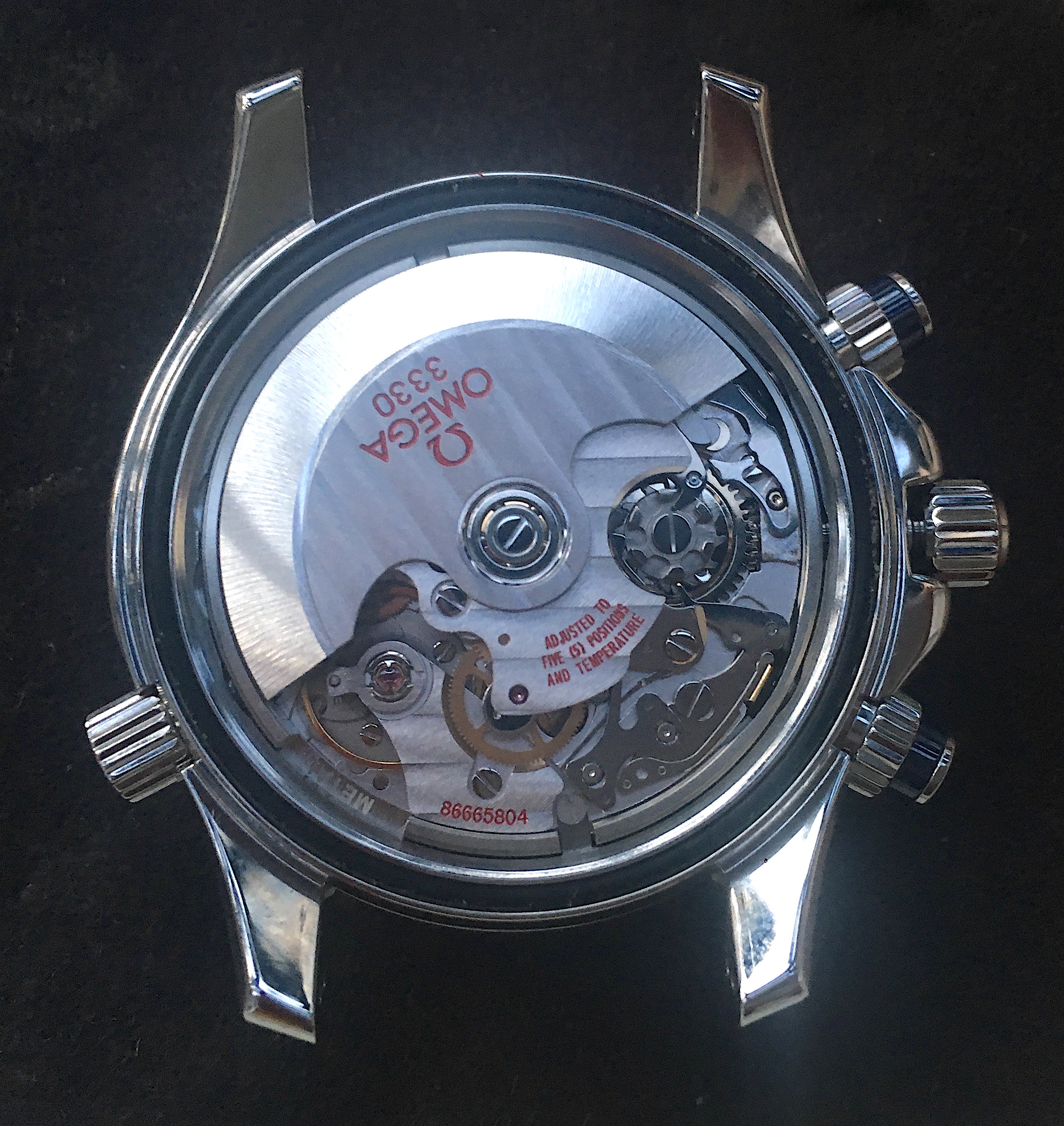

Thanks for the helpful feedback Al. I was having my doubts too about the movement having being tampered with or being a clone... so I decided to crack it open (even though the red dot was still in place) and not something I'd normally do on a sealed watch, but having serious doubts I thought it better check under the hood... (pics attached)
Anyway, all looks good in there, nothing suggests the watch has been tampered with (all factory spotless, no screw bruising anywhere... all correct stamps, Swiss 31 jewels, correct serial, etc and all matches perfectly to photos of the calibre 3330.
The 2nd notch is quite evident though, although not as much as on a 7750 based watch I have here to compare with.
The watch is only a year old, has all the Omega cards with matching serial etc, so I only assume Omega put the wrong part in as you say.
So there we go... strange things happen at Omega too! Lol
