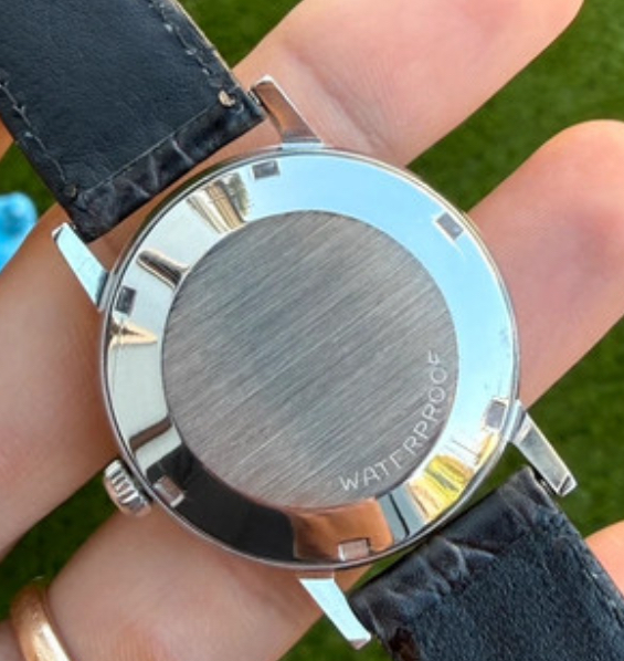

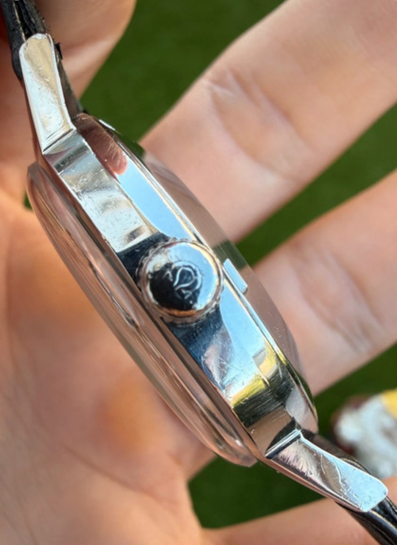

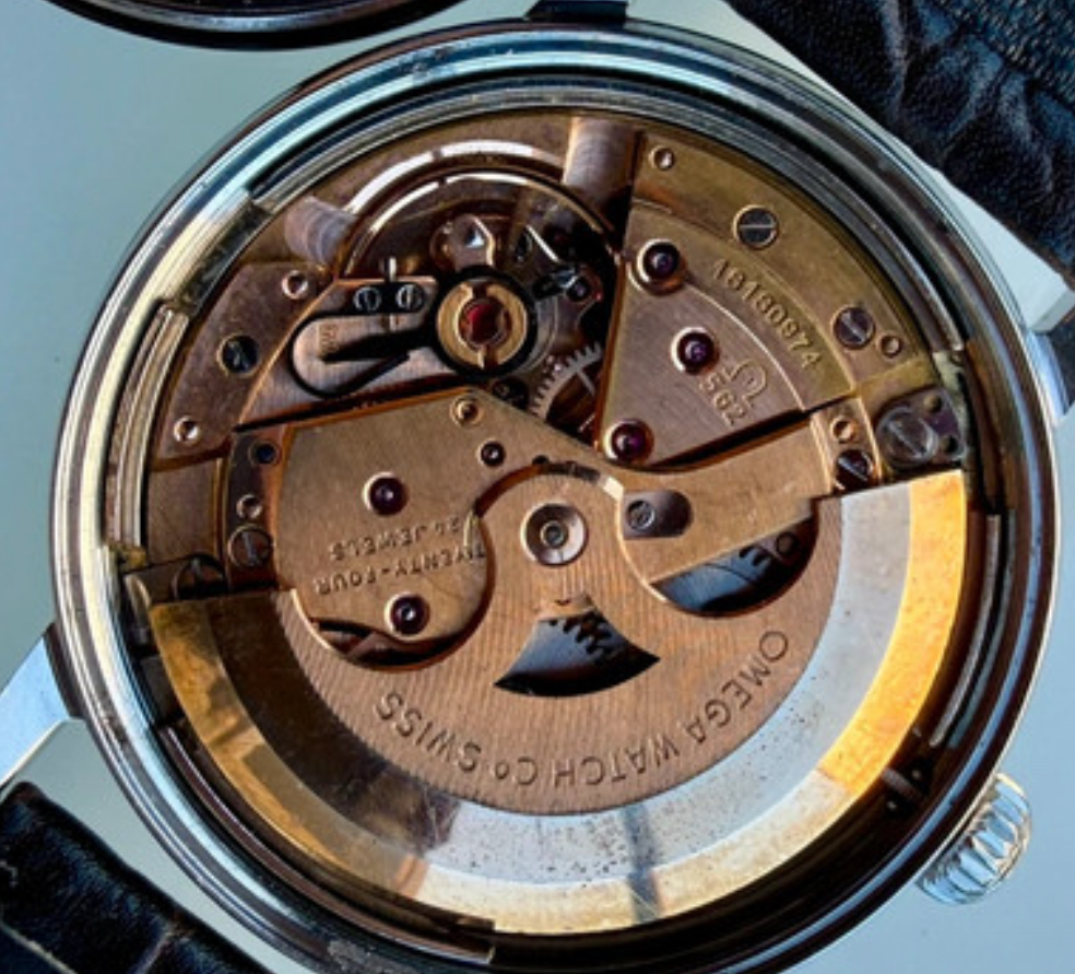

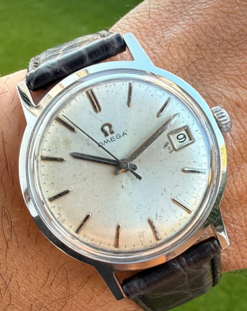

Hi! I posted some photos belonging to the period before the service. When I was 15, I thought it was beautiful. As you can see:
  • The back belongs to the reference 166.070, which has a cal. 565;
  • The dial belongs to an other reference with cal. 611.
My movement is a cal. 562, which is now perfect and serviced with all original Omega parts. So I want to save it and change the dial and the back with two pieces that match with the movement and the case: it’s possibile to know which is the reference the case belongs to? Thank you for all the answers

Why do you think it’s a 14701? The caseback matches the case and is correct for a 166.070

You are right....So the case and the caseback belongs to 166070, the movement is a cal. 562 and the dial is from the reference 132019.... Probably it's better to buy a new dial from ref.166070. Anyway, do you think that the parts are original?

How do you know the dial is from a 132.019?
I’d say it’s more than likely to be from a 136.070.
The rest of the parts look correct although the hands may have come with the dial

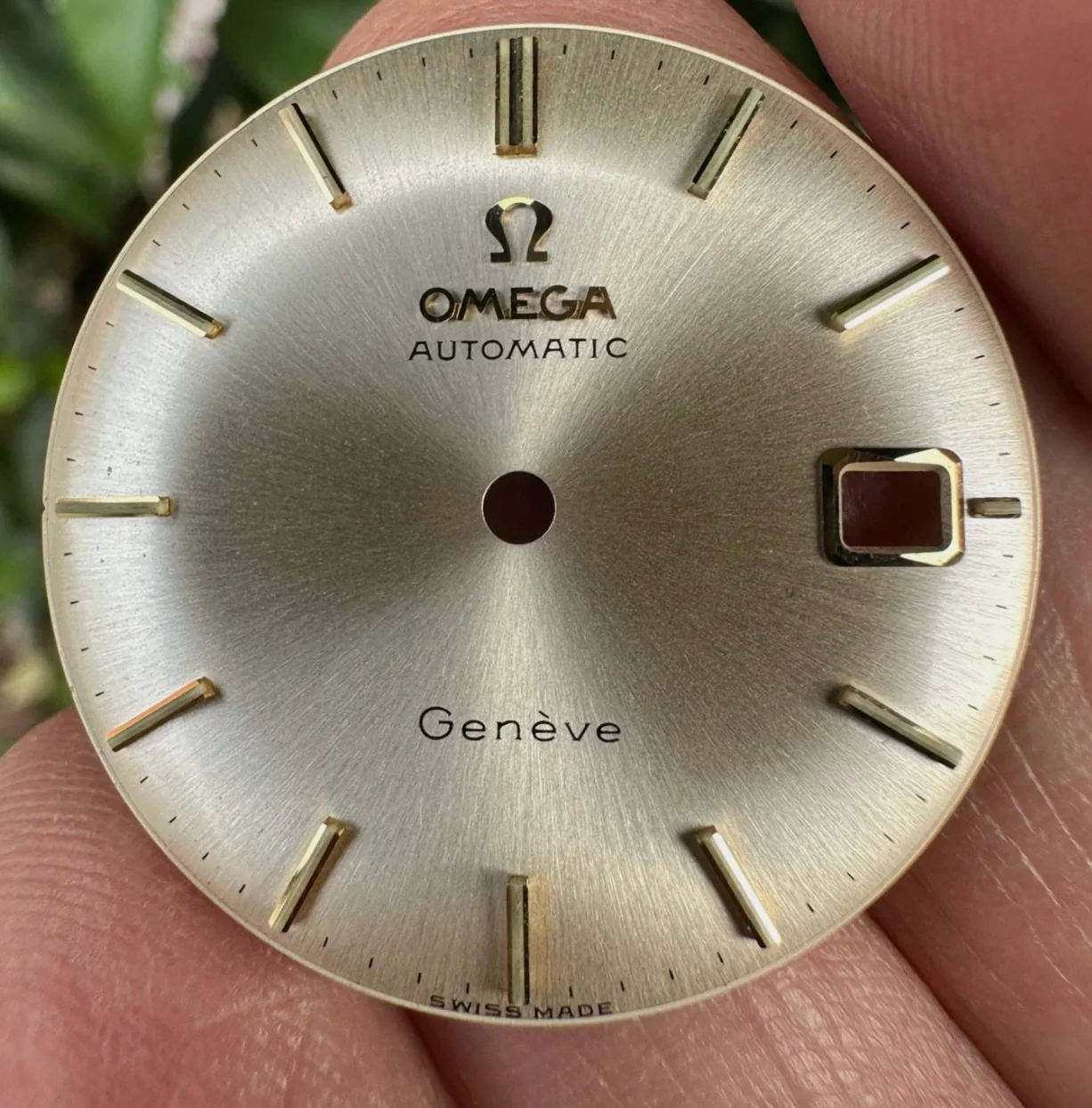

The hands have been replaced during the service with pieces from the maison. Fortunately, the dial from 166070 isn't so difficult to find, there are some listings on ebay (for example, the one in the picture): how much should I pay it?

That’s for you to decide based on how bad you want it and the value of a complete 166.070.

According to you, is this dial original?

The dial looks original, but I’m not convinced it is the correct one for your watch. You need to be very careful when buying dials. The dial may look correct and may fit the movement outside the watch. But if it is too large, it will not fit the case and is useless to you.
I think your original premise is correct. You have a frankenwatch with parts from multiple watches. I’m not sure it is a financially sound endeavor to even try to make it original, as I can’t tell you what is original for this watch.
That dial is either refinished (in which case it’s a very good job) or isn’t correct for a 166.070 as no 166.070 dial has ‘Automatic’ with straight sided M’s.

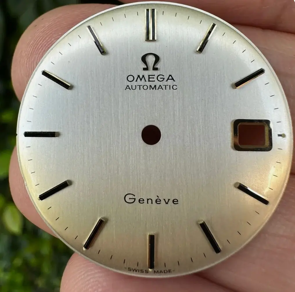

I didn't notice that. I spoke with the seller, which is very affable, and he told me that he sells an other dial, with the features that you underlined:

I think the dial is original Omega, but not for that movement, as it doesn’t have “Automatic”. I’m still unclear as to whether the case had an automatic (56X) or manual (60X) movement when it left the factory.

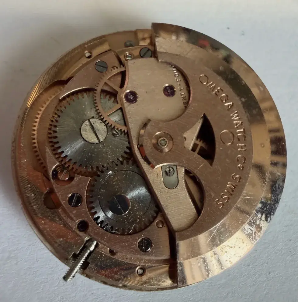

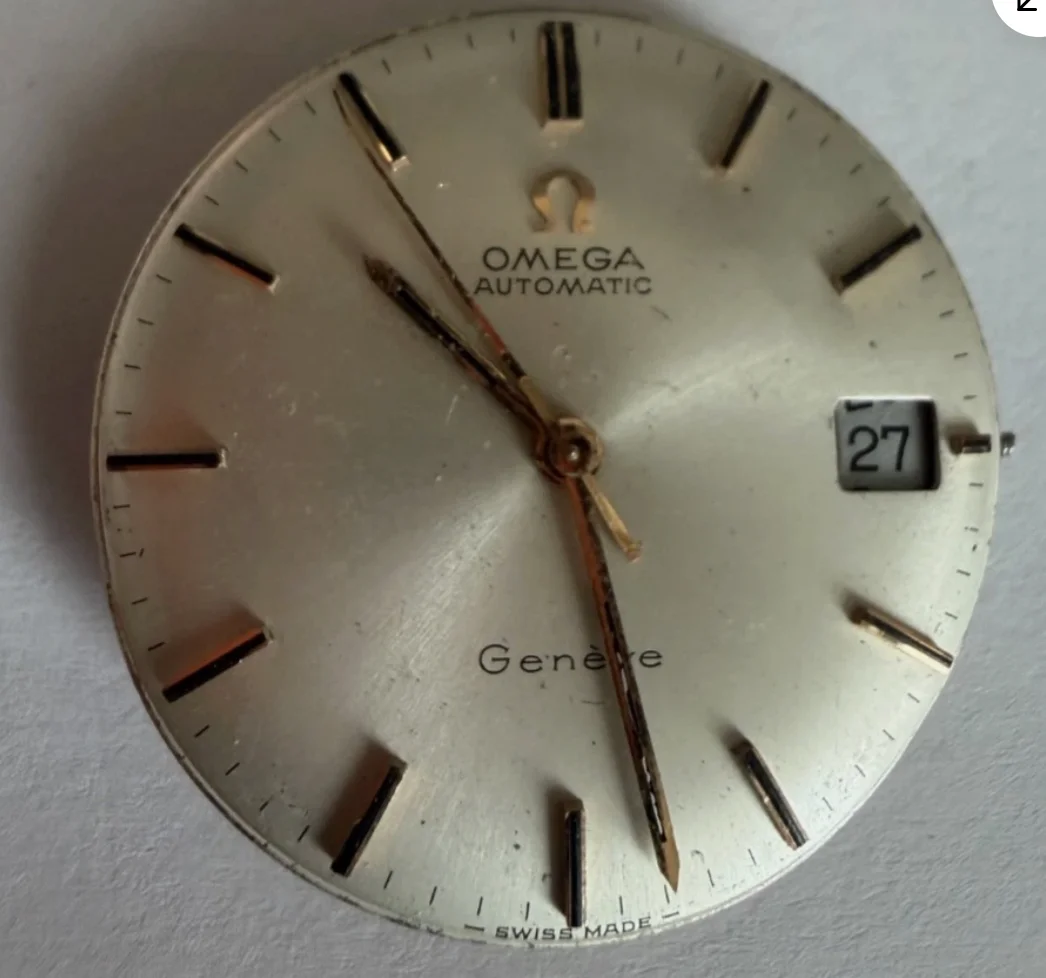

Without any doubt the dial that I have doesn't belong to ref. 166070. I saw on ebay the correct dial with his own caliber, at the same price of the precedent dial...:
