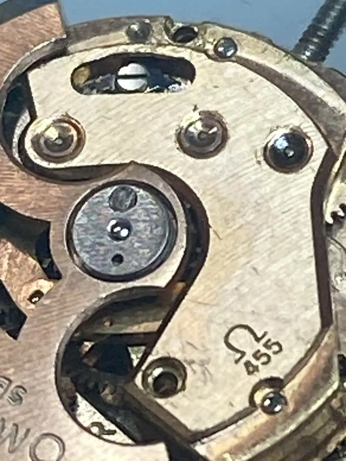

Hi everyone,
I’m currently servicing an Omega caliber 455 and I’m having trouble removing the rotor.
There is a central disc with a screw. I was able to loosen the screw, and now the disc (and rotor) can rotate freely. However, the screw itself will not come out - it just spins in place and seems to stay captive.
At the same time, the rotor cannot be lifted off.
There is also a small empty hole next to the screw, which appears to be part of the design (not a missing screw).
So currently:
  • The central screw is loosened but not removable (spins freely)
  • The rotor/disc assembly rotates freely
  • The rotor cannot be lifted
Before I apply more force, I wanted to ask:
Is this screw supposed to be captive on the cal. 455?
Does the rotor sit on a friction fit even after loosening the screw?
Or is there another retaining mechanism I might be missing?
Any advice would be much appreciated - I’d like to avoid damaging the rotor or the bearing.
Thanks in advance!
18,787
39,036
Hopefully the screw hasn't stripped its thread.
Get a magnetised screwdriver and remove the screw.
You should then be able to rotate the steel disc (unscrew) and then remove the rotor.
Hi - thank you for your suggestions - they brought me on the right track. I tried to rotate the disk - but it does not unscrew.
But then I recognized that the disk are indeed a two disk sandwitch. In the middle they have a little excenter attached to the screw. The excenter secures the disk via a recess in the central stem. When i turned the screw in a certain position, the rotor was free and i was able to detach it.
The calibre 455 is extremly tiny - so are all those parts… a really challenging project for an hobbyist like myself….
Thanks again!
