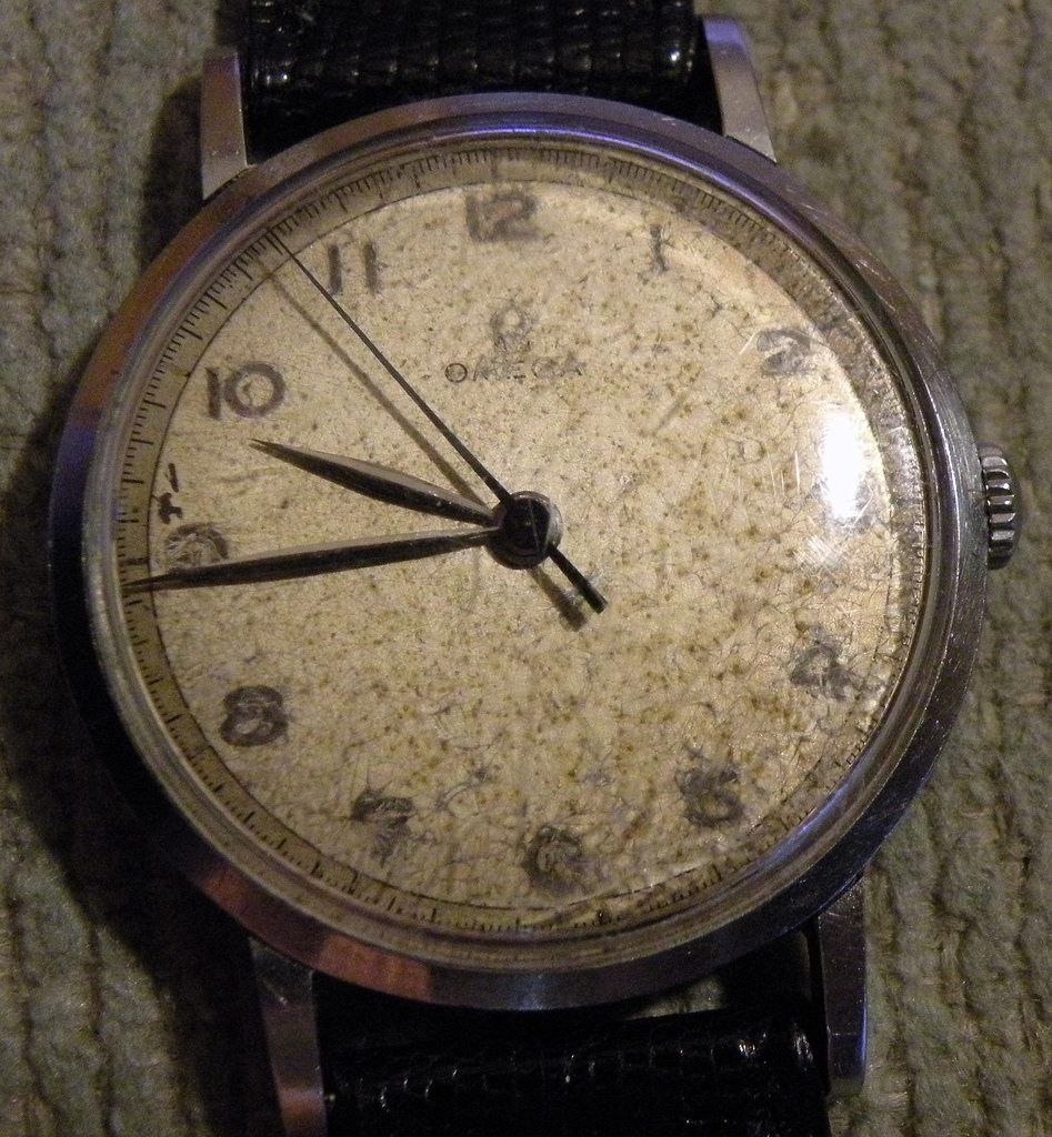

    I entered this forum because a Omega watch entered my life. For me this was an extraordinary event because I never was interessted in watches very much, but since I "found" this watch (it is from my grandpa) I fell in love with it.. Thanks to the interenet I learned a lot about it: it's a reference 2256 with a caliber 283 movement and according to the serial number it was made about 1948..1950. I allready found a good address to give this watch some care and maintenance. I will replace the glass (I'm still not quite sure whether to take a original Omega part or a cheaper one) and the crown, give the case some (but not to much) polish and a revision to the movement. The clock face will get some cleaning but nothing more. And ofcourse I will replace the quite ugly metal straps with some nice leather straps.
    Here are some pics:
    [​IMG]
    [​IMG]
    [​IMG]
    [​IMG]
    [​IMG]
    [​IMG]
    The quesition I have is aboout the hands. Without any doubt the second hand is not original and I definitely will replace it. But what about the hour and minute hands? In the interenet I found Omega watches with the same hands, so they propabely are original Omega parts. But are they original for my Omega? Some guys in another watch forum told me that both of them might be not original. Their argument is that both hands are filled with luminous material but the clock face has not. And the longer I'm looking for pics of vintage Omage watches in the internet the more I get the feeling that both hands do not fit to the design of my Omega.
    What do you think - do the hour and minute hands fit to my Omega? If not: which hands would be more suitable?
    Kind regards, Thomas.
  2. hoipolloi Vintage Omega Connoisseur Jan 15, 2016
    3,516
    5,795
    Maybe this?
    Chorknabe likes this.

  5. Chorknabe Jan 19, 2016
    3
    Hello to all,
    thanks for your respond :) The hands you suggested are looking quite good - and much better than the old hands. I will try to organize some. What color would be better: polished sílver (like the case) or maybe steel blue?
  6. Pvt-Public Jan 19, 2016
    2,319
    3,107
    I like the silver hour and minute hands with blue steel seconds hand, but then again I may be biased.

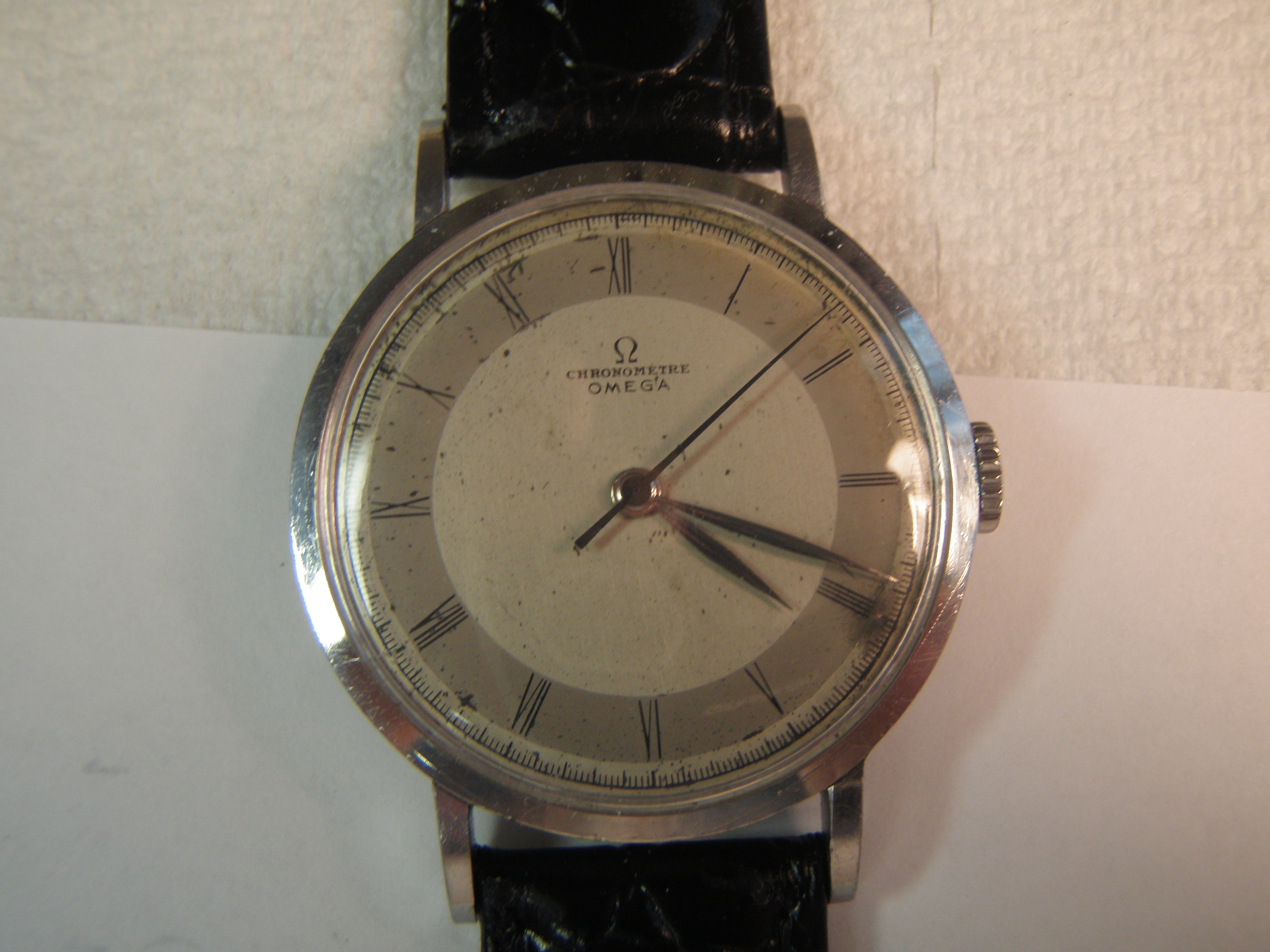

  7. Chorknabe Feb 29, 2016
    3
    Hello,
    I got my Omega back from revision, now I want to show the result.
    The hands have been replaced with new one. Unfortunately they are not original - but the design is quite close to the typical hands of Omega watches with cal. 283. In my opinion the hands design fits very well, and I'm very happy with this result. Nevertheless the hands are to new for this old lady. Maybe some original hands (from the late 40s / early 50s) with some nice patina would be better? So this journey could not be over yet :)
    What do you think?

  8. VanDamme NOT "The Muscles from Brussels" Feb 29, 2016
    280
    328
    Looks nice. Some of these watches had dauphine hands. Only criticism would be that the minute hand is a bit short as these should reach the minute track.
