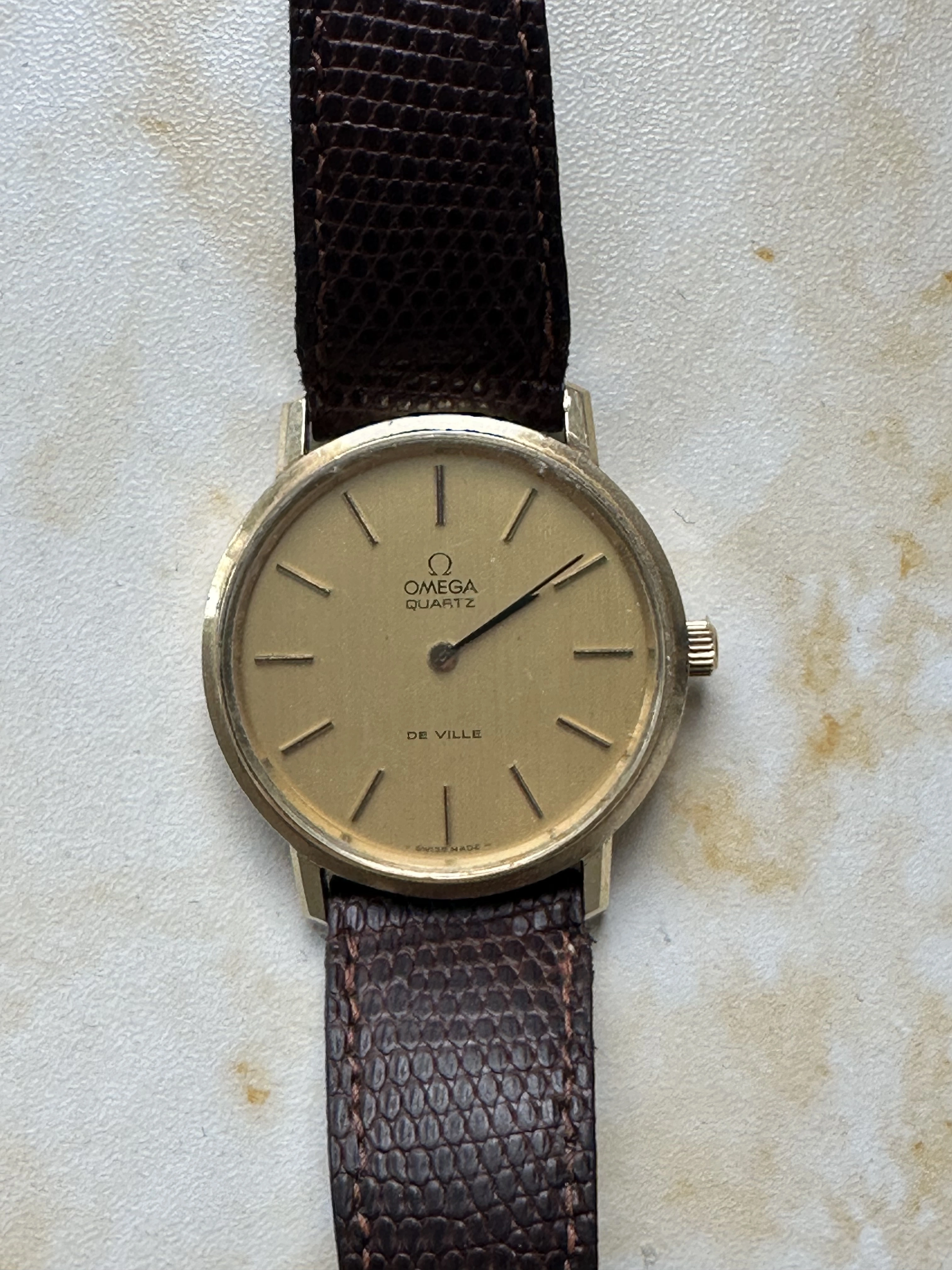

Does anyone have information on this watch? The minute hand doesn’t move when I try to set it. How much would it cost to fix?

Omega will charge you $600 to do a service, which will include replacement parts to fix it.
A watchmaker will be a few hundred dollars-plus-parts. Fortunately parts are not horribly expensive, and you can get reasonably priced (~$100) parts movements for it at least (since I presume electronics/motor are what goes first).
That said, the gold-melt-value is probably more than the value of the watch as-is. It'd cost you $400-$600 to repair it. A NON gold one is worth about $2-300 at best (its small and quartz, which limits the value a bunch, and even the 2-300 is probably very generous), and I presume you have $800-$1000 of gold in it.

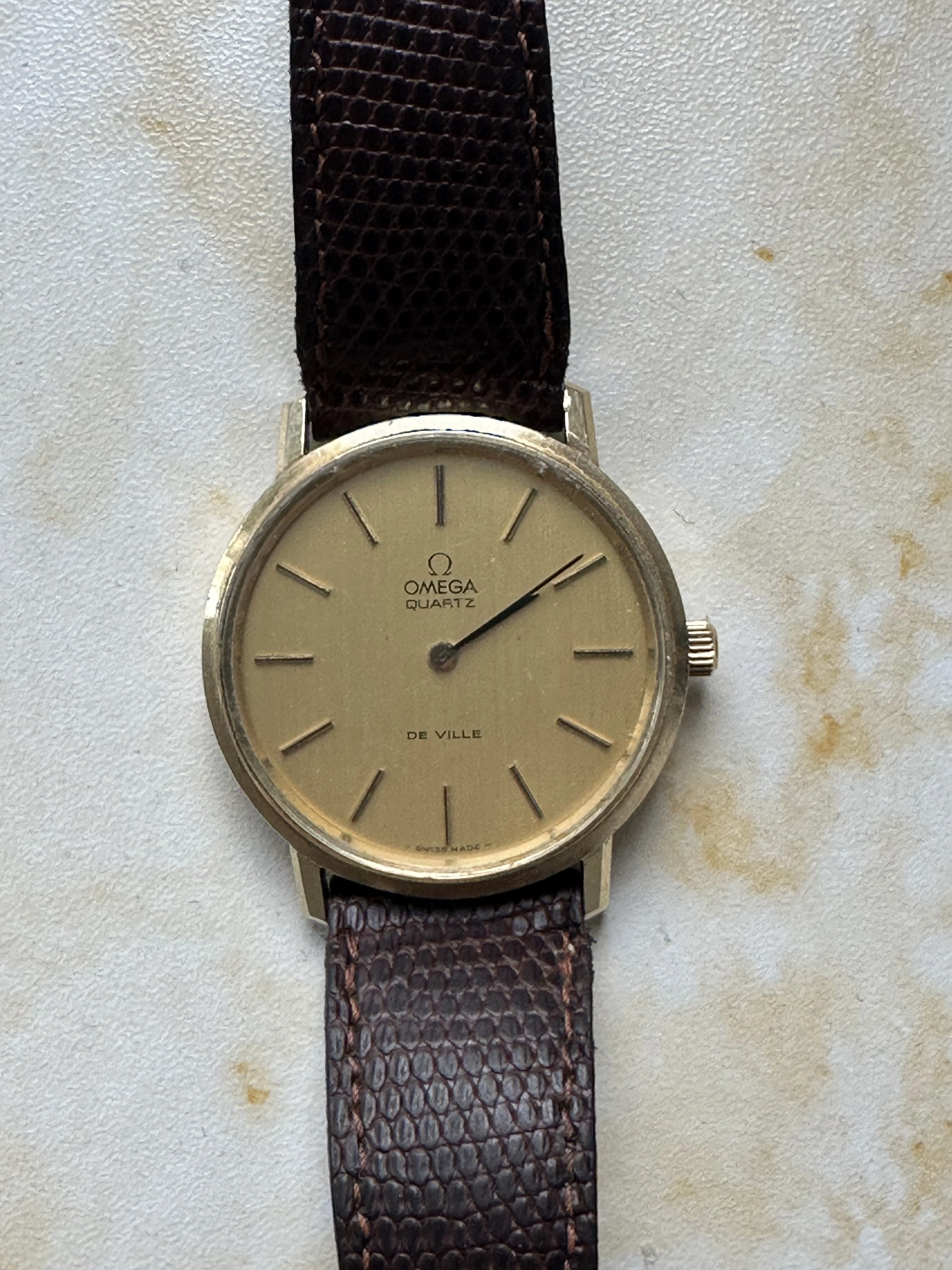

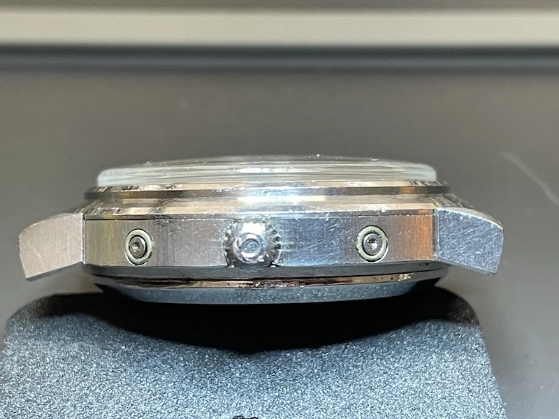

Does the watch run?

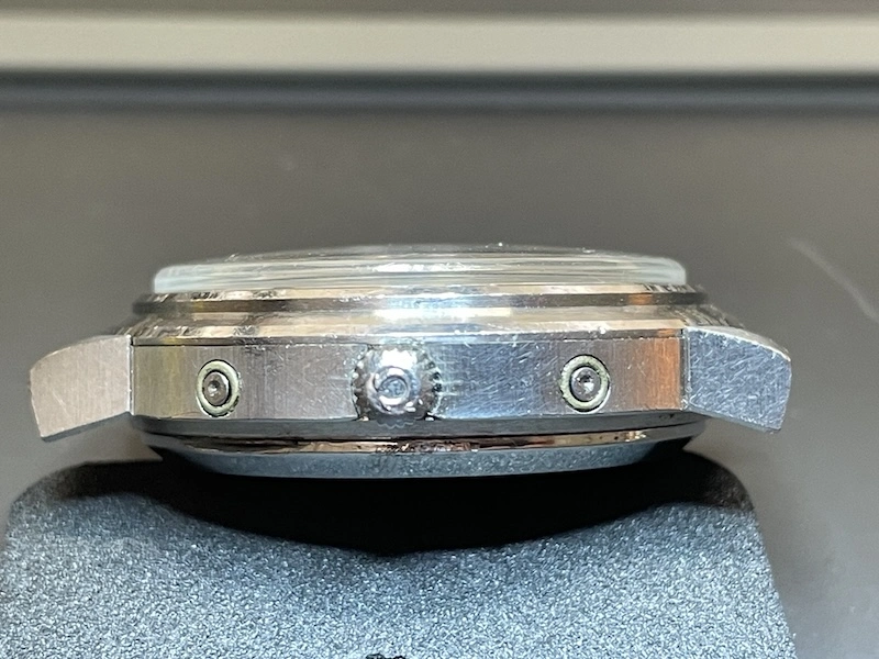

Can you post a photo of the side of the case, like this?
You can pop the caseback off by lifting it with a bluntish tool (table knife).
If you do, provide some photos of the movement and inside caseback and we can tell you everything about the watch.

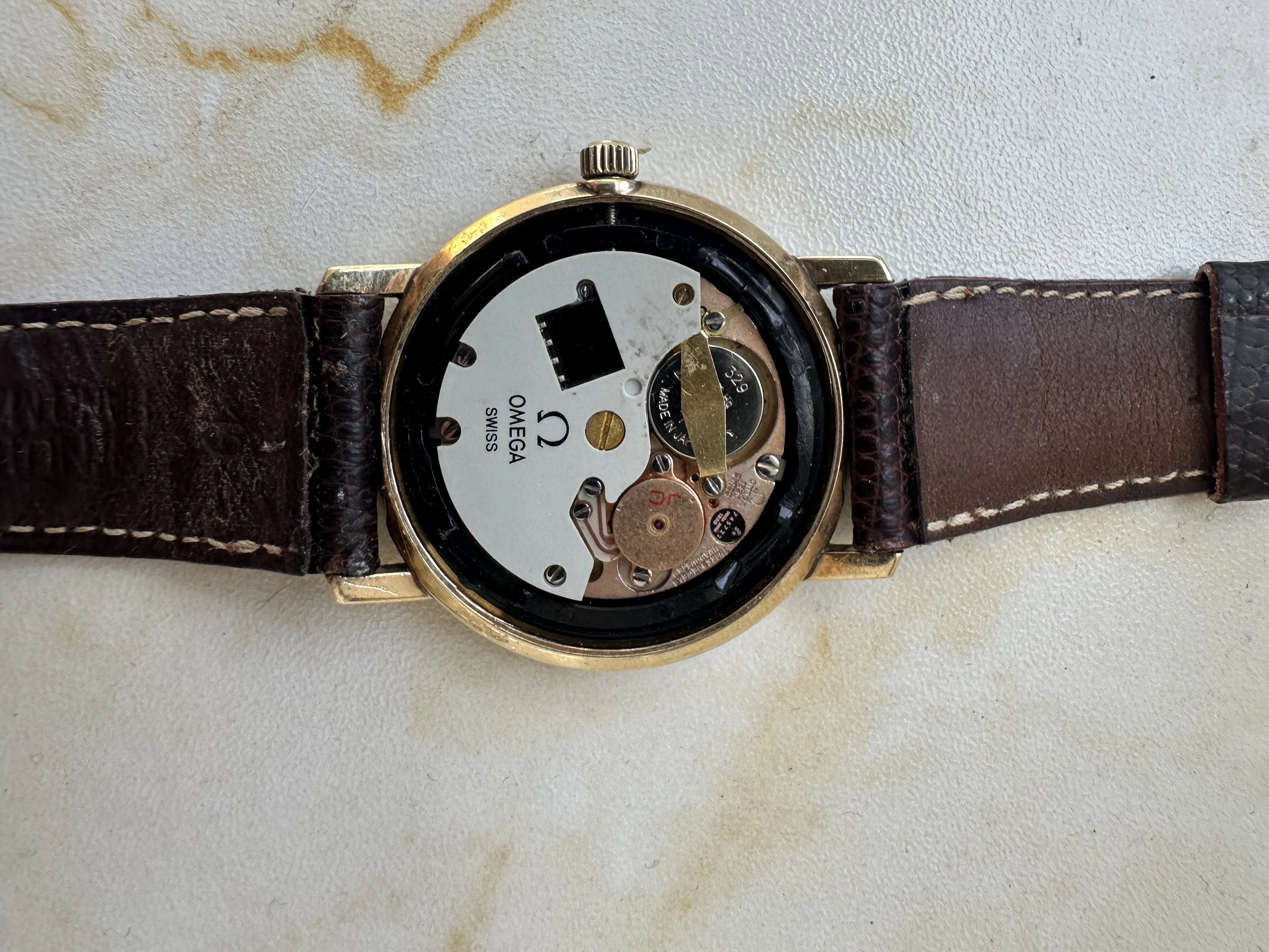

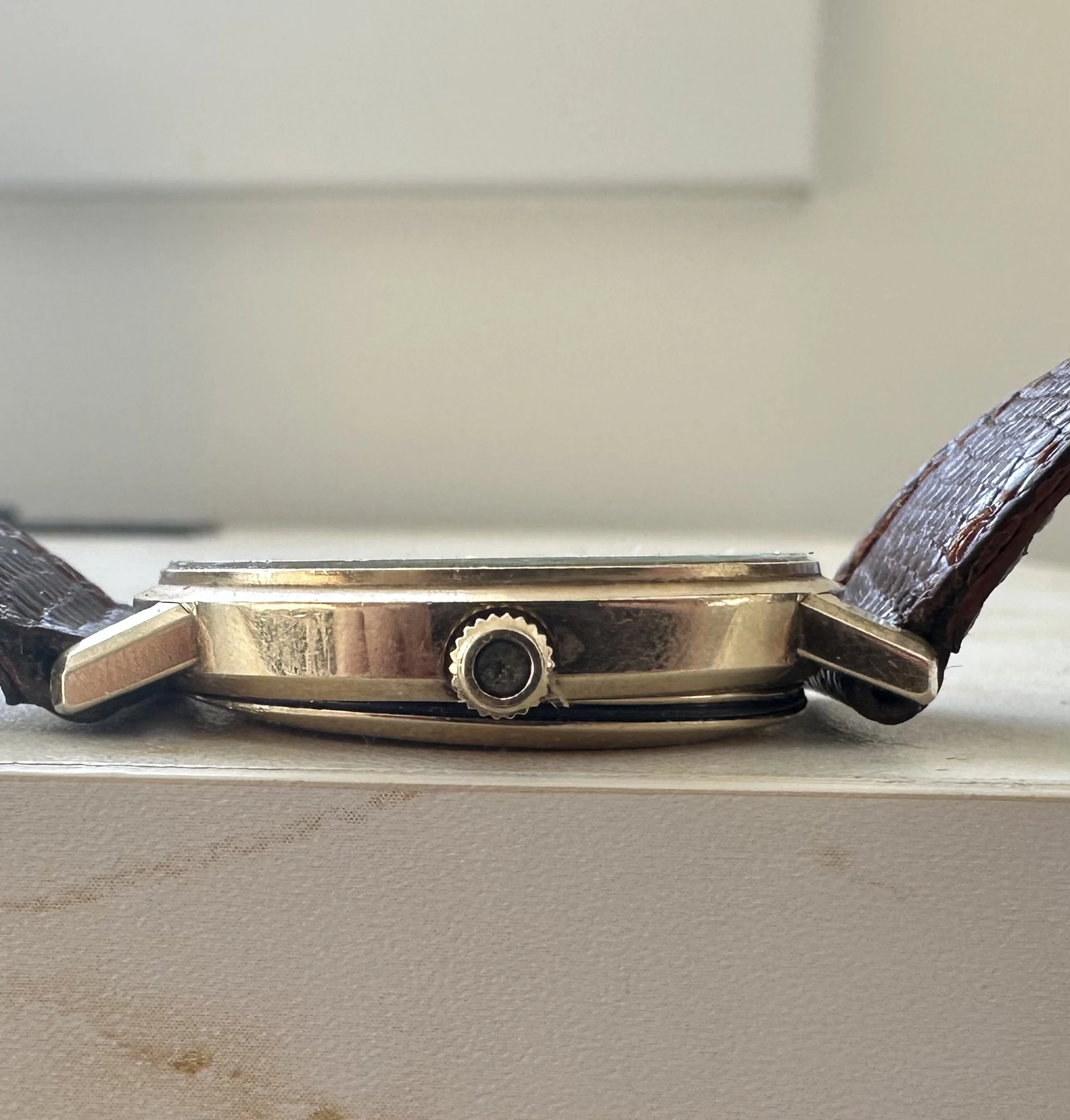

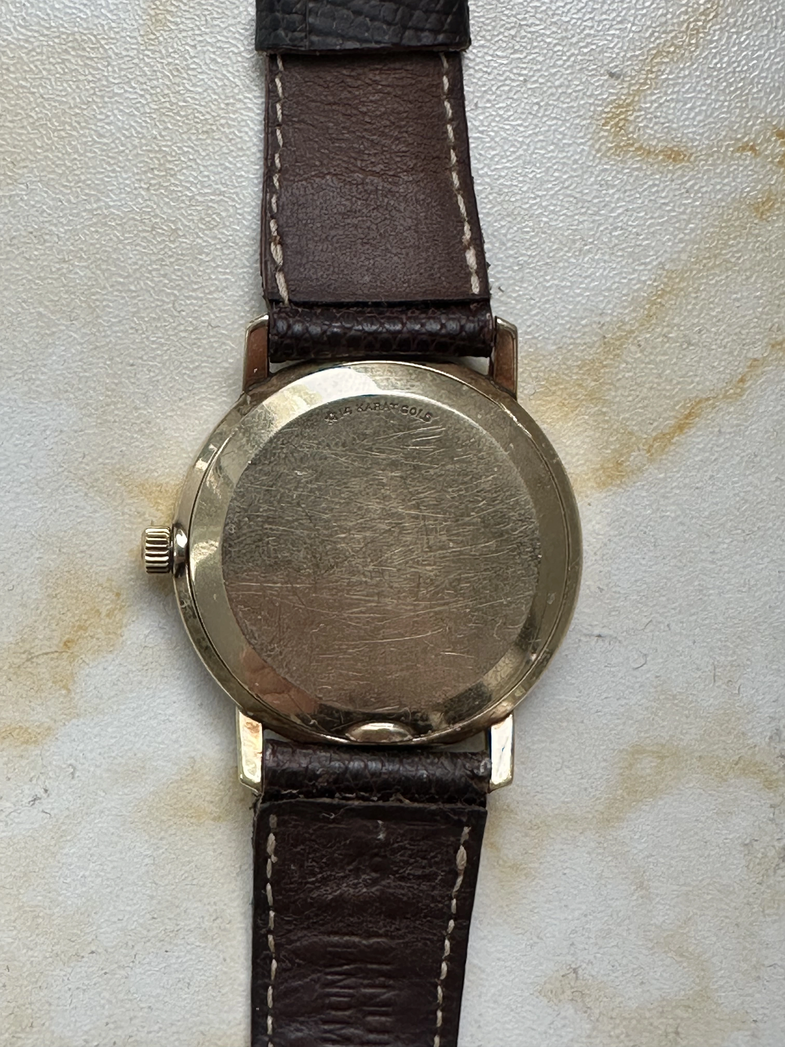

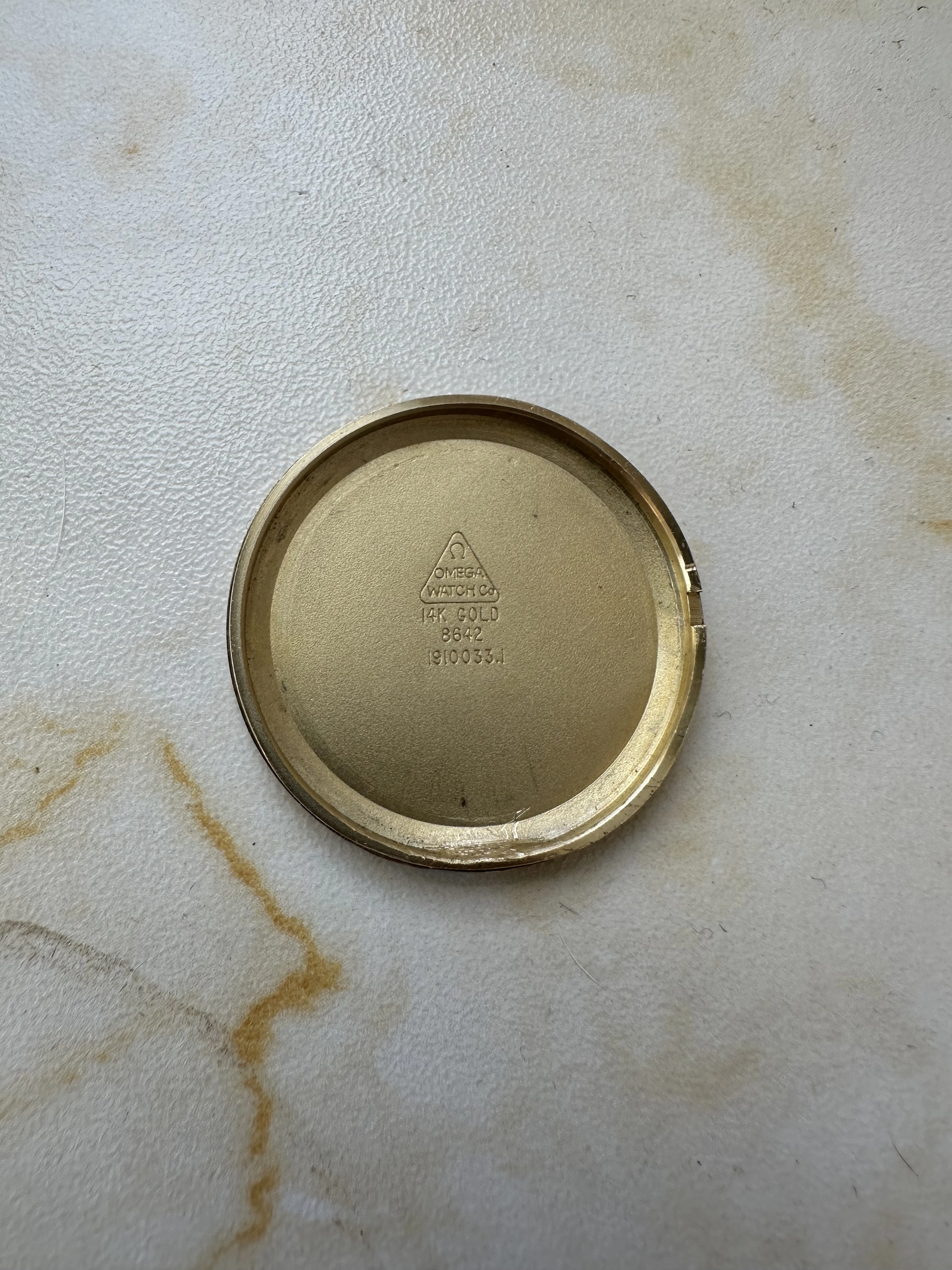

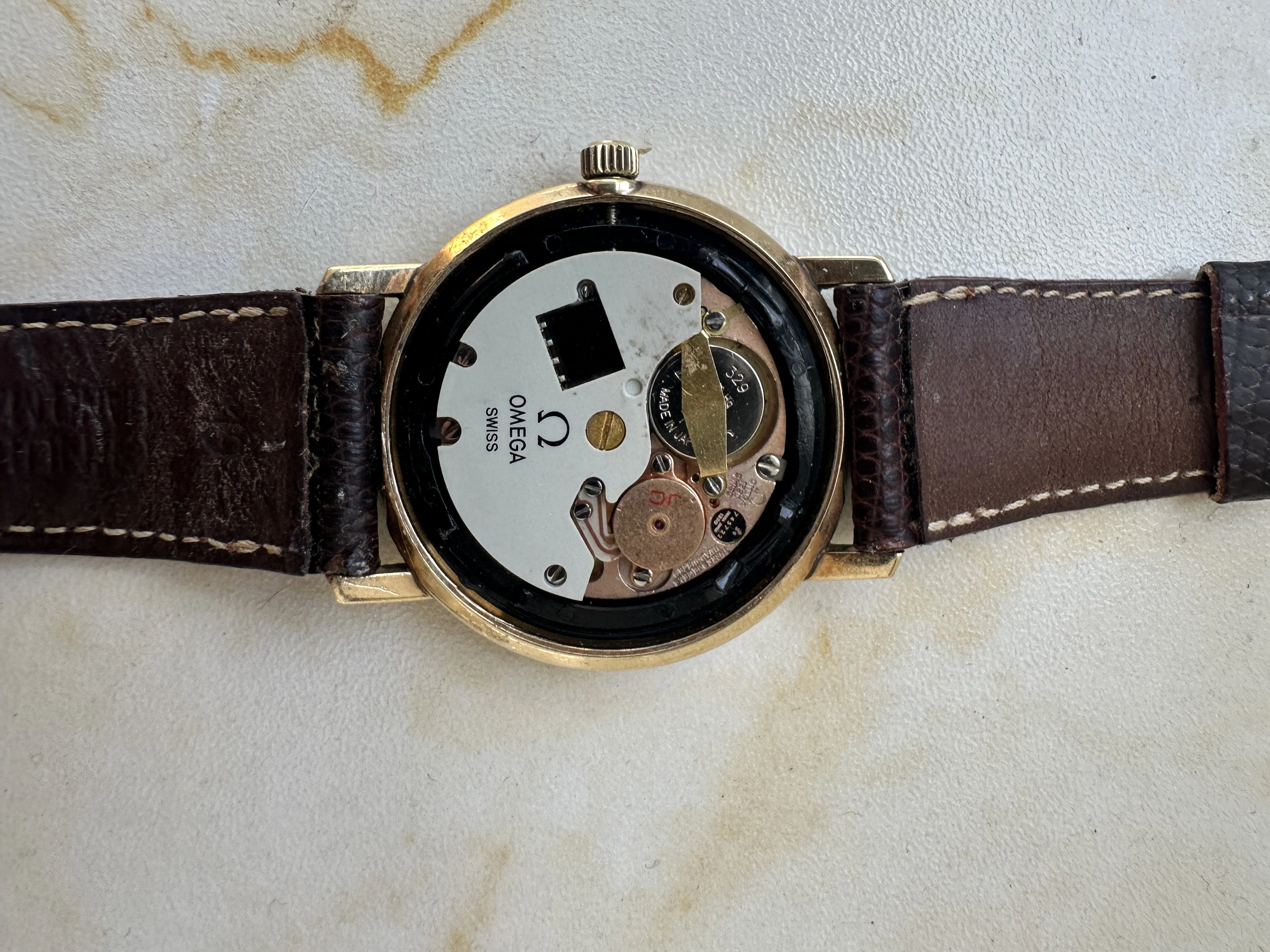

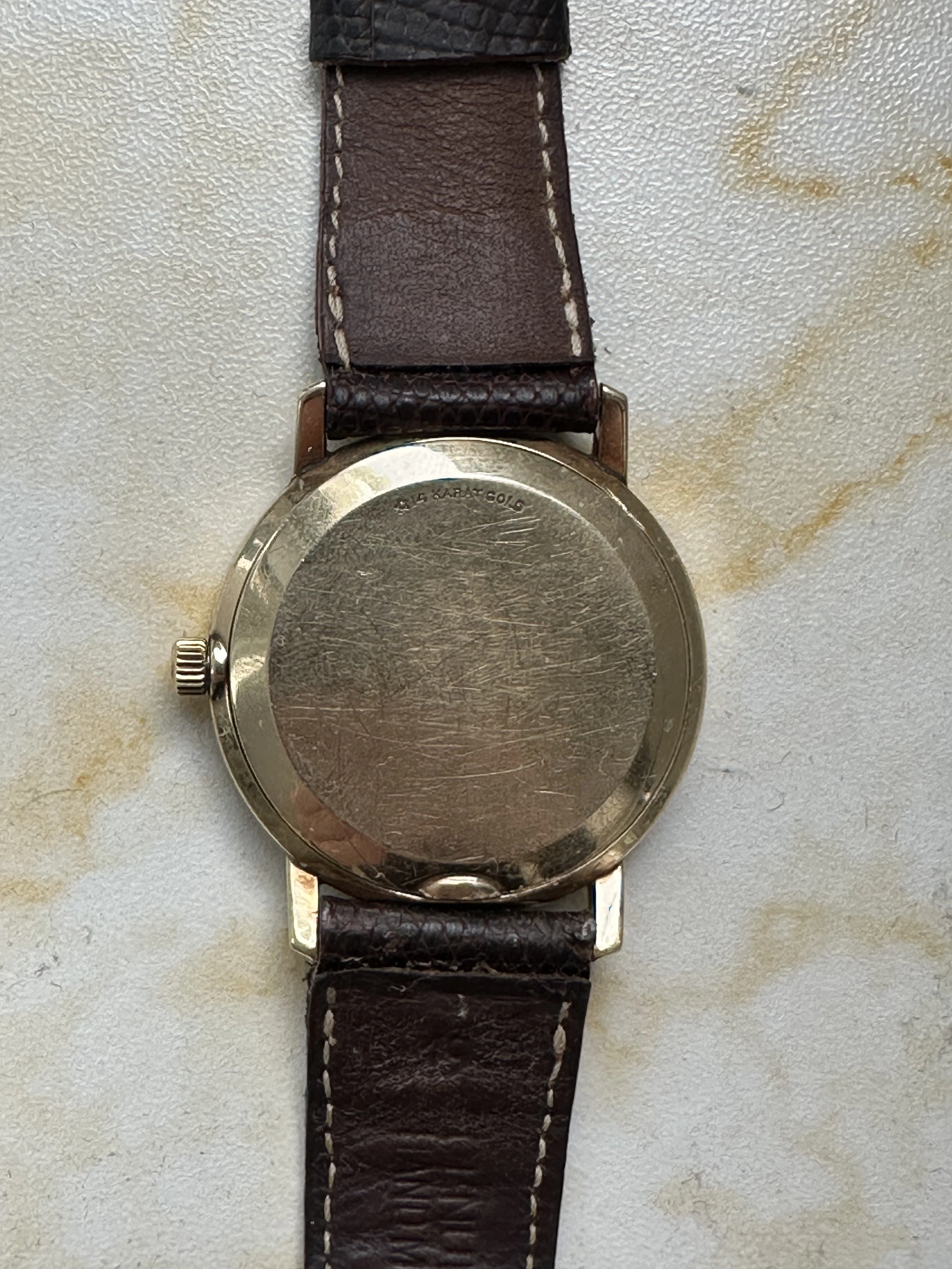

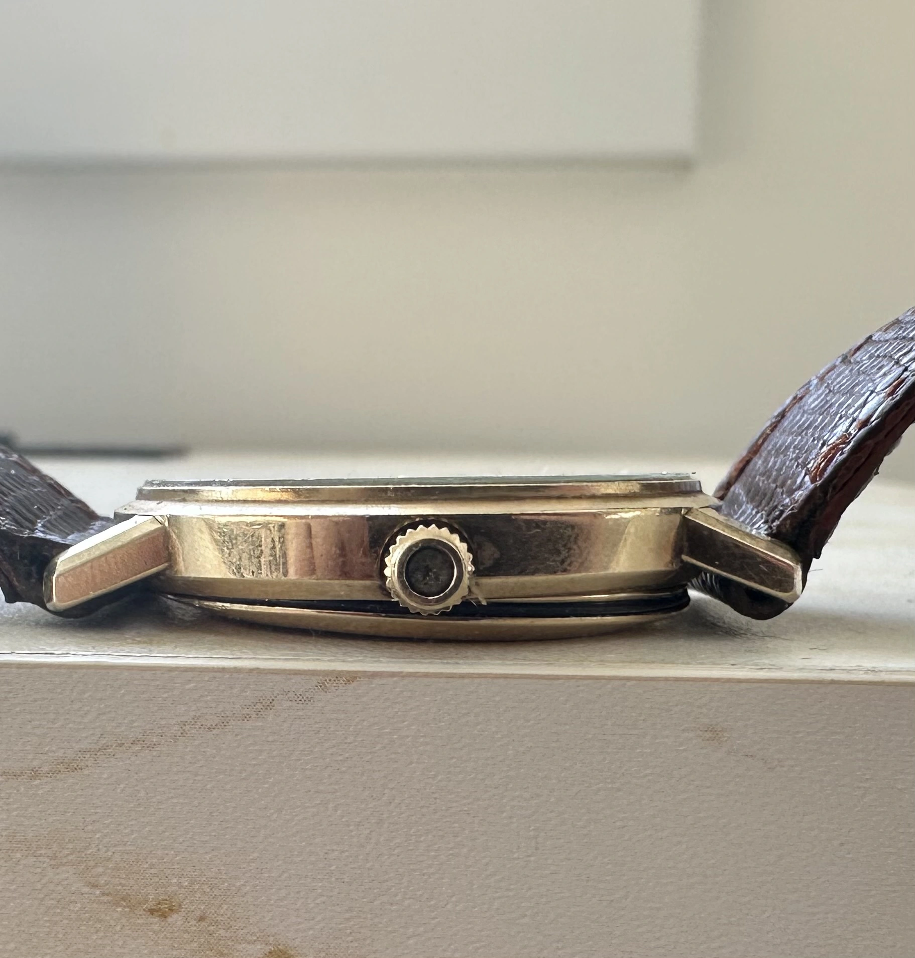

I got some photos of the side and inside. It tells the time accurately, the problem is that I can’t move the minute hand. In addition to that, the back plate is bent.

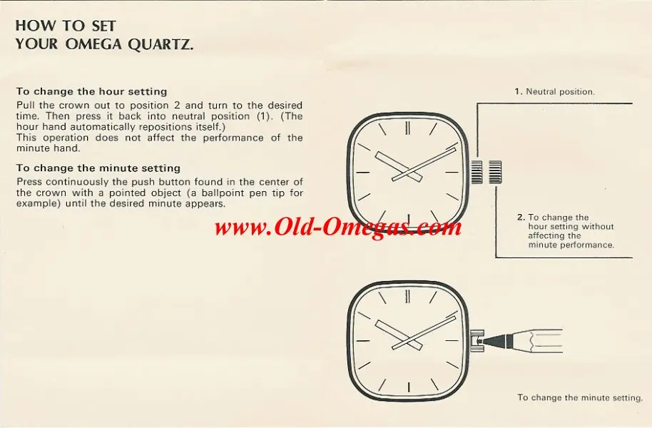

Ok, so a 1330 movement.

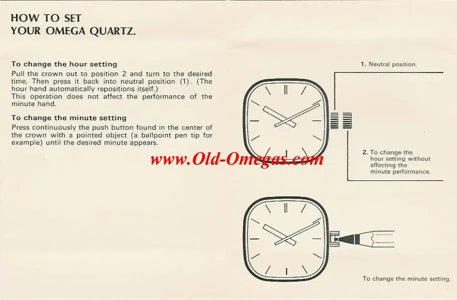

You might be just not setting the minute hand correctly as was said above, check this photo out of the manual.
The 'full out' ONLY moves the hour hand. to change the minute, you have to press inside the center of the crown with a pen.
The bent case back is going to be a bit of a pain to fix, BUT it shouldn't be a problem as-is. I THINK that case is keeping the back on entirely with the gasket, so replacing the o-ring (or making sure the current one is in good shape) should keep it on and watertight.
9,366
78,434
A competent local jeweller or watchmaker (not the guy in the Mall who sells batteries) should be able to repair the bent case.

Thank you, this worked for me.

I may be wrong here but the current battery looks a little undersized?
18,847
39,194
They originally used a larger mercury based 1.35v battery but the 1.55v silver oxide replacements will work OK.
Ideally it would have a plastic spacer ring but if the OP isn't playing golf or mowing the lawn it should be OK.
