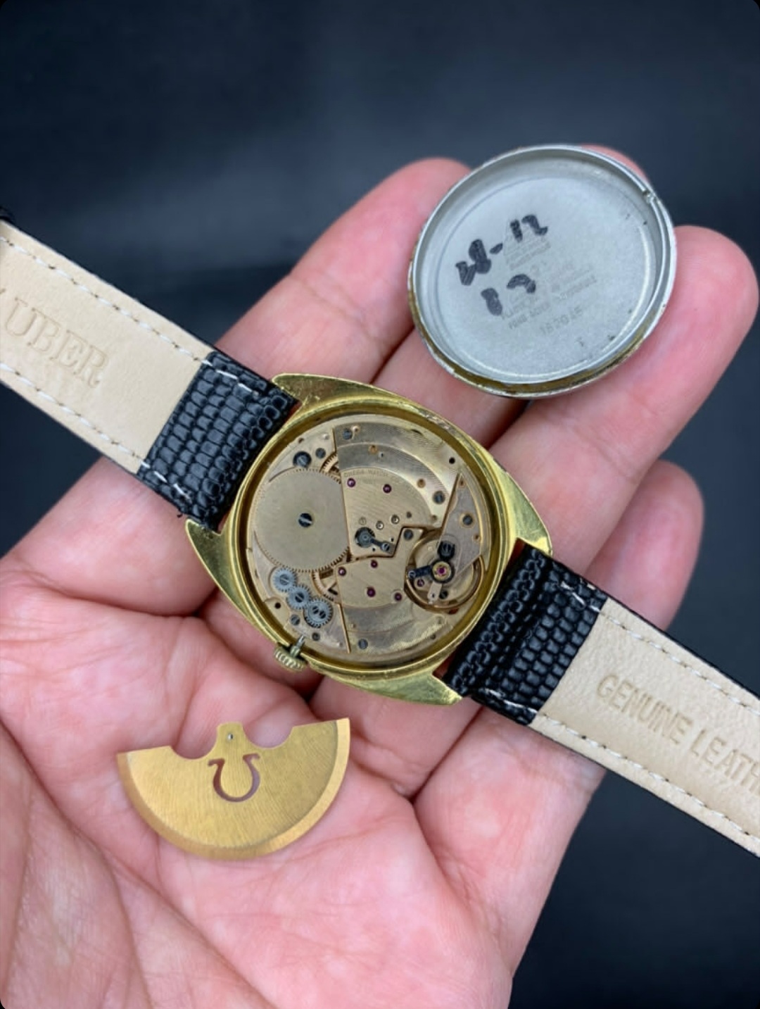

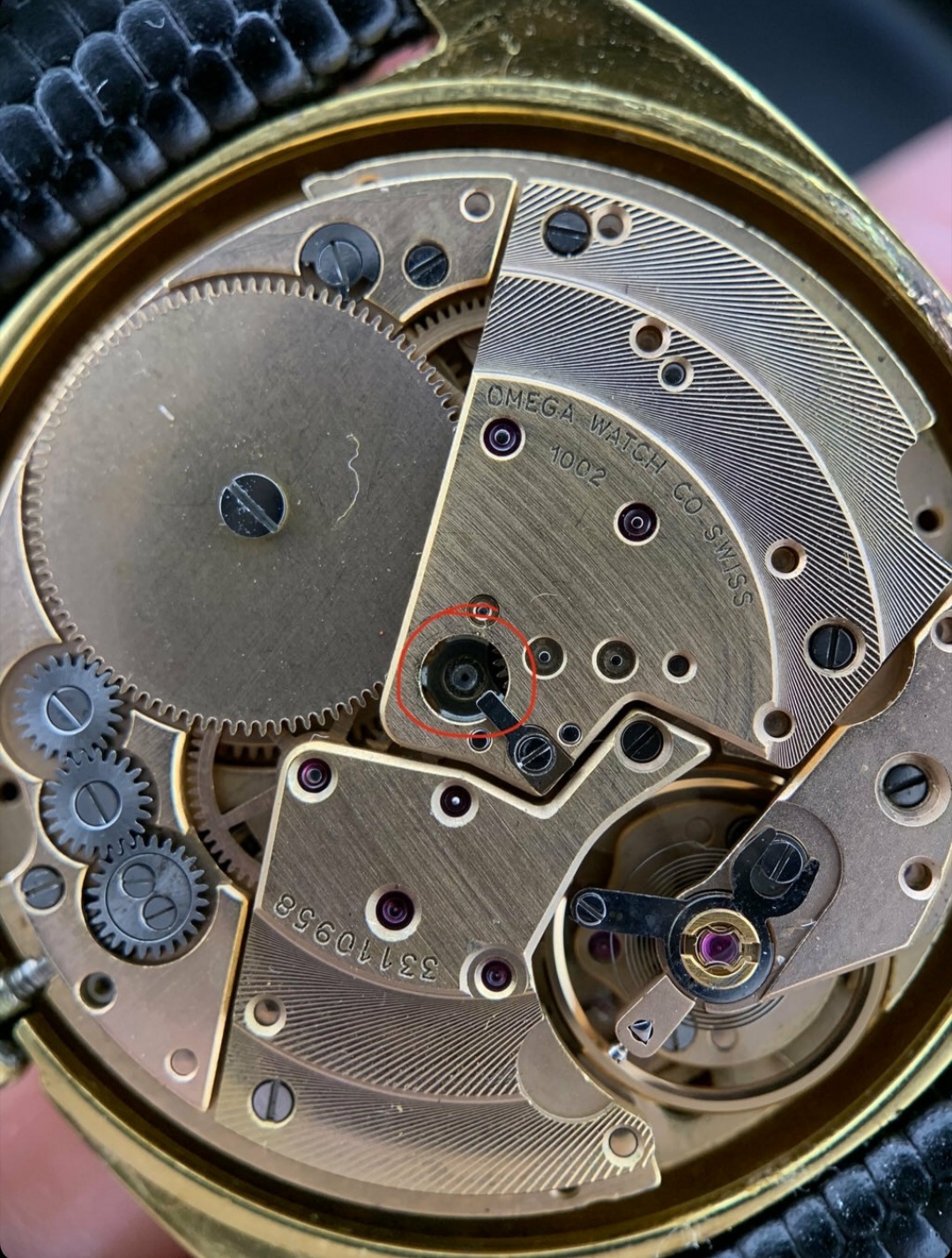

Hello all,
I am not sure if this is the right sub forum to post this, pardon me if i make a mistake.
I have this Cal 1002 which has a missing part, i believe it's called "Rotor Axle"? Please correct me if im wrong.
I am currently looking for this part, but due to the scarcity it's hard to source. My question is, does this part has universal size among all caliber? Can I substitute it with series 6XX caliber etc?
Your input is appreciated.
250
713
You are looking for caliber 1000 part number #1400. Omega’s internal part number is 72210001400. It’s an available part of you take the watch to a watchmaker with an Omega parts account.

Hello,
Thank you so much for the advice and part number, it definitely make thing easier 😁

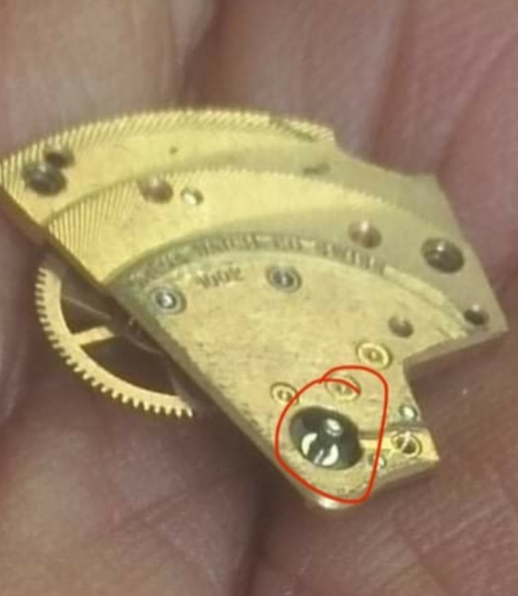

4
Did you resolve this? I can see you have circled where the rotor axle bushing/gear would be but that the rotor axle is in the photo. Was it that you were looking for the rotor axle or the rotor bearing? I am looking for the bushing/gear but cannot find the part number, or part.
