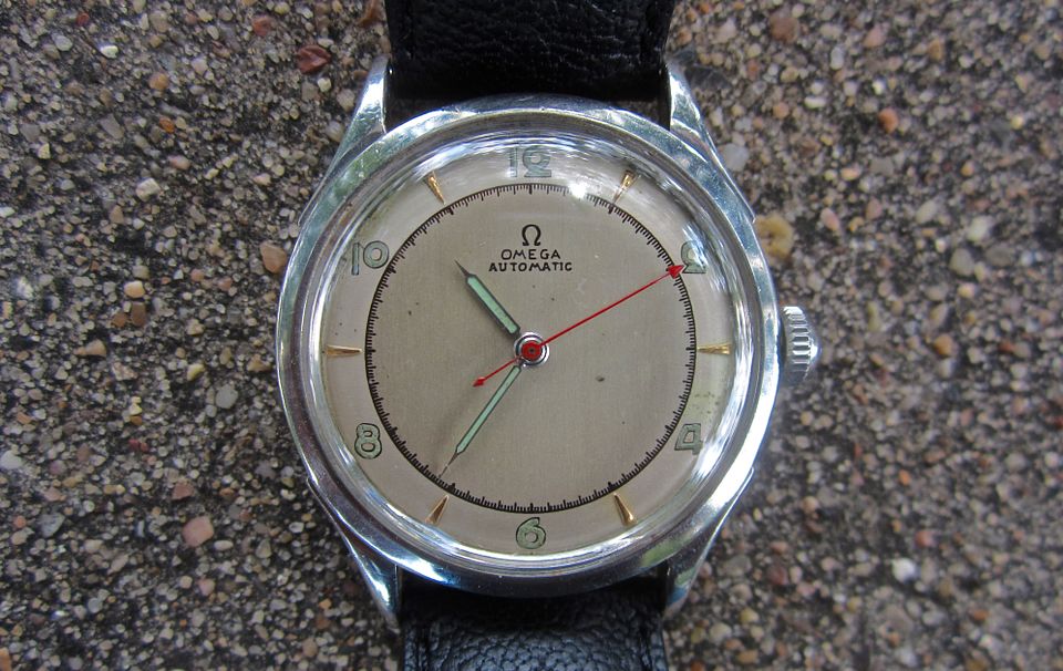

If they are genuine Omega dials, given the two references, I wanted to check that they were manufactured in a similar time frame.
Having said that, that dial style would have been quite strange for the late '40s...

May I change my opinion from "refinished" to "needs to be refinished?"

@noelekal there is one more option: "finished"!
2467 model with serial no 11228786 is made in 1947 as per the site.
2438-5 is 10755338 is also 1947.
Both dials are contemporaneous 'redials'!

There were dial refinishers who had their own creative dies to reprint years ago. So anything is possible.
Personally, I lean towards original here, but as I said before, it’s impossible to tell. Omega is of no use, because they never opine on dials.

Now forum may opine if the dial is a refinish or not.
Two things bother me in the photos - the back side of the dial appears to have had something applied to it in the area of all the applied markers. This could imply that they were removed for refinishing.
There is a punch mark at 12 - we see notches sometimes in dials, and there's debate if they are from refinishing. I don't believe they always are, because I've seen brand new dials with notches in them. This punch mark though, to me that looks like something done after the dial was originally produced (it has deformed the edge of the dial) and seems like something that a refinisher has used as a reference.
To me these are both indications of a refinished dial.

@gatorcpa the whole day i have been so down and morose! You are correct and I am neither professionally equipped to do it. I myself am to be blamed.
While on the topic of damage, there are experts calling damaged dial as rolex 'spider' dial and heavily damaged is heavily patinated and with 'character'. I sure love the experts' terminology.

"the back side of the dial appears to have had something applied to it in the area of all the applied markers. This could imply that they were removed for refinishing."
@Archer this is the second good point after the point was made about scratched text. But if someone would goto the extent of scratching out OMEGA, he might as well do it too.
Not sure what point you are trying to make. When a dial is refinished, applied markers are removed so the dial can be stripped and reprinted. The markers are initially held in place by grinding the pins on them after they are pressed onto the dial, which sort of smears their material into the dial and keeps them secure. Once they have been removed, they need to be held in place, and often dial refinishers will use glues to do this.
A dial from the factory doesn't typically have anything painted over the backs of these markers, as your dial has.
