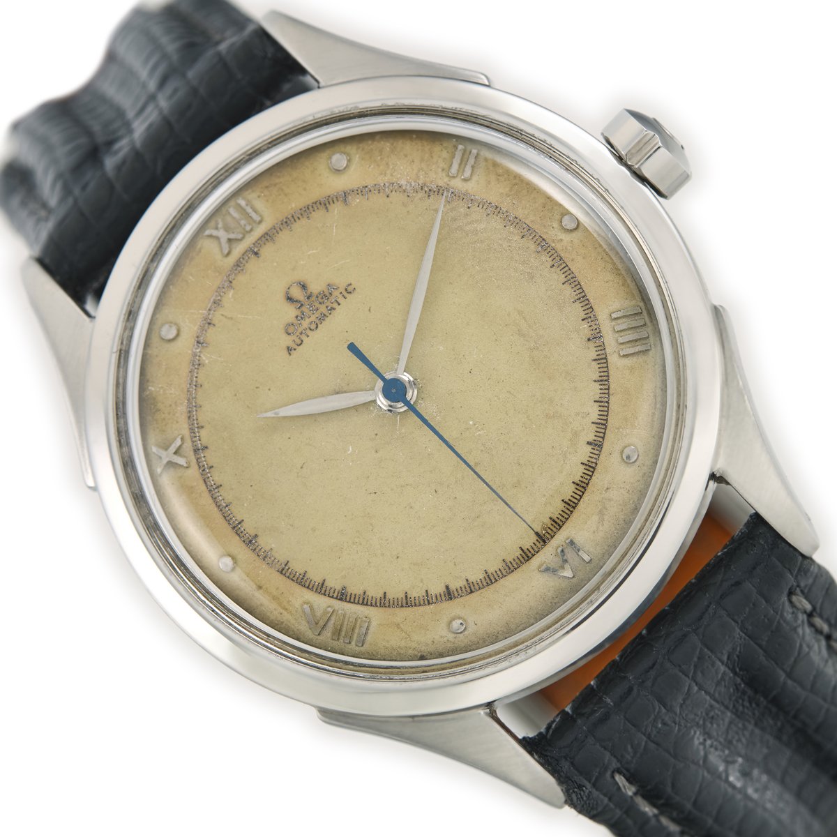

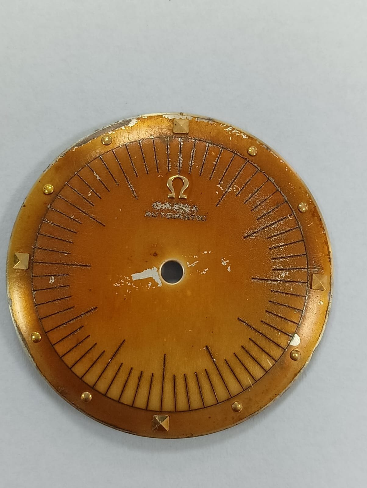

Second watch was sold in an auction house with "original dial". In USA, Hess Fine Arts. To think of these having originated in same refinish shop seems preposterous, to say the least, and an a priori presumption of verdict already passed. (I am in India, BTW! Yes, it could have been shipped, brought by a relative etcetc. For a few hundred dollars of cheating!?)
Answer to why so few such dials are there lies in your own commentary that its very unappealing. Hence probably discontinued fast. Wasnt Rolex 1655 McQueen considered unappealing till McQueen happened?
Will get the watch opened and submit dial for more scrutiny by the members.
Tony remains skeptical even with second example despite same hands and similar dial example given. One would have thought old position would have been revisited.
Anyway, will submit more pictures tomorrow after opening the dial.
Do you seriously imagine that all dials claimed to be original by auction house "experts" are necessarily original? You really are displaying a strong case of confirmation bias.
Do you realise that by disputing the Auction House too and that too of Jeff Hess, who has authored authoritative books on Rolex, charge of confirmation bias is equally applicable to you!?😀 Isnt it?
I am NO expert. Just a dabbler. But for someone disputing Hess, you must be equally or more expert. (Which appears to be the case and I am learning. Honestly meaning it.)
I wonder if Omega heritage wing would give the details?!

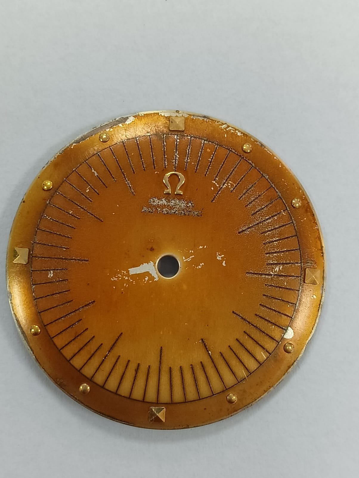

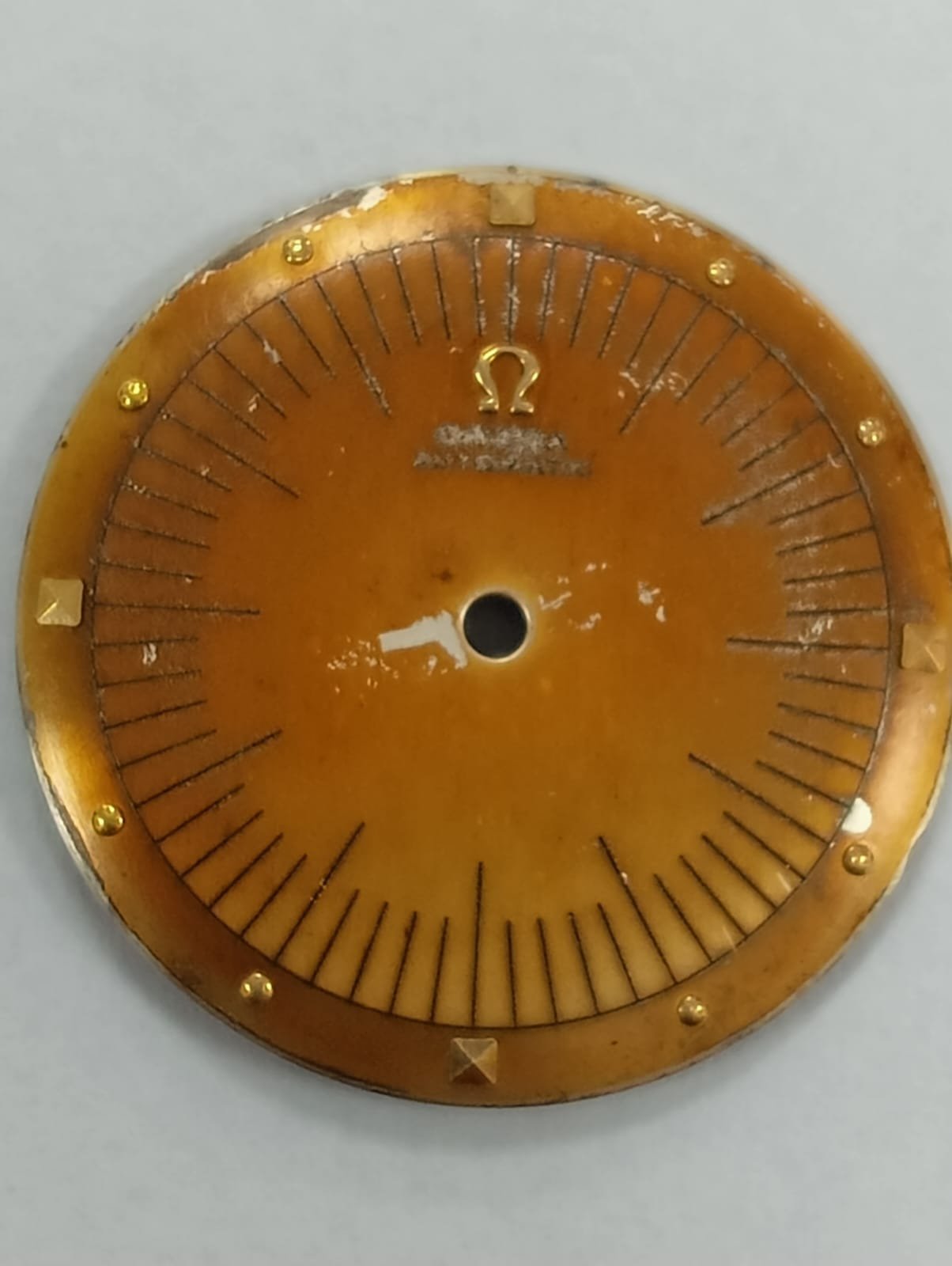

I think it was your choice of word in the title of this post that set everyone off.
Watches are mass produced items, made in factories. The use of the word “unique” is almost an oxymoron. Watch companies are never going to shell out the expense of creating a dial style for a single production example. Not even a prototype is “unique”, by the dictionary definition of that word, because multiple copies are made for testing and marketing purposes.
My opinion is that it is possible that the dial has its original finish, or what is left of it.
You did not show a movement photograph. Is the serial number in line with other Ref. 2438-5 examples found online? Does it have an “OXG” import mark, making it a creation only for the U.S. market? Norman Morris, Inc. was noted for having special designs that were not marketed elsewhere. The red seconds hand is unusual but not unknown to Omegas.
Between the condition issues and poor photography, there just isn’t enough information to make an accurate assessment.

No it is not. The reasons are as follows.
Auction houses are, by definition, biased. They want to sell, and get the highest possible prices for each offering. That isn't to say that they are all dishonest, but if you pay close attention to the descriptions, even from relatively honest houses, the bias will become evident.
A few related points in regard to Jeff Hess specifically. First, do you think that expertise, no matter how impressive, in one brand of vintage watches, is evidence of similar expertise in many others? If so, you are mistaken.
Secondly, do you think that Mr. Hess assesses all of the watches that are sold by his company? I would say that the chances of that are very close to zero.

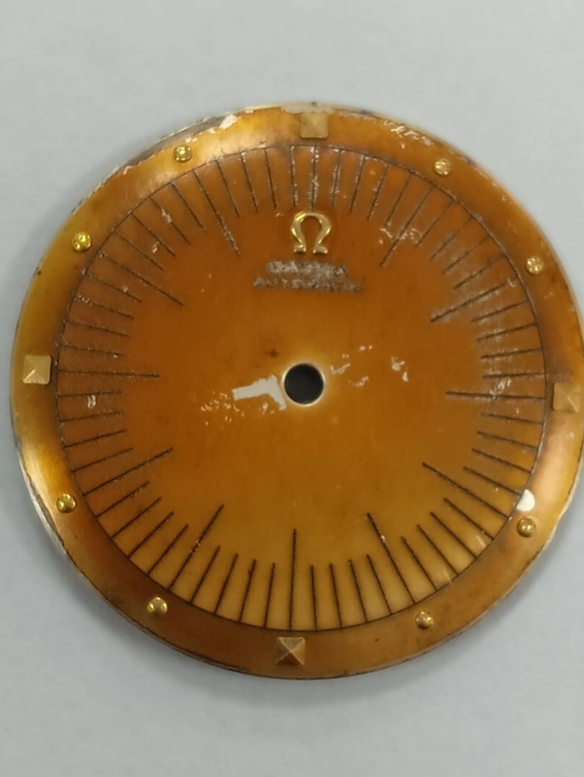

Why ask for opinions if you are going to ignore all of them and buy it anyway? It looks junk, I for one think it is a historic redial but even if not it is too far gone to be anything of great interest.

Not having seen a similar dial would just prove the Black Swan Theory, IMHO.
Cross-referencing dials is a powerful tool. Not being able to find another example sold from a major company in an era of mass-production is a problem. You need to accept this. The dial is going to face greater scrutiny and the standard of positive evidence is higher because the statistics are against you.

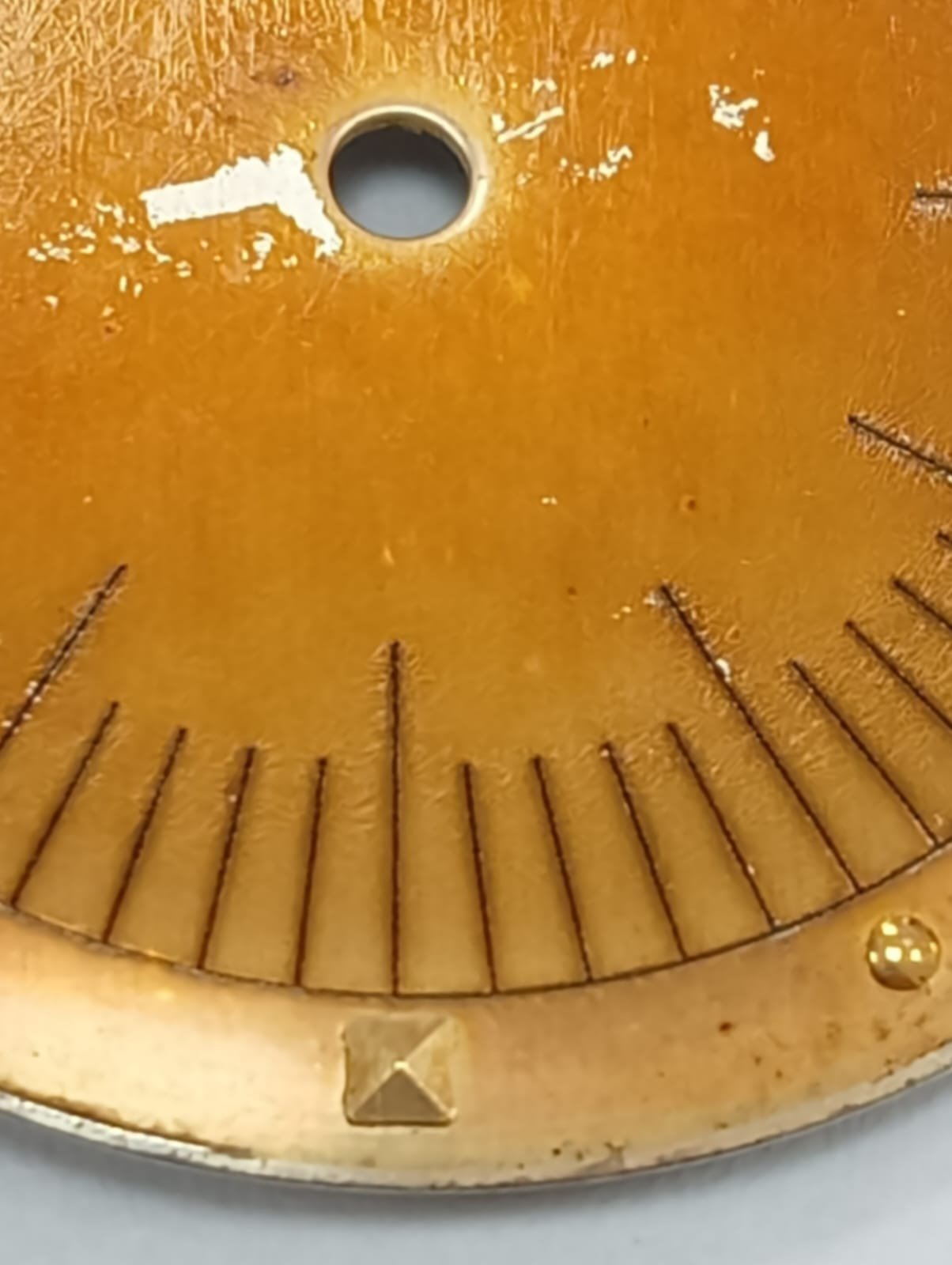

My gut reaction is that it's a redial.
1. The way the track approaches the Omega logo and markers makes the dial seem out of proportion and cramped. In fact, the minute marker is possibly even touching the logo. It's not a very cohesive dial, in my opinion, and strikes me more like a stamp from a redial kit. But this is not enough to condemn it. Even big companies made questionable design choices.
2. The second hand does not even closely approach the track. This is concerning.
It makes we wonder if the hand was originally on a dial with a shorter track - like this one:
The sub-seconds example is a nice find by you - but the photo is terrible. No detail at all. My gut reaction, if I saw that out of context, would be that it is a redial, too.
You say how unlikely it is that they could both be redials - and you're right - is makes it less likely. But it's still possible. Redial kits were sold all around the world. It doesn't mean they were redialed by the same person (assuming they are identical jobs). My guess is that - if they are redials - they were redialed decades ago.
As for you holding up an auction house's word that a dial is original... The more experience a person gain in this hobby, the less interest and faith they tends to have in auction descriptions. They learn all they need to know from the photos.
All in all, I lean toward this being a redial. Mostly by intuition and the dearth of other examples - but I am not certain either way and I'm not an expert with these bumper Omega's.

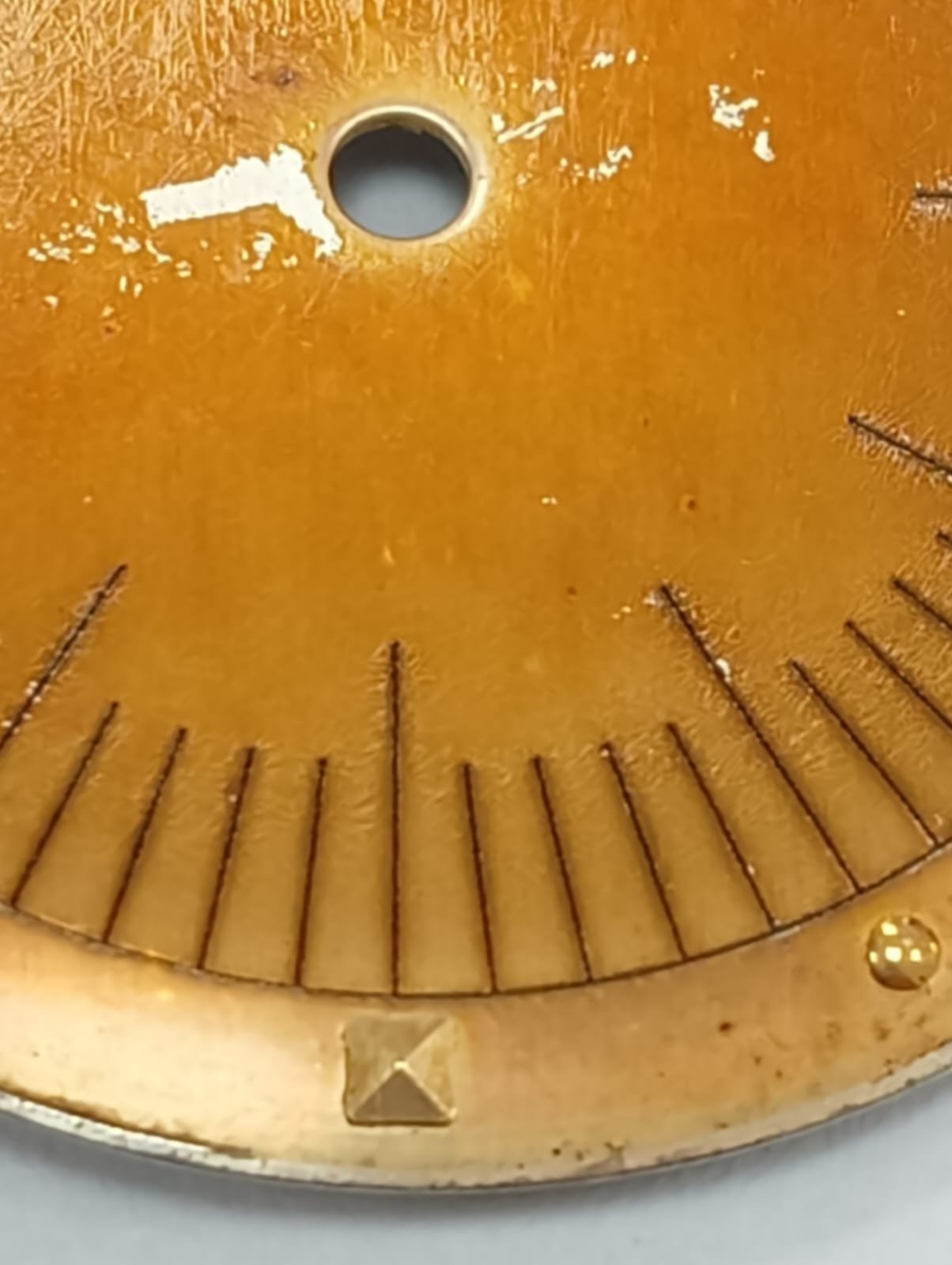

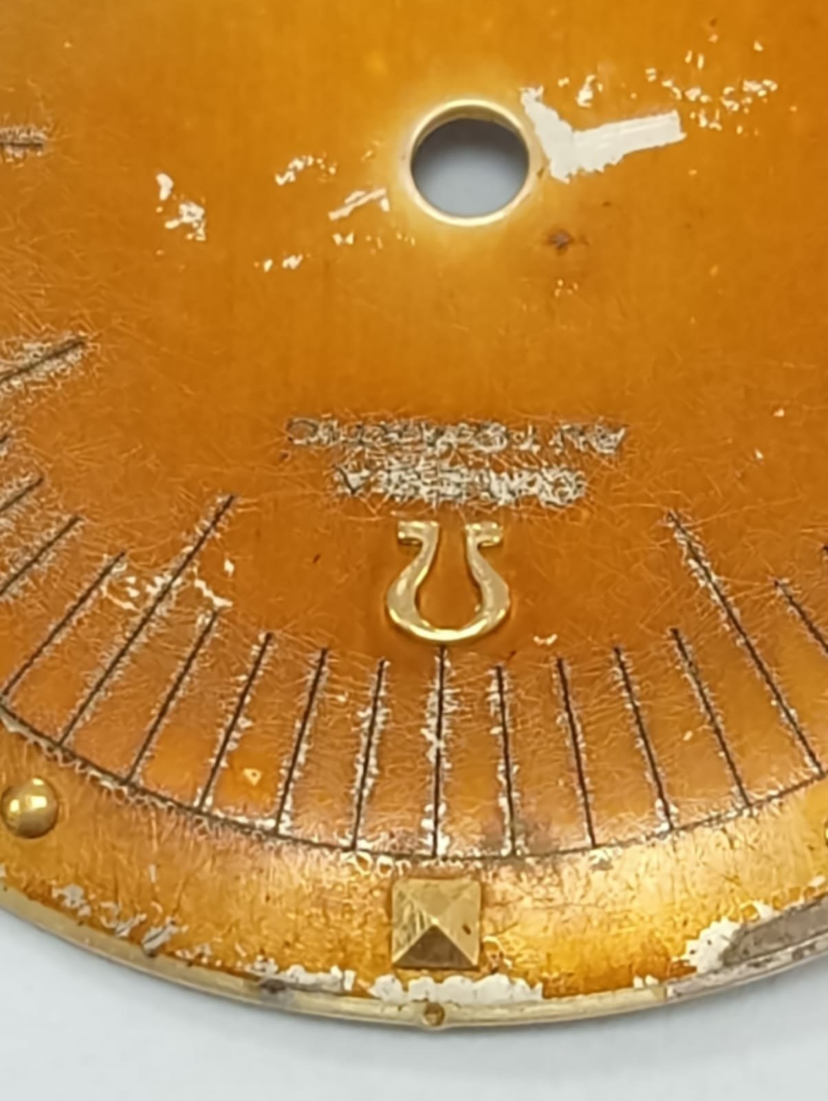

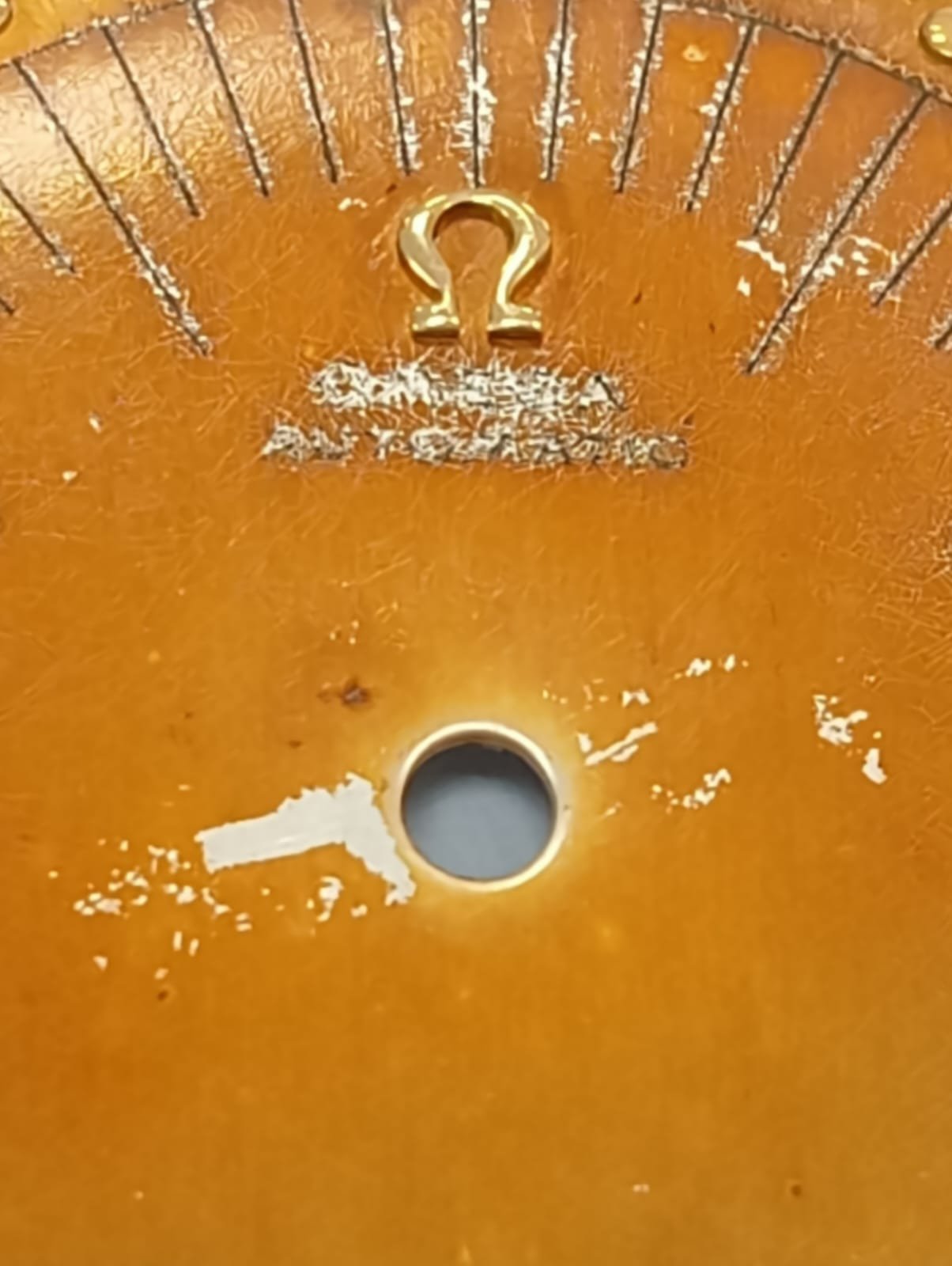

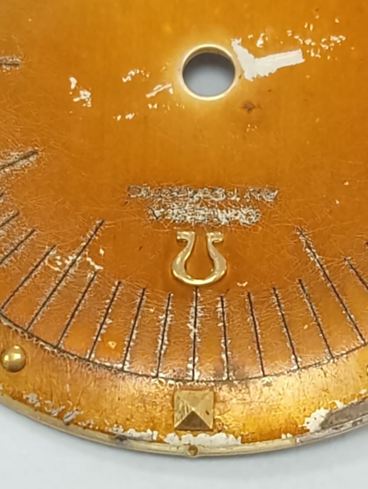

LONG POST ALERT!
While I was sleeping, the world seems to have been typing at Omega Forum furiously! I am glad for the comments and am responding to individual comments.
“I think it was your choice of word in the title of this post that set everyone off.
My opinion is that it is possible that the dial has its original finish, or what is left of it.”
@gatorcpa, ‘unique’ was used in colloquial sense of term. Cambridge dictionary defines unique as 1. being the only existing one of its type or, more generally, unusual, or special in some way. It was thus used in the sense that its unusual or special in some way. Thus if non-contexual interpretation was taken, burden of that isn’t on me.
Many versions of 2438 but hardly 2 pieces of 2438-5 (while many sub-versions of 1, 2, 3, 4, 6, 7 and 8 are available) were found meaning thereby that production number of this 2438-5 would have been less. Probabilistically, all sub-versions have equal chances of being found on internet, unless production numbers of one version are remarkably low.
“First, do you think that expertise, no matter how impressive, in one brand of vintage watches, is evidence of similar expertise in many others? If so, you are mistaken.”
@Tony C. this is not about expertise in one brand not being evidence of expertise in another branch. Ofcourse not. A superspecialist Neurosurgeon is not a super specialist Oncologist. But both superspecialists know the basic generalities of MBBS. The question here is whether dial is refinished or original, which is good enough for any General MBBS/Horologist of Hess’s expertise. The details of that watch may be seen here:
https://www.liveauctioneers.com/ite...ginal-dial-bumper-watch-reference-number-2674
“Do you think that those dials are original? Neither one is described as being either original, or refinished. Now, what does that mean to you?”
@Tony C. Yes, there are instances of ‘leading to believe’ by omission, but lying by misrepresentation would be grave. However, the watch linked by me is clearly described as ‘Original Dial’ and whoever did it, did on Hess’s behalf; liability is of Hess. But your examples donot have the “Original Dial”. So what is not said cannot be assumed to have been said.
“Why ask for opinions if you are going to ignore all of them and buy it anyway? It looks junk, I for one think it is a historic redial but even if not it is too far gone to be anything of great interest.”
@padders one seeks wisdom from all sides and decides on one’s own on the basis of such diverse opinions and wisdom. Makes for considered decision making. I always say that if two people always agree on something, one of them is not needed! Its junk and ugly is different issue, is it original or refinished redial is the issue. And you seem to be noncommittal.
As for junk, yes. What some might call patina of time, I would call the wrinkles of age. What the poet Longfellow says in “Dust thou art, to dust returnest”
“Cross-referencing dials is a powerful tool. Not being able to find another example sold from a major company in an era of mass-production is a problem. You need to accept this. The dial is going to face greater scrutiny and the standard of positive evidence is higher because the statistics are against you.”
@Modest_Proposal statistics aren’t against me when you consider that 1. Only 2 examples I could find on net for 2438-5 (pointing to very low production numbers), with same feuille hands, similar dial was found on another bumper, same cal 28.10 was used in another 2438-5 as also on this model. Greater scrutiny yes, hence more pictures are given attached.
“The sub-seconds example is a nice find by you - but the photo is terrible. No detail at all. My gut reaction, if I saw that out of context, would be that it is a redial, too.”
@Modest_Proposal have given the link to see those pics.
“You call your watch a "Black Swan" ? Please do not insult these Beauties with your watch.”
@watchyouwant I didn’t call the watch a Black Swan but the event of finding this as a Black Swan Event. Though I am sure you already know it, however looking up ‘Black Swan Event’ may not hurt, just in case.

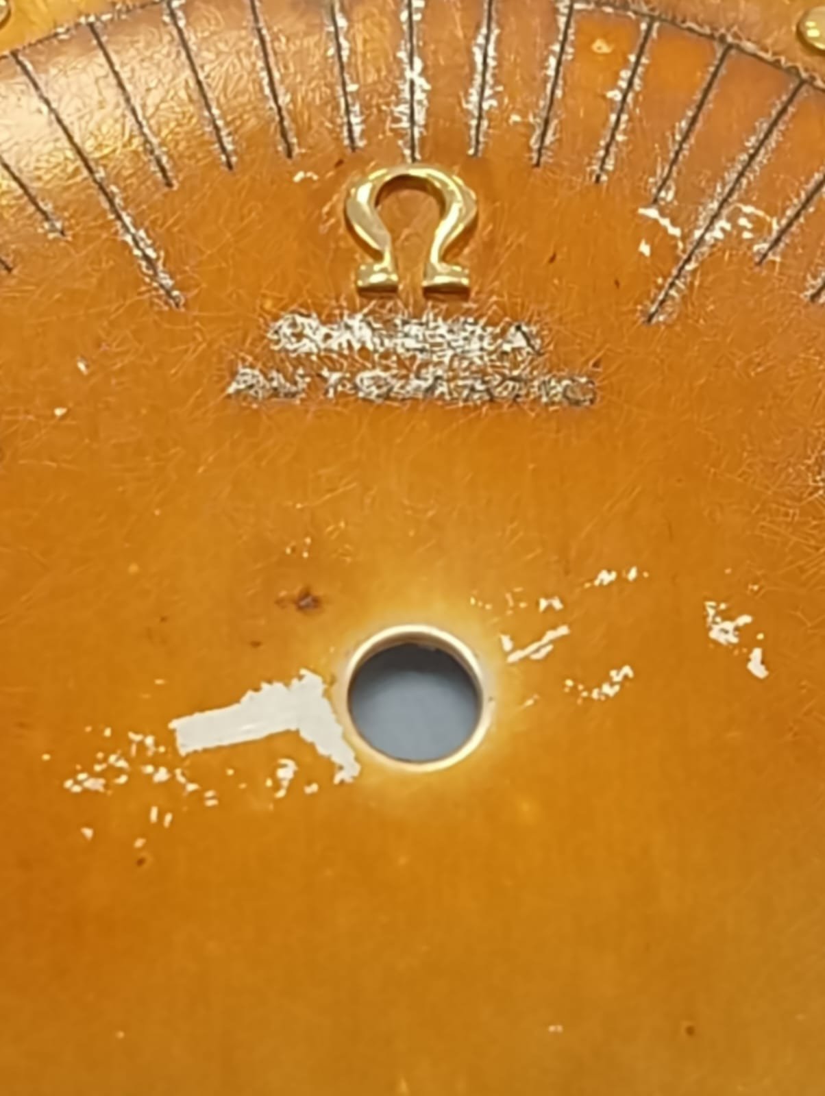

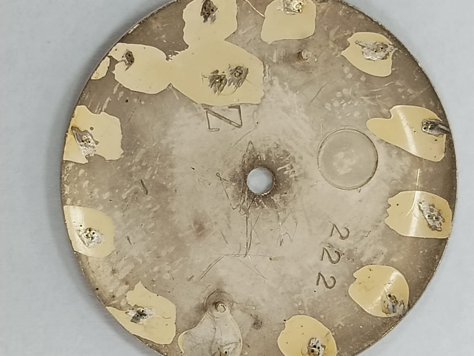

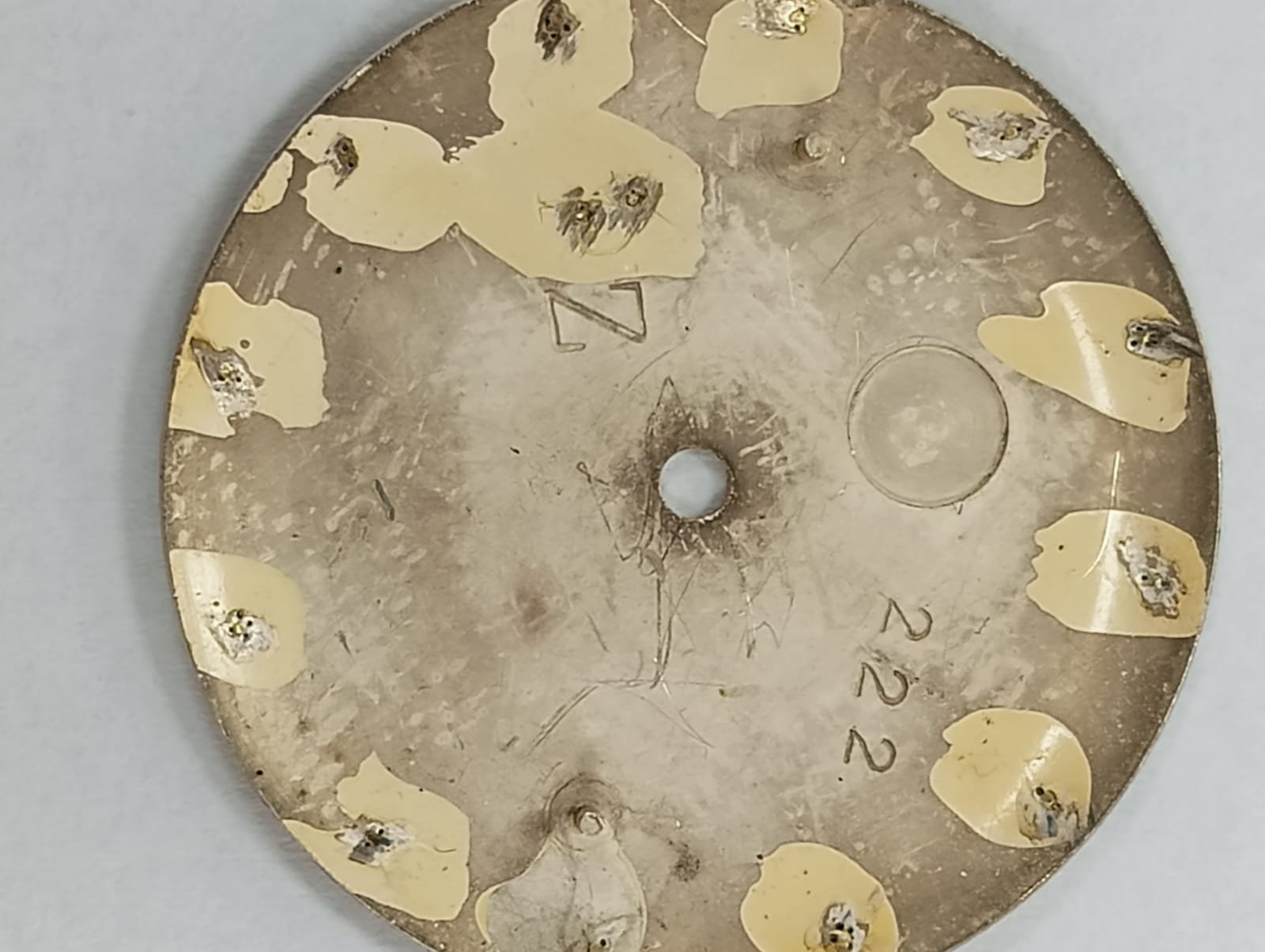

In haste to open the watch, I did some terrible damage (yes, even though most wont believe any more damage was possible!!!). Attached are pictures of the dial and movement. Dial seems to be silver with Z 222 on back. Front is also attached as are some pics of movement.
Now forum may opine if the dial is a refinish or not.

You took my pretty disparaging comment in your stride, fair play to you so I will try to engage more constructively this time. I know it is stated above that a lack of Swiss or Swiss Made is not a red flag, but in my experience of watches from this era, with a Swiss production watch like this, if you can't see it, it's because it is hidden not missing. Here it just isn't present and aside from anything else that does worry me. I was on the fence as you say since if this was redone, the state of the varnish suggests it was a long time ago, but I can't get past the missing text. I'm now firmly on the redial side of the fence, particularly when other factors like the hand length are considered. If you really have found something unique good luck to you, but the condition of the text is such that it will remain a curiosity IMO rather than a diamond in the rough.
One afterthought. Could the state of the text be as a result of a recent seller wanting to obscure a more definite redial tell? It seems very convenient that all the text is obliterated. I’ve not seen that happen on a verified original dial before. It looks scratched off here.
62
13
@padders Of all the points mentioned by the learned people here, this point seems most persuasive towards it being a redial and done with a purpose to obliterate any telltale signs of redial.
Thanks everybody for the time they have taken out to comment here, in deriding or deciding, the dial.
First, some refinished dials are difficult to tell from originals, and I do not agree that a "Horologist of Hess's expertise" would necessarily be able to distinguish them outside of his primary area of expertise.
Secondly, as mentioned and supported above, dealers or auctioneers who are selling watches are by definition biased. If there is a grey area, which there often is in the vintage watch world, they will almost always choose an interpretation that favors their interests. This really isn't debatable, in my view.
The watch to which you linked is the second example (on this thread) of a dial variation that we are assessing and debating. It is described as a ref. 2674. The watch that you posted initially is a ref. 2438. So, you are arguing that these are exceedingly rare, original Omega dials, yet the only two examples presented thus far aren't even associated with the same model. Yes, I understand that one is a center-second, and the other a sub-second, but it does minimally seem odd.
On a related note, what is the movement serial number of the original watch that you posted?
Finally, my initial comments on your watch were not confined to the dial. I would say that there is no possibility that a red second hand was employed by Omega on a gold watch, and when there is one replacement part, it does raise the likelihood of further modifications.
