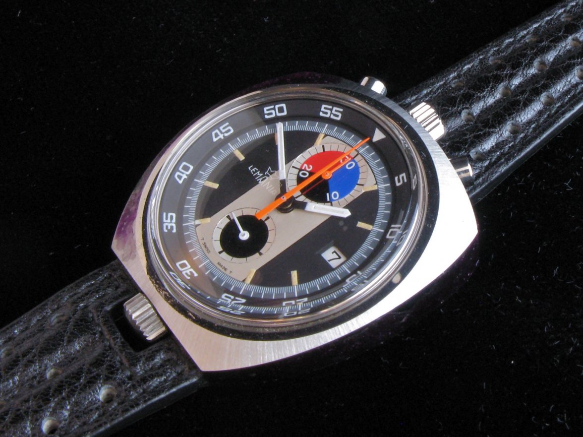

As has been said, there were no 'Watchco' or new Omega service cases, such as are available for the SM300. Watchco were selling NOS cases for this watch and so in my opinion, the dial is of premier importance for these watches. If it is 10/10 then a NOS case can be fitted and it will be a great match.
I bought a NOS Lemania version from them at the time, but found the case shape unwearable and sold it
I suppose we can now get into a discussion as to wether replacing the case on a watch makes it Franken, or improves a tired watch?

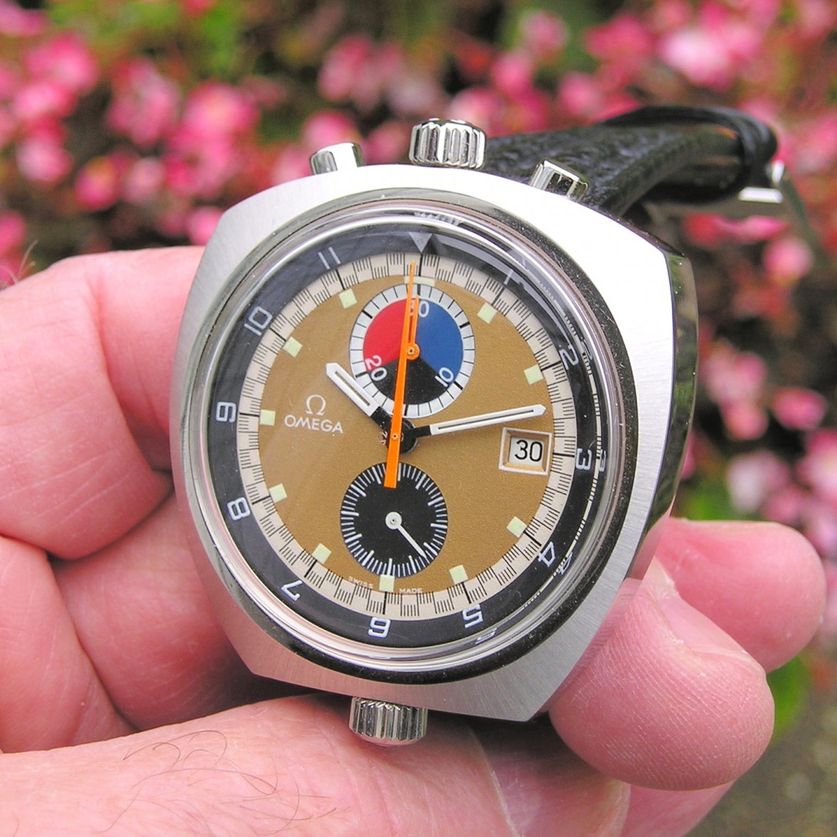

2,086
2,897
This is the only one I've seen with these special hands.
