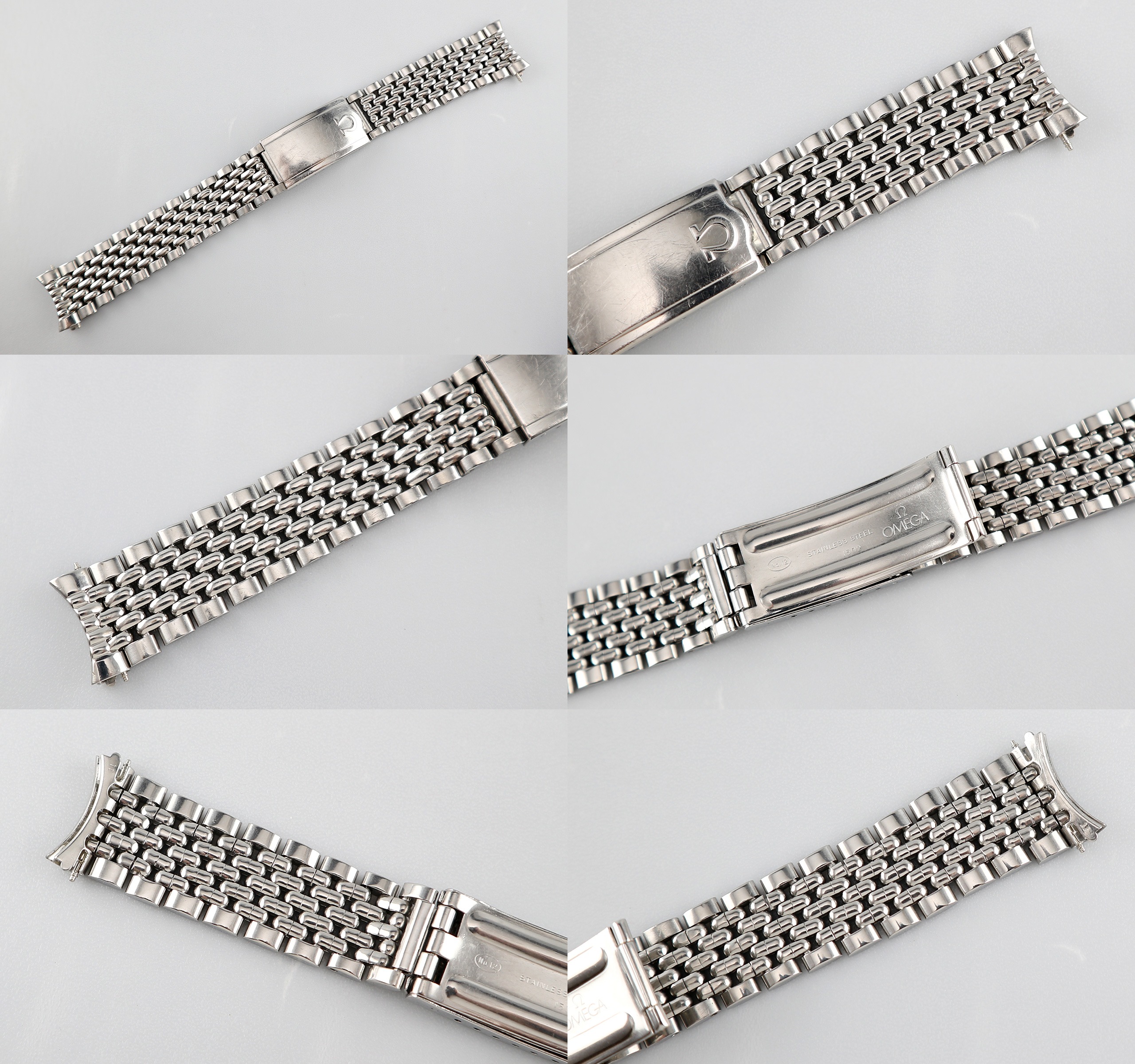

The fakes I know that are currently for sale on eBay regularly for about 60USD and that I find are increasingly often on vintage Omegas being offered ususally seem to have no number stamped into the end links, a clasp marked 1502 and only the outside of the bracelet seems to be polished.

This is another one than the one I was referring to, but this one also don't look original to me.
Edit: a 1502 Omega bracelet should look like this (pic stolen from @No Mercy listing)
