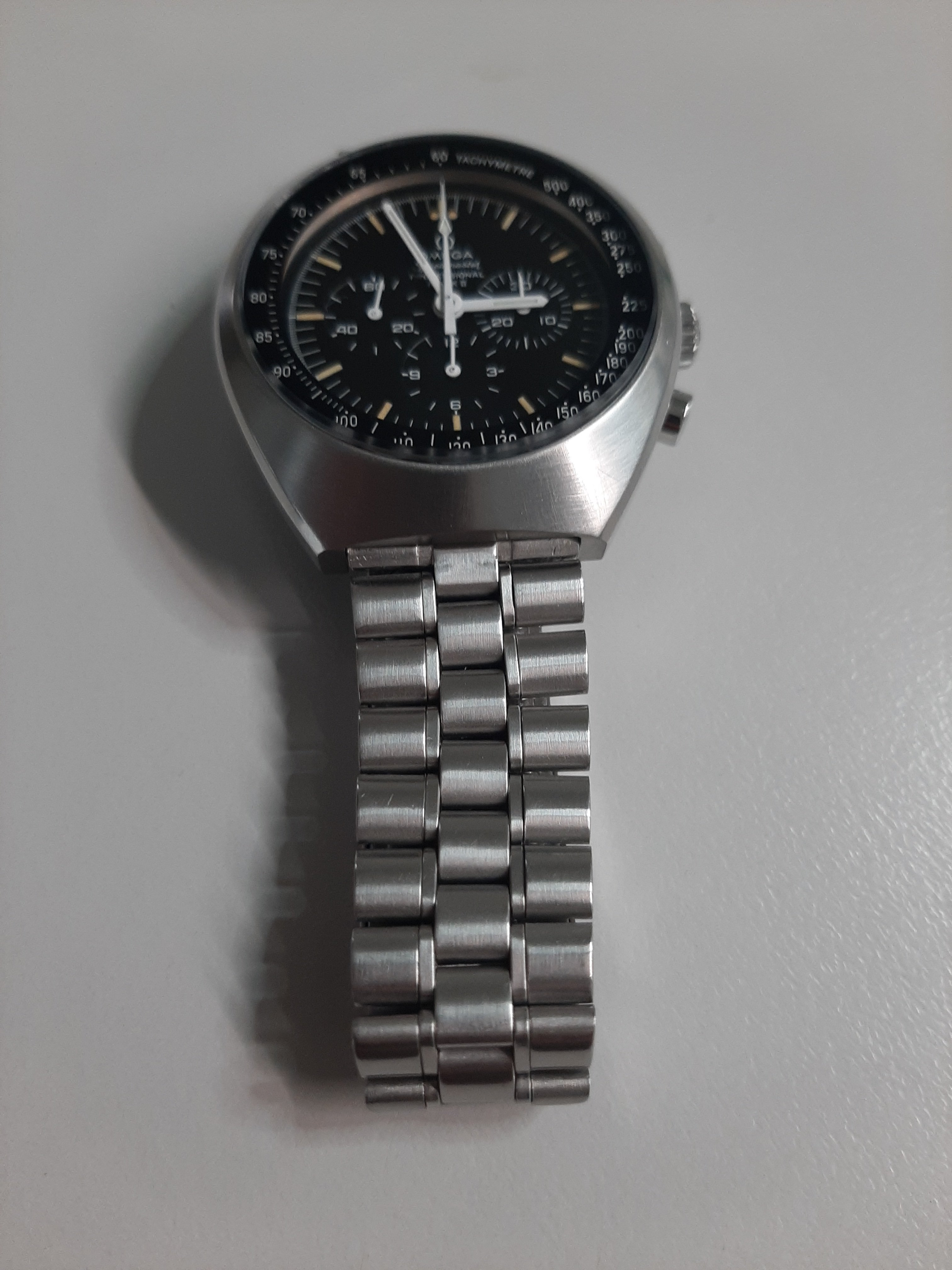

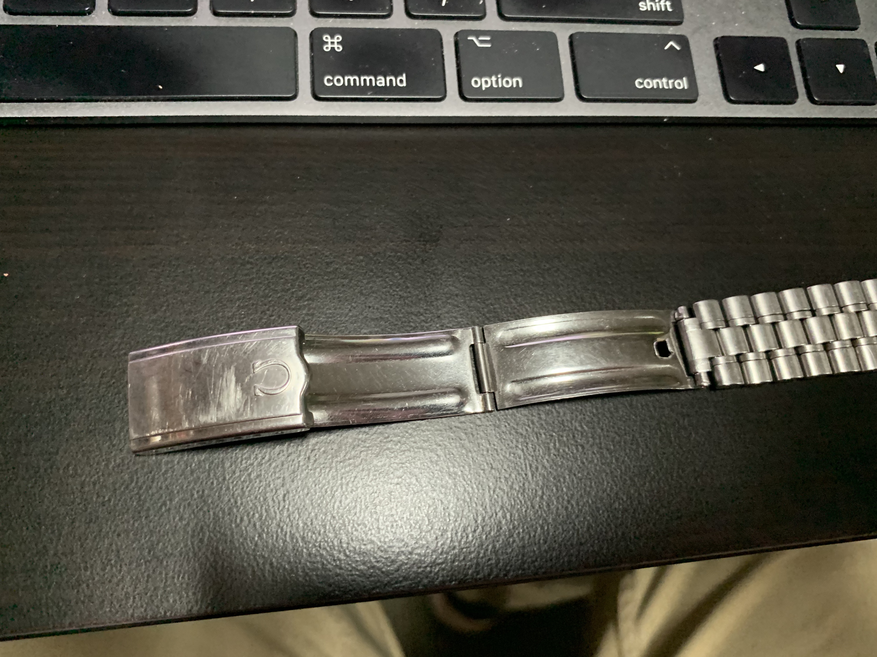

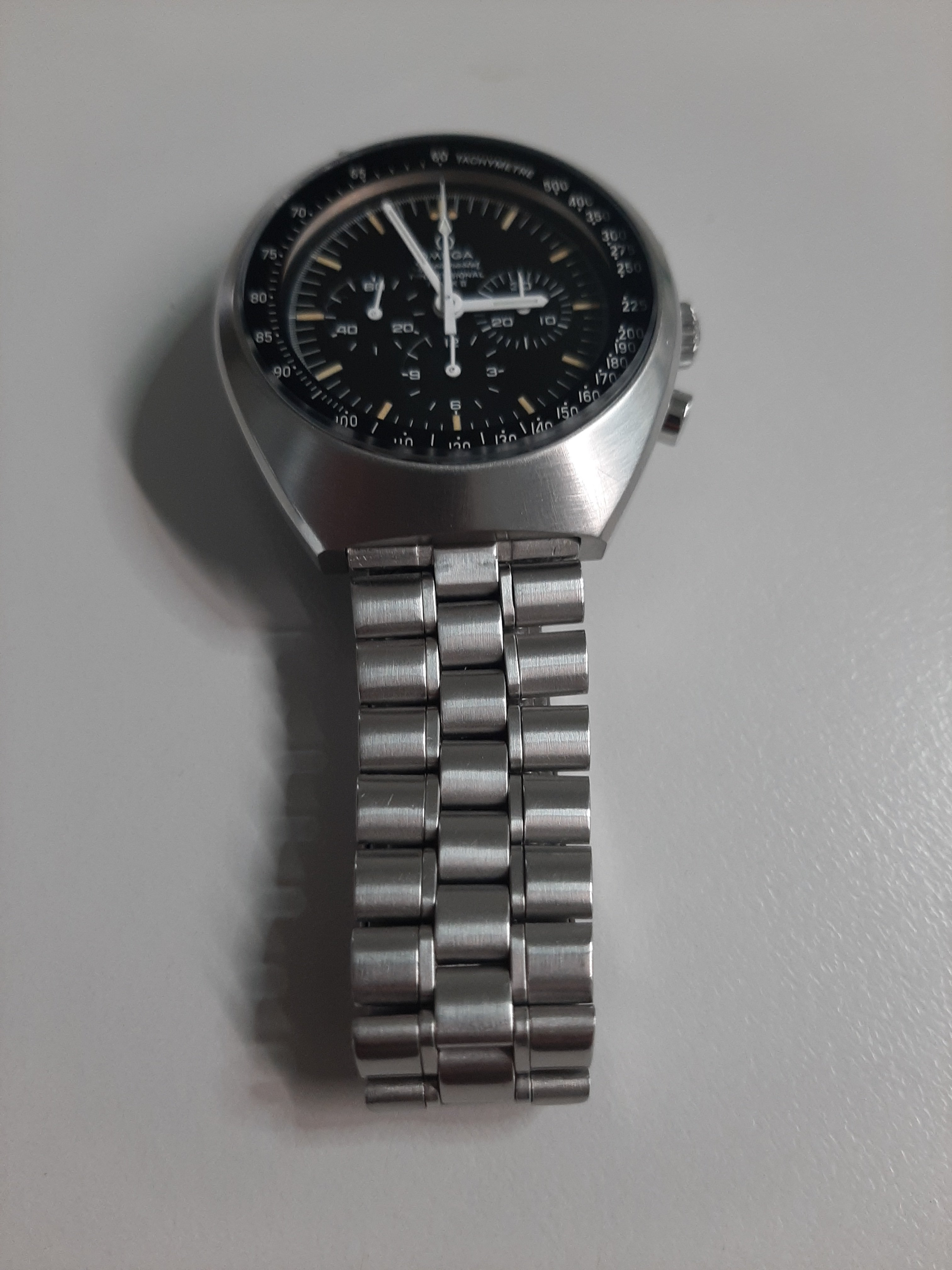

I bought a Speedmaster Mark II and it arrived with this bracelet. The correct is the 1159 or 1162. My watch will date to July or August of 1969 most likely so I’ll be looking for a correct bracelet. What did the 1116 with 20mm end links come on?

1116 came on Speedmasters and a couple of seamasters. I never seen one like yours before. Interesting.
Can you show us the end links?

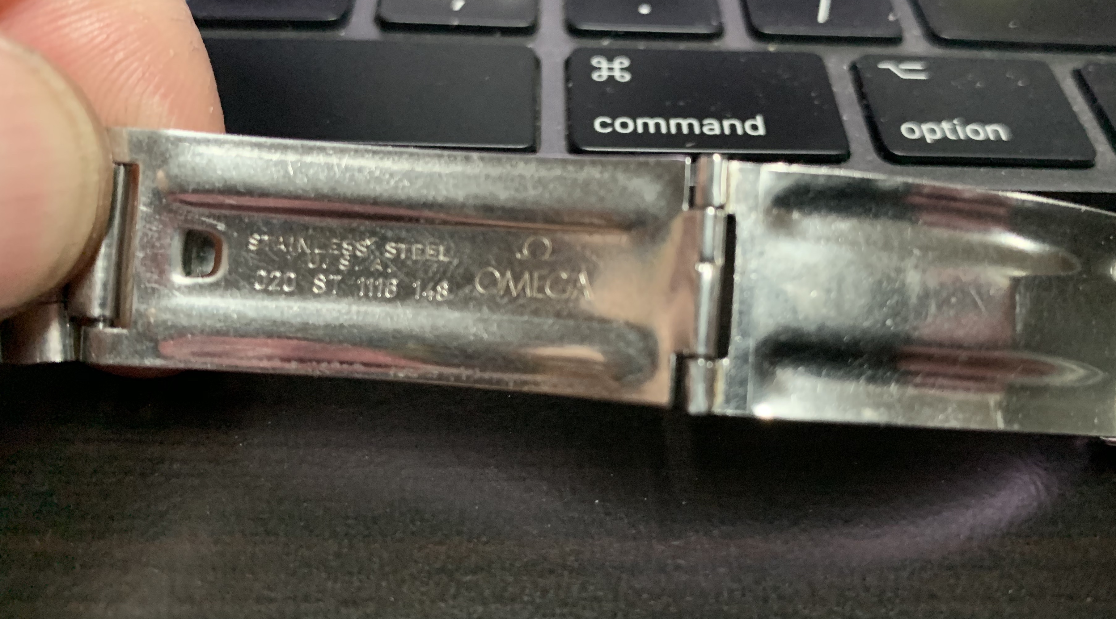

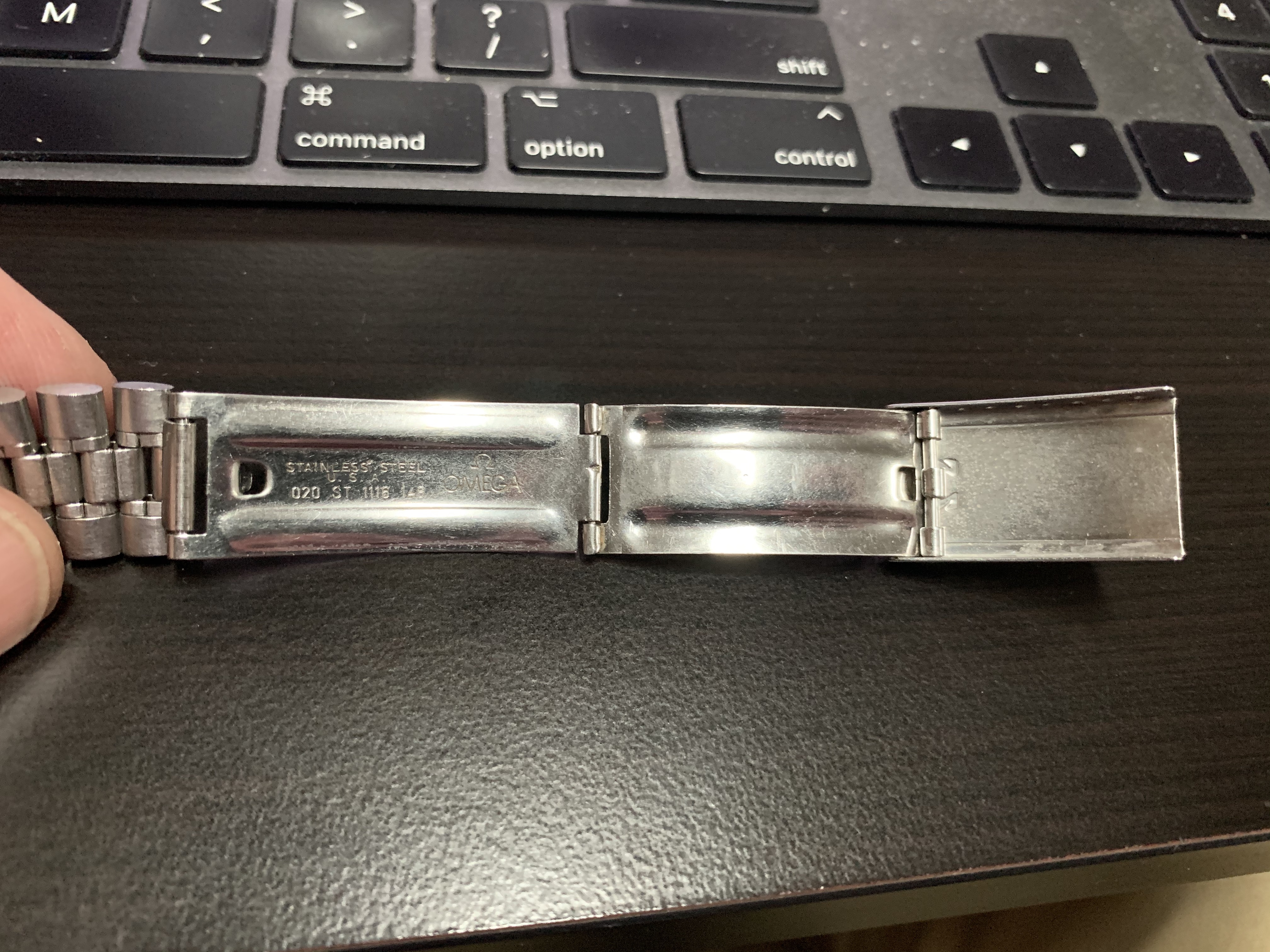

To me it looks like a 1116/148 with filed endlinks. The 1116/148 came on the Jedi e.g. before changed to 1171/175. I also had a 145.010 which came on a 1116/148.

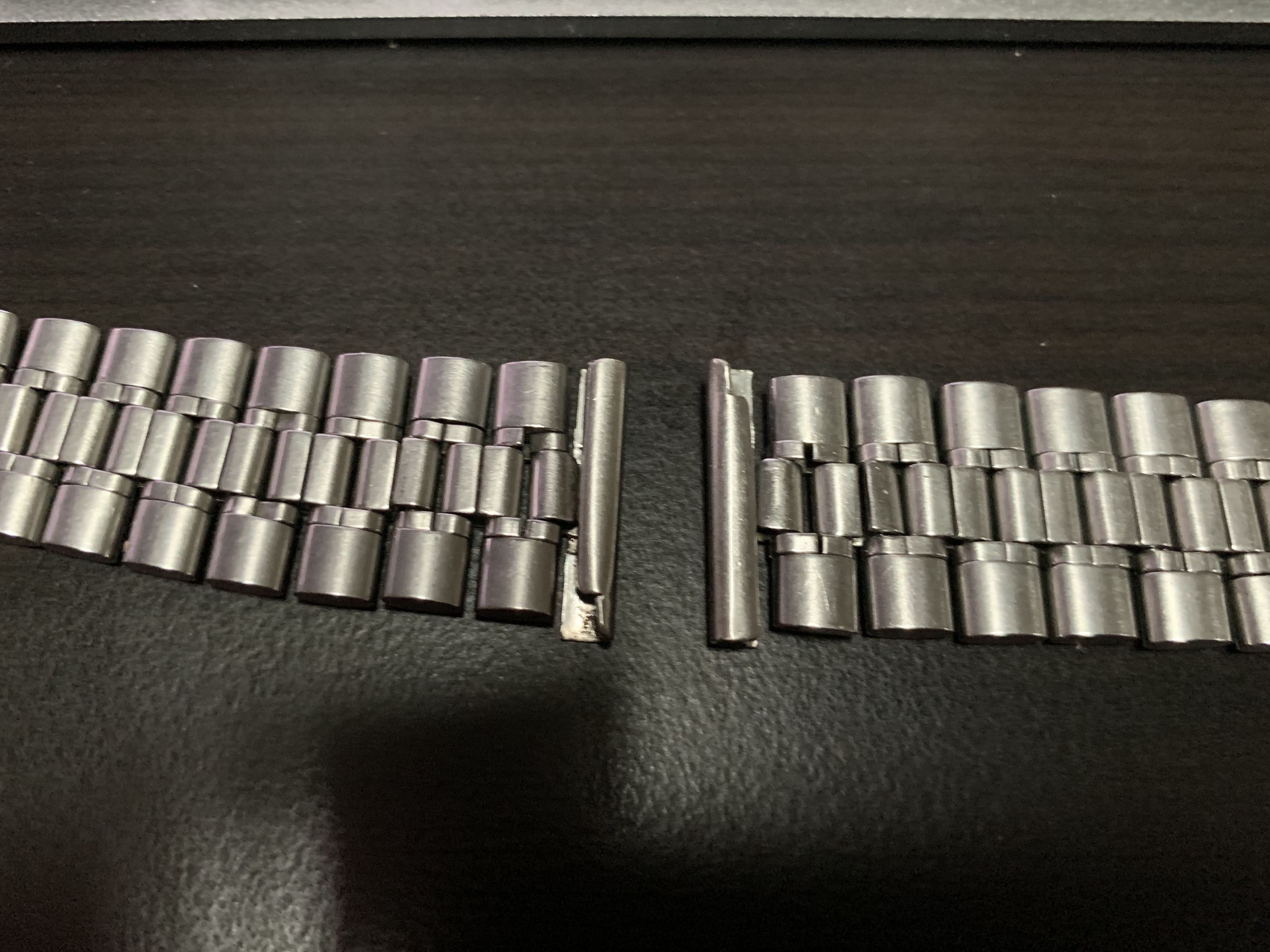

If you measure the last link before the endlink you may find out its the smaler execution of the 1116 not meant for or Mk 2 or a Speedy Pro.
kind regards Max

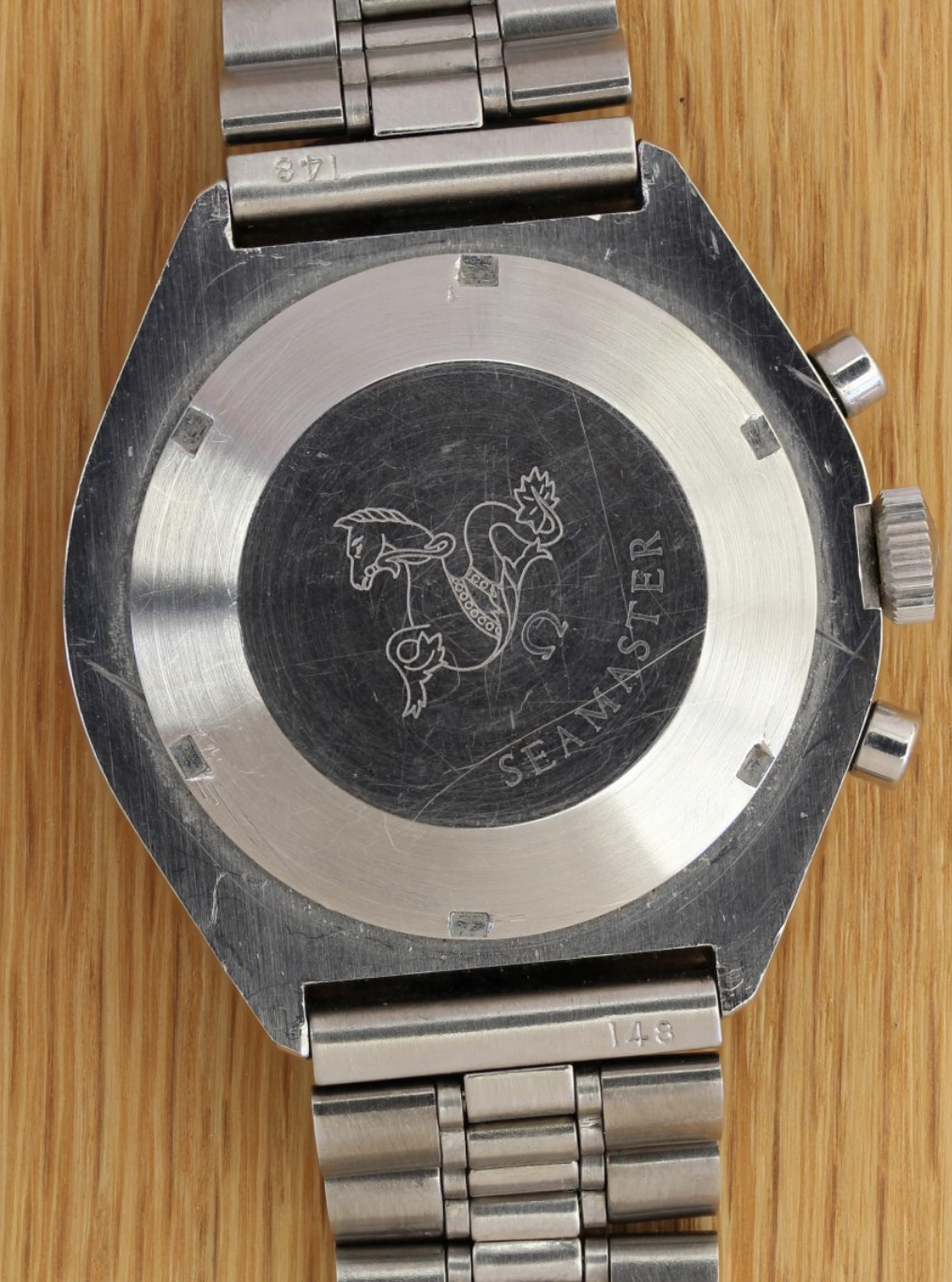

I think at least the endlinks belong to a Flat Jedi (145.029). Since they appear to be a bit wider than the last link the rest of the bracelet might be a 1116/123 seen on 145.009 sometimes.
To me the whole bracelet looks like a bit of a mashup of different bracelets.

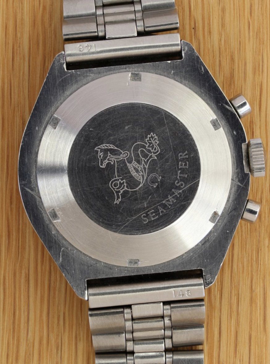

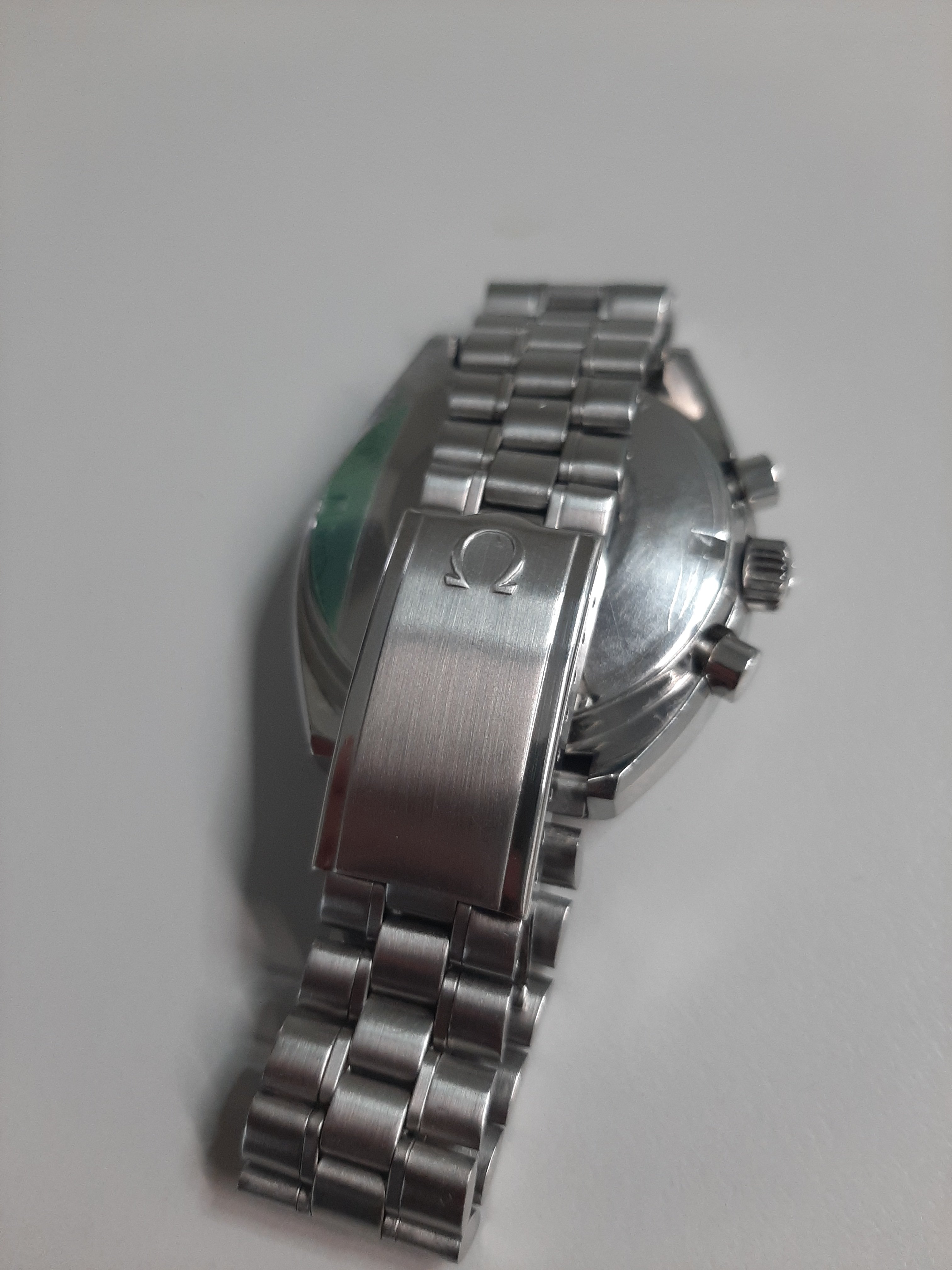

The pic shows how a nice 1116/148 looks like.
Pic courtesy @ewand here on OF:

The early Mark II Speedmasters came with the 1116 bracelet with 148 end links. I checked with Omega and this is correct. They also came on other models too like the Jedi but for anyone who thinks theirs is incorrect, this is not the case. 148 end links are 20mm as is the lug wodth of the Mark II
