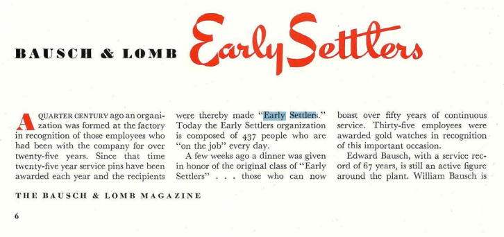

Nope - the first Omega automatic movement was introduced in ~1943, and Tritium not until 1961/62 or so.
6
hmm, do you think they added the back case inscription to a newer watch?
13,493
31,814
Likely a start date, watch is from the 1960s.
25 year retirement I suspect.
6
Oh wow that’s amazing that you found that reference. What’s a watch like this worth
2,587
3,883
Looks to me like this person started at B&L in 1941 "class of 1941" which could mean it was presented after 25 years to this person around 1966. 1966 is in the relative time period for the dial style and having an automatic movement. Not that the watch was made in '41.
