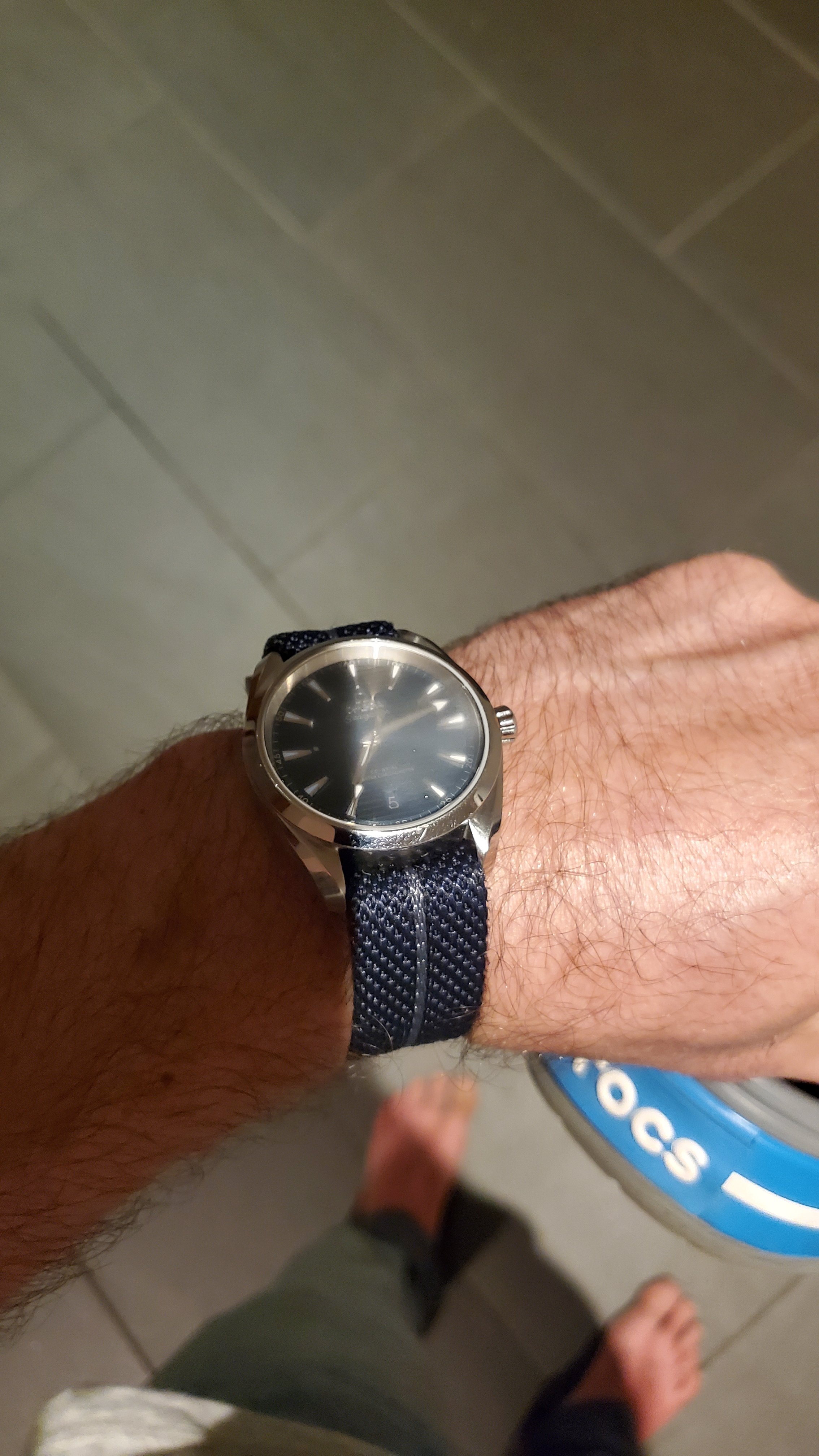

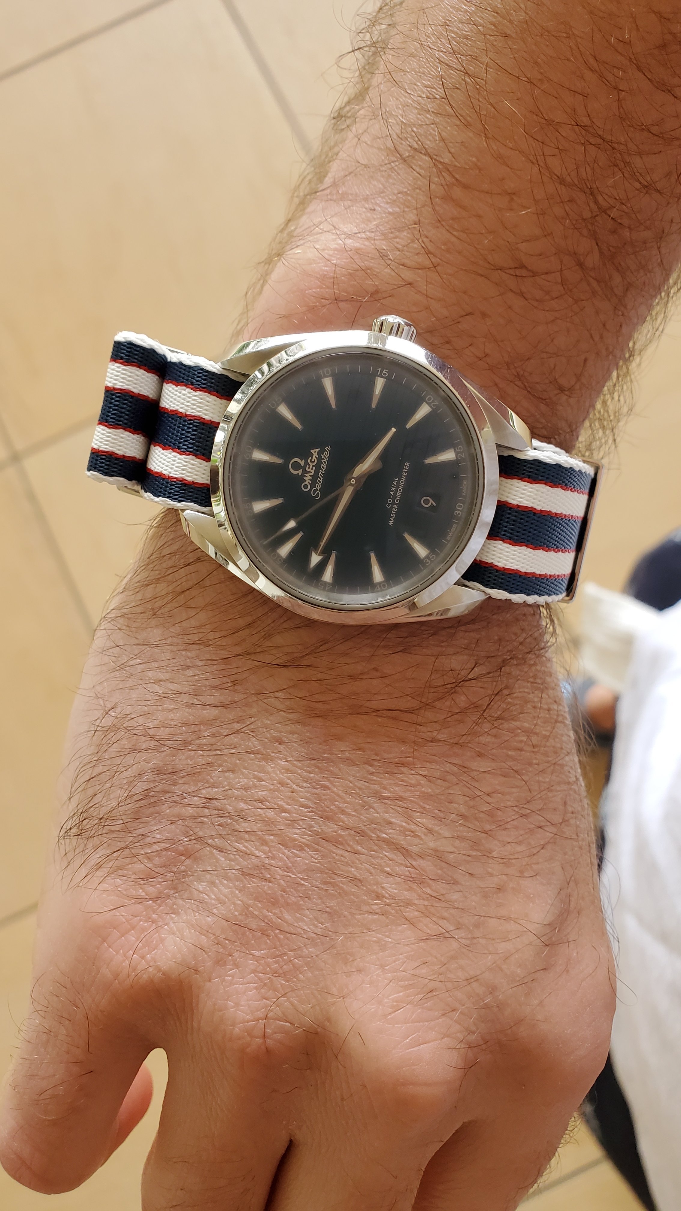

My name is K. and I would like to share my story of buying and owning an Omega Aquaterra watch.
For many years I was a watch lover and dreamed of buying something from Rolex or Omega. And now, later in 2020, I was able to collect the required amount and bought a watch in the WorldofLuxuryUS store, which I found on chrono24.
For a few years the watch was fine. I really like the watch, they are aesthetically very well made. The watch is suitable for all situations and has supplanted every other watch in my set. I am sure that Omega makes the best watches in terms of price-quality ratio.
But in 2022, the date began to switch incorrectly in the watch. I found an official Omega service center, and brought the watch and a plastic warranty card there. The service center refused me because the warranty card was not filled out. Yes, for some reason, the store was not WorldofLuxuryUS, but Joyce's Jewelry was indicated on the map and the warranty card was not filled out.
I called the WorldofLuxuryUS store and they told me to solve the problem with the watch myself.
Then I wrote a letter to Joyce's Jewelry. They were surprised at such an error with the warranty card, but to their credit they agreed to take the watch for repair and asked to send it to them (Thank you, Zach for your patience and understanding!)
After about three months! The watch was returned for repair, but there was garbage under the glass and I had to take the watch back to the service, but with the warranty talent filled in, the watch was accepted to fix the problem. Three weeks later, the watch was returned, I quickly noticed that the clock was running rather inaccurately, about + 7-8 seconds per day. I took the watch back for service. After a couple of weeks, the watch was returned and they said that they had fixed the problem (it seems that something with an amplitude).
After a couple of days of wearing it, I realized that the clock was still not accurate enough. I took the watch back for service. After several days of checking, I was told that the accuracy of + 7-8 seconds per day is normal, and that the guaranteed accuracy implies an average value, they advised me to put the watch in different positions at night. I decided to put up with it and really noticed that if you put the clock face down, then the accuracy of the watch became better.
After that, I went on vacation to Hawaii. On the very first day of my vacation, the watch got very fogged up after I went to the supermarket. The crown was screwed on tightly. I have not been to a bathhouse or hot tub. I unscrewed the crown to let the moisture out. But it did not help. A few hours later, already in the hotel, I completely pulled out the crown and after a few hours the moisture evaporated and did not appear again. Just in case, I want to say that with all the things that I own, I handle very carefully.
On my question to the service center, I was again told to bring the watch for verification. This will be the fifth time in three years. Here is such an experience
Conclusions: in my opinion, Zack from Joyce's Jewelry and boutique manager Joshua showed themselves worthy. The Omega company itself behaved very indifferently when I wrote and tried to find out if it was possible to replace the watch with another one. Had a better opinion of them. By the way, during all this time I managed to buy another Omega Railmaster (I don’t know why I did it. I really regret it)
I work in the service industry and I know that my future depends on my reputation and, accordingly, if my client is dissatisfied with the quality of my work, then I always eliminate my mistakes at my own expense and am very surprised why Omega does not do the same. Yes, the watch was bought in an online store, but the warranty card is real, the watch was registered on the official website, the warranty is still valid. Of course, everyone has the right to make a mistake, but in my opinion, if the watch has already been repaired several times, then Omega could replace it for free or with a small surcharge.
But anyway, I just wrote this to share my experience and to let future Omega watch owners know that this can happen. Personally, I most likely will sell both of my omega. I won't buy Omega watches again. Most likely I will buy something from Tudor or Rolex Explorer. Well, the advice is not to have high expectations from expensive watches, from service. And try to buy directly in the boutique, and not on the Internet.
PS. Early rejoiced at the disappearance of moisture from the watch. After a few days of break, the moisture reappeared. And just an hour ago, a Starbucks employee complimented my watch
P.P.S. Sorry for possible errors in the text. I use google translate because my english is in progress
And also I will be grateful for any advice. Sincerely, K.
