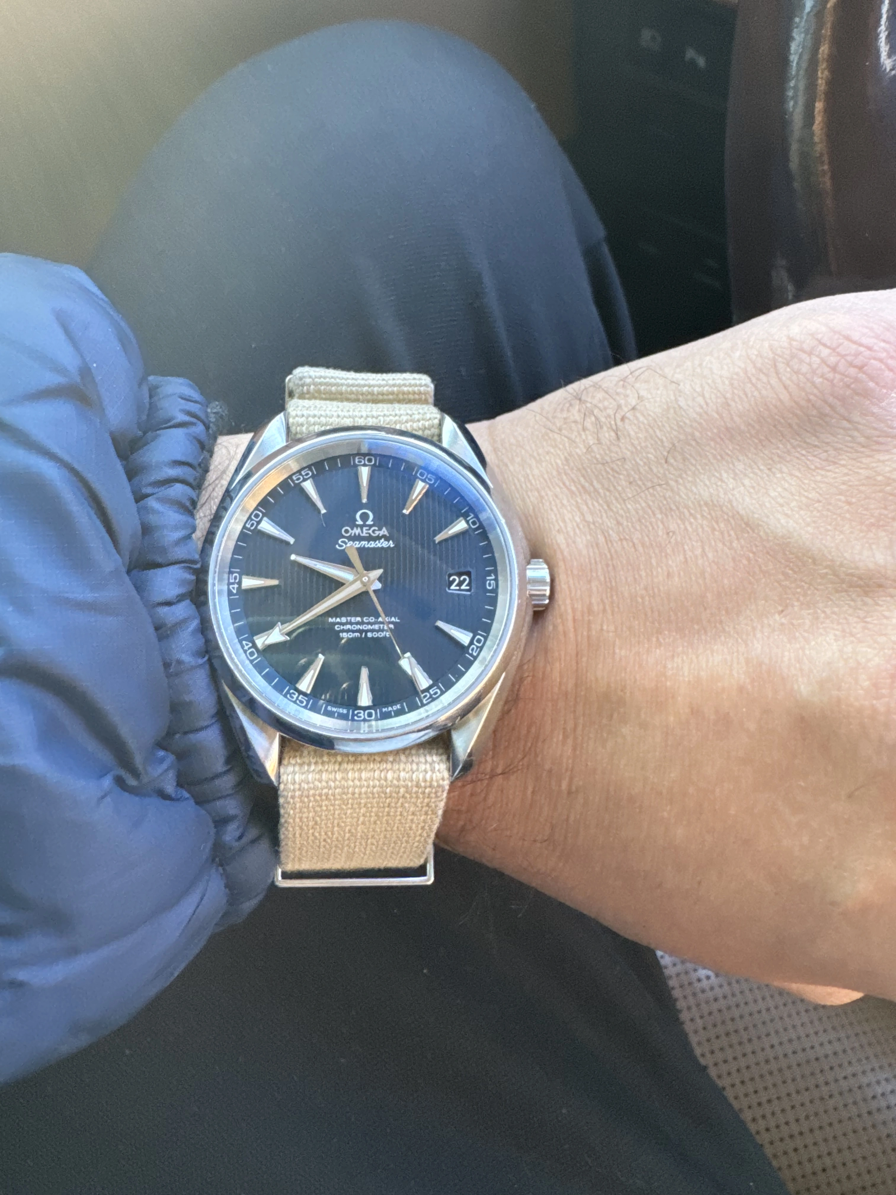

Hi!
I have the omega aqua terra 41mm with the blue teak dial.
Ref -220.10.41.21.03.004
I wanted to buy the new Shade watch mainly because of the the bracelet (President style).
BUT - recently i found a reddit post that someone said he did buy the same watch as i have and the AD did put the shades bracelet on the blue teak dial(same reference). I do know that the 38mm does fit the new bracelet
Anyone tried it?
I cant see any other info about it elsewhere.
Thanks!

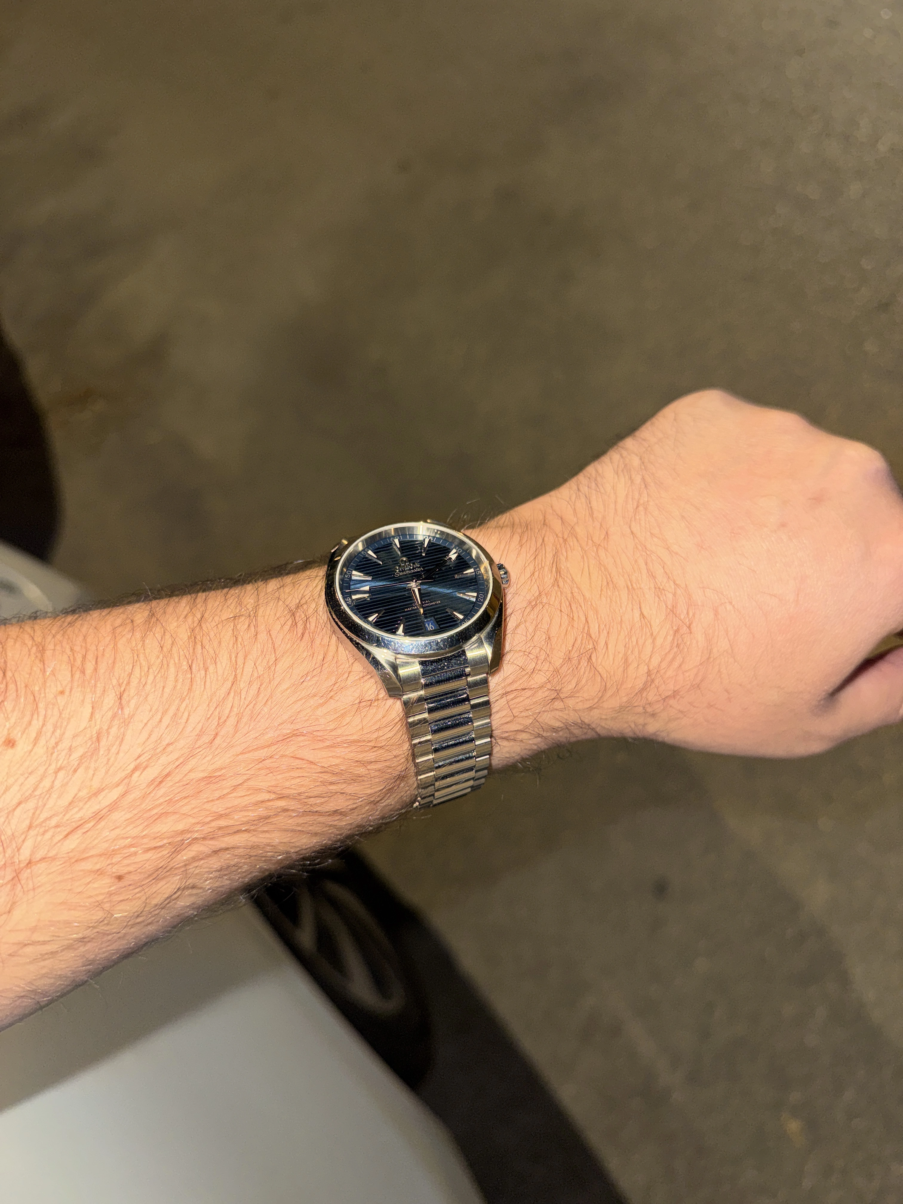

Now, the question is if it fits this one. Because I鈥檇 love a president for it
13
13
I really dont know 馃榾
But i used the old end links for the new bracelet and i just need to fix the first link it wobble a little bit but its an easy fix

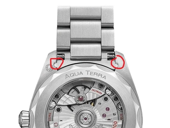

If that's the 38.5mm AT, the answer is yes but with a caveat. You would need to sand or grind down the little tabs that stick out on the side of the end links so the end links can fit. Then it's wise to use a small piece of double sided tape between the edge of the end link and the side of the case to keep them from wiggling. I've done it for my 38.5mm Skyfall. It looks perfect. You just have to be comfortable permanently modifying the end links.
