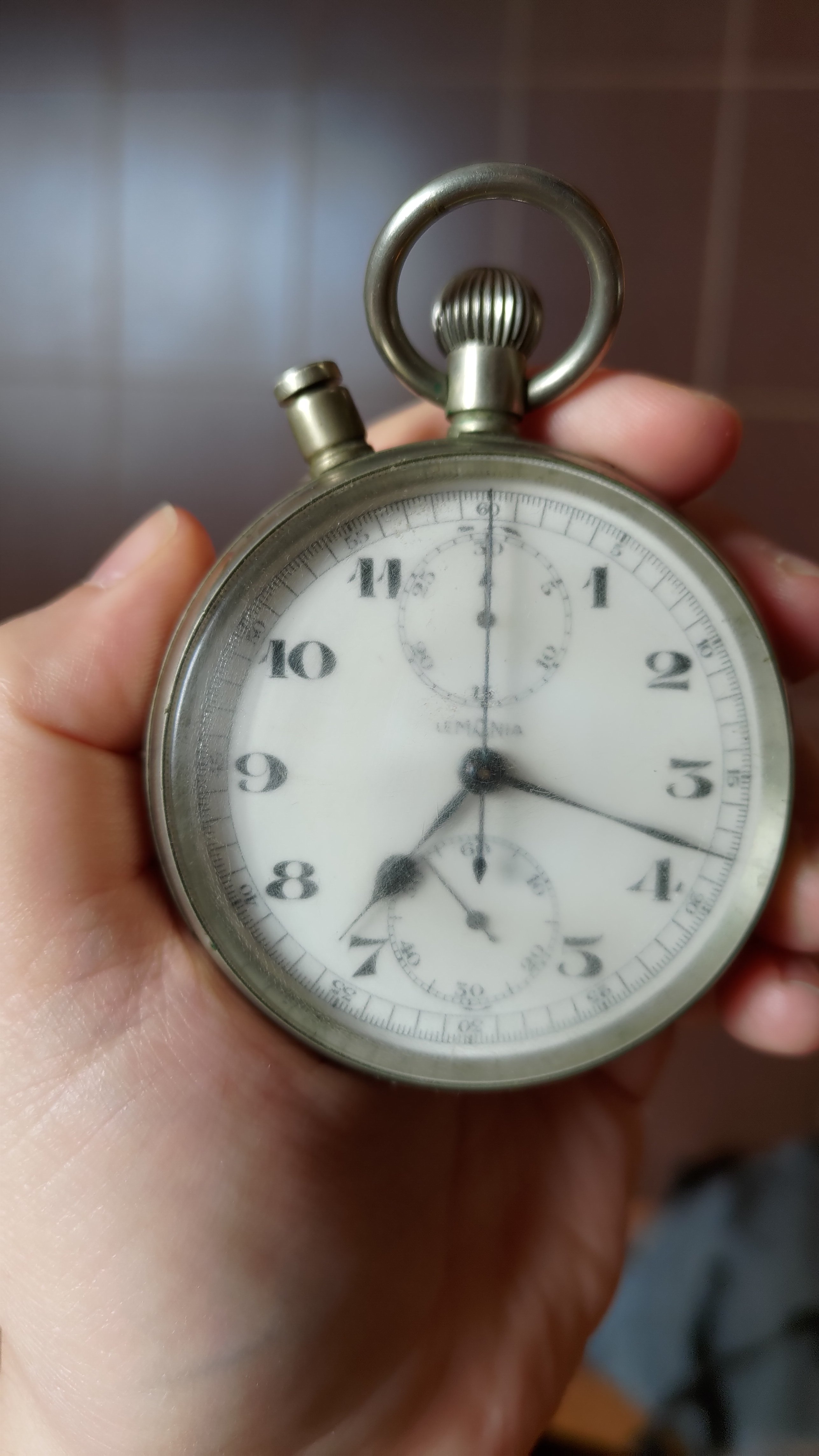

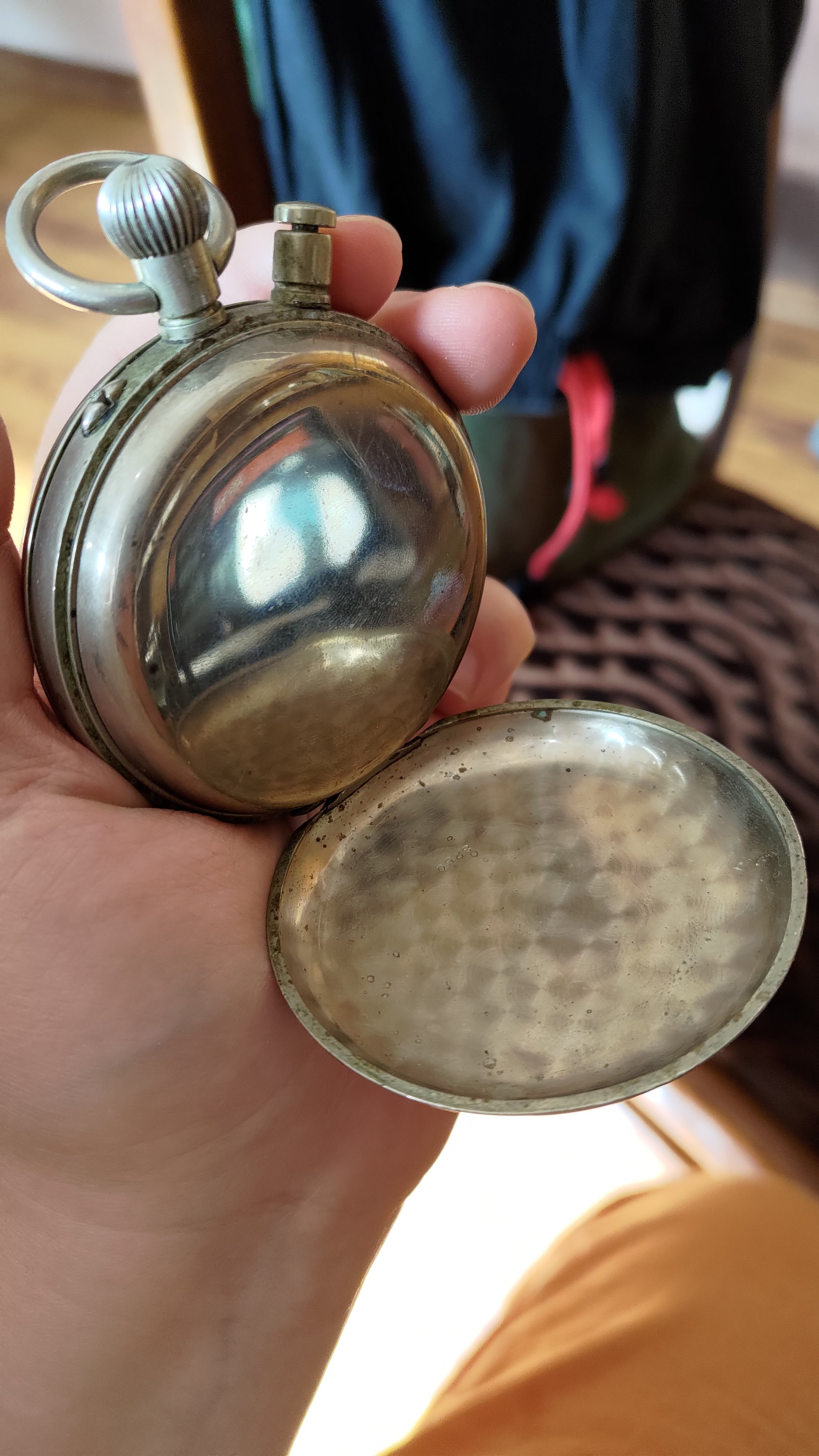

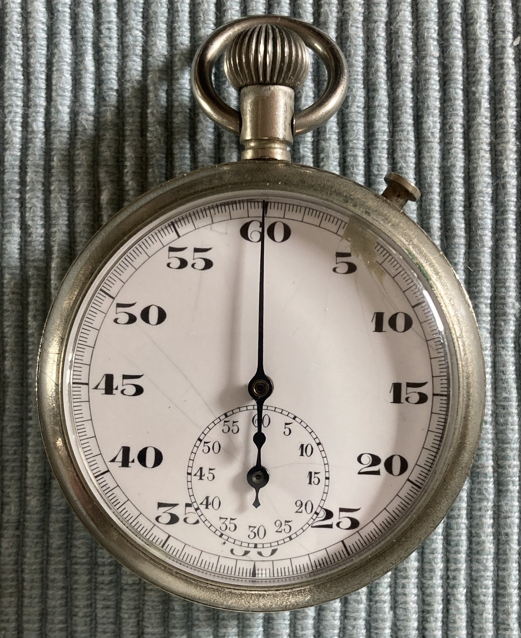

Hey! Could anyone help me in identifying this ones? I've got it from my grandfather and I think he got it from his grandfather or father, I don't remember and can't ask him anymore... It seems to be old, but I don't know the year and I don't find identification marks on them. Thanks!

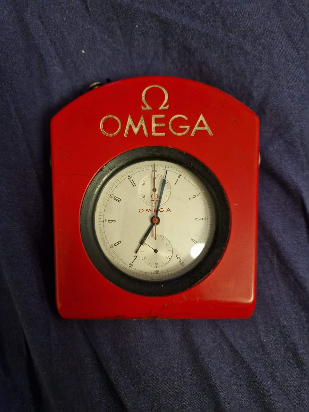

New addition to the family. It cost me the princely sum of £28 on eBay. I haven't opened it yet.

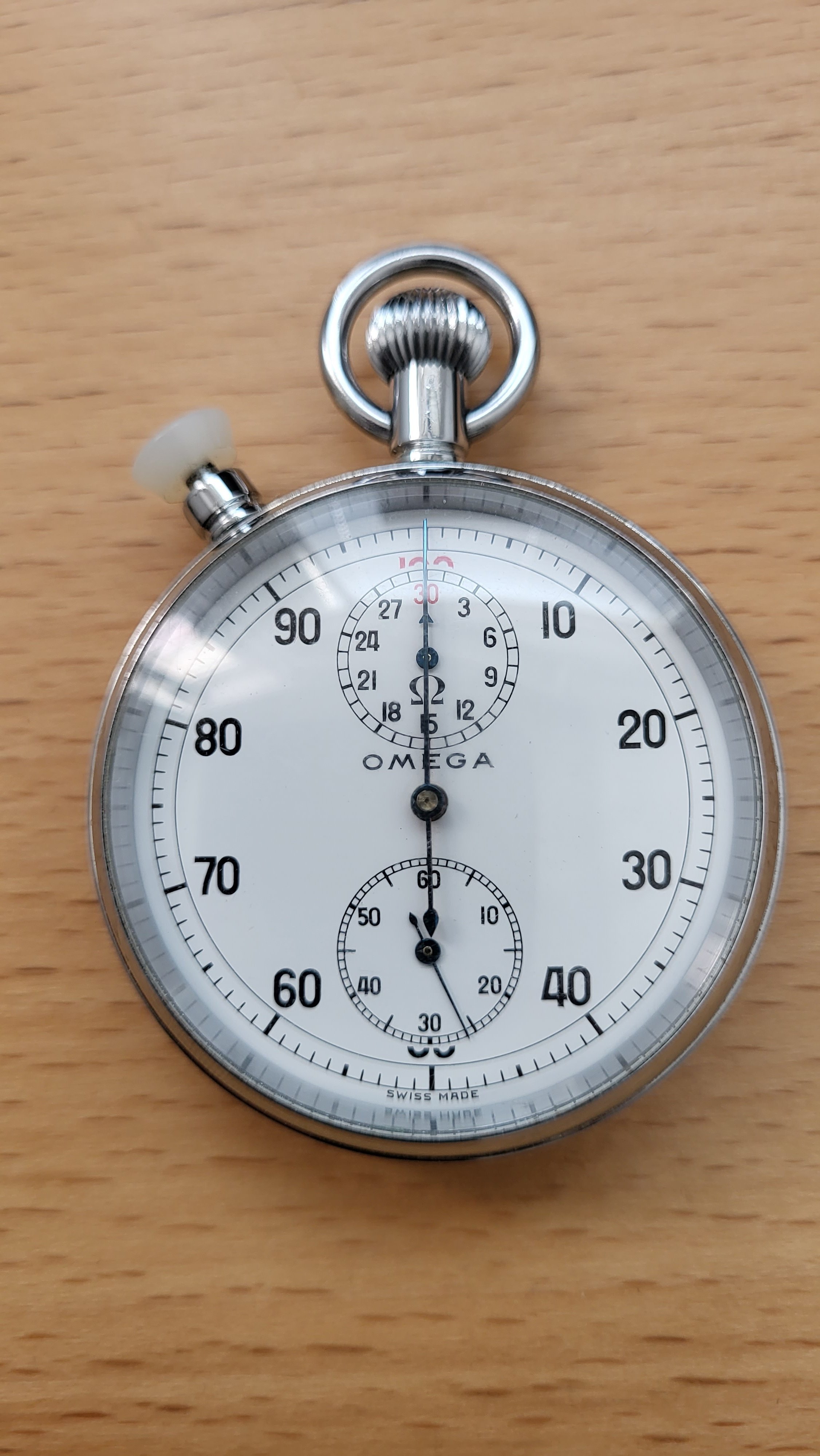

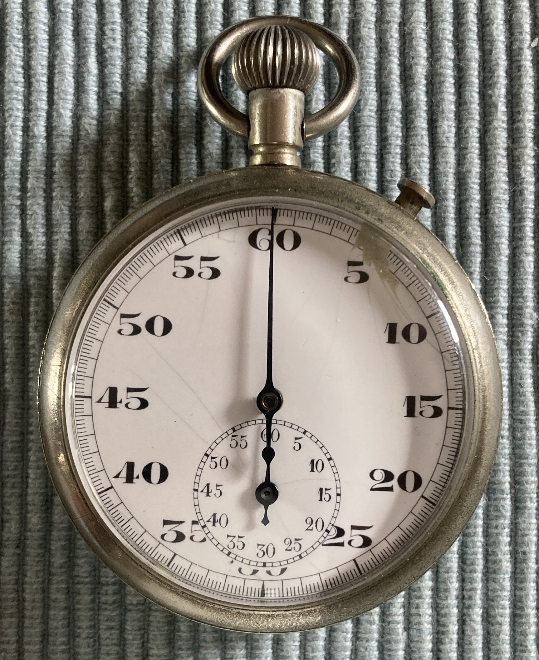

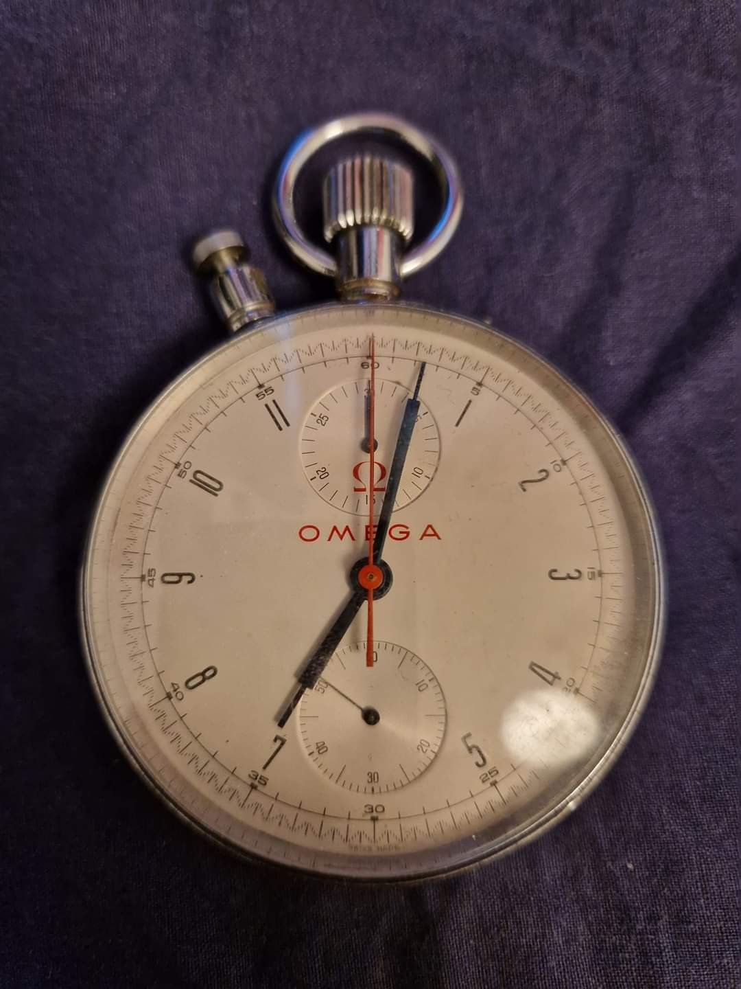

Hello!

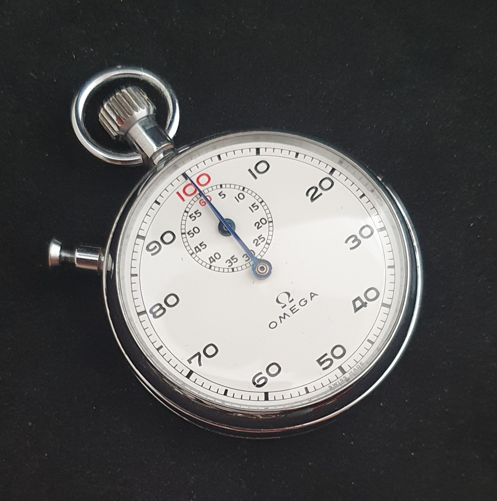

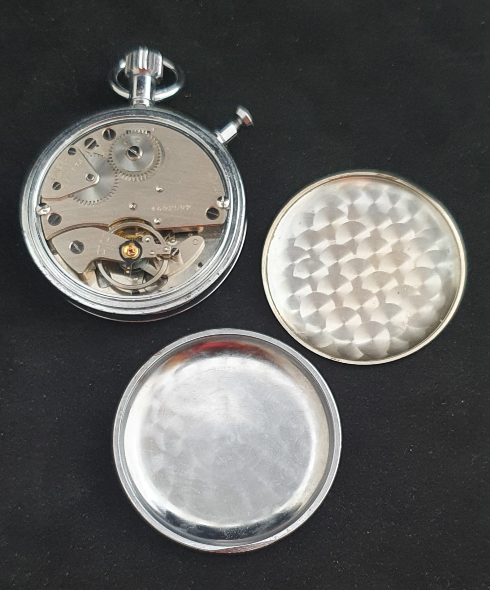

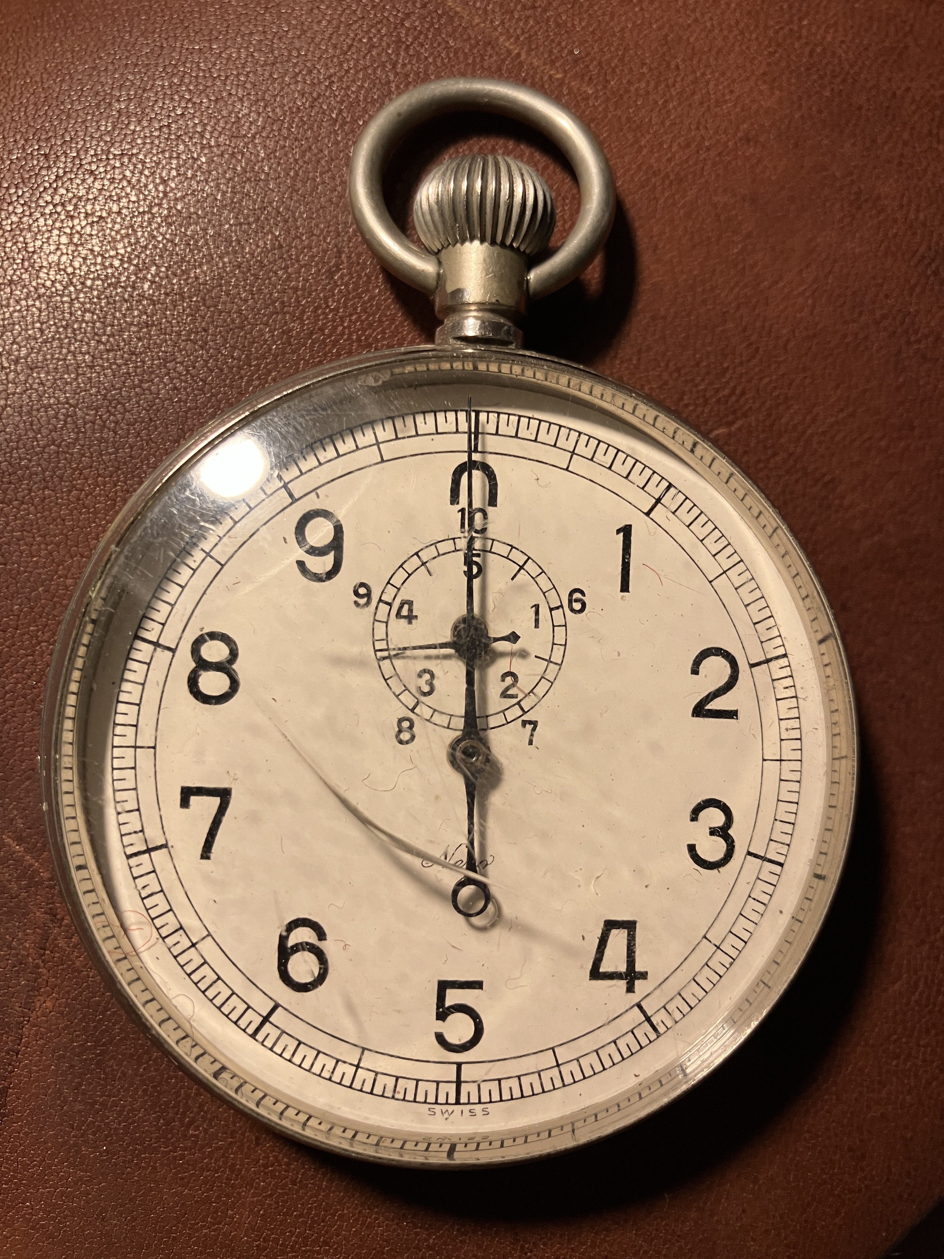

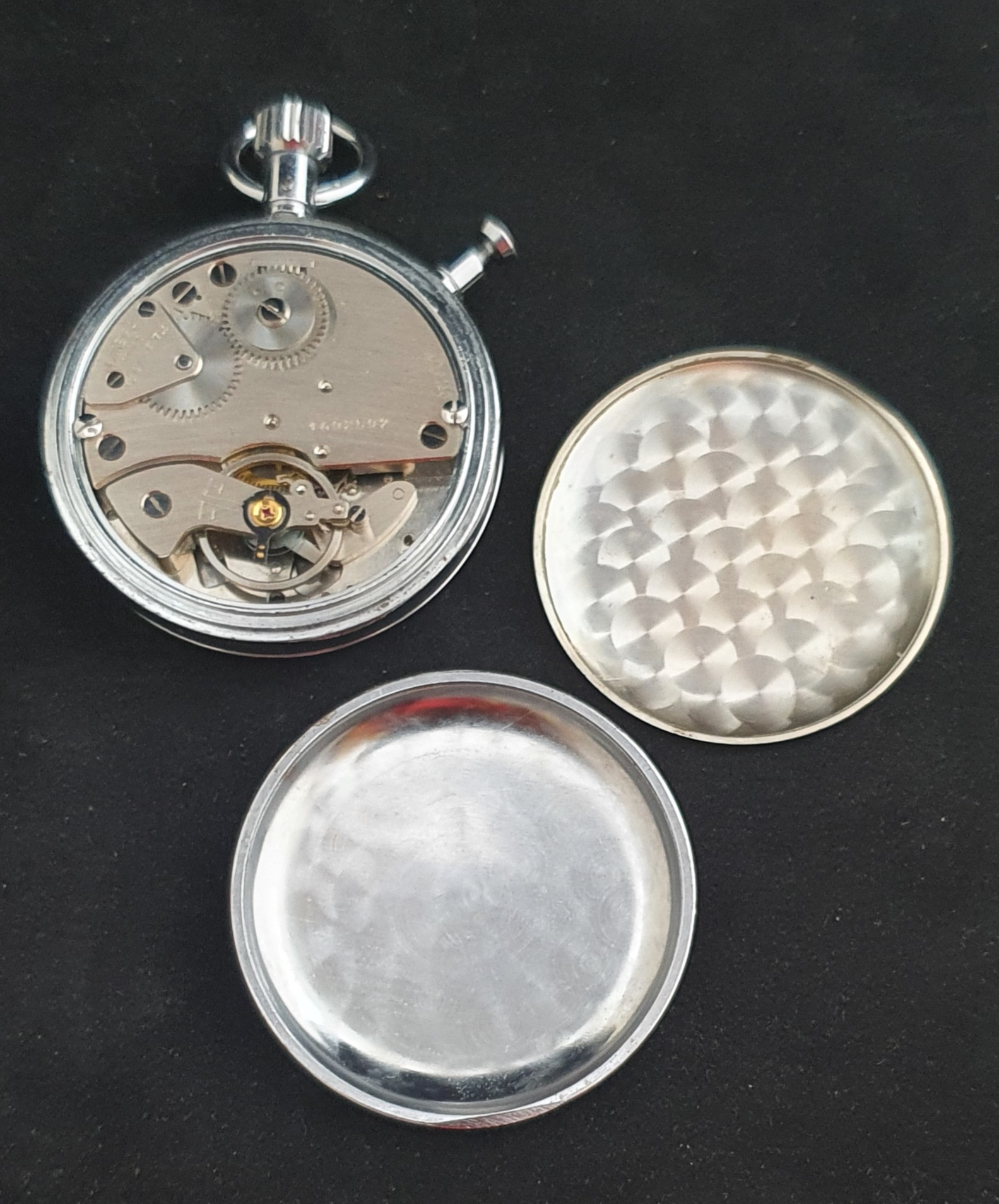

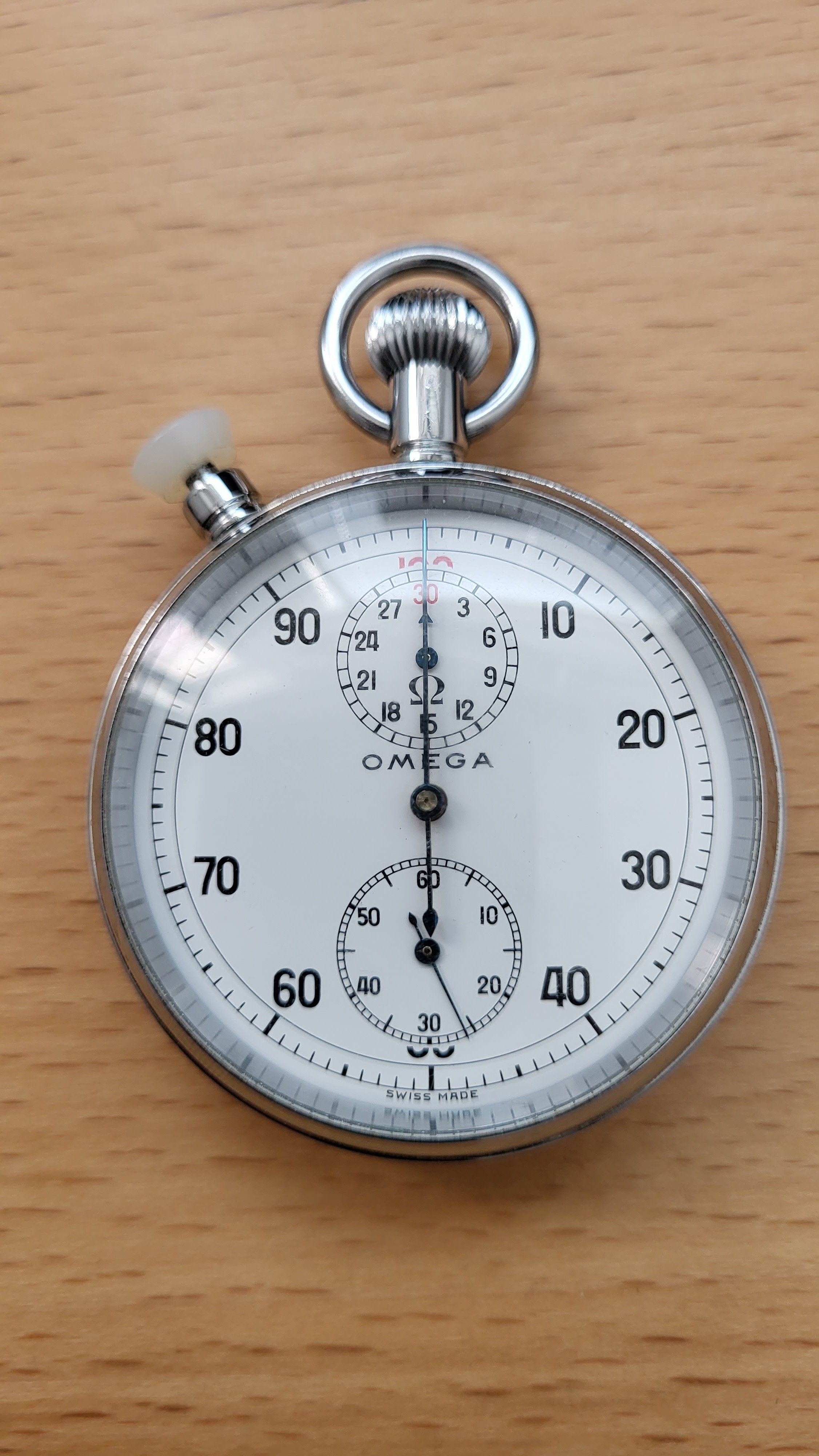

My father gave me this Omega Stopwatch many years ago. Had totally forgotten I even had this one. Does anyone have any information what model etc. this one might be? Haven't opened it yet as I do not want to damage the casing by prying it with a screwdriver etc... It ticks just fine after rewinding, but only dial that is moving is the lower smaller dial.. ticking one revolution every 1 minute.
2,781
4,706

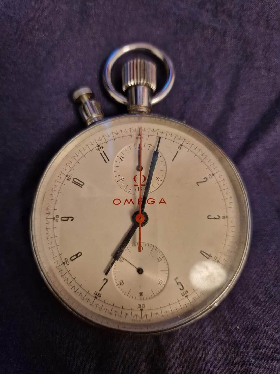

Hello!
I have a few Omega stopwatches and although different to yours one of the has the separate pusher.
In the case of mine it has a pair of second hands one of which is stopped by the pusher to give a reading and restarted by the pusher without interfering with the timing of the other hand.
So my guess is the pusher function is to do with getting a reading in the 100ths of a second and given the the outer dial is in 100ths of a second I think that it’s rather pointless to have that hand wildly spinning so I would imagine that hand should only give a reading when stopped. I’m thinking that you start timing by pressing the crown and the seconds hand in the lower sub dial starts and to stop the timing to read the results by pressing the crown again, and reset by pressing the crown. The pusher is used to stop the watch to read and pushed again to continue timing without resetting.
That’s only a guess on my part, and I’m sure someone will be along soon to correct me :whipped:.
I suggest you try various combinations of pressing the crown and pusher and see what happens.
When the lower seconds sub dial clocks up a full minute does the upper dial indicate one minute?

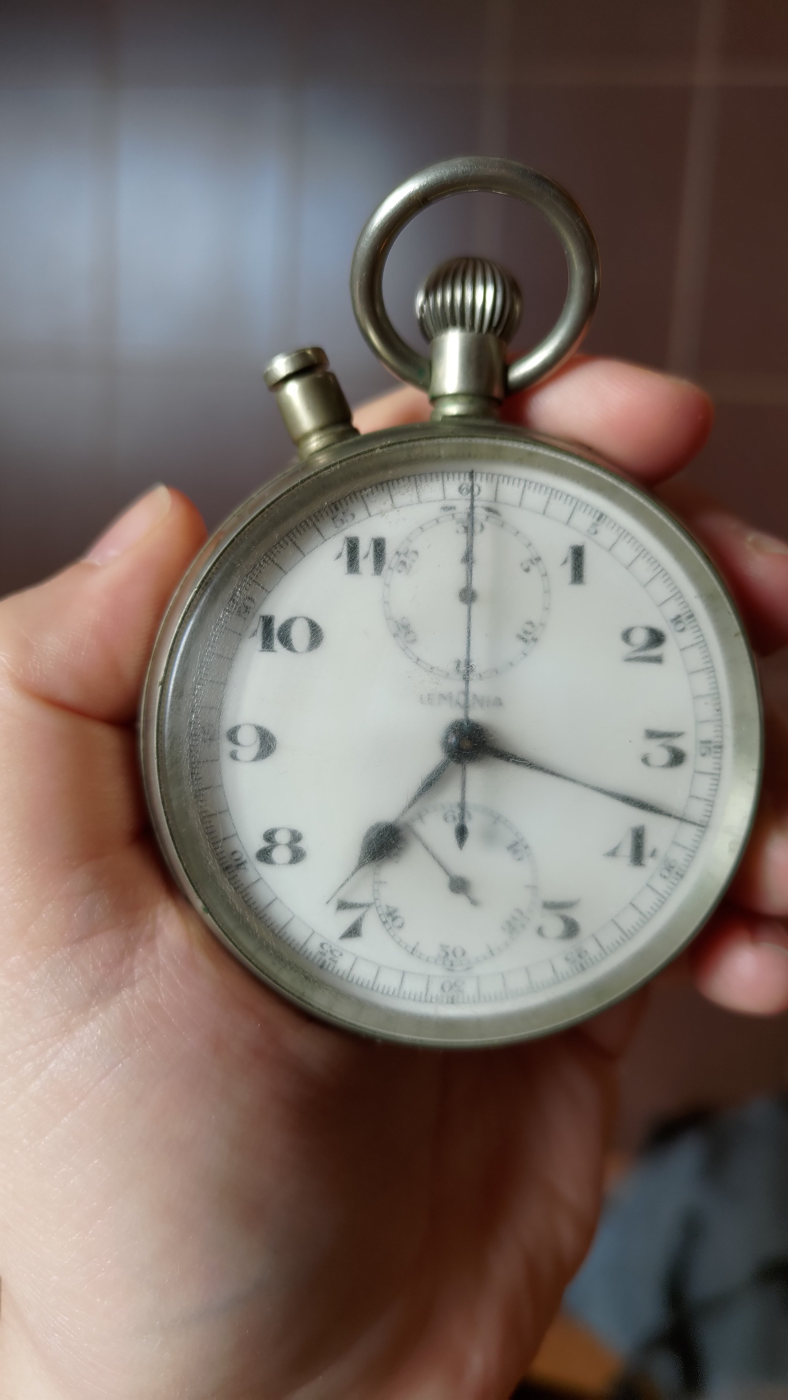

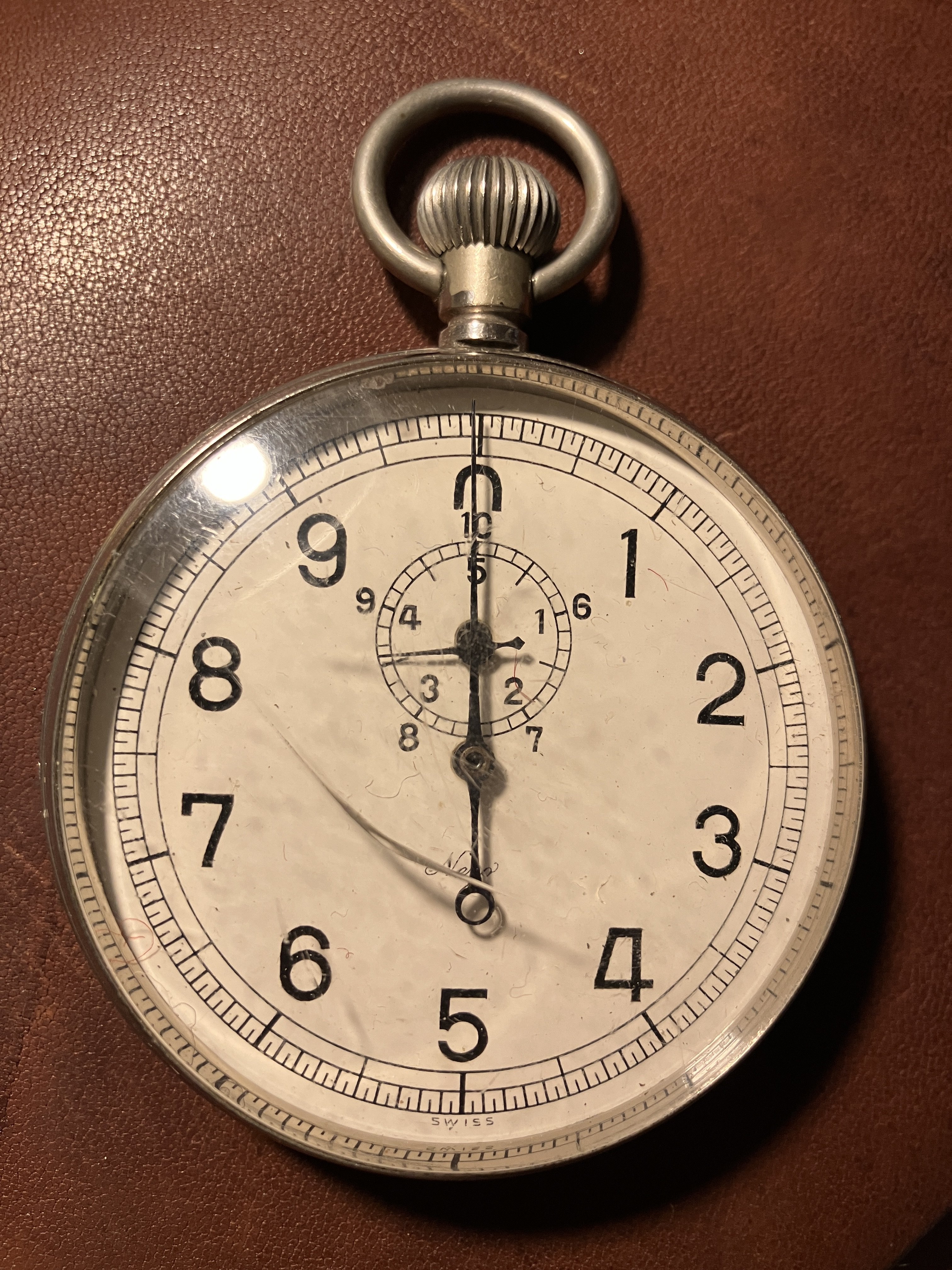

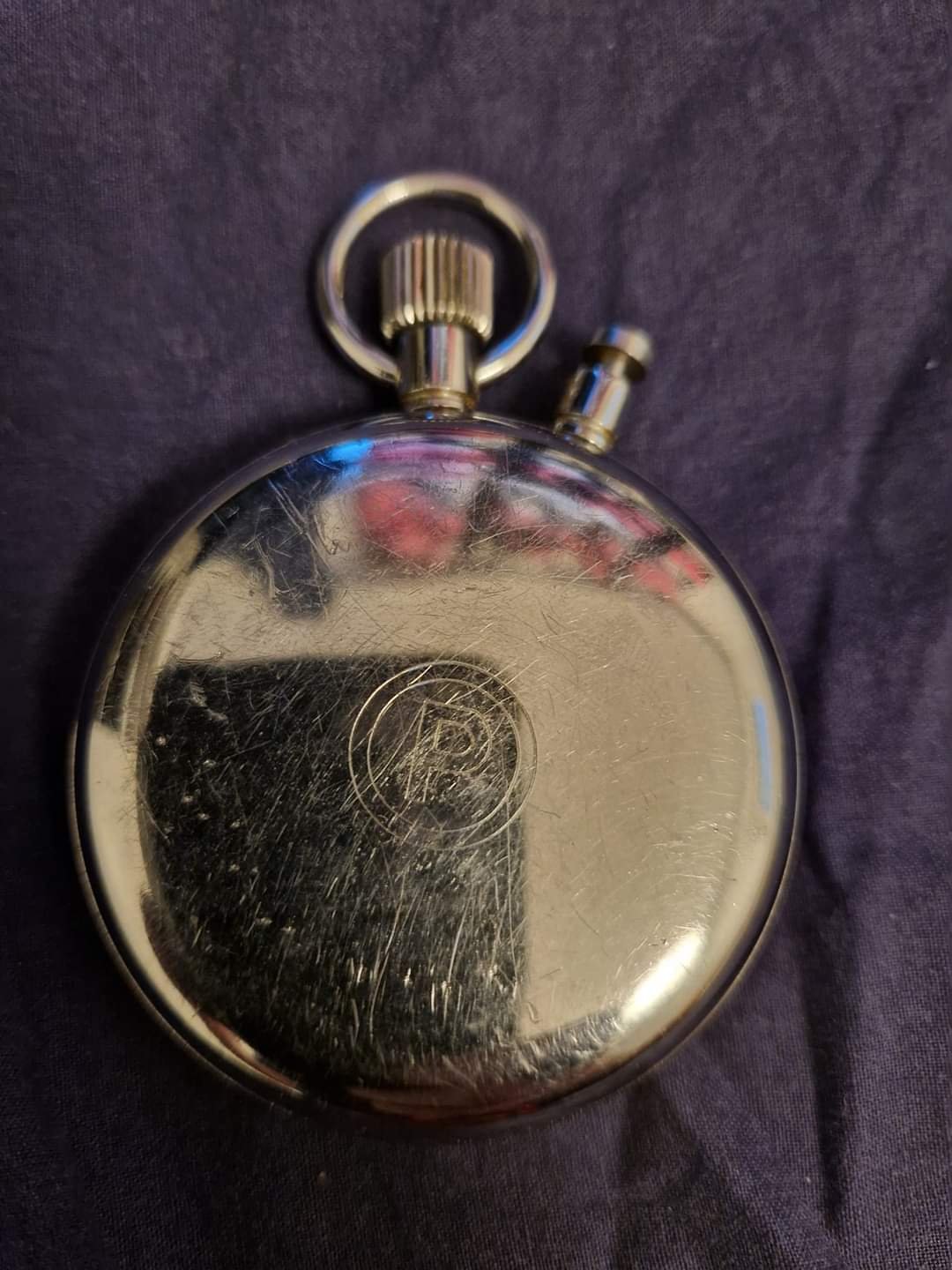

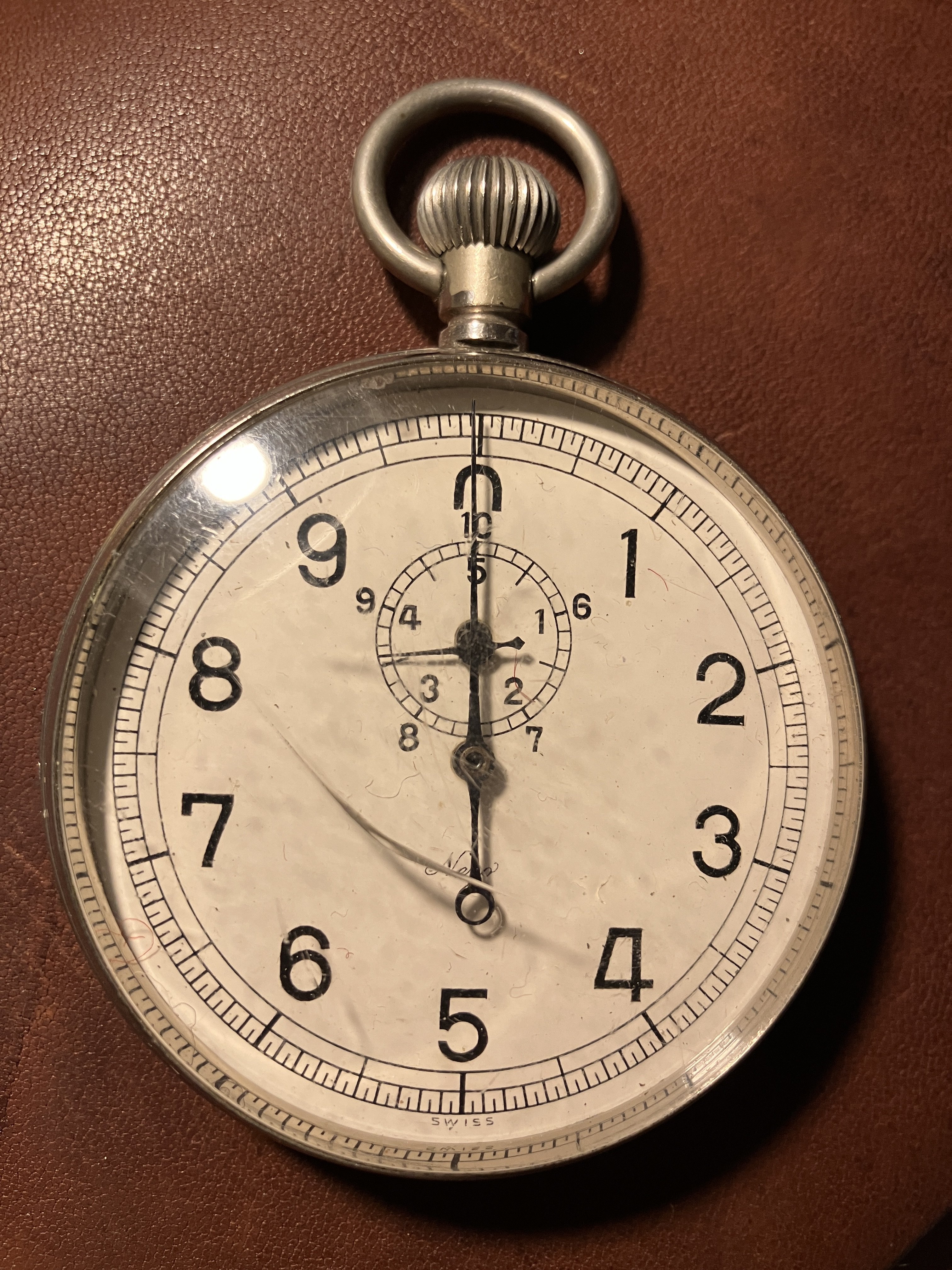

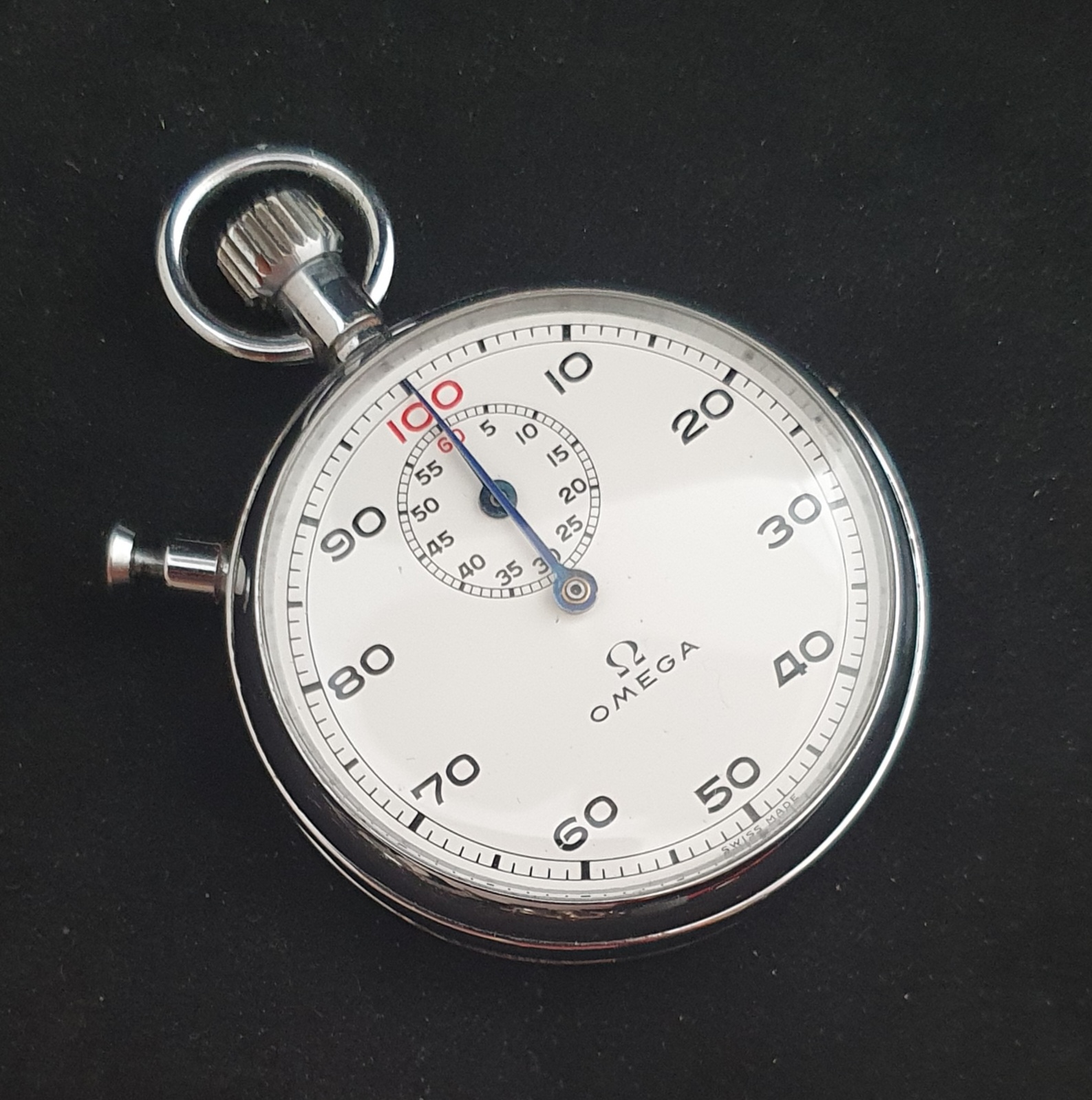

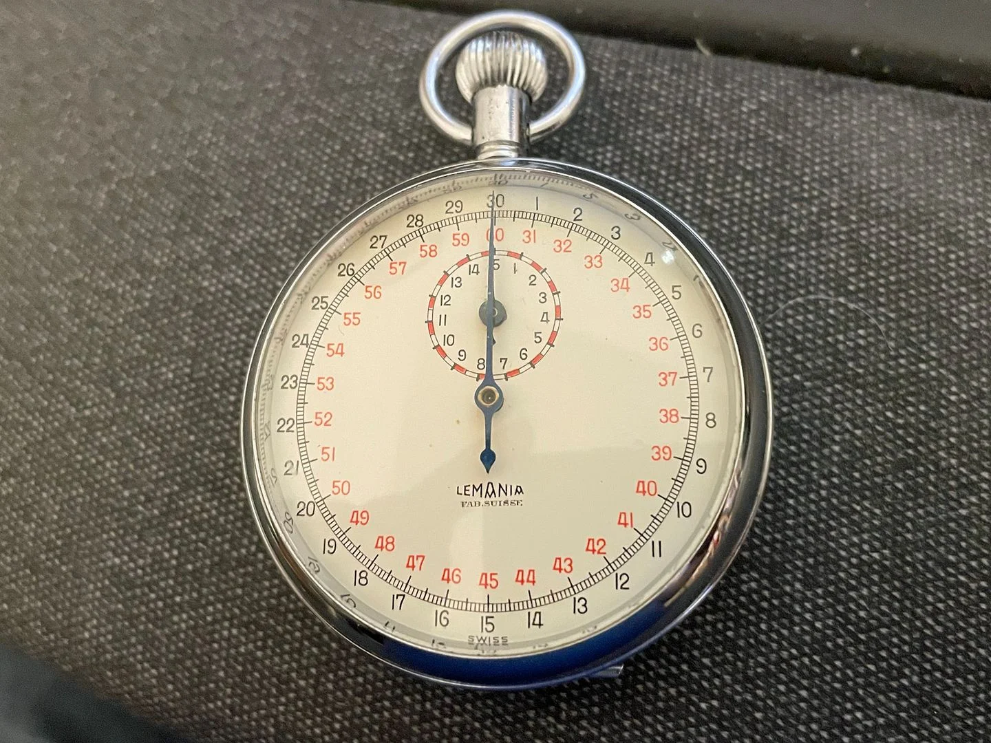

How about this one? Any information anyone? Any ideas what does that p-letter stands for? Thank you for replying!

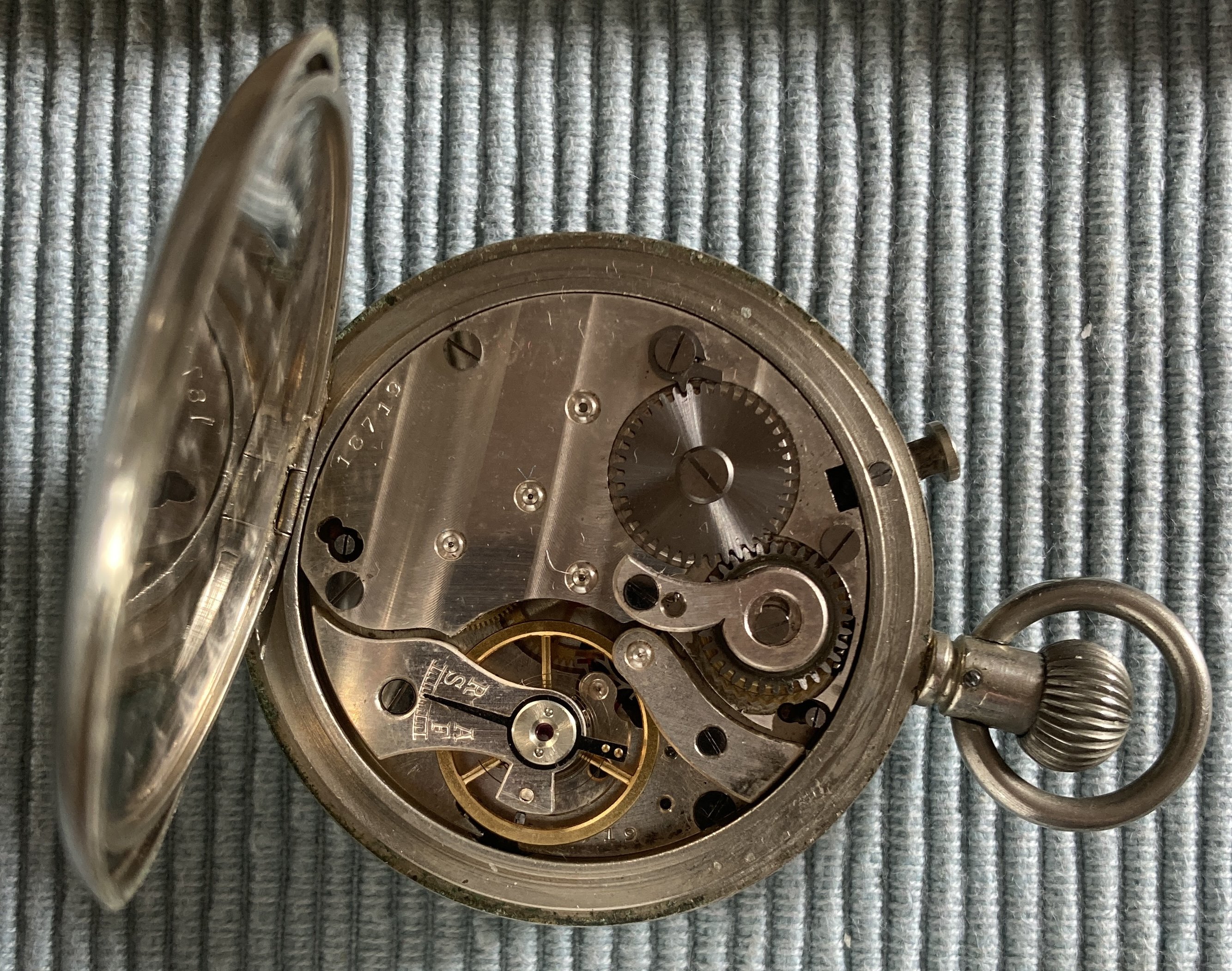

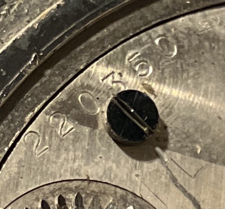

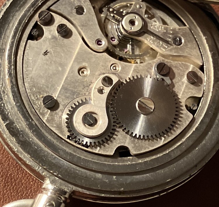

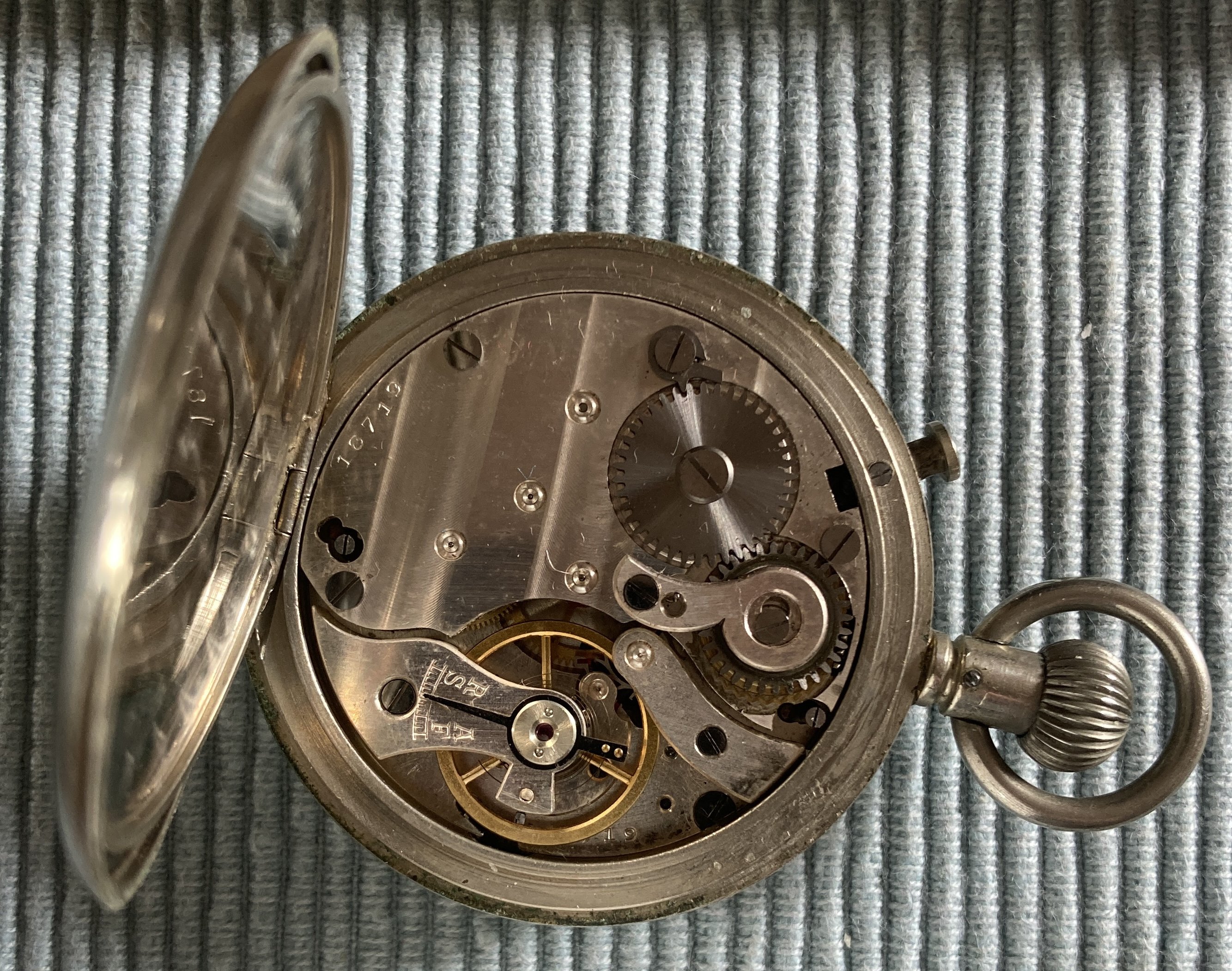

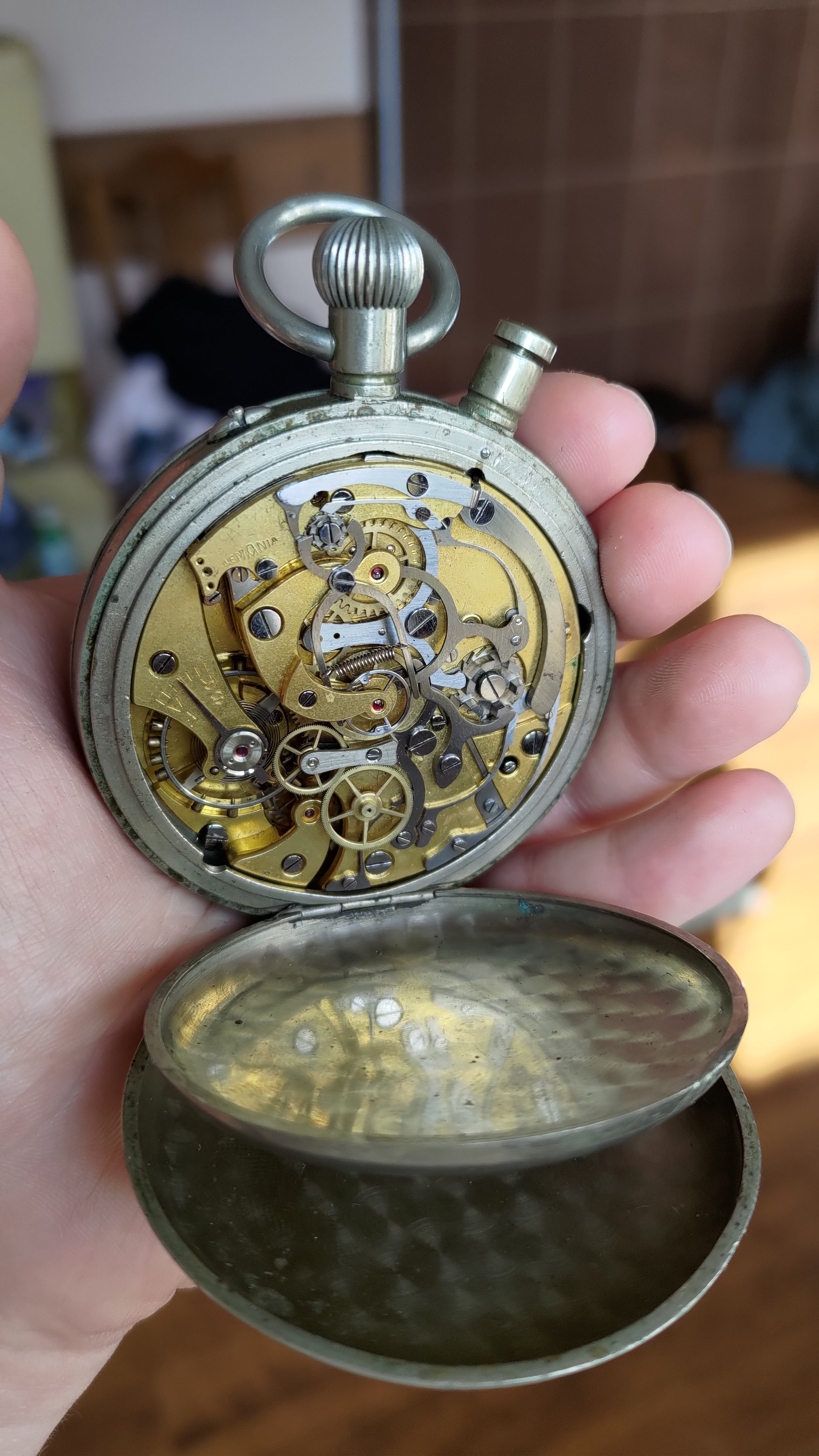

I wonder if anyone can assist me with this anonymous stop watch that recently wandered into my sticky mitts. The quality, shape of the bridges and crown wheel configuration lead me to think it might be an early'ish Lemania movement, it has nice Geneve stripes. I haven't had the dial off and only numbers on the movement are 18719 under the balance and on the barrel bridge. No markings on the case other than a different number on the inside of the outer case back. I haven't seen many Lemania stop watches with a single sub dial at 6, mostly they are at 12. Has anyone see similar or can help identify it. Much appreciated.

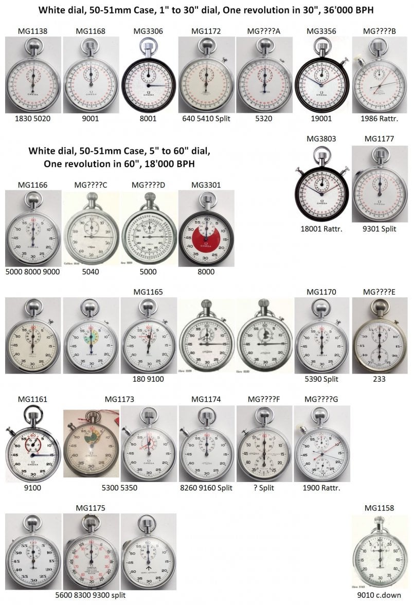

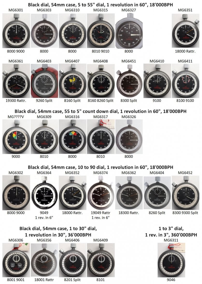

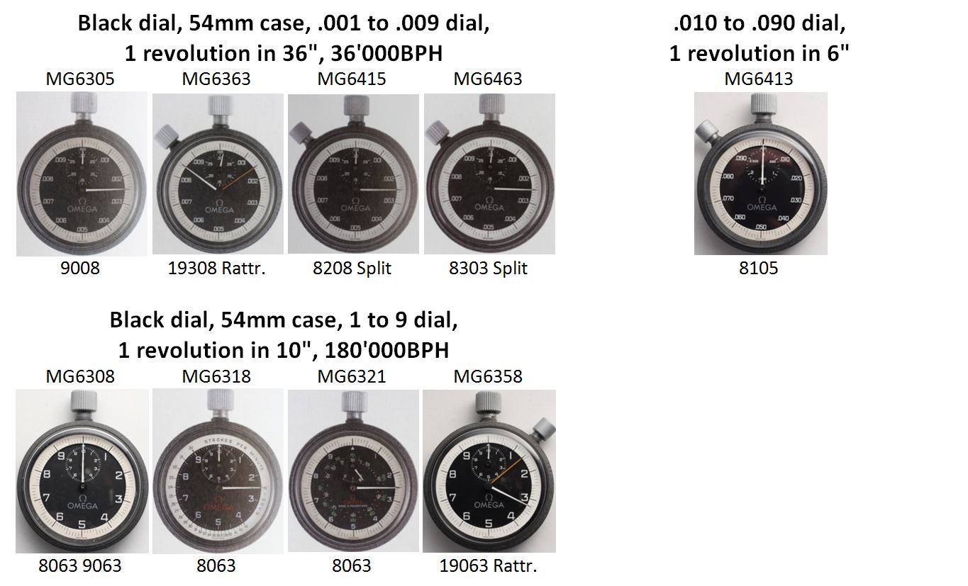

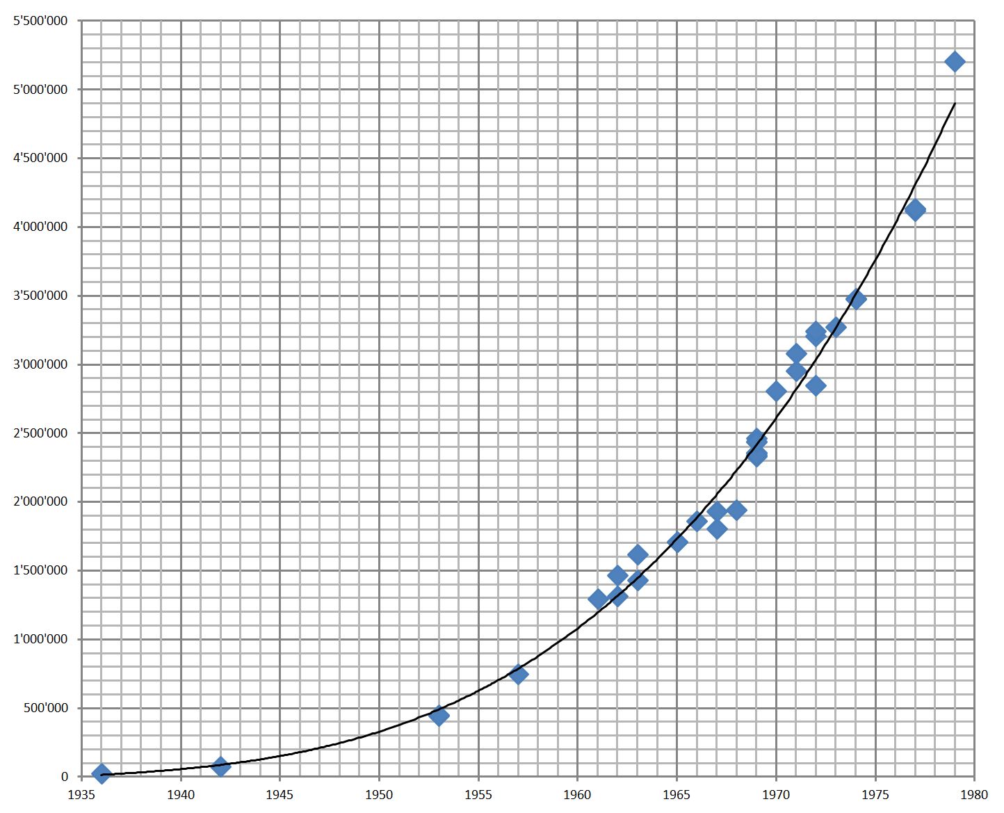

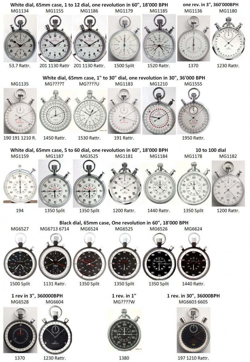

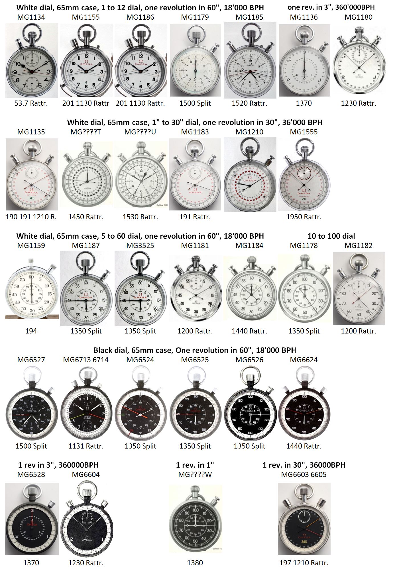

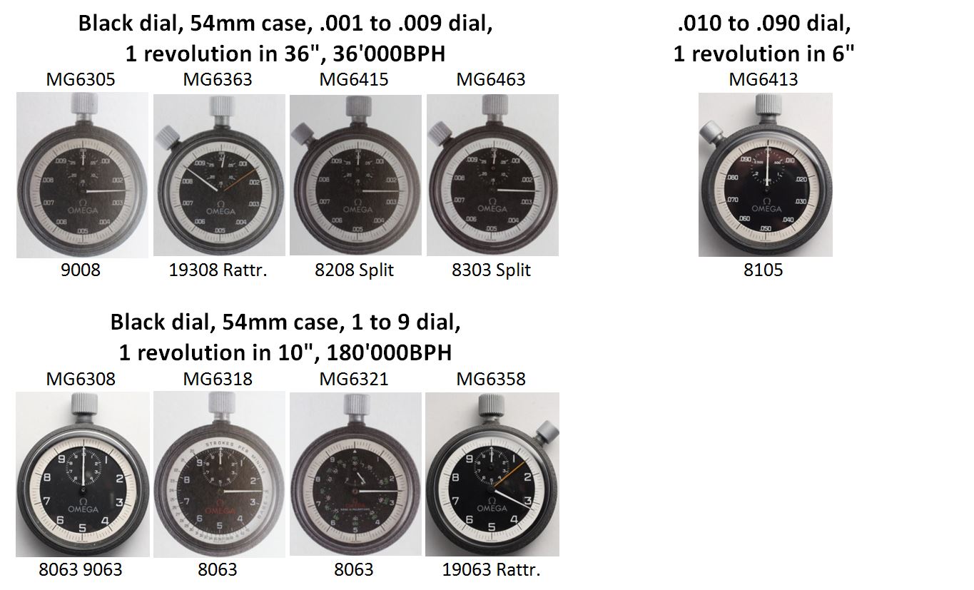

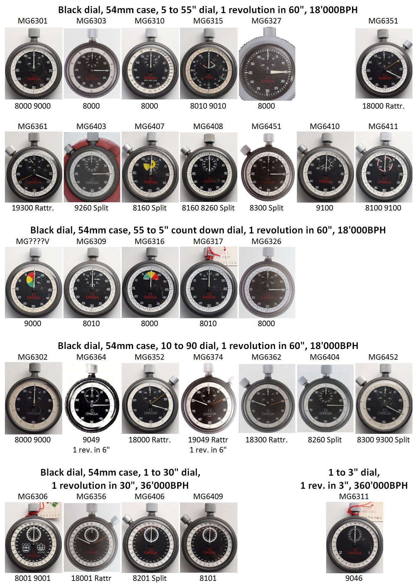

Here is the result of some compilation work about Omega and Lemania Timers. It's based on my own collection, some old Omega and Lemania catalogues and of course the Omega "A Journey through time" book from M. Richon. I'd be very happy to get more information... but it's hard to find... let me know...

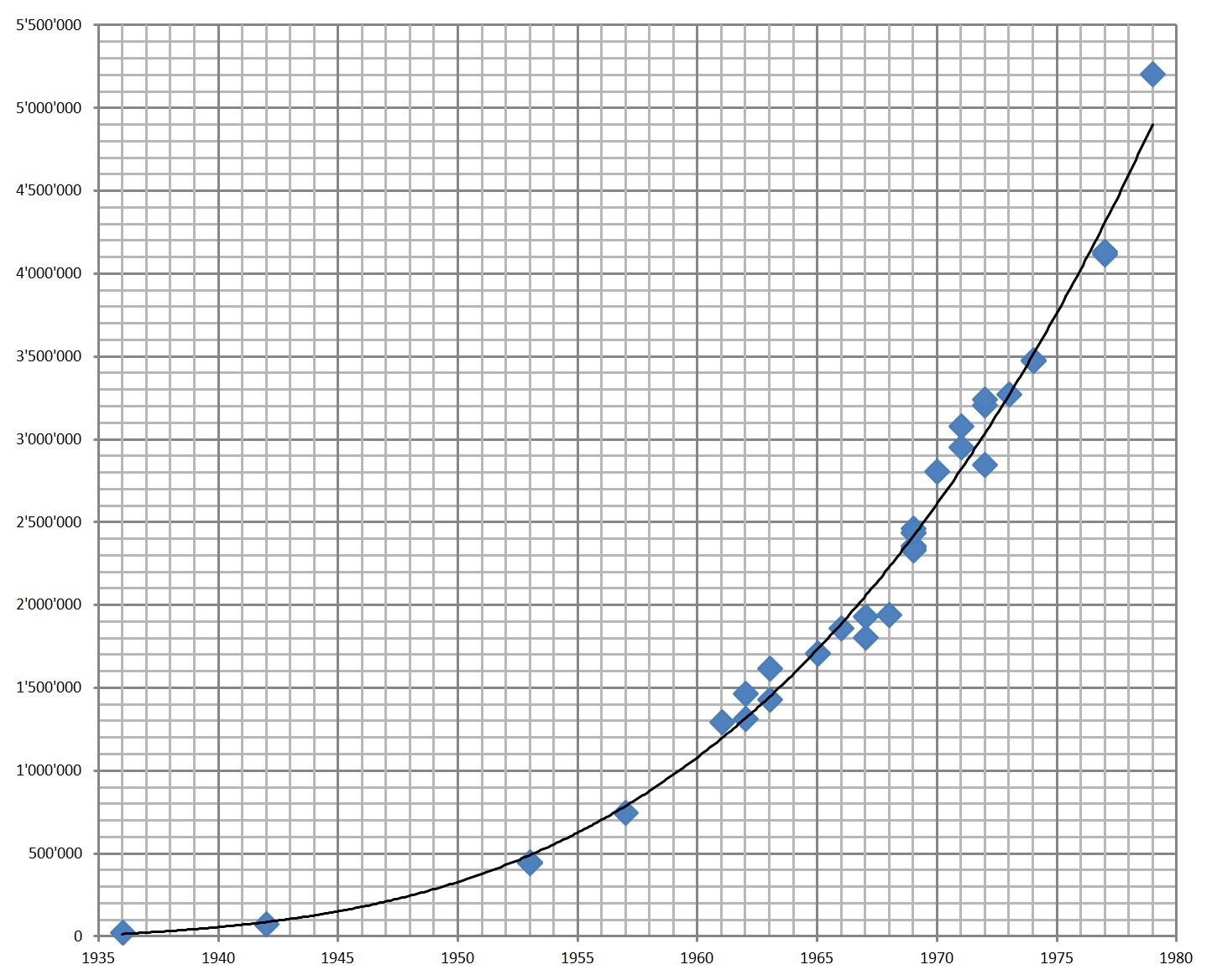

Most serial numbers on Omega Timers are Lemania serial numbers and very little is know about it as all Lemania archives were lost. Here a graph that can help to date a Lemania serial number:
** crowns changed from round to cylinder around 1962.

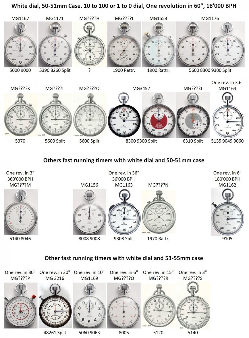

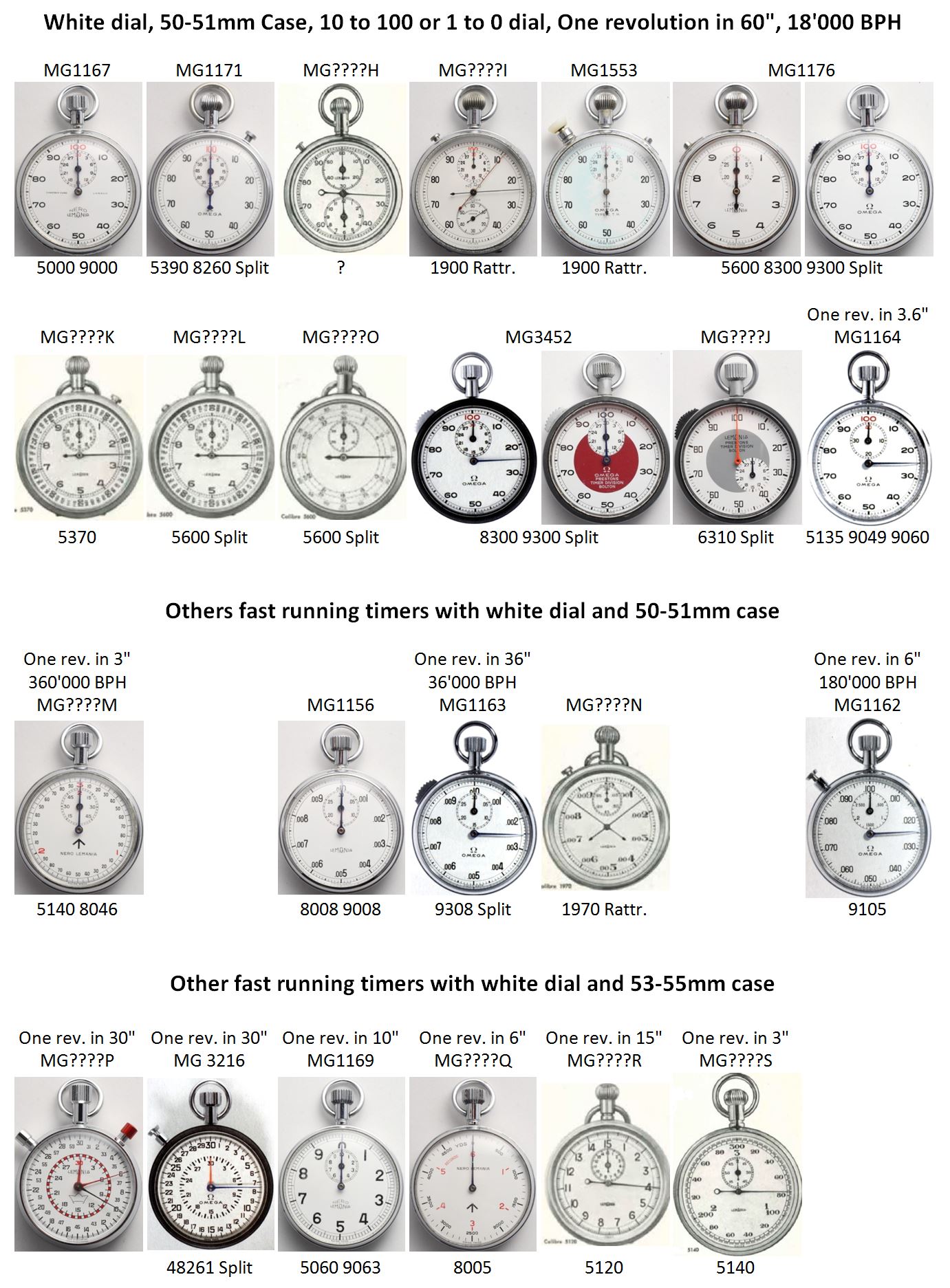

I is called MG1166 then or had it an other reference?

I keep kidding myself into thinking that I am not collecting these things, and yet here we are. This just got in.
If my reading of the table is correct, this is a ref. MG1138 model with a high frequency calibre 5020. It's a lovely piece, whatever it may actually be.

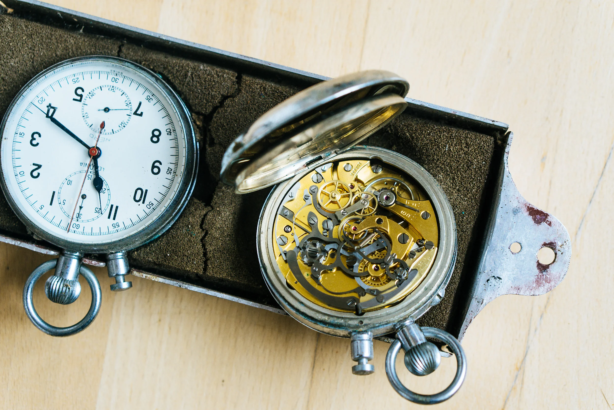

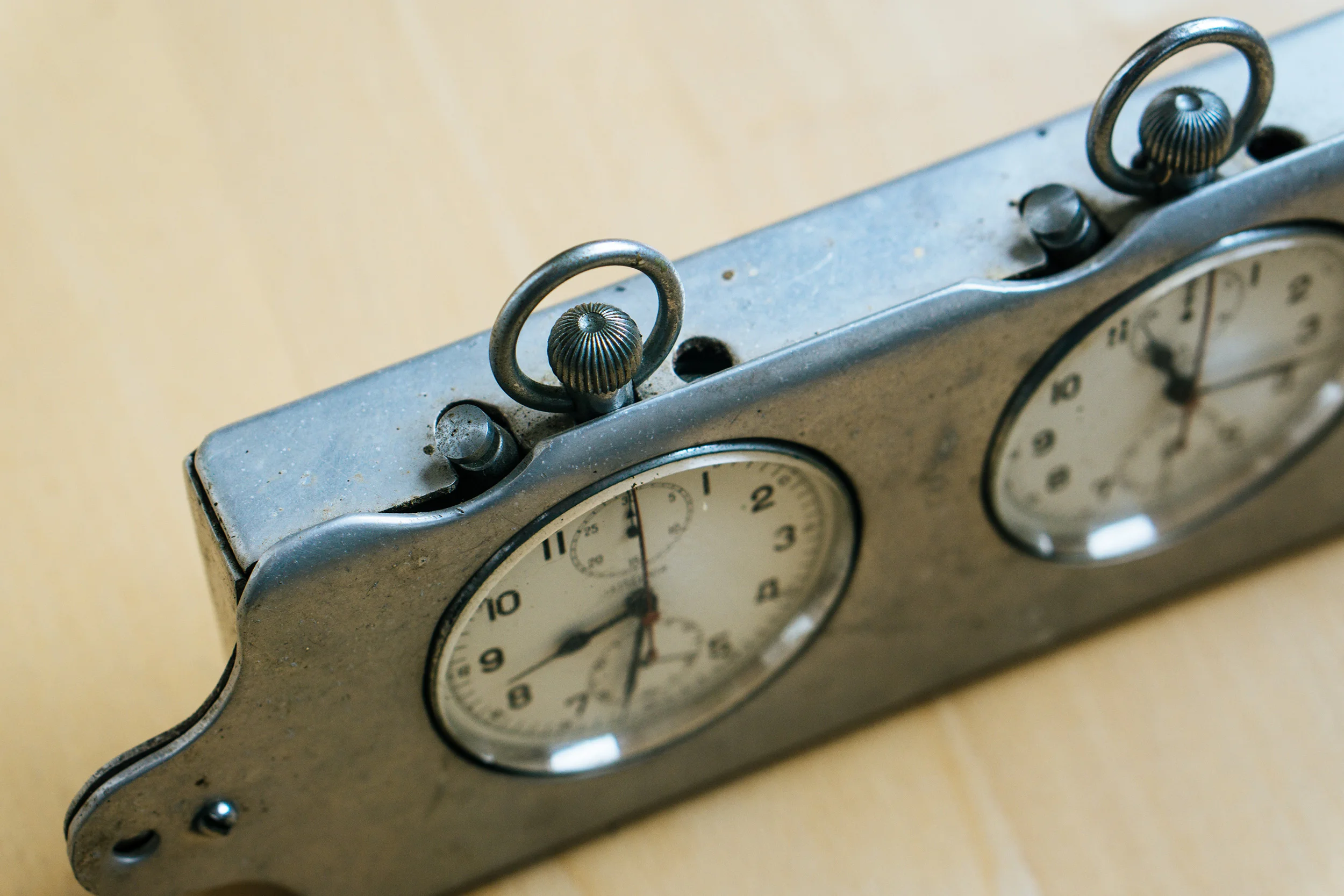

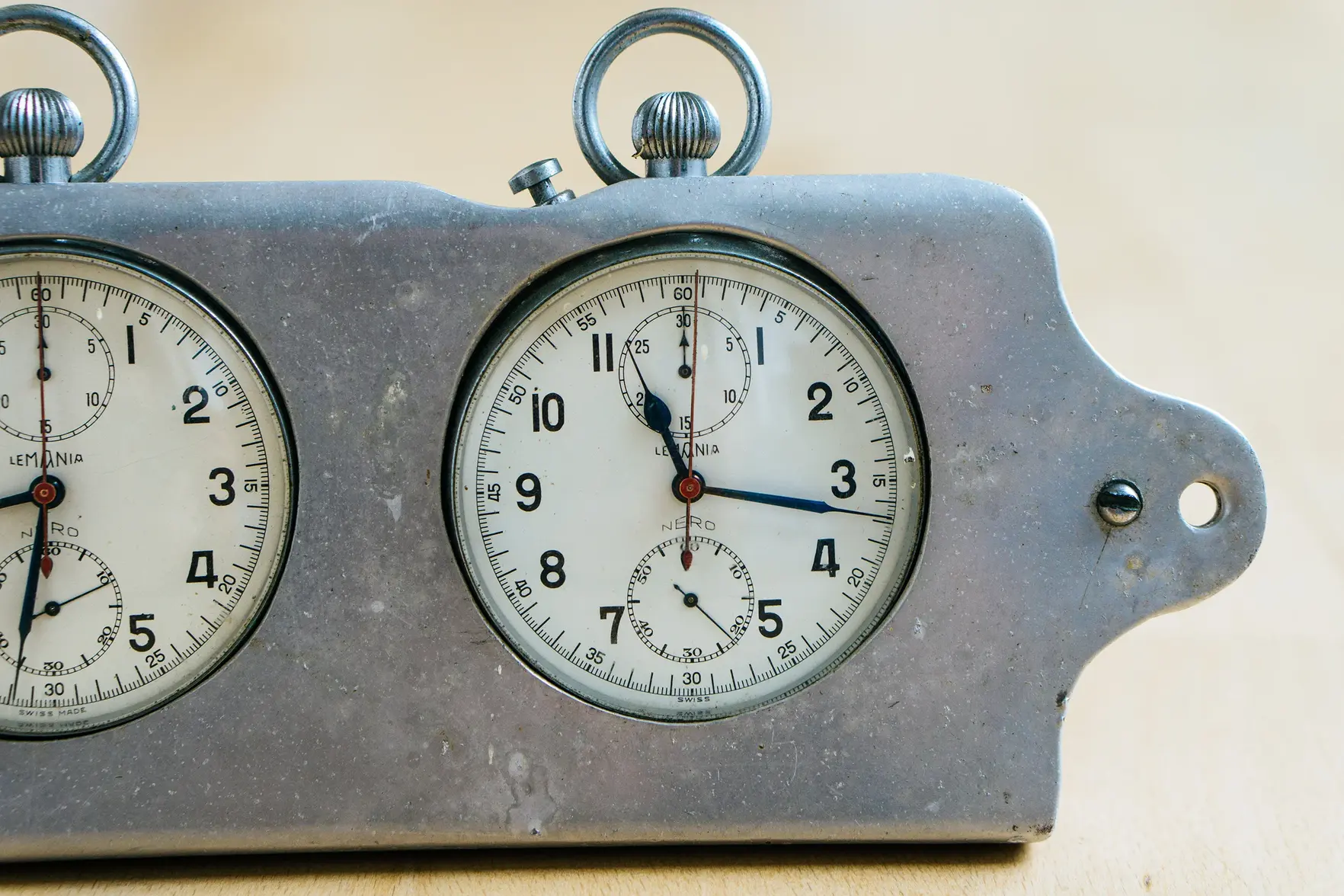

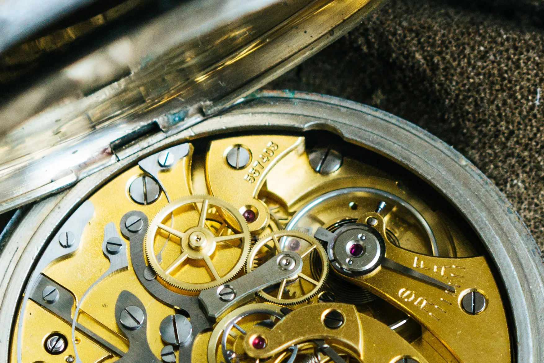

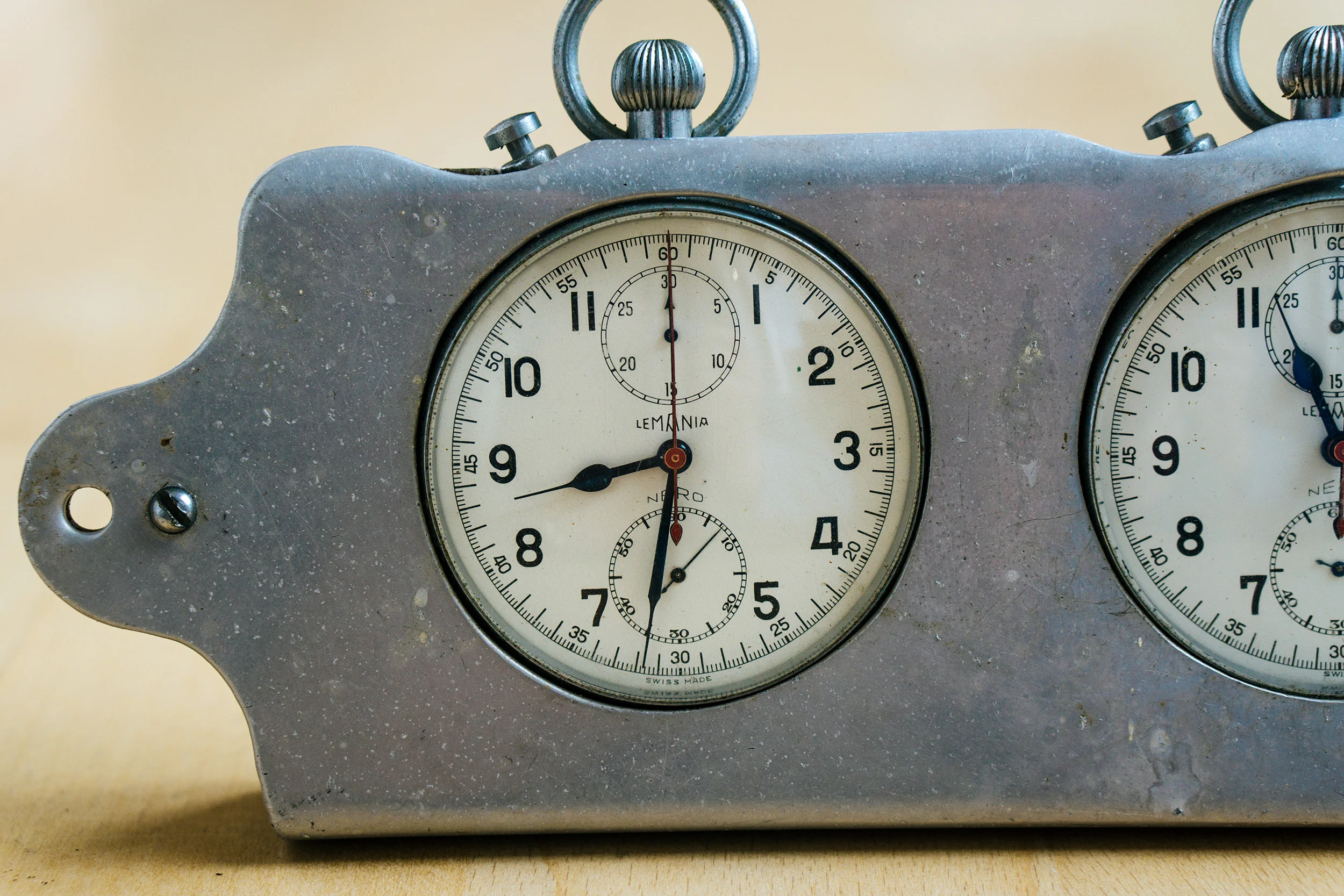

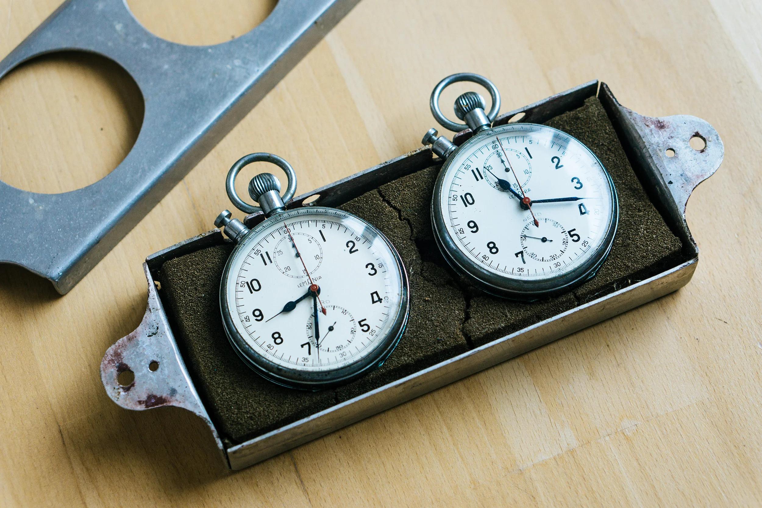

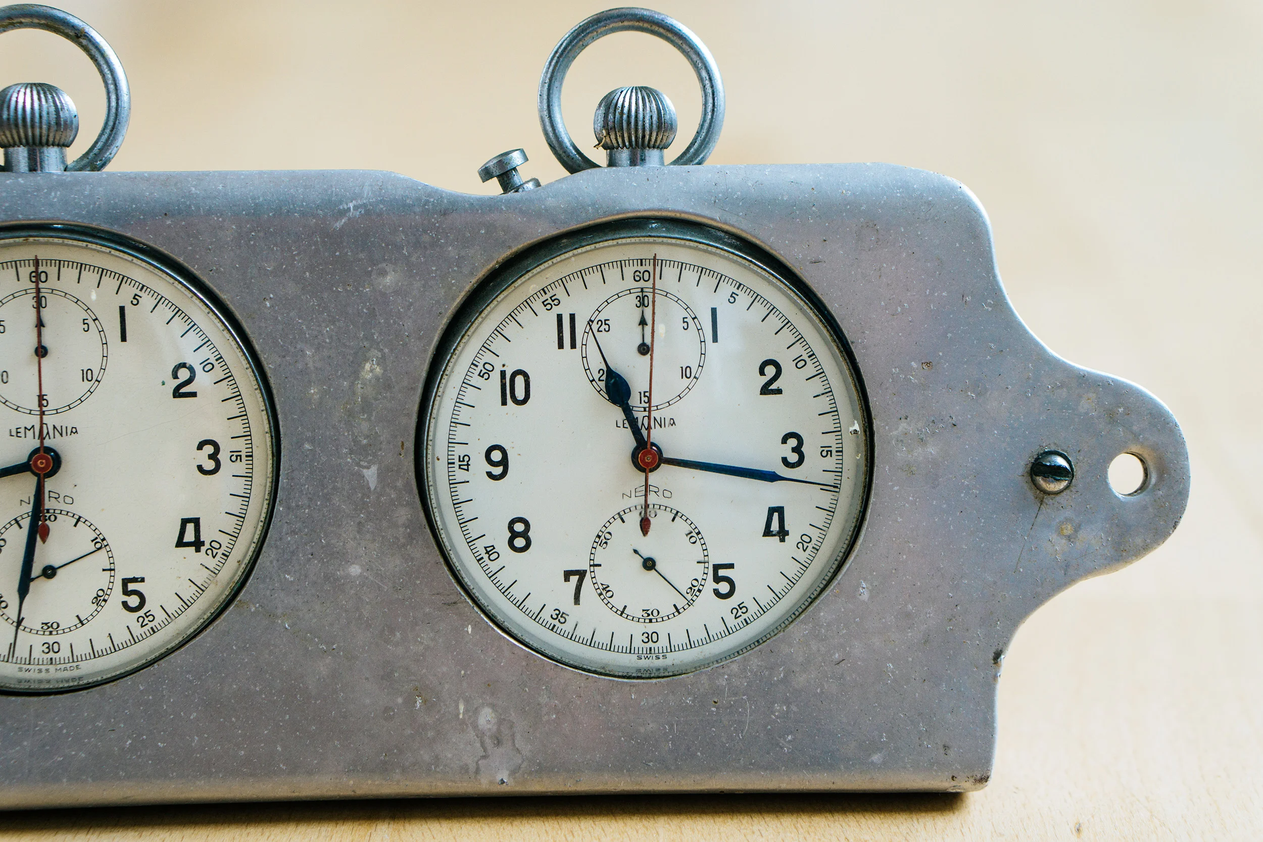

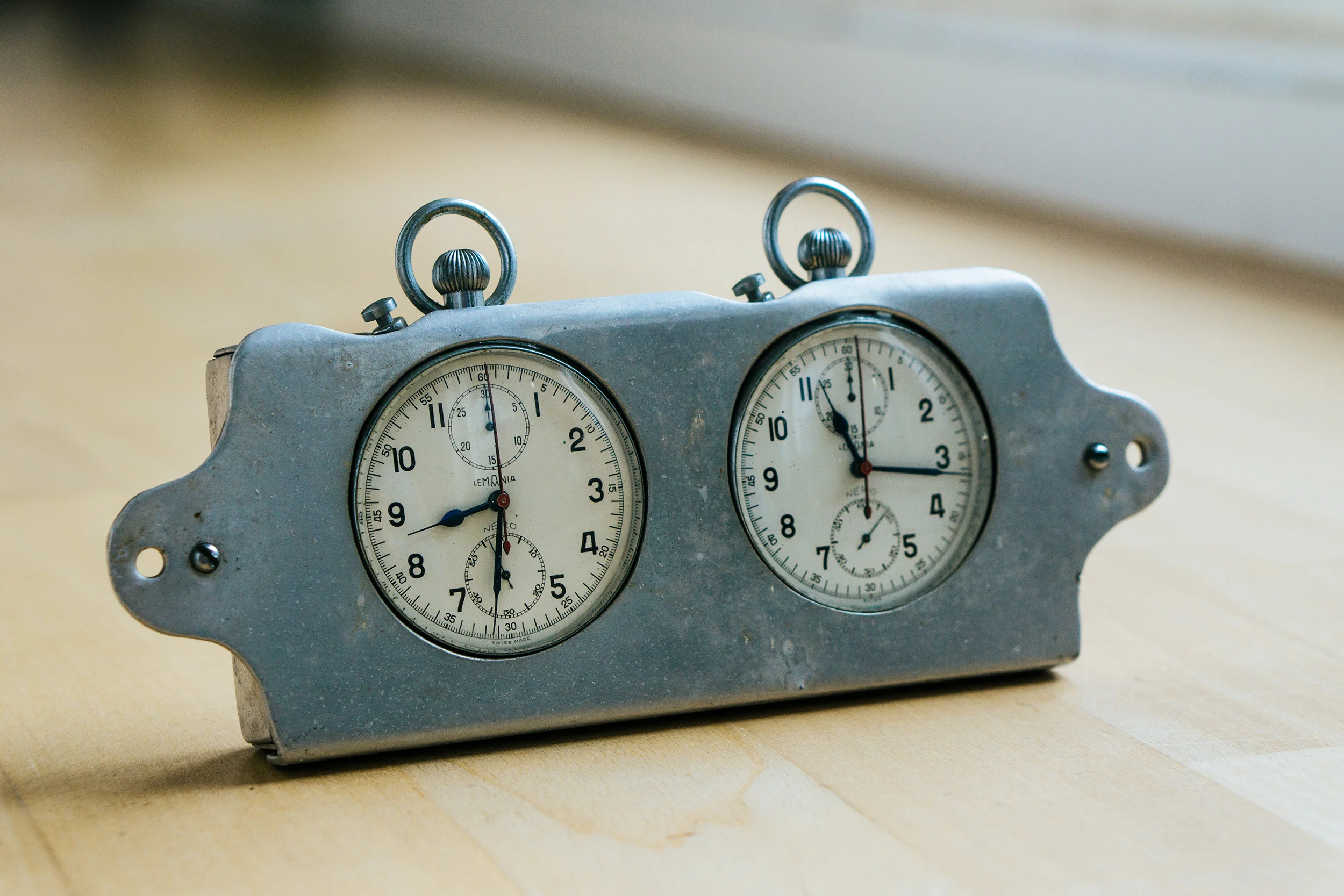

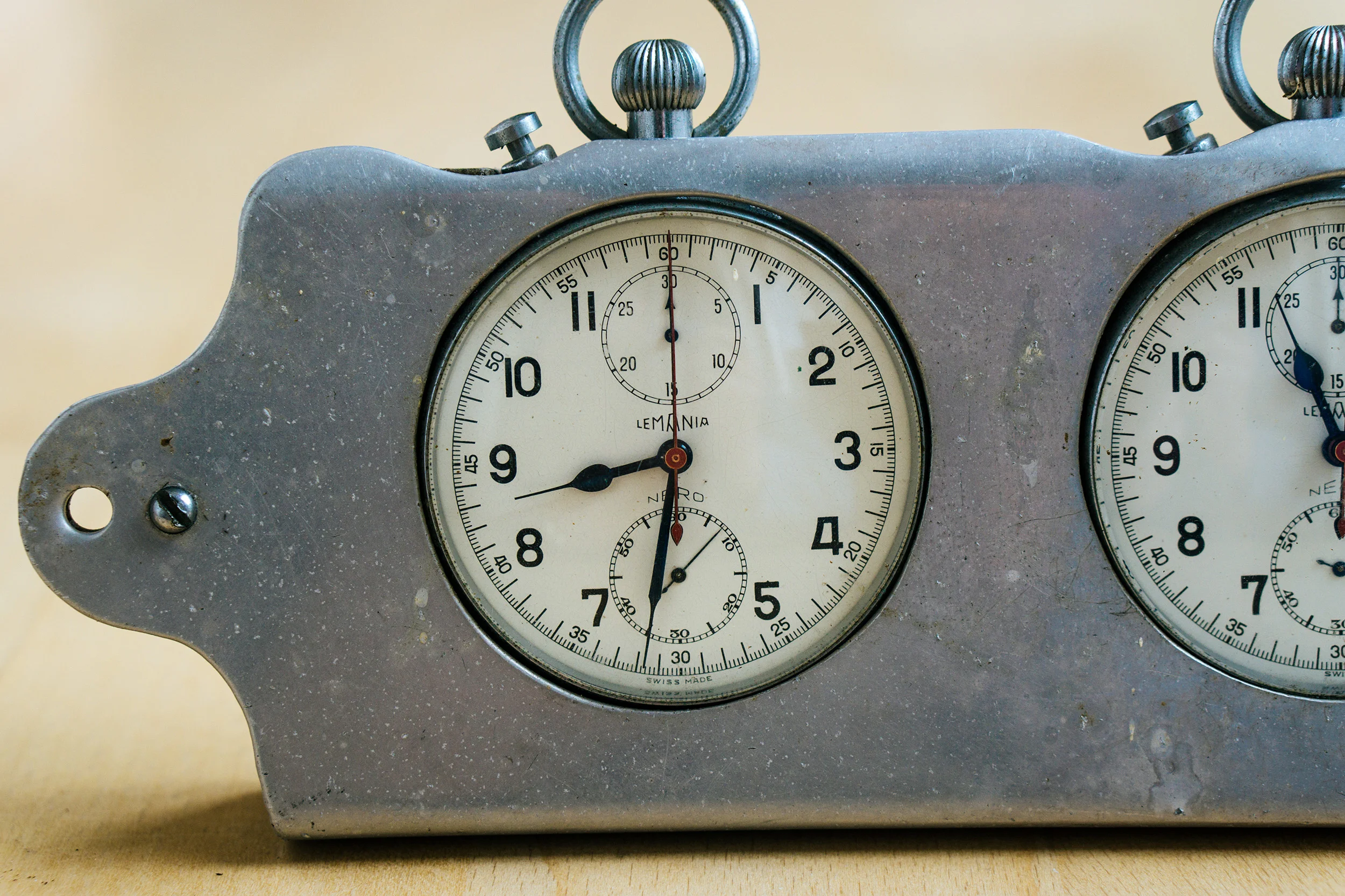

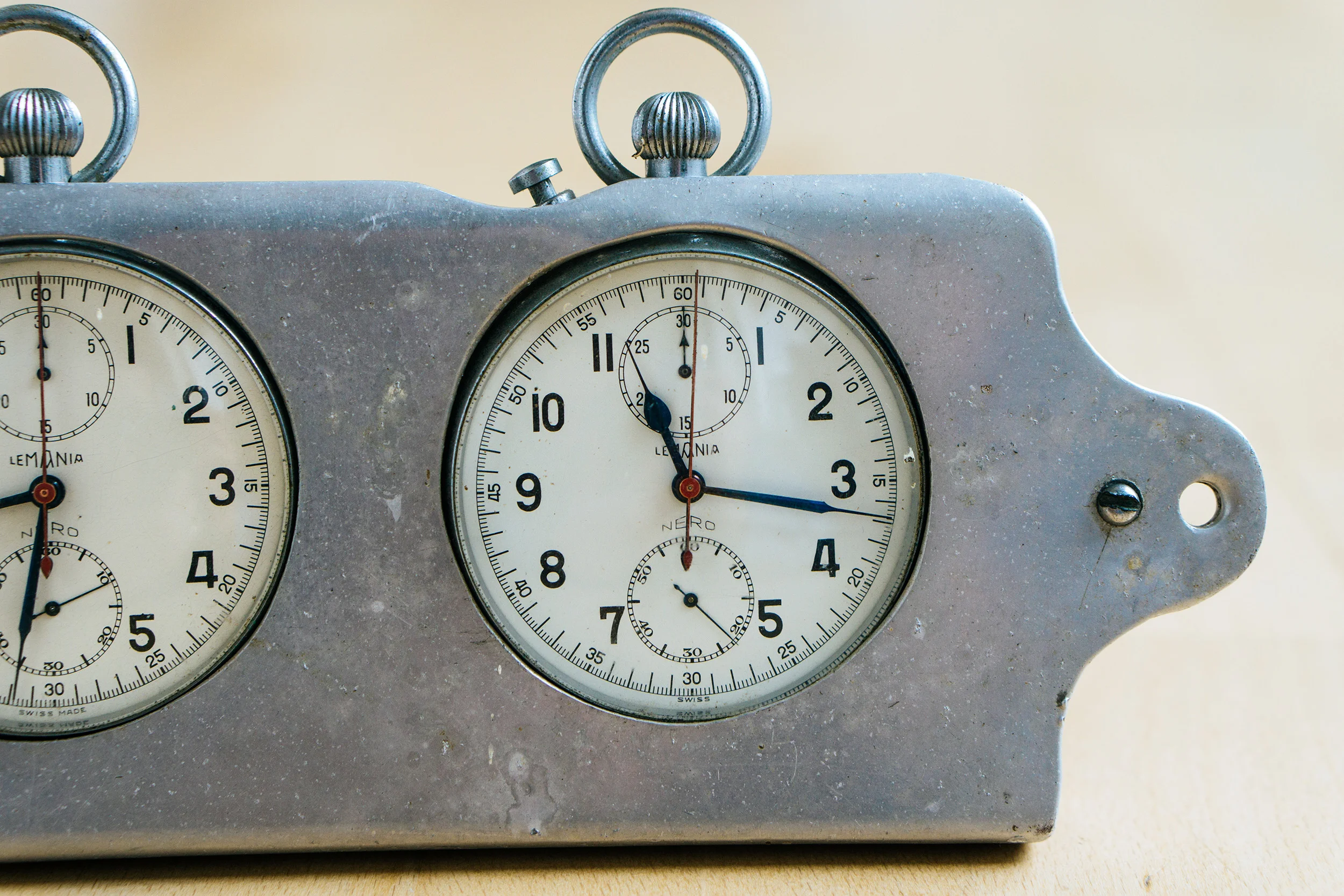

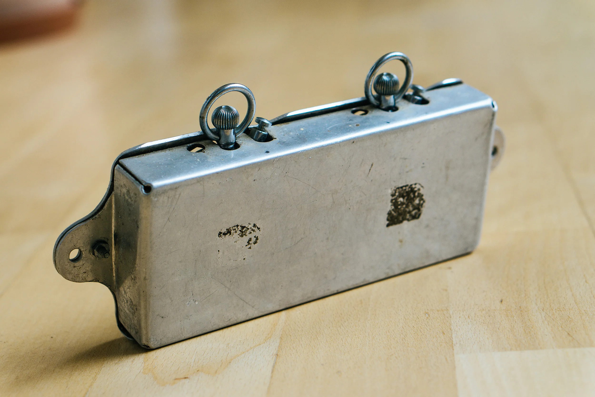

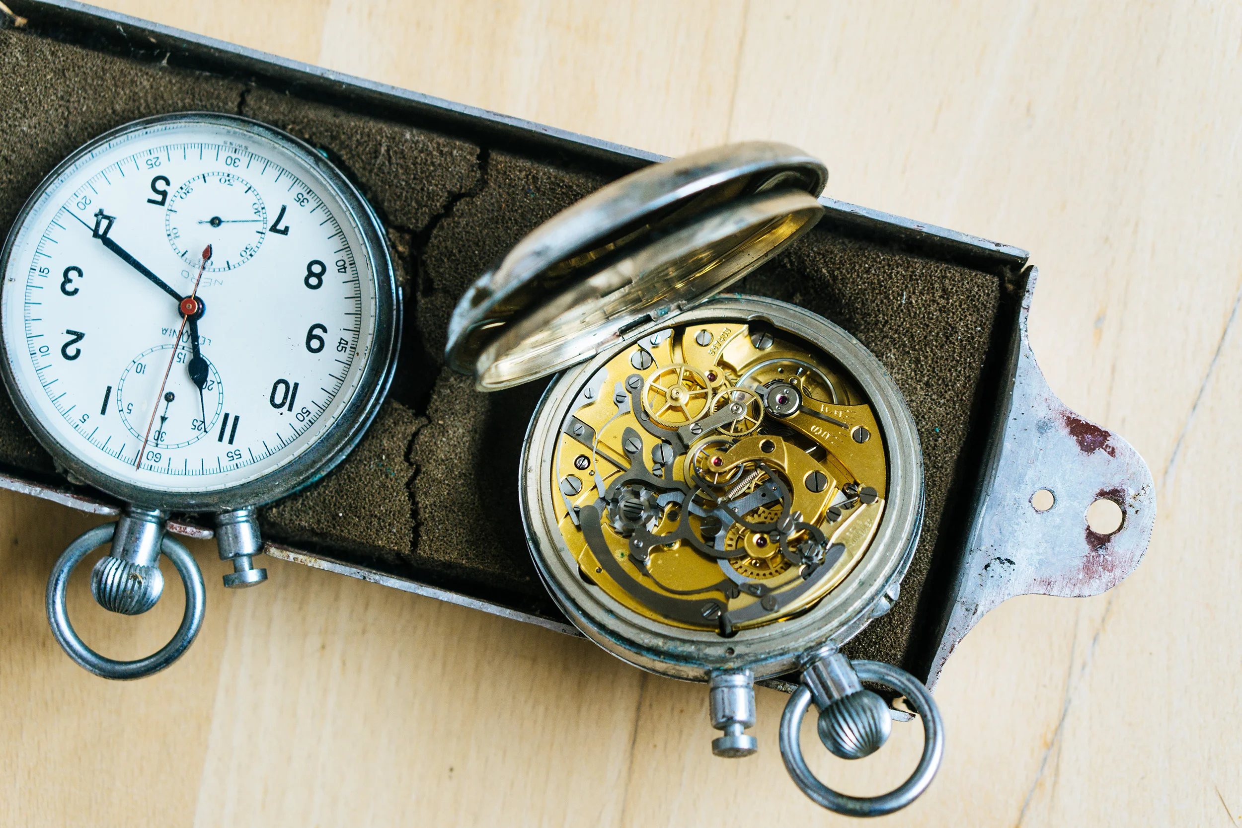

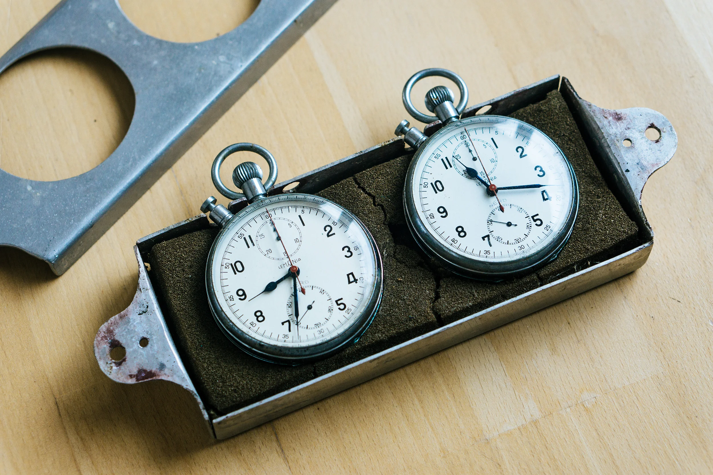

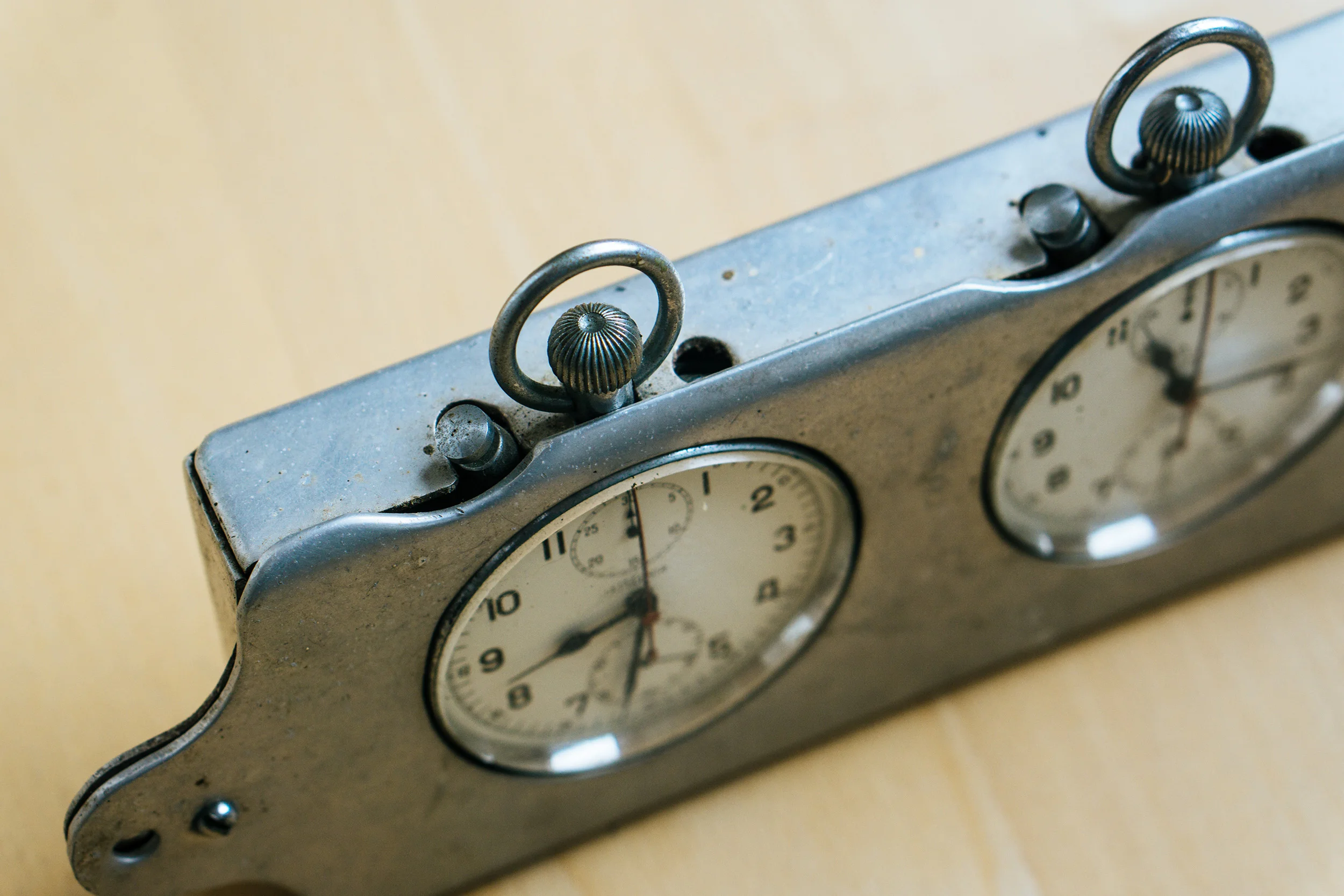

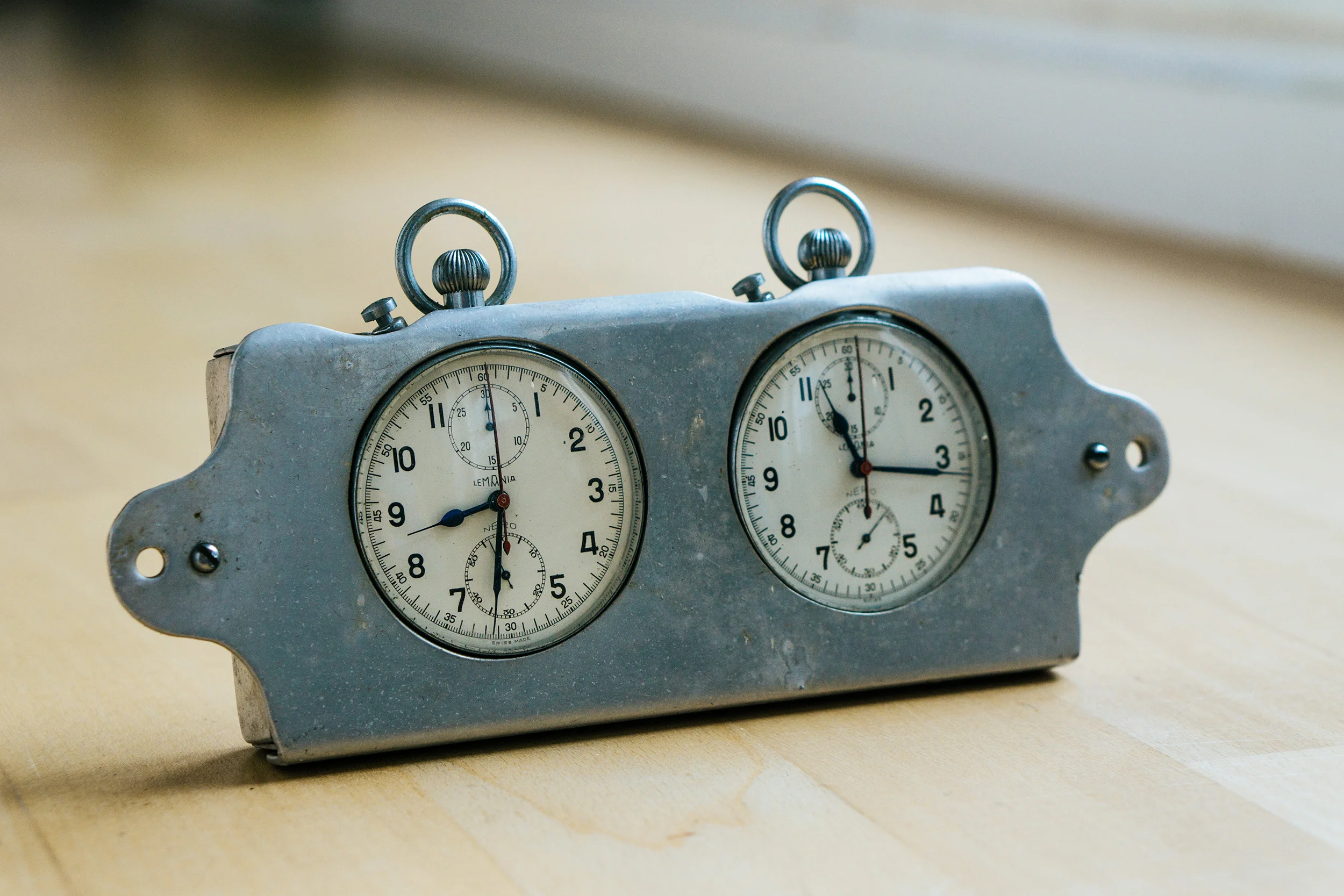

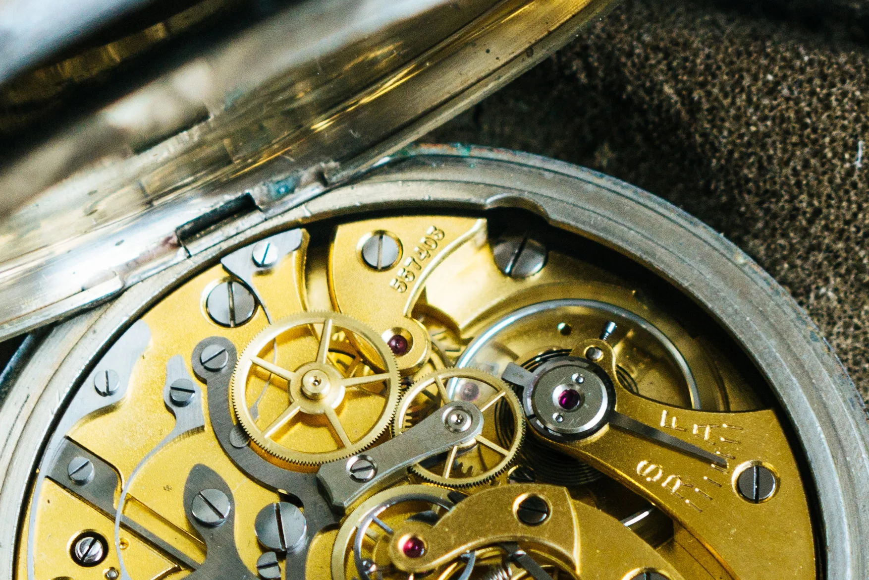

Got this interesting Lemania "Dual-Timer" from the bay. From the first look, I thought this might be a Rallyetimer, on the second I thought, hmm, maybe the pushers are not optimal reachable.
Since it arrived today, its pretty sure the case is hand build. Since Motorsport in the 50s (Serial 557.404 & 557.403) was a hobby for a lot of people, i wouldnt cross out the possibility the Timers where set on a dashboard. But I am open to ideas. 😀
Regarding the serials, its interesting that they are direct siblings (see number above). Both are running and the movements are quite a stunner!
Nico

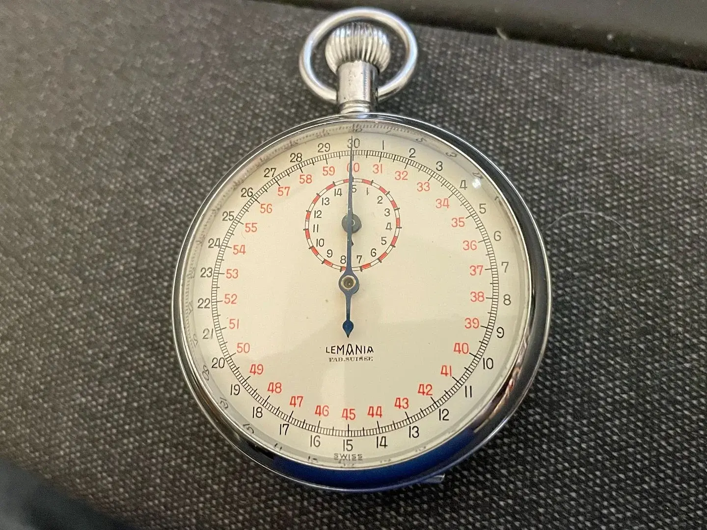

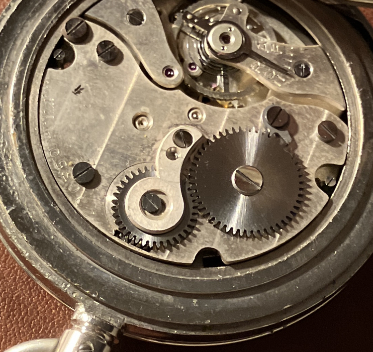

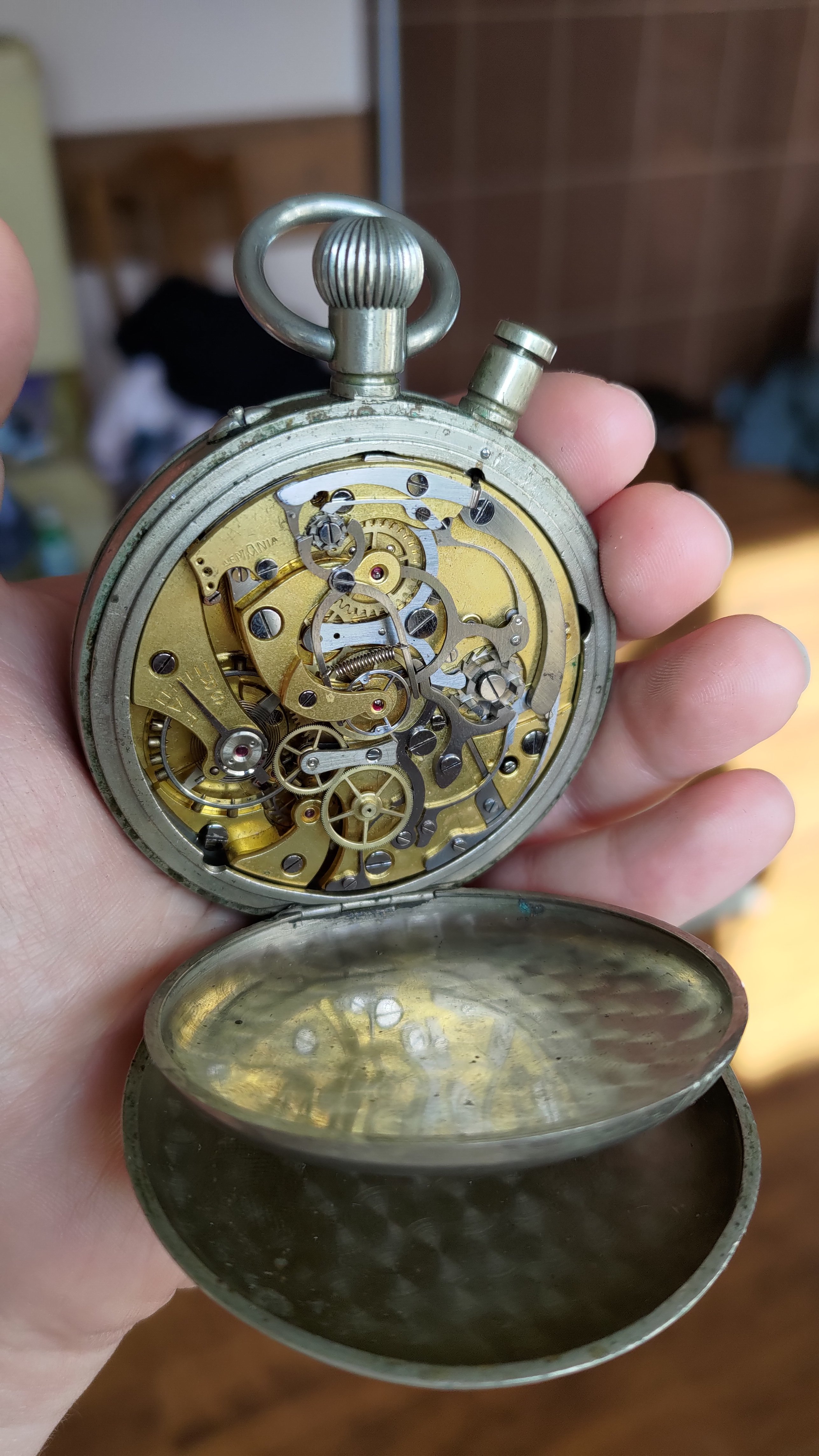

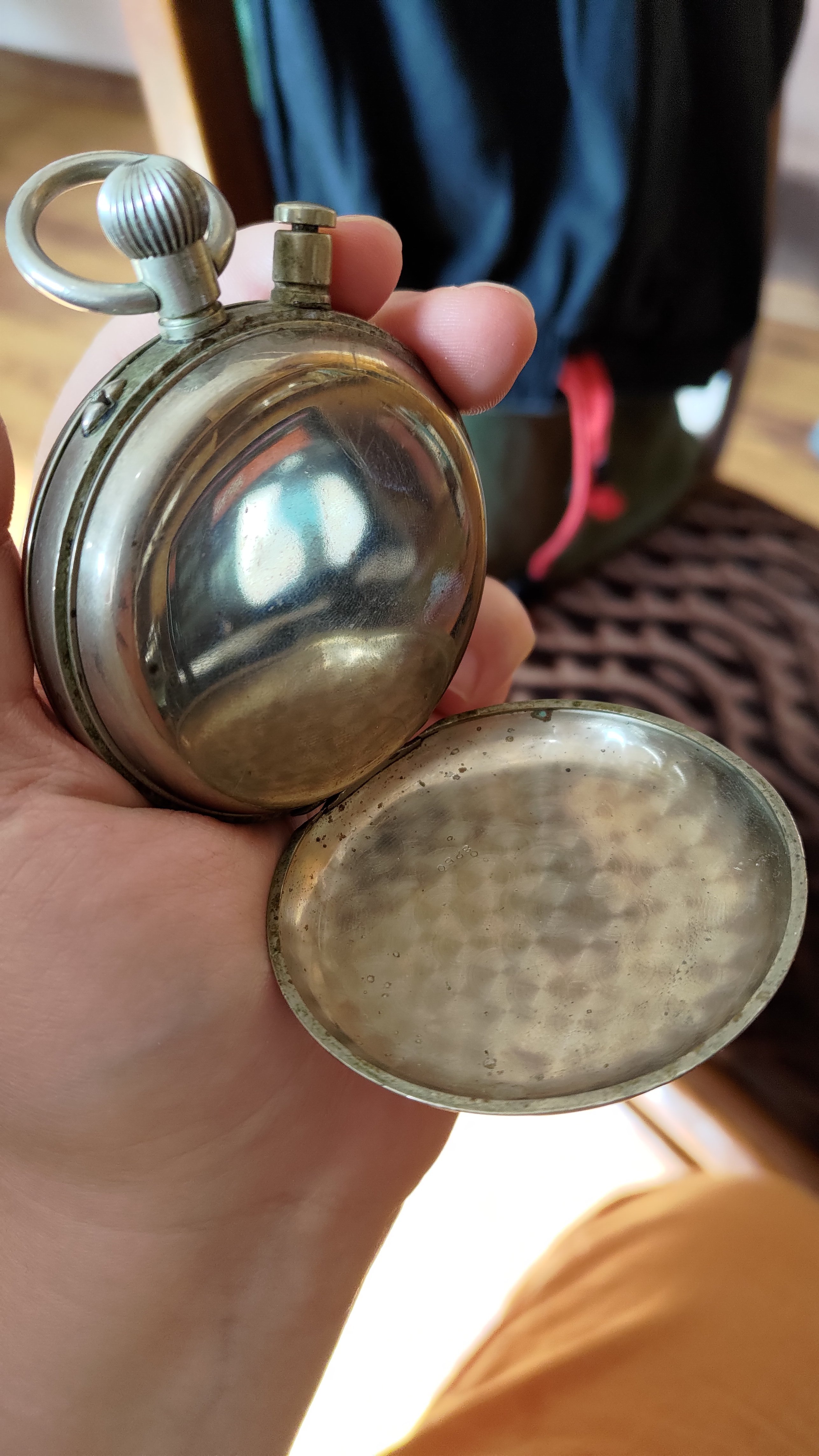

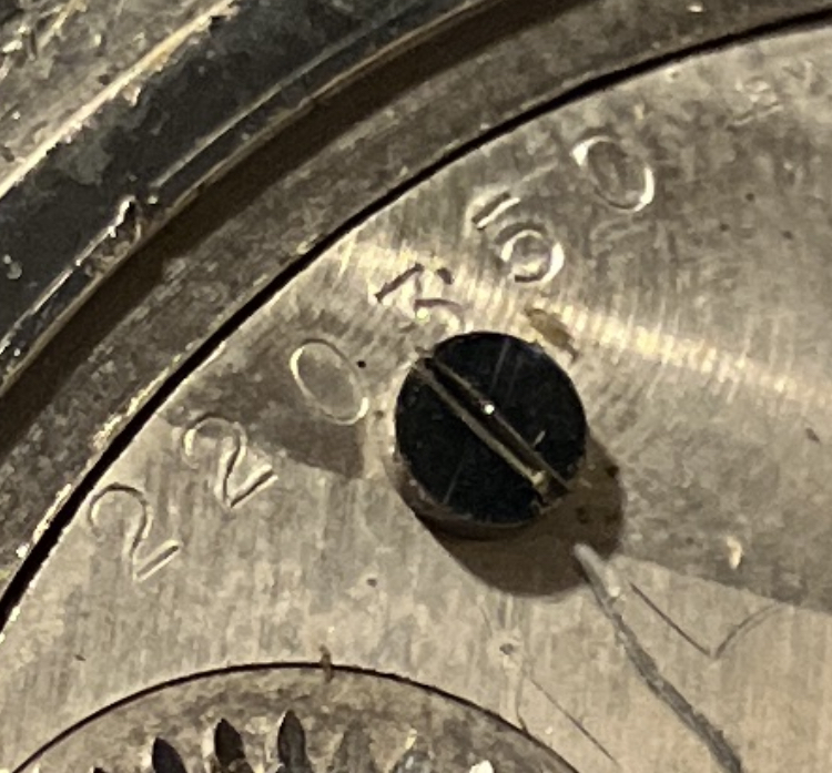

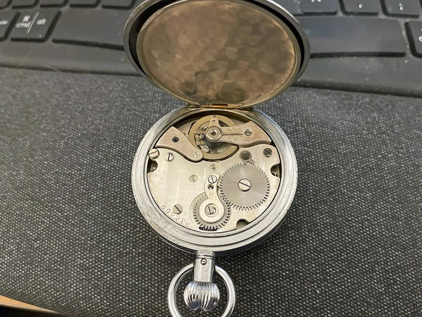

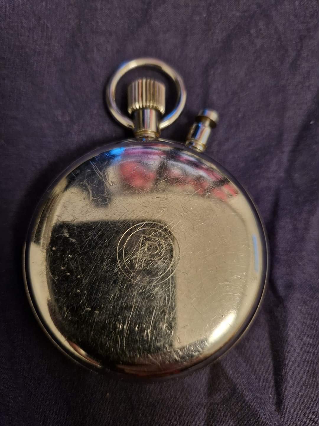

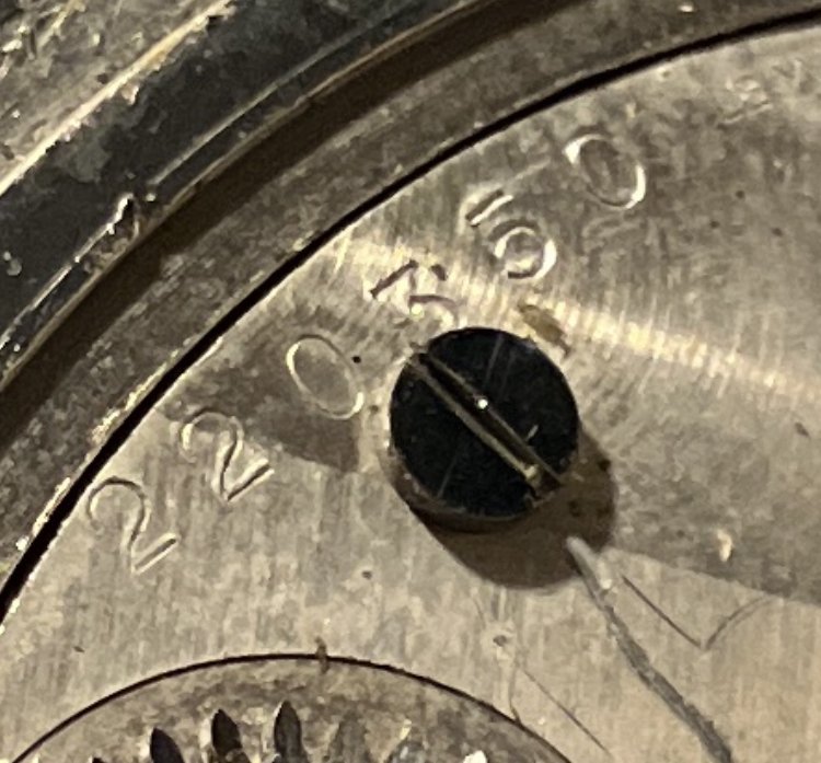

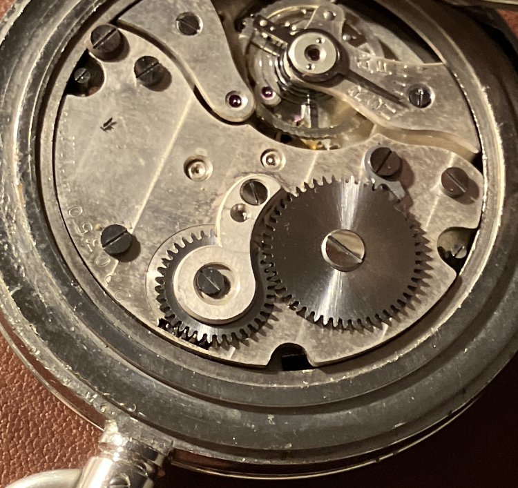

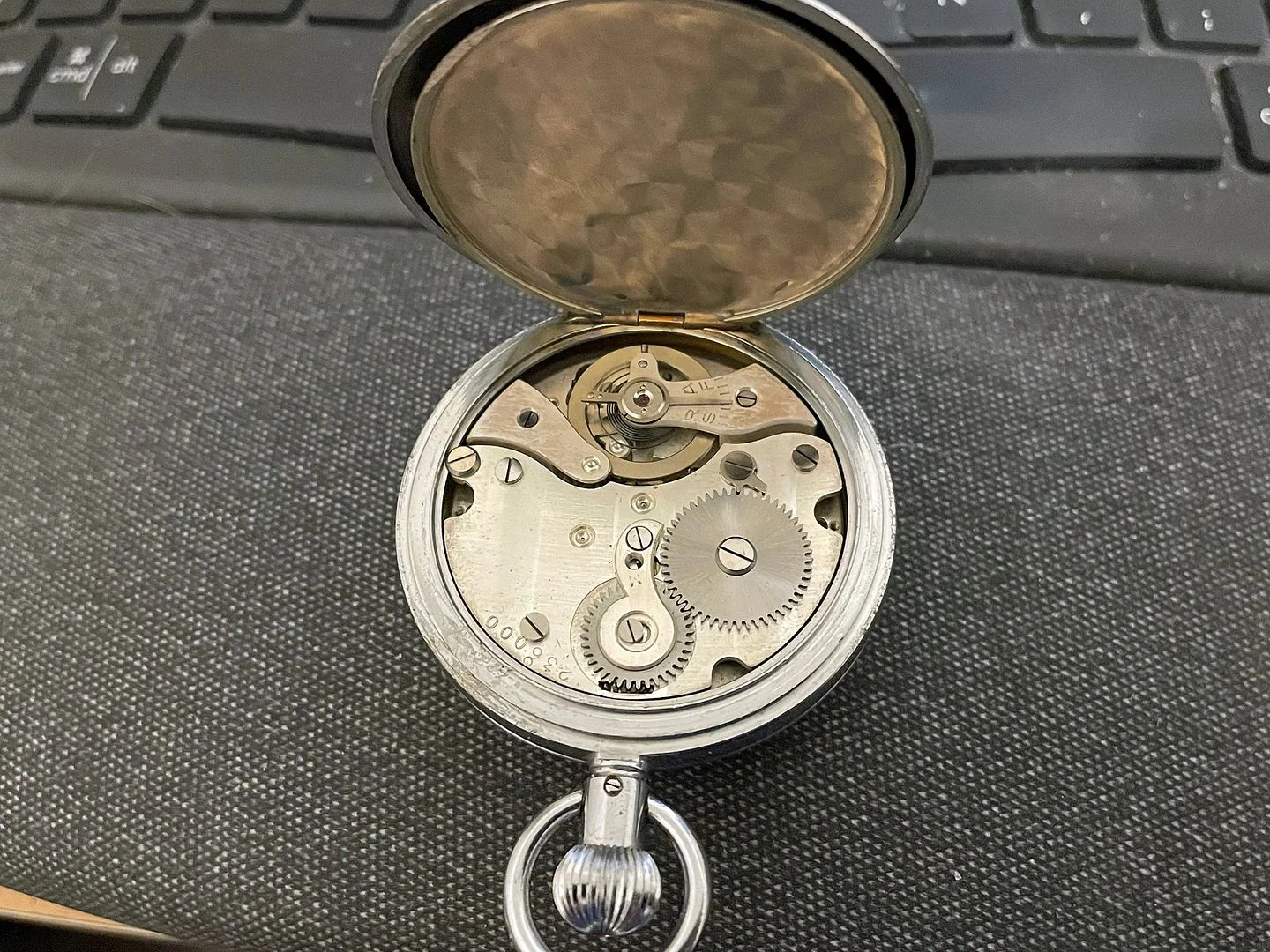

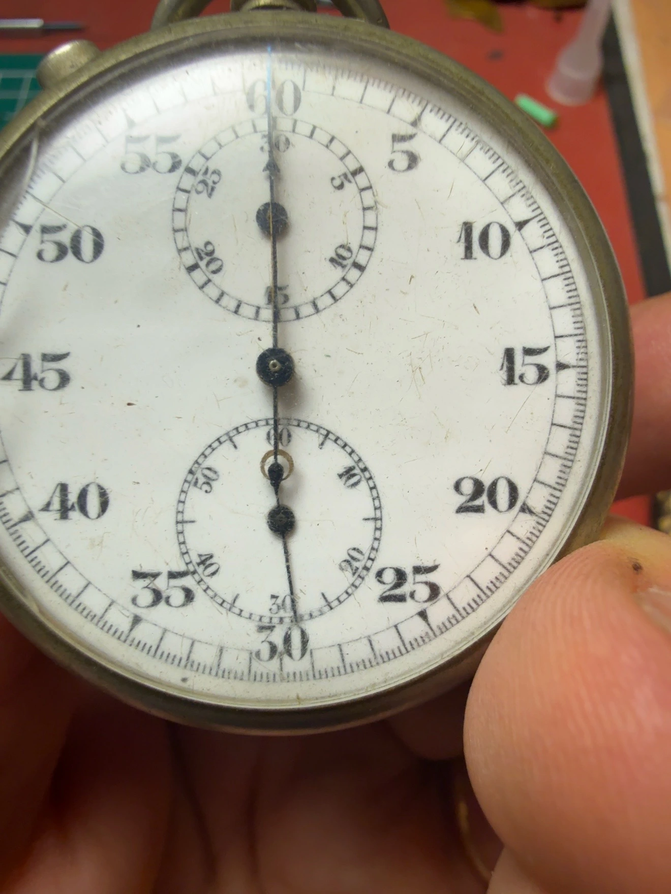

hello all. I’m trying to identify this stopwatch that’s been in my family for years. Looks like a Lemania 233 but the reset button is on the left rather than the right. I can’t find an exact model and apart from Swiss Made, there is no other identifying descriptors. The serial number is 208937 and the movement dust cover has been ‘Manchesterised’ using carborundem paste and a rotary wooden peg. Need to identify to try to source a balance wheel and balance spring for it so any clues greatly received. Thank you. Jools
